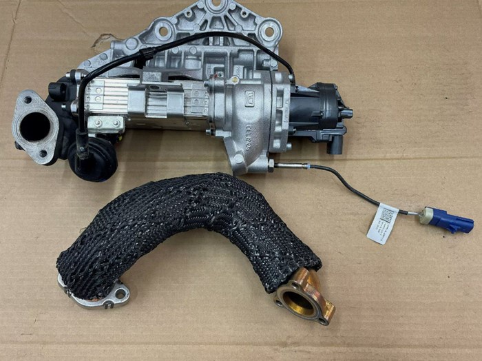

Let me preface this by saying that I've had the EGR valve/cooler replaced three times on my 2015. The first one failed internally and was replaced under warranty. The second one did not fail but was replaced due to the EGR recall. The third one clogged and was replaced under the AEM warranty.
I've already bought a spare Mopar EGR valve/cooler. Keep in mind, the EGR valve is pretty solid and long-lasting. It's the actual cooler that fails. Mopar doesn't sell the cooler separately, so you get the valve and cooler in one unit. The BulletProof cooler is a standalone cooler.
I bought a spare Mopar EGR valve/cooler from a person who took it off a new crate engine. I've considered removing the Mopar cooler and installing the BulletProof cooler but haven't made any decisions yet.

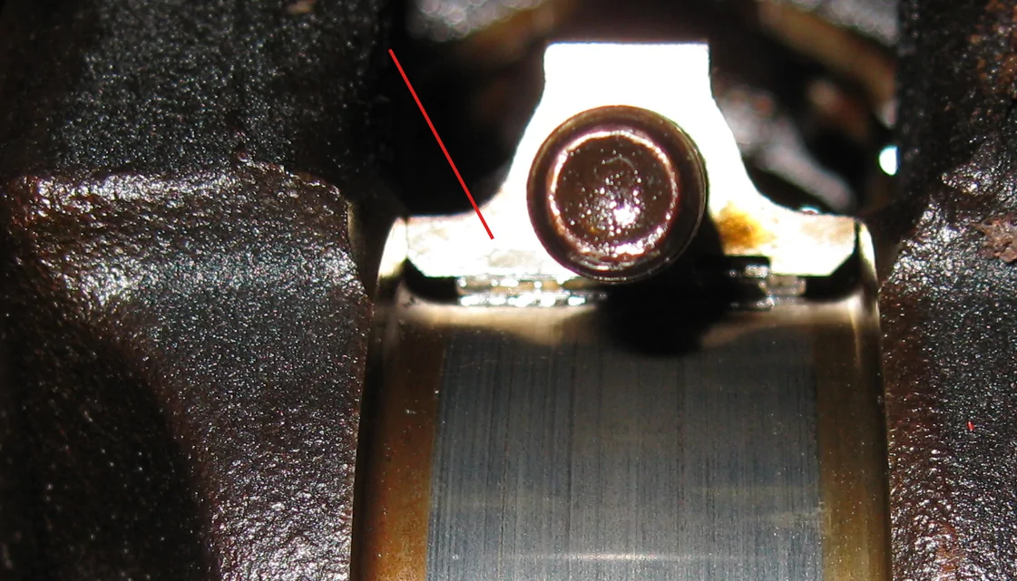

To align them correctly in the cap. The 2 ends of tbe bearings after caps are put on push against one another which does the job of preventing rotation IF all clearances are per spec. I know it sure help when you have to do a fly by night bearing job. And the block is still in the truck . I literally have left the scene of a off roading rollover situation that resulted in damaged bearings. Bought bearrings . Dropped the oil pan. Loosened all caps . And gently slide the new ones in around that lip,tang , lock what ever it is lets ya know its in there correctly situated. So that tang has to line up with that notched area or something else bad will take place
They don't need to align - in fact, they typically don't match each other but are on opposite sides. The tab prevents rotation, yes, but the bearings are just a tiny bit larger than the recess and get crushed into the cap and rod and torqued down. The tabs don't touch each other. They make contact with the plain part of the rod or cap, or block or main.
One thing that I found interesting about MOPAR's version of the 4.0 was that the bearing tangs for the rods were on opposite sides from the 258. When I built a 4.0 and used 258 rod bearings, I had to file notches in the rods and caps for the rod bearing tangs!
Why they moved the notch in the rods and caps to the opposite sides I'll never know, unless it was something Iacocca wanted to ensure no one could use AMC parts in the Chrysler engine that AMC invented. I did it anyway.
The tangs never contact each other. In fact, because there's no difference between the rod half and the cap half, they end up opposite each other, not touching each other.
The tang has to be in the slot in the main or rod, but they don't line up against each other, cap tang to rod tang, and so on.
Here's one example from one I did -
The top bearing half tang can be seen to the right of the bolt.
The cap bearing half tang would hit the rod where the red line shows - in fact, you can see the imprint on the rod surface. They don't line up, you don't want them to.

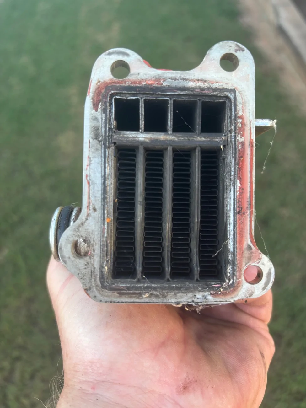

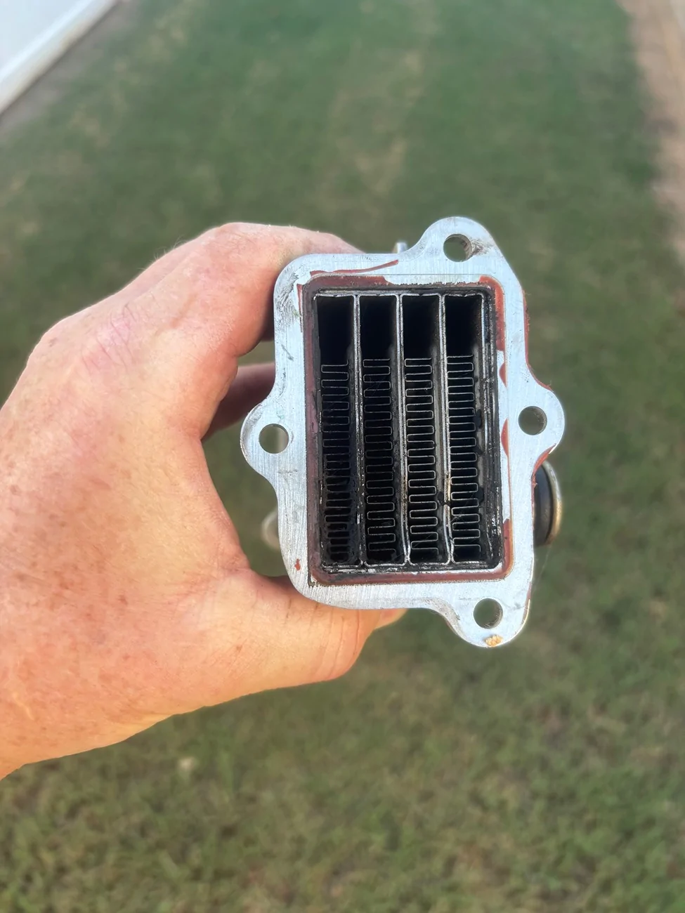

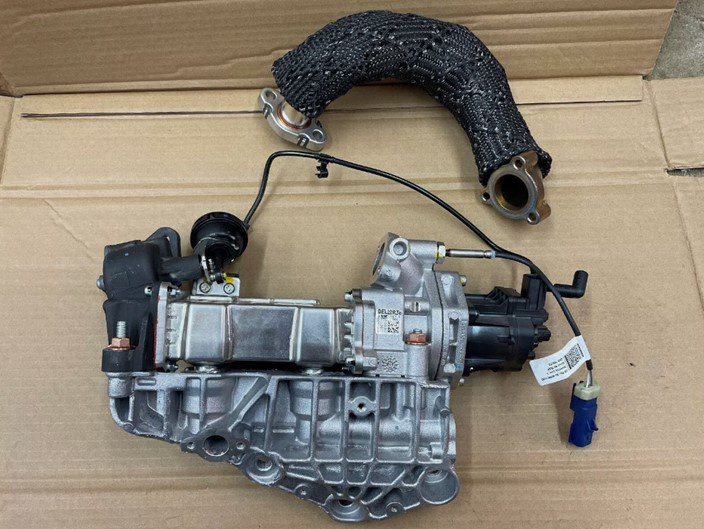

Here is a couple pics of my EGR Cooler I removed to replaced with the one from Bullet Proof Diesel. 210,000 miles total on this cooler with 154,000 of them with the GDE Tune.
Steve
Not to shabby

In regards to clogging. What do you think caused it?
In general, low temperature operation (short commutes) and high idle times are probably two major factors that accelerate soot accumulation inside the EGR cooler.
It would be a good idea for EGR coolers to be cleaned every 30,000 to 50,000 miles depending on how the vehicle is used. In my opinion, the Mopar cooler is a throwaway item, but the BulletProof coolers are designed to be cleaned and reused.
I use my 2015 as a daily driver and work truck, so it sees a lot of low temp operation, lots of idle time, and a fair amount of towing.
