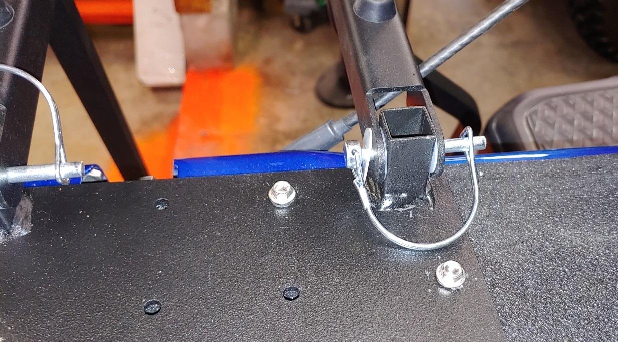

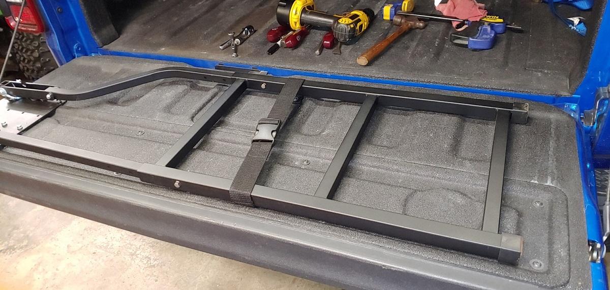

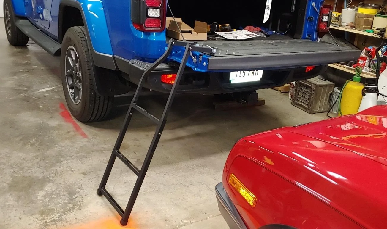

I made two mods and got the ladder to work just fine.
I moved the front of the two "posts" that hold the ladder to the mounting plate by cutting it off the place and moving it to the rear (closer to the other) by about 1/2" and welding it back in place.
It still left one of the pieces resting against the tailgate cable, so I notched a piece on the ladder to clear the cable.
I also did not mount the straps where and how they said as I didn't want to drill still more holes in my tailgate - so I used existing screws. They wanted that strap mounted between the first and second ladder rung, that would have demanded two new holes. I moved the strap to between the 2nd and 3rd.
We'll see - if it's not held solidly enough, I can always relocate the strap.
I did not yet put the 2 square plastic plugs into the square stud ends after welding - almost forgot, removed them to prevent melting them from the welding.......... so those square studs sticking up don't have the plastic plugs in them yet.
It works, after getting the tires up into the truck for my wave rotation and oil change, it started raining so I had to move the ramps and get the truck back into the garage to strap the tires down - using the ladder to get into the truck.
So I can say that I have used it at least twice and it works fine.

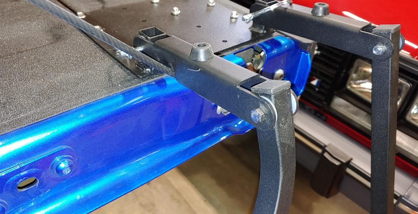

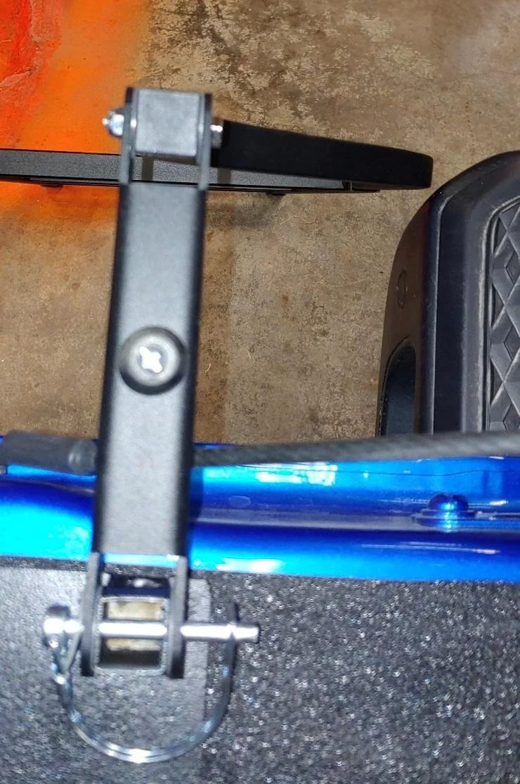

Here's the part I notched - just one side, and just to clear the cable better. I may put a piece of fuel line on that part of the cable to help my OCD stop thinking about it.
Jeep Gladiator Steps for tailgate? 20201022_161542_HDR

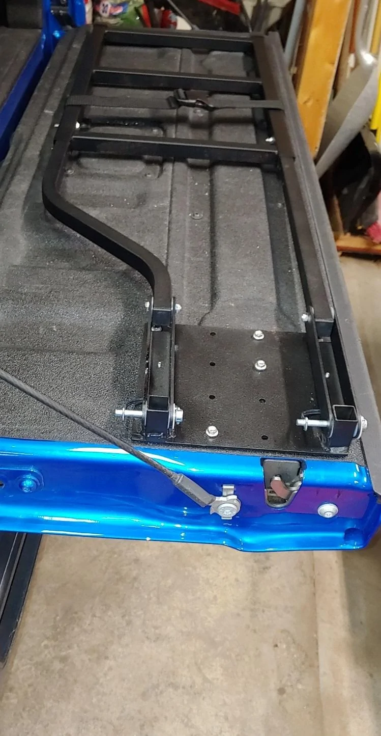

The forward mounting post -the one on the right in this picture, was mounted clear out to the front edge (right edge in this photo).
I moved it in a bit to help move the ladder a bit away from the cable (and bumper)
My weld looks like crap in this picture! (well, they aren't things of art anyway, but not as bad as the pic, either)

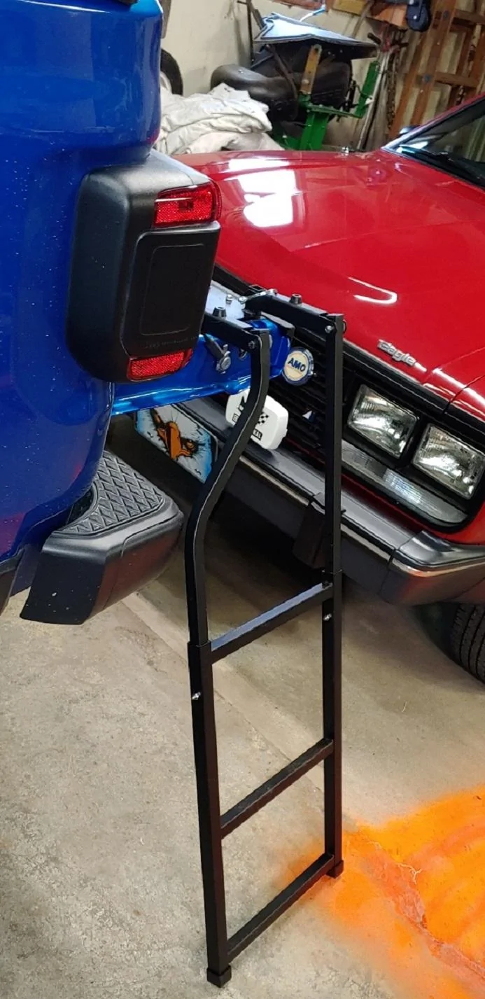

To remove the ladder completely, you simply pull the two pins and the nylon washers.
Jeep Gladiator Steps for tailgate? 20201022_161606_HDR
Jeep Gladiator Steps for tailgate? 20201022_161620
Another view of the square post I moved, it was clear at the corner of the plate. I moved it inward.
Also, a view of the tailgate cable - the cable is not even quite touching the ladder.

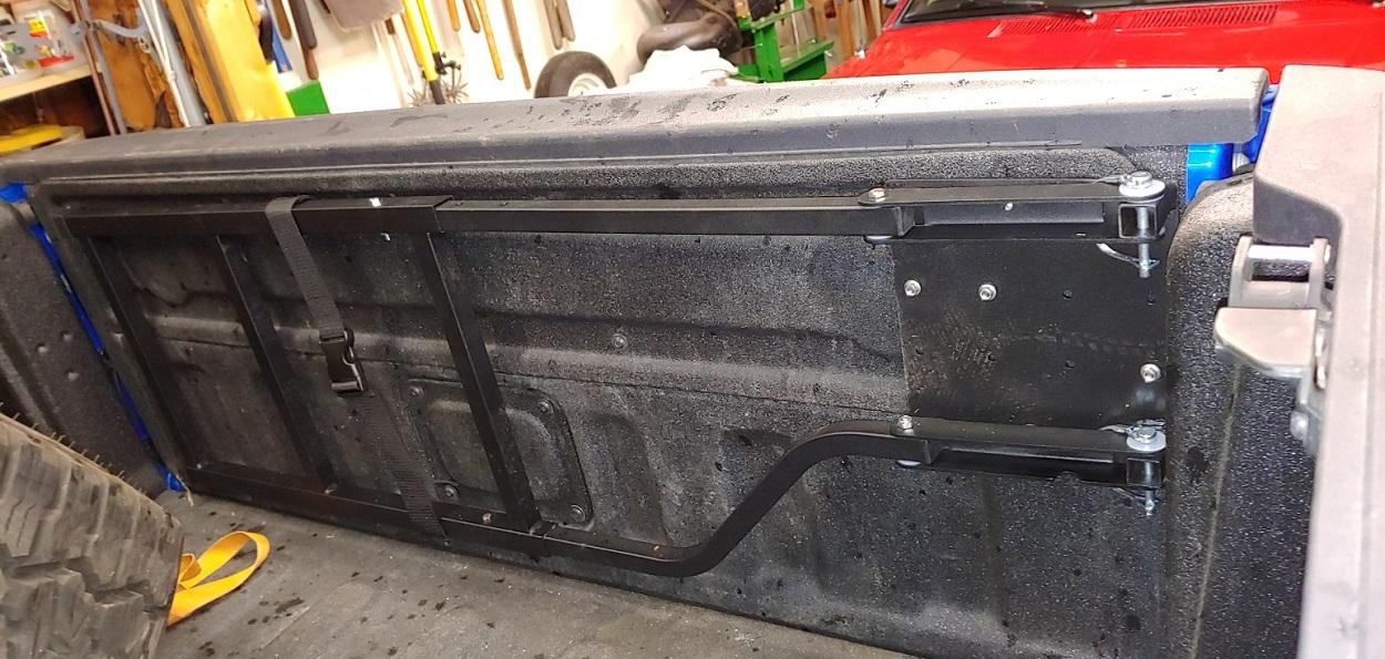

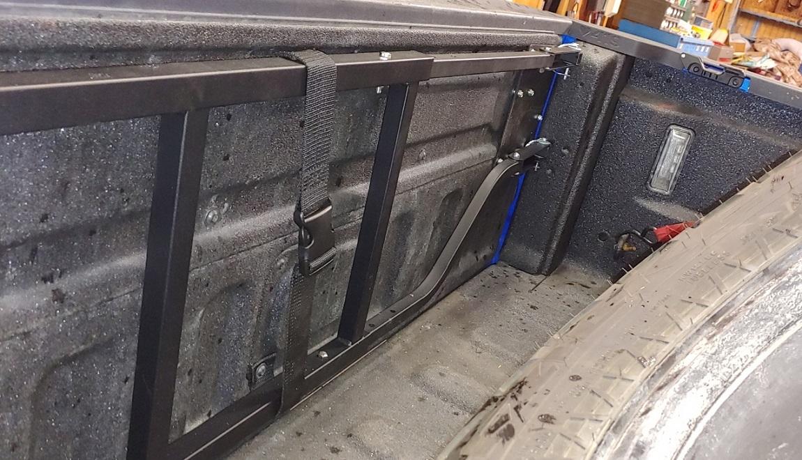

Ladder strapped - used existing screws to attach the strap. They wanted it further out to the right between those last two rungs.
