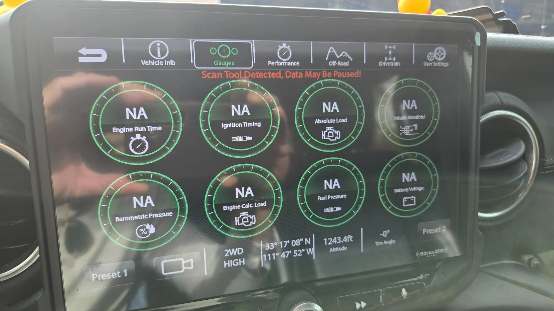

Initially I thought maybe this was because I had my Tazer MINI installed that my STINGER RADIO would put this message up when looking at the gauges. But I removed it for dealer service for what I thought was a rough idle and they said a emissions software update should take care of it because it was missing from my 2020 Gladiator, 33k miles. I've gotten it back and doesn't seem that it made a difference to the rough idle but I've not reinstalled my Tazer MINI and basically seems to me if I drive for about 5 minutes without using the brake the gauges will all start working but as soon as I hit the brakes everything on PRESET2 page goes to "NA"(and the "battery voltage" on PRESET1 page). All values come back if I don't use the brakes for around 5mins but that's what seems to trigger the message.
The only other after market thing I can think of that I have on here is the VIPER DS4 Remote Start and alarm system.
Anyone know why or how to get rid of the message from reoccurring?

One suggestion that I can offer is for you to check the canbus star connector behind the glove compartment. Check for damaged wires, damaged connector, or disconnected wires.

I checked all green and white connectors but what do you mean by "star" connector?
