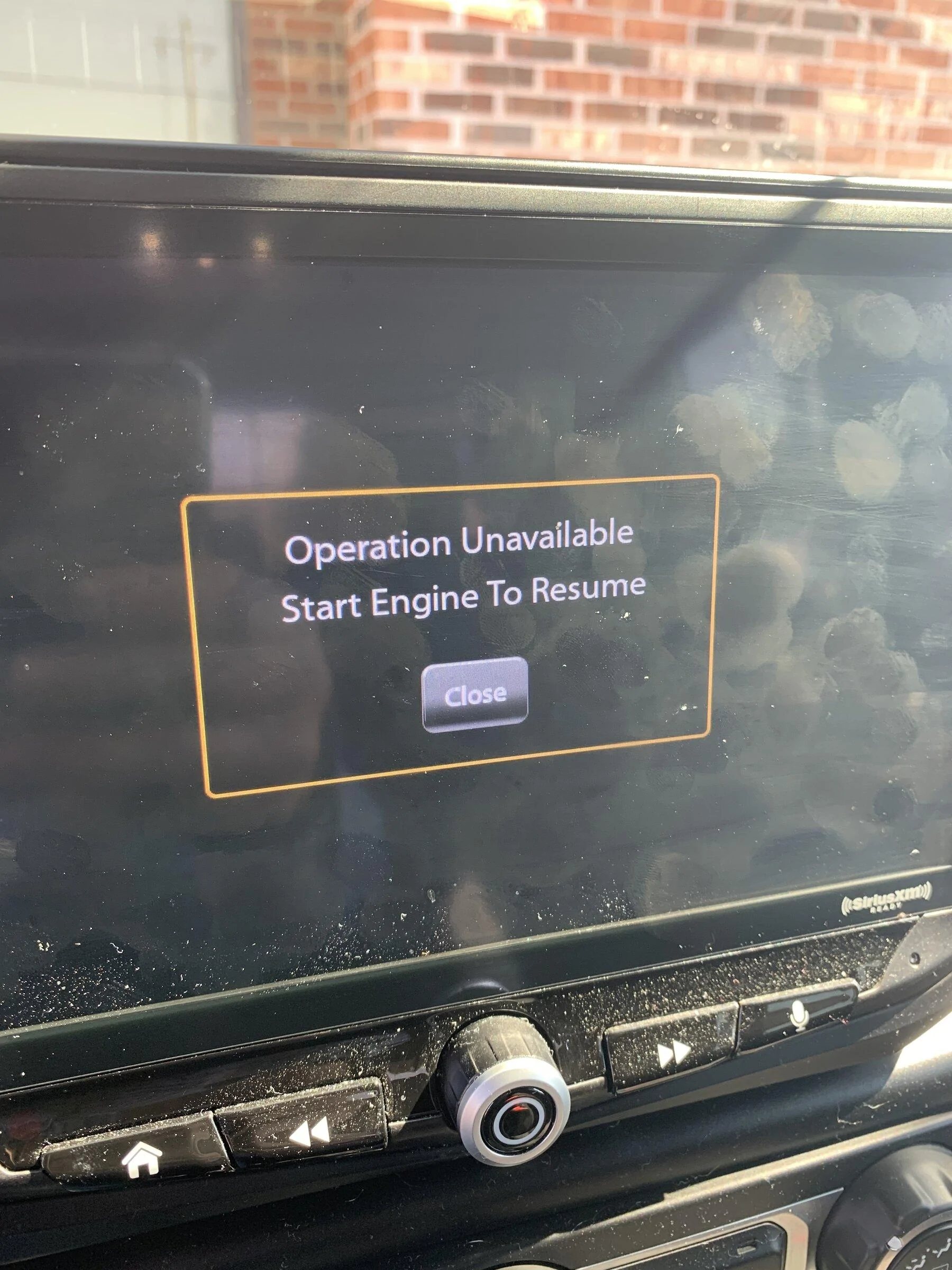

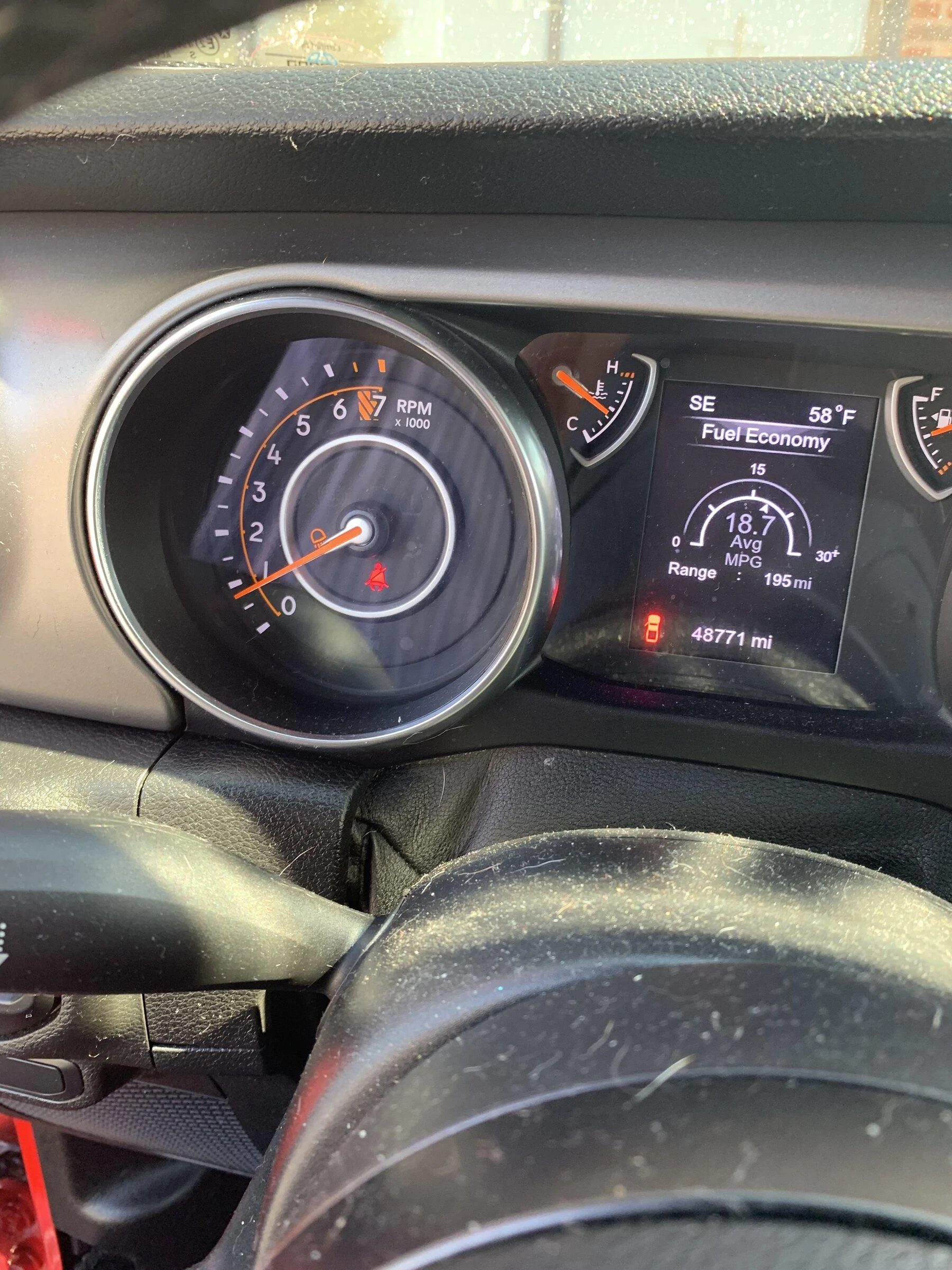

Had my heigh 10 in since June and this past weekend the back up camera stopped responding saying “operation unavailable start engine” except the engine is running…I updated the stinger firmware but no change. Thoughts or similar experiences?

My camera has been finicky since day 1. Including on the factory head unit. It will randomly decide not to work but it usually comes back after a restart. Part of the reason I upgraded. I thought it was in the crappy 5” mopar unit and that upgrading would fix the issue. Neither the pioneer with the maestro interface not the stinger has fixed it. So it must be something with the cam. Unfortunately, since I upgraded I don’t believe the dealership will fix under warranty as they will likely blame the stinger and im not gonna un/reinstall again, lmao.

This could be resolved with a firmware update on the CH4A-JW18 module itself if you only updated the HEIGH10.
Go to Advanced Vehicle Features > Installer Settings and check that v14 is installed on the module.
If you have already done that or continue to have issues, give us a call at (727) 732-3114 and we can troubleshoot with you.
