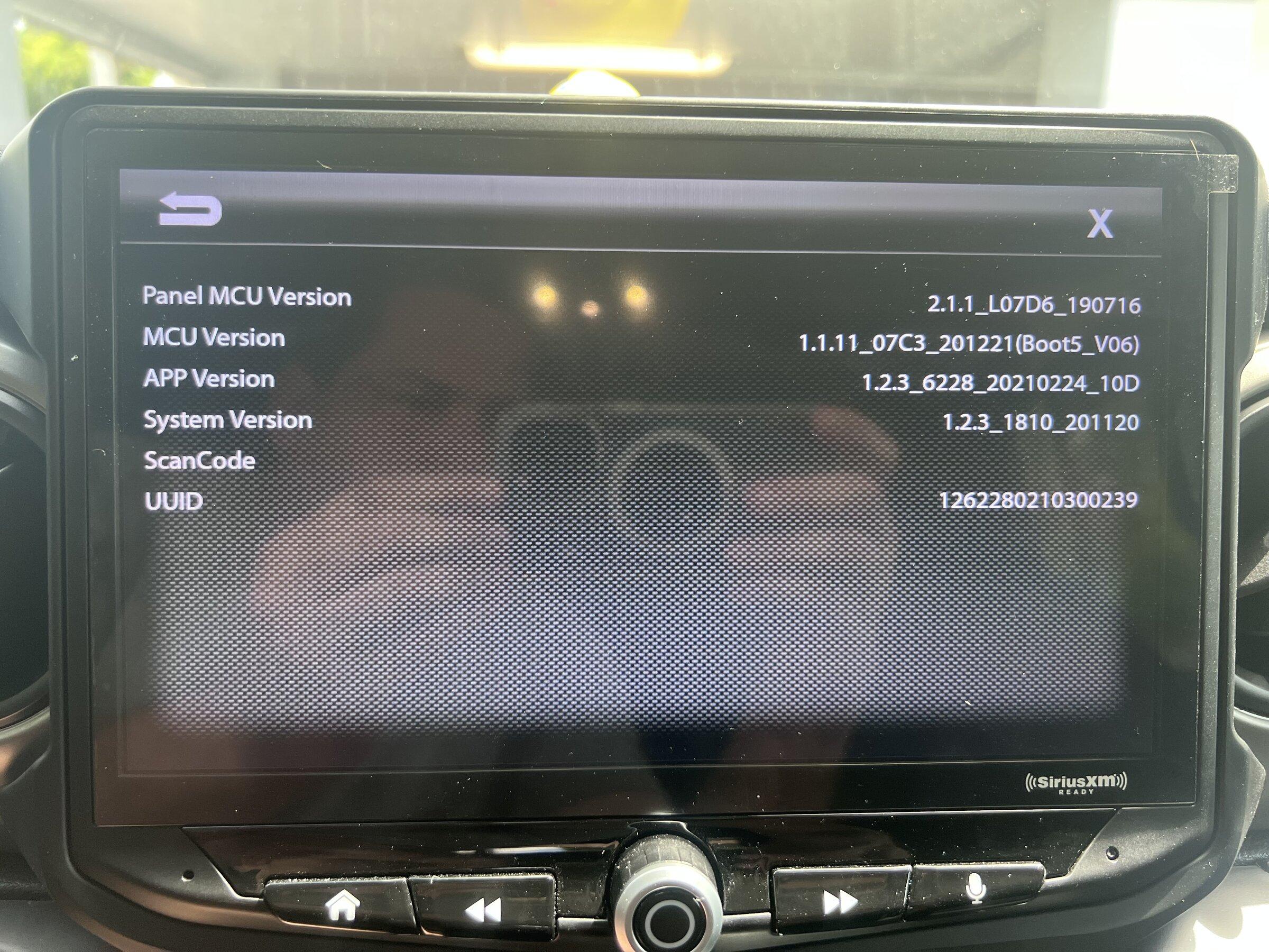

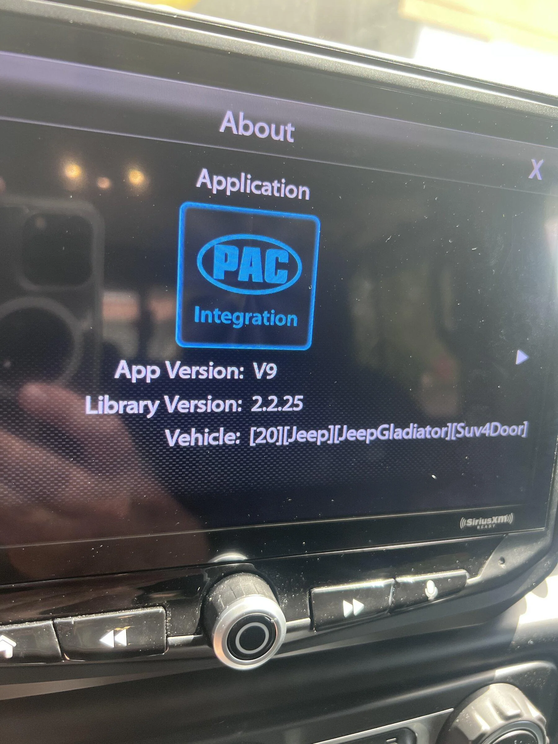

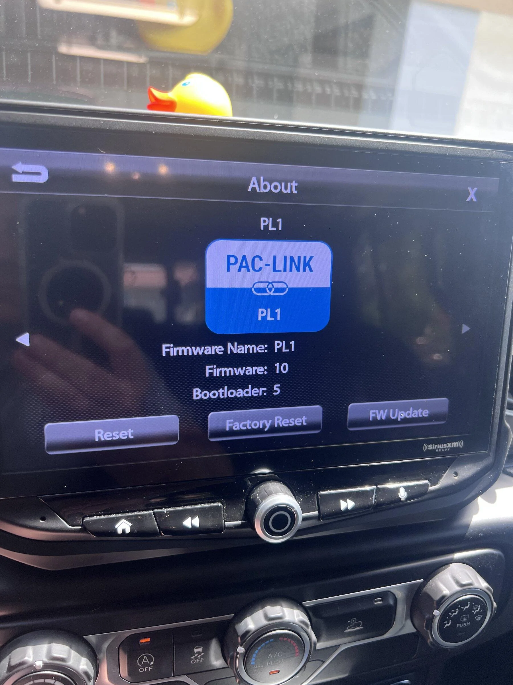

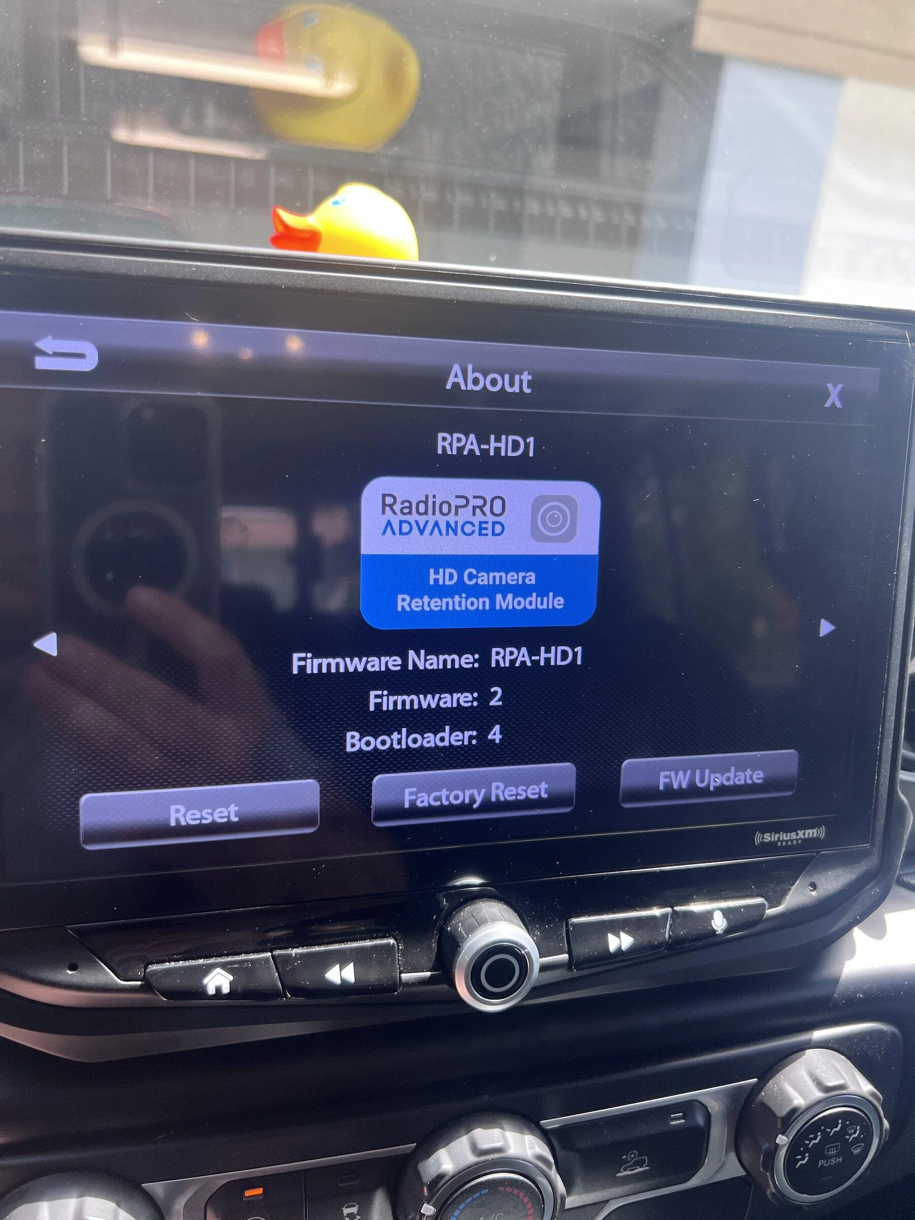

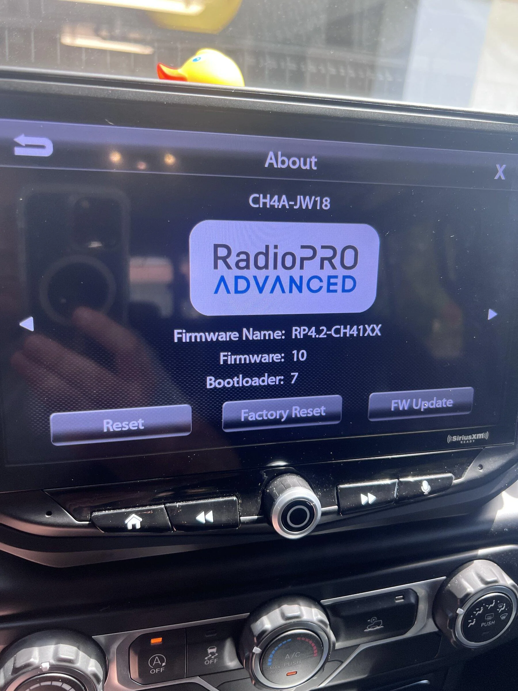

Anyone have luck updating? My backup camera stopped working, I hooked up my stock radio and the camera is fine. Seems to be a issue with the pac hdmi part. I’m looking at pacs website and did the overall jeep specific update, but was told the “ CH4A-JW18 interface” also needs to be updated
Jeep Gladiator Stinger Off Road 10” Radio Replacement FE2F6380-370B-467F-8B17-0EBDD1670347
Jeep Gladiator Stinger Off Road 10” Radio Replacement C6A61A57-30F7-4D4F-9AF5-5620E258CA01
Jeep Gladiator Stinger Off Road 10” Radio Replacement EDC33726-4694-4053-808B-8CB8145E0D36
Jeep Gladiator Stinger Off Road 10” Radio Replacement D4644177-EB36-4585-8AD7-4808675130A9
Jeep Gladiator Stinger Off Road 10” Radio Replacement BD8445CF-8088-4C59-86AB-F95FEF5C0BE8
Mike - Stinger Off-Road
Oct 5, 2020
46
Clearwater, FL
stingeroffroad.com
2006 LJ Rubicon, 2020 JT Gladiator Sport S
Automotive Electronics
Hey Joseph!
It looks like the interface will need to be updated to Firmware 14.
You will need to connect a micro USB directly to the CH4A-JW18 module in the dash to update it.
  1. https://pac-audio.com/firmware-updates/
  2. Under "select a product" choose the SRK-JW18EH
  3. Then download both the RadioPRO software and the v14 firmware file for the JW18
  4. Install the RadioPRO app on the PC (will not work with a Mac or Chromebook) and connect the CH4A-JW18 to the computer. Open RadioPRO and choose update. Reference the v14 firmware file downloaded
  5. Do not disconnect the unit until you get the "update completed" message, even if the progress bar is all the way across and doesn't appear to be doing anything more. *Very important
If you run into any issues, feel free to give us a call at 727-592-5991.
