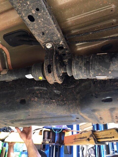

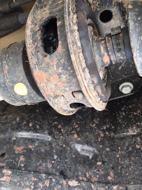

I purchased an Overland Gladiator in June 2020. Only modifications on it are Rubicon take-off wheels and shocks, and a 1.5 inch spacer leveling kit in the front. I have done some light off-roading maybe 5 times since I purchased the vehicle. It is always low speed on dirt roads, nothing too extreme.
I recently started noticing the car would vibrate at certain speeds 20-25 mph. Similar sensation to driving on a rumble strip. Initially I thought i had a wheel balancing issue, but earlier this week, I was driving on the highway at 60 mph and the vehicle started vibrating and rattling noticeably louder than any of the times before. After this point, the noise was consistent and seemed to be getting worse. I managed to hobble to the dealership.
After a few days, the service department contacted me saying that my driveshaft was damaged and needed to be replaced. They are saying that they cannot cover it under warranty because the modifications may have caused the issue, citing that the new angle put may have put stress on the driveshaft.
I saw there is a recall on the gladiator driveshafts units that were assembled without grease. I did a VIN lookup and my vehicle is not listed under this recall.
I attached some photos of the damage. Is the service dept. blowing smoke, or is this damage probably my fault?
We're very sorry to hear of these concerns you're experiencing! Our team would be happy to discuss further with you, although we cannot guarantee any certain outcome here. Just send us a PM to get started.
