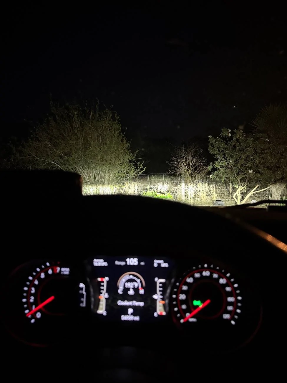

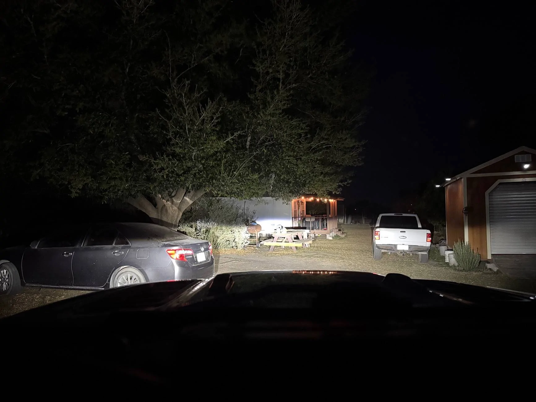

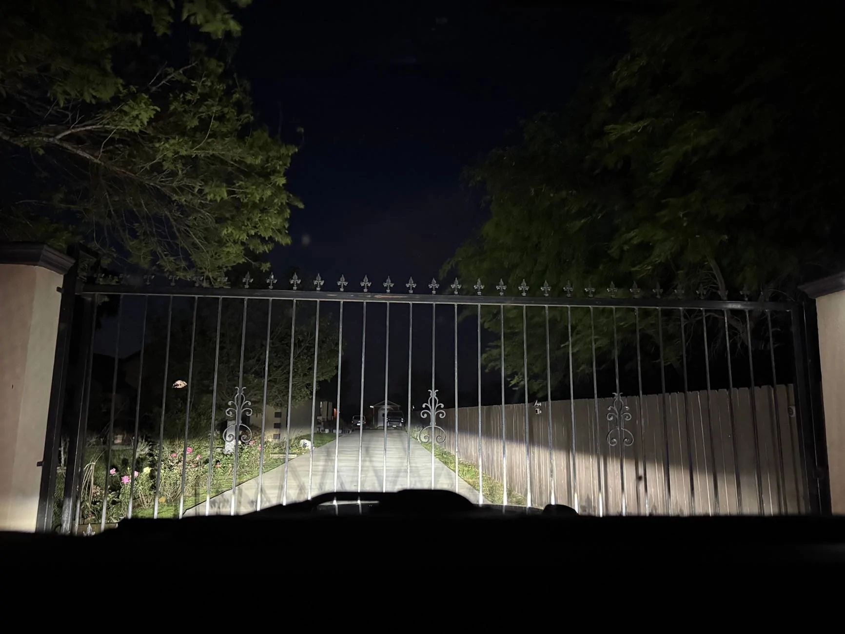

Well I guess I have the only pair of headlights with light that spills above the cutoff.
Jeep Gladiator Stock High Beams are Unimpressive IMG_8901
Jeep Gladiator Stock High Beams are Unimpressive IMG_8902
Jeep Gladiator Stock High Beams are Unimpressive IMG_8905
