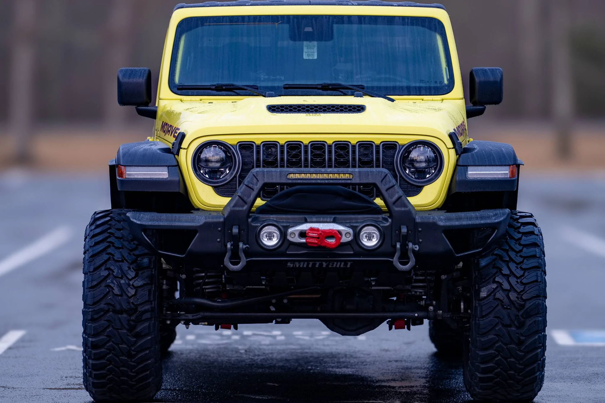

If you're planning to lift rear only - this might help your aiming problem (think "Starsky & Hutch").
As for shocks are they stock? How much shaft you have showing sitting level?
It sits perfectly level now. I would prefer about 1" of rake.

That shot is perfect! Looks dead level. I wouldn't change a thing.
