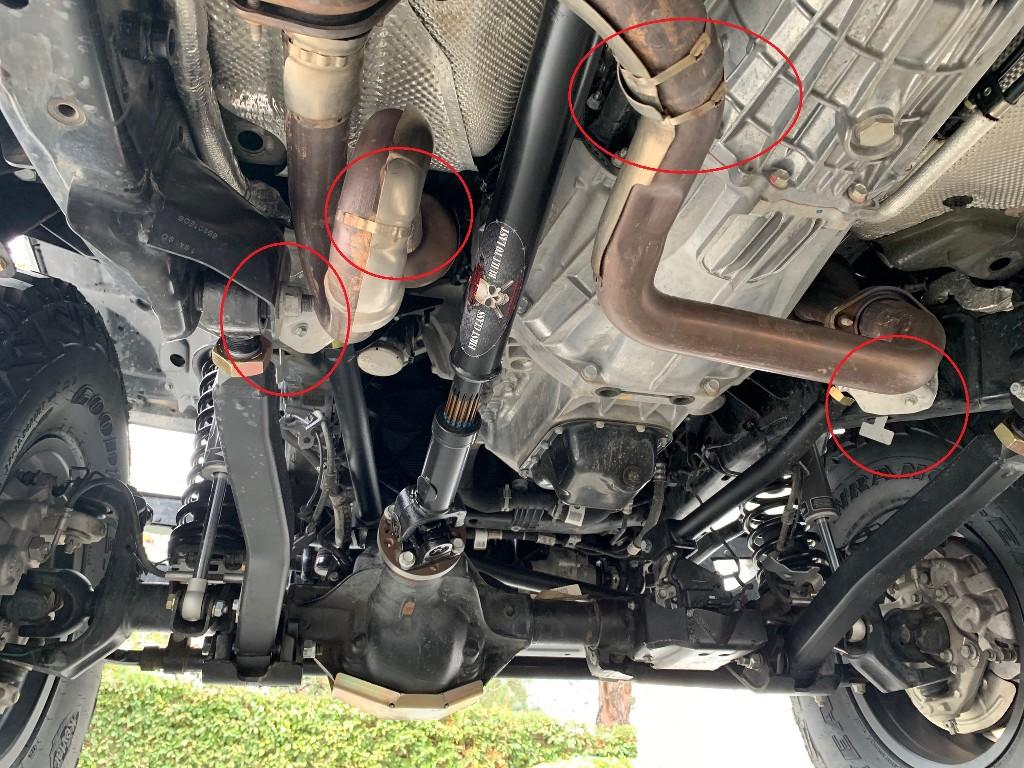

If you feel like crawling underneath, here are some heat shield spots that could be loose. The upper control arm heat shield are being held on with two 10 mm bolts and the exhaust pipe heat shield are held on with hose clamps.

Thanks ! Working late tonight but I'm gonna check it out tomorrow..
