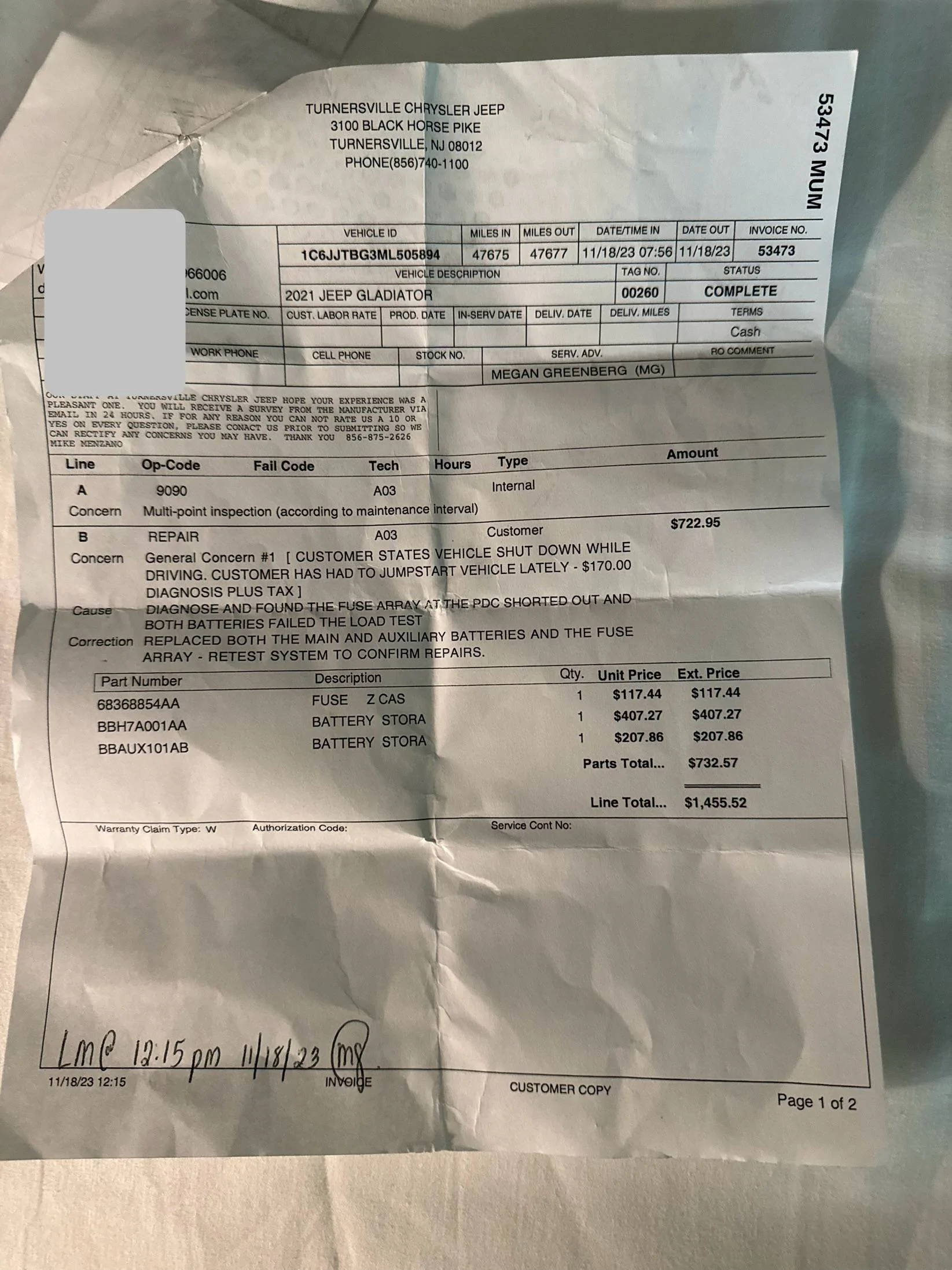

That Damn ESS cost me $1500. Here’s my invoice…
Jeep Gladiator Stupid ESS System IMG_0221
That's not the ESS. Clearly shows the batteries were junk.

As said, it's the batteries in these that go bad. The system isn't the issue, it's the batteries.
I know it's more convenient to blame ESS, but it's not the truth.
You say ESS, but nowhere does your invoice say they did anything to the ESS. You had two bad batteries and the dealer hosed you on the cost of them. Not sure how much a fuse array costs, the batteries I would have bought elsewhere.
