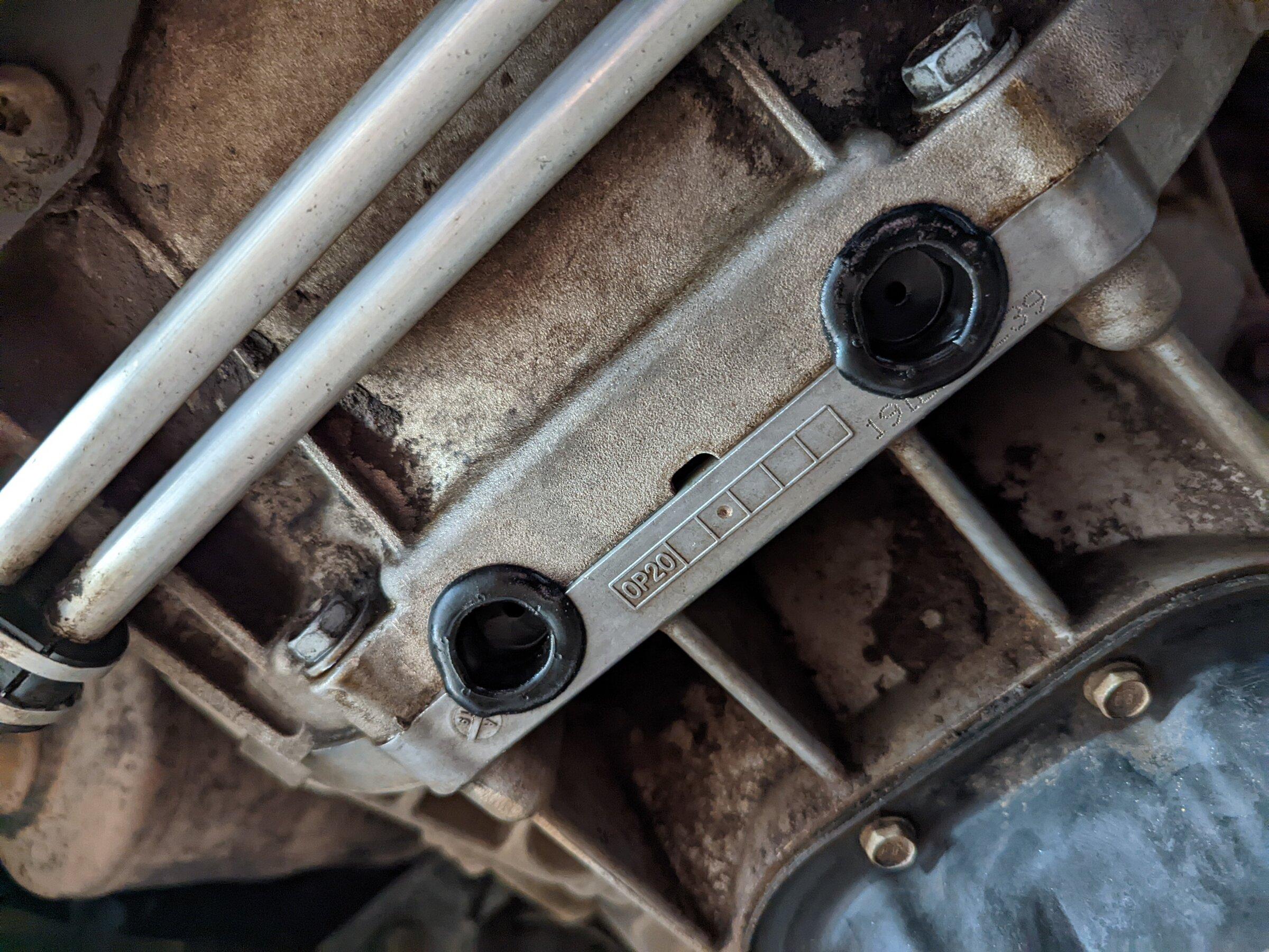

Yeah I would like to see a picture of the 3.6 rear main. from what folks here are saying it must not have any protection at all but that seems really weird design
This?
Jeep Gladiator Sunk it but winched out PXL_20220419_212217634

The actual rear main seal itself - the actual seal at the back of the crankshaft.
As far as those plugs, if the holes were pretty evenly round, a person could buy nice plugs from Amazon and close those two holes up.
Odd that dirty water with grit gets up in there with those in place. That center weep hole would allow grime and water up inside the bell housing area, of course, and let it get to the back of the crankshaft.
That this is happening at all is WEIRD.

For those plugs to be that bad, they'd have to almost fall out. Even if they wiggle a bit, they'd block out sand or anything very large at all and let in only very very very fine stuff.
The weep hole between them is about the only way most stuff could get in if the factory plugs were in place.
But it would be simple to find plugs that would actually seal off those larger location holes. Likely I have some in my shop as a lot of stuff I get has plastic and rubber plugs in and on hydraulic hoses or pumps or other stuff. I suspect the plugs I used to fill the sensor holes in my front bumper would work if they were the right size.
