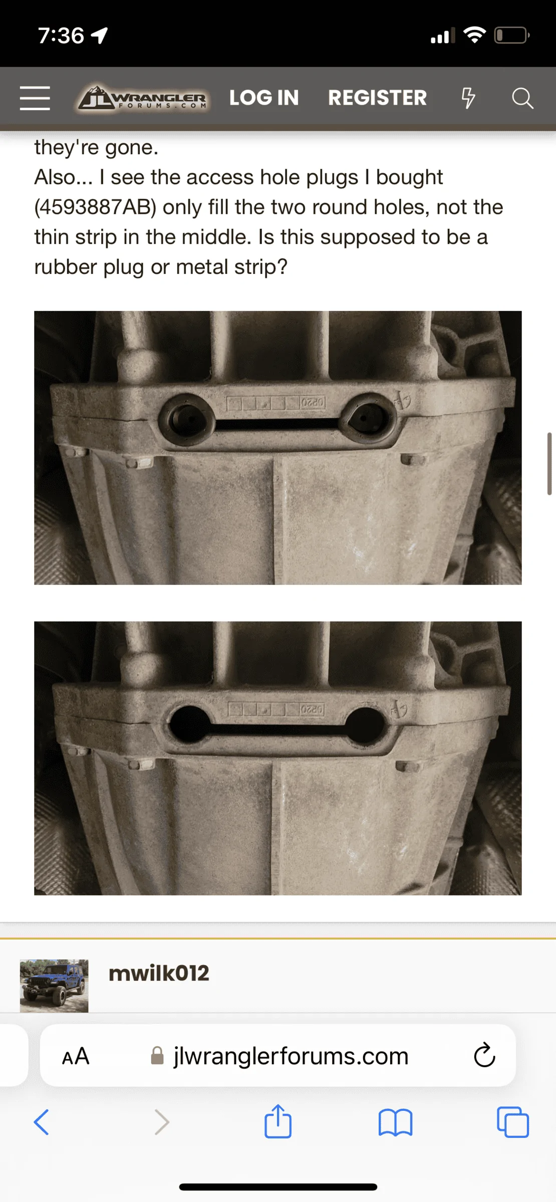

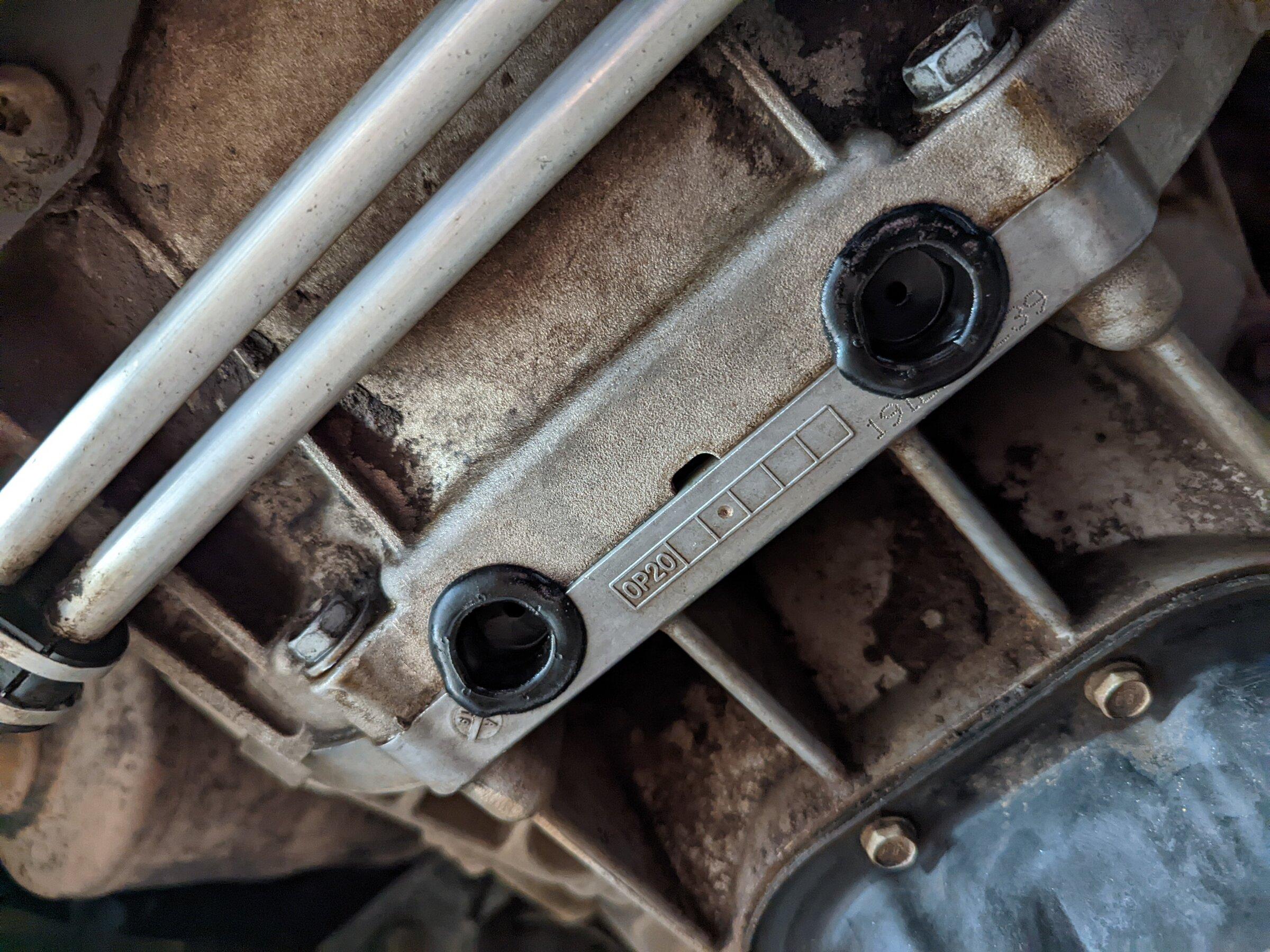

FWiW, there are two rubber plugs at the bottom of where the engine and transmission mate. These are apparently Jeeps answer for preventing any and all foreign substance intrusion. If these are/we’re missing on your truck, then water/muddy water/mud could have gotten in this area and can destroy the seal on the transmission where the torque converter is installed. This can cause a leak as well.
Are these plugs visible from the outside?

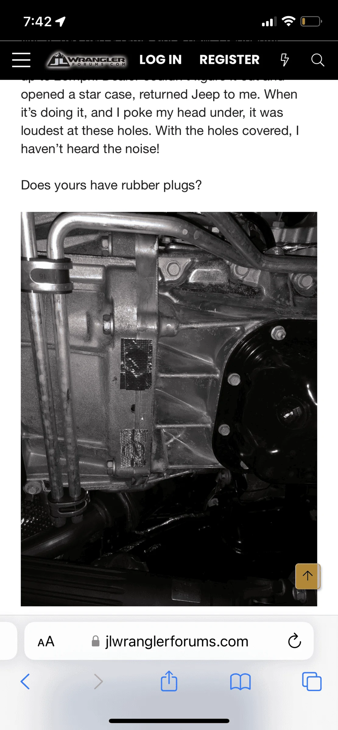

Mystery solved for all. The plugs in the bell housing are nothing more than protective covers for posts the casing is placed on in production. See the pics. After I get mine back the plugs are out and the taping begins. I wheel this things. Can’t have muck all over the flywheel every time I take it out.
