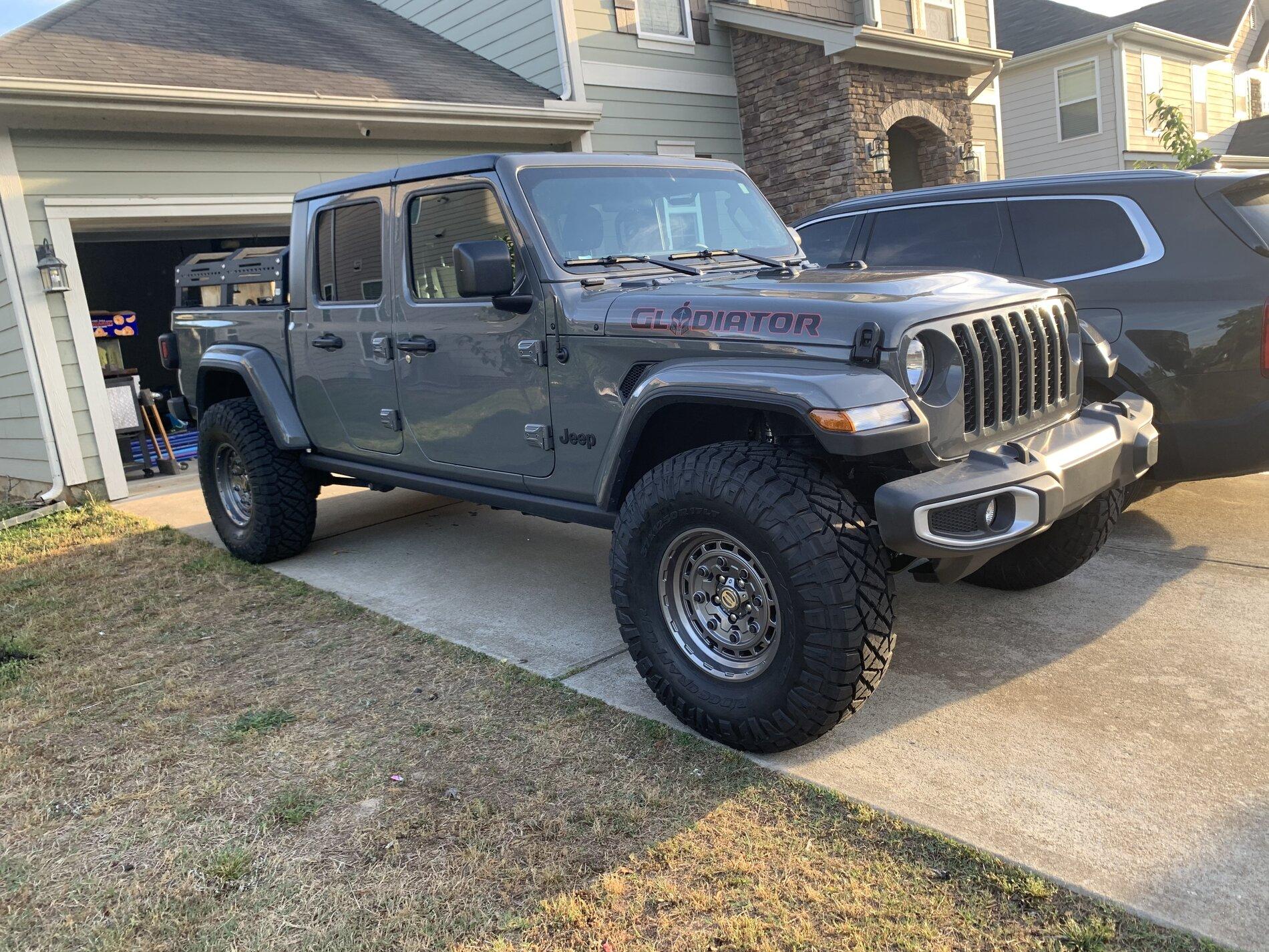

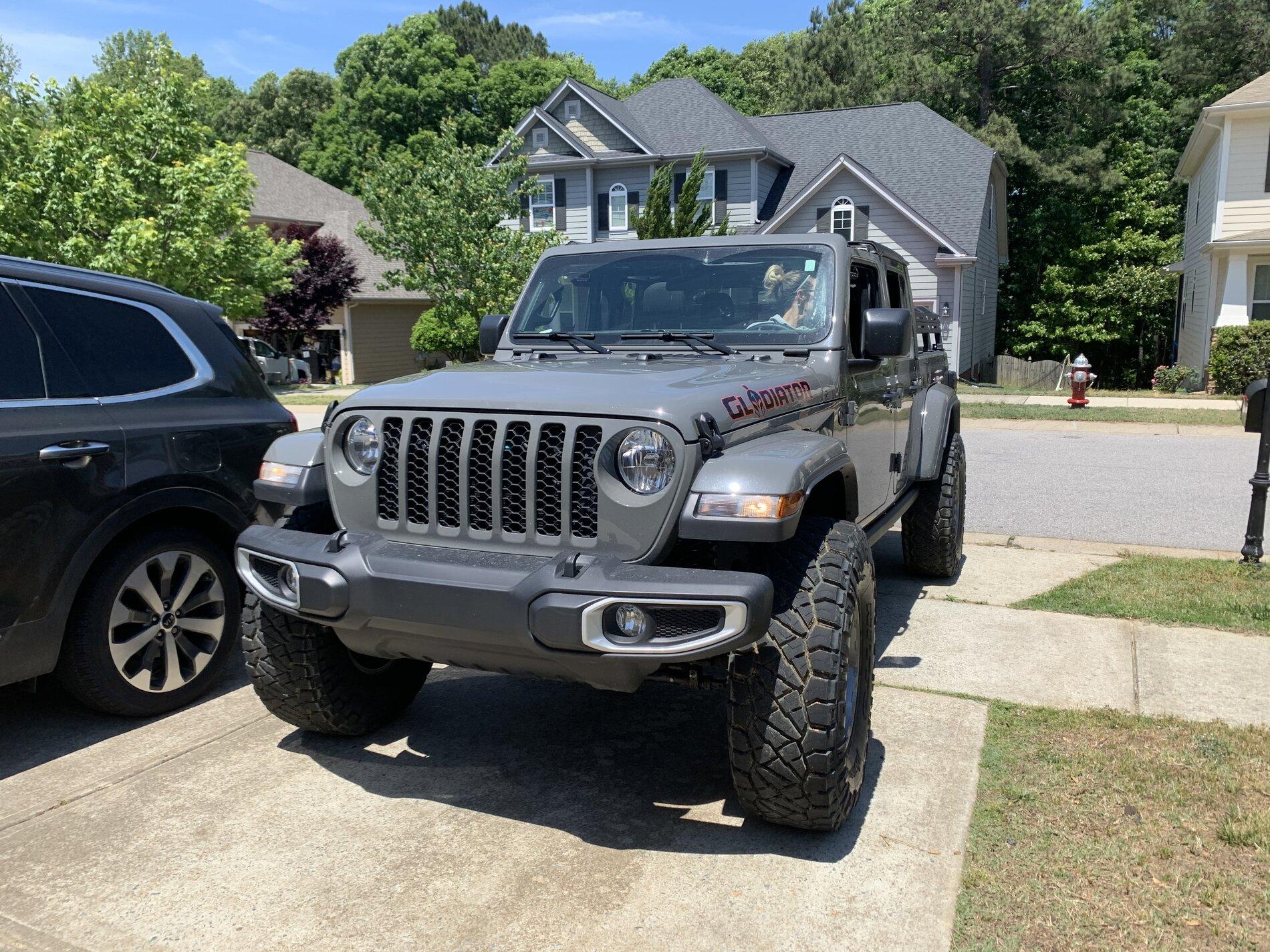

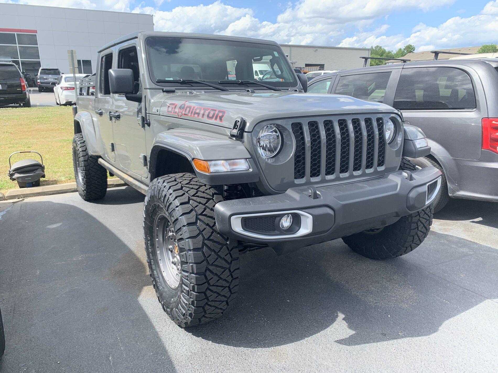

Thank you sir. I went with Nitto Ridge Grappler 37's in Warn Jackhammer gunmetal grey wheels. Lift and tires are being installed on Tuesday so I will have pictures to post next week.
Thank you all for your help!

So that is actually what Isettled on as well. Went with Mopar 2" since I opted for the additional warranty when I bought the truck so figured I would go with the Mopar lift instead of the RK kit. Iabsolutely love how it turned out!!
