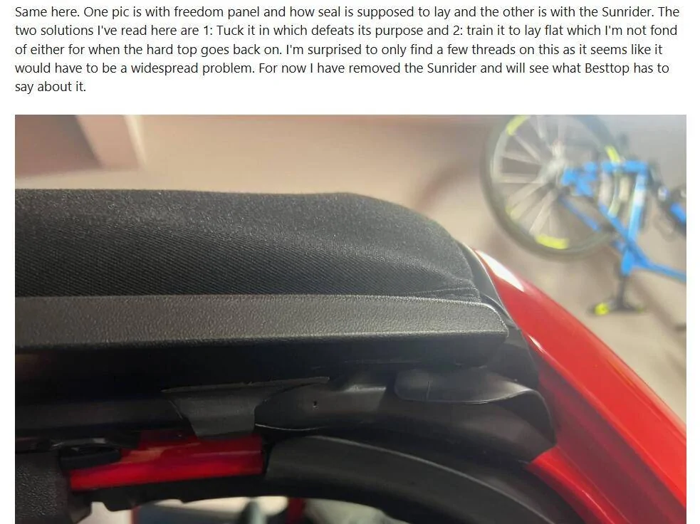

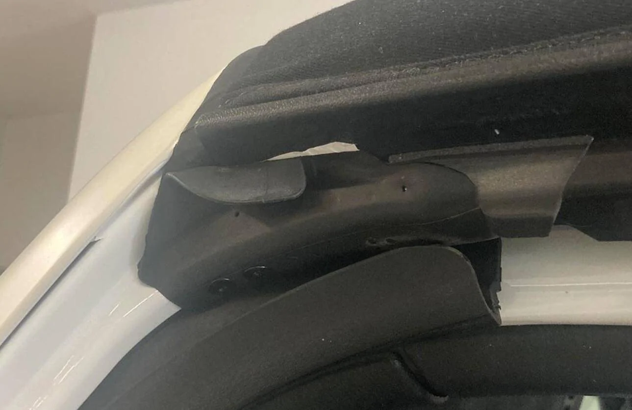

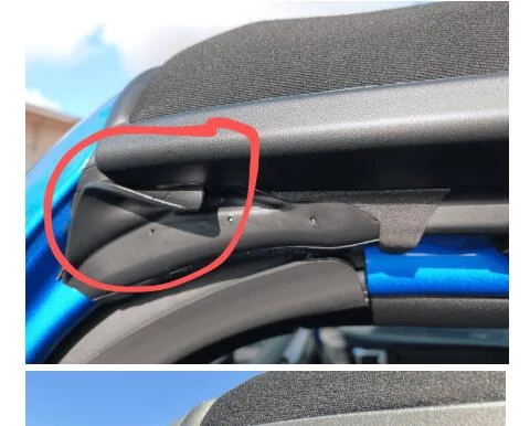

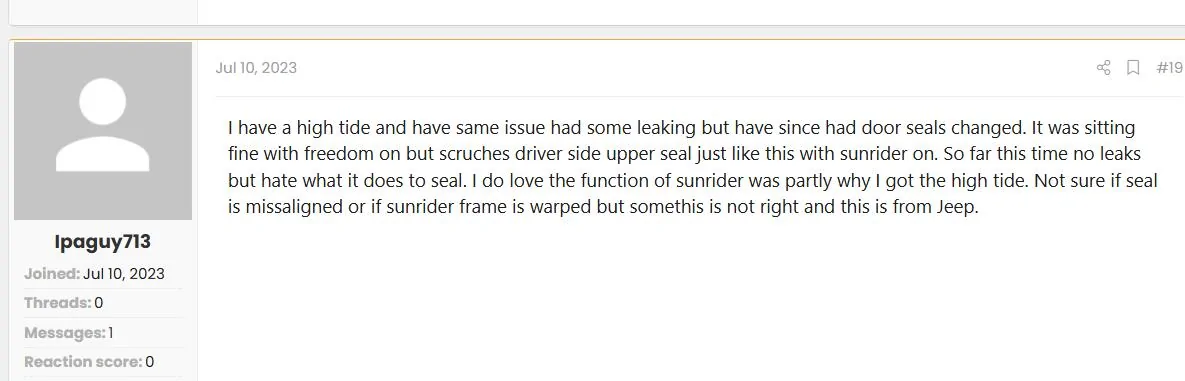

Didn't take long to find several others with the same thing - and the response they got was - nothing.
Jeep Gladiator Sunrider owners - MY mess-up, or theirs? 1751575767803-k7
Another Wrangler owner -
Jeep Gladiator Sunrider owners - MY mess-up, or theirs? 1751575831960-di
Jeep Gladiator Sunrider owners - MY mess-up, or theirs? 1751575918842-2

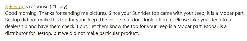

And here's what everyone has been wondering - Bestop says they do NOT make these for Jeep. (likely they don't even make their own, but that's a different animal)
Jeep Gladiator Sunrider owners - MY mess-up, or theirs? 1751576101681-j6
Still, some of them ARE Bestop branded tops - so this is one case where it is not and they wash their hands of it.

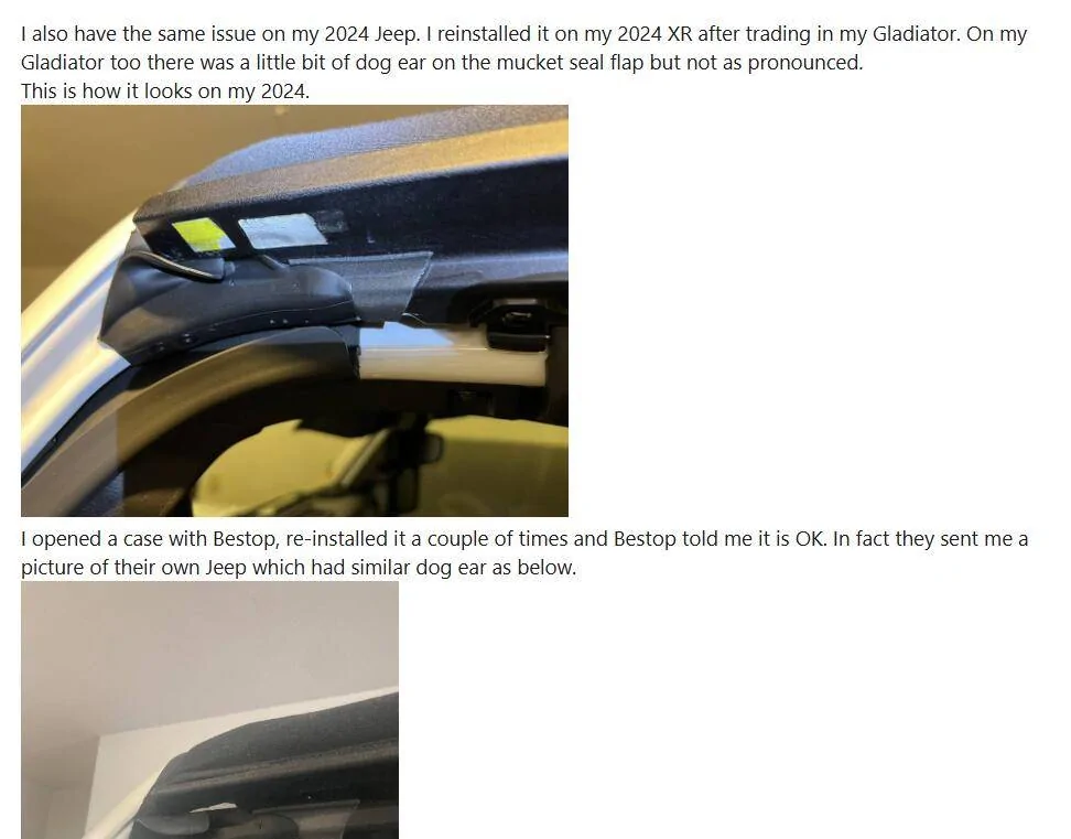

And here's my proof it happens even with the Bestop branded units -
Jeep Gladiator Sunrider owners - MY mess-up, or theirs? 1751576217496-0q
However, their response to that person is pure bullshit. That is NOT ok, it distorts the seal, ad in my case, it cuts the seal.
The person from Bestop even told me "that's not right".
So one of them is lying - one said "it's fine" and another said "it shouldn't do that".
Which is it.
And no, talking out of both sides like that, no, I'm not being hard on them.
They should give one clear answer. The seals are made that way on purpose, what has happened is that Bestop has sat back and ignored the fact their tops sit too low, made more evident by the fact that it distorts seals and totally defeats the Jeep water control system there.
Rather than fixing the issue they've had all along, but was just brought to the top by Jeep putting those seals on 22 and later Jeeps - they are not making any changes and telling people whatever the person at Bestop decides to say at that time.
They can't have it both ways.

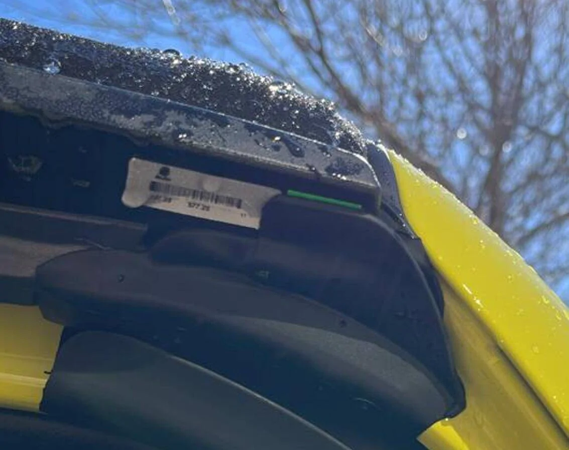

Check it out - the picture above Bestop says is ok vs. the picture they sent me showing "this is how it should fit".
This is their "this is how it should fit" picture -exactly what they told me -
Jeep Gladiator Sunrider owners - MY mess-up, or theirs? 1751576585618-5h
Another Bestop person told the other fellow, sending him this picture - this is ok, don't worry about it - and yet this goes back to 2020 where if you open the door you will get water dumped on you because that mucket can't function.
Jeep Gladiator Sunrider owners - MY mess-up, or theirs? 1751576659144-sn
That's my problem with Bestop - one person says it's fine, another person says no, that's not fine and no, don't tuck the seals.
One of them is wrong. (the first one - it's not fine)
