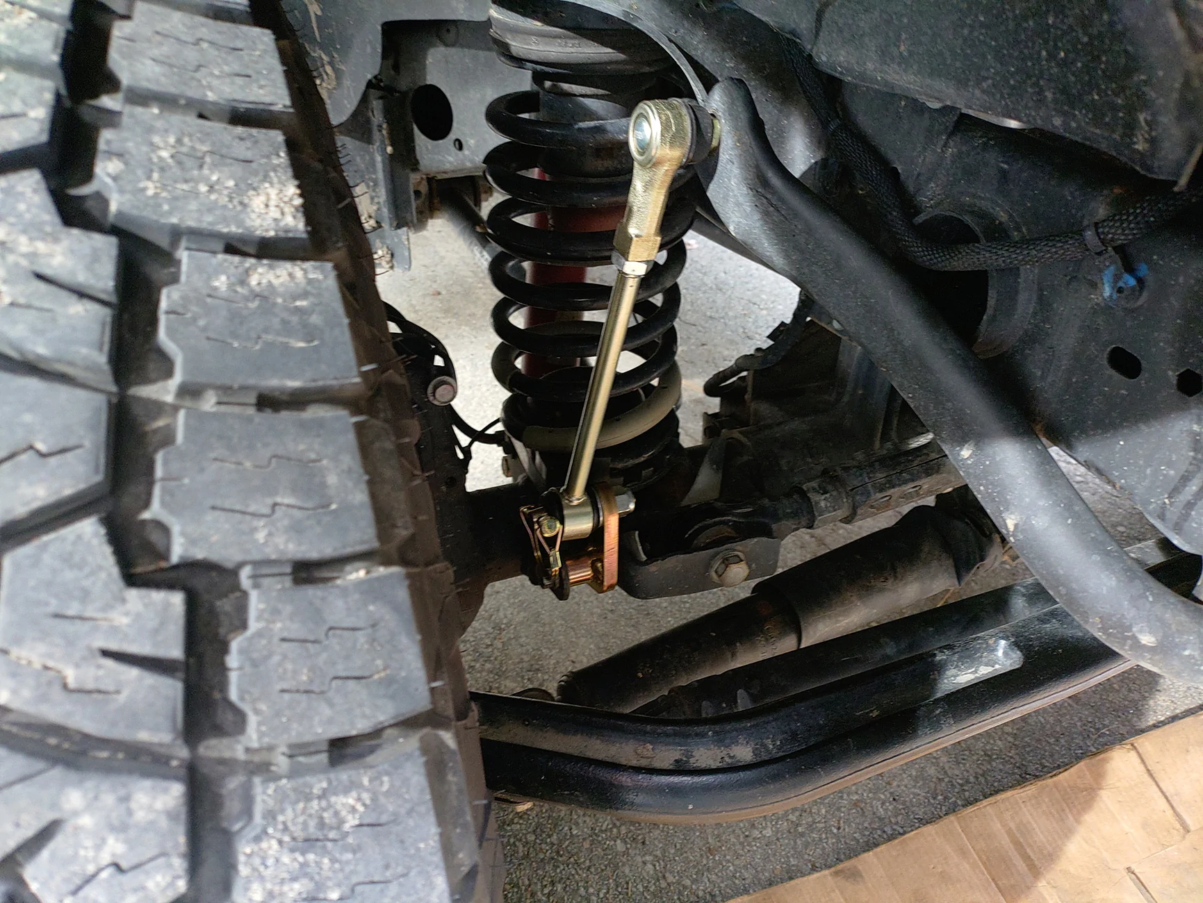

well the tera flex rear sway bay links defiantly flex I replaced them with metal cloak ones

Sway bar still straight?
Pat and I got home around five tonight from our great adventure , lobster eating , Jeep beating trip…..Jack
yes sway bar was fine ..rear end felt "loose" on the ride home kinda glad we didn't try MT Washington Sunday morning! I put the new links in yesterday and it tighten everything back up

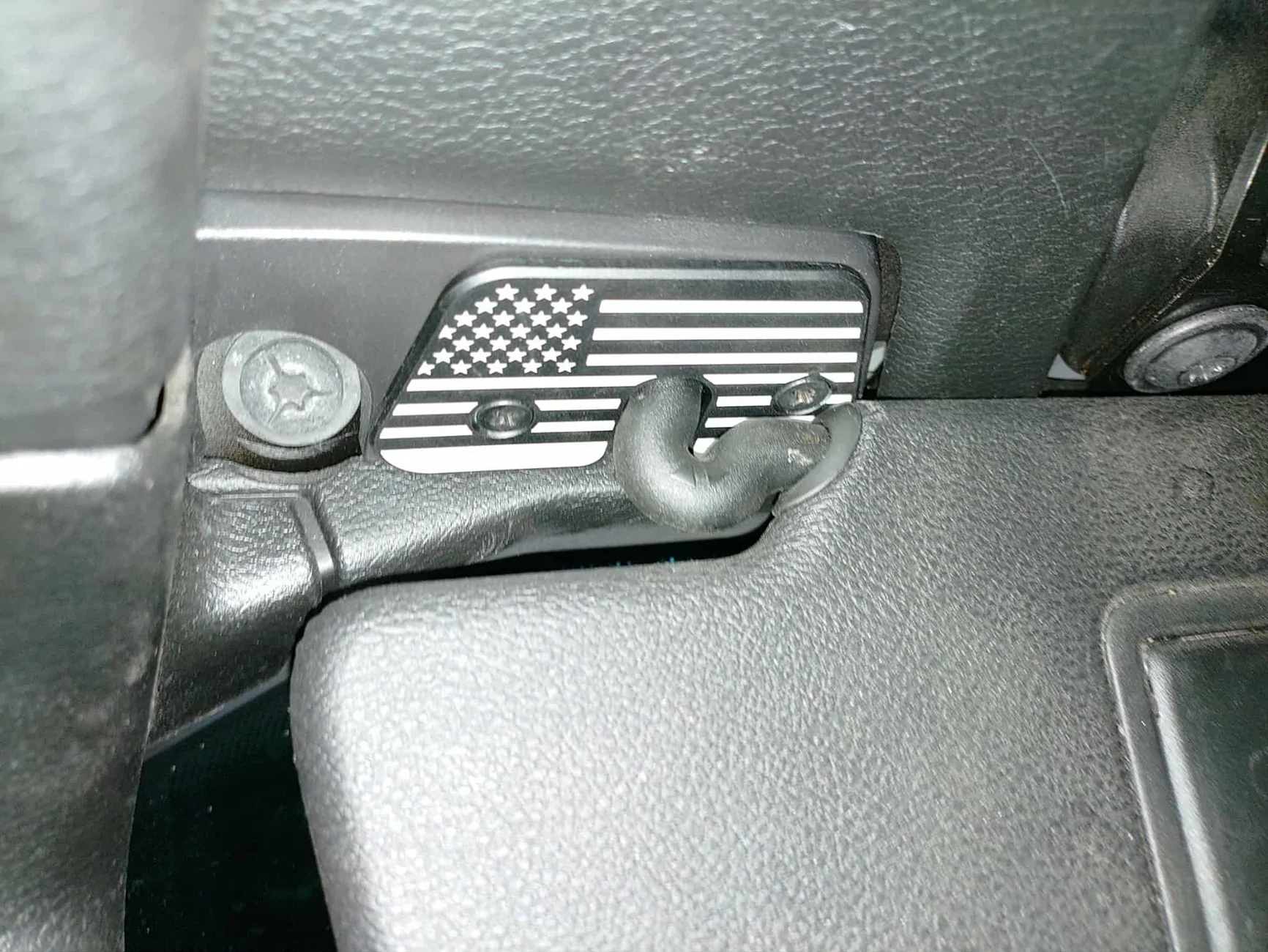

added visor reenforcments

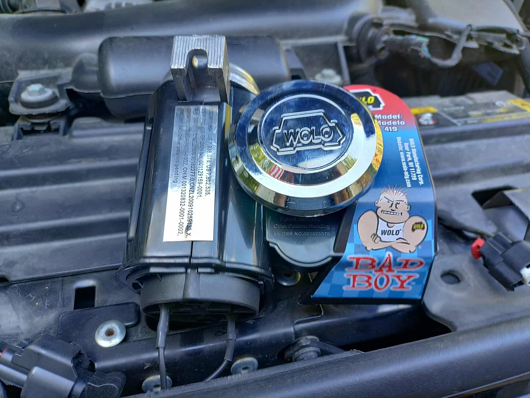

So I finally fixed the week sounding jeep horn, I bought the horn a year ago never got to installing it it is a: Bad Boy Model 419 12-Volt 123.5 Decibels 530 / 680 Hz
and I have one in my suburban and Mini Countryman its virtual a compact train horn. I it bought at Harbor Freight with coupon

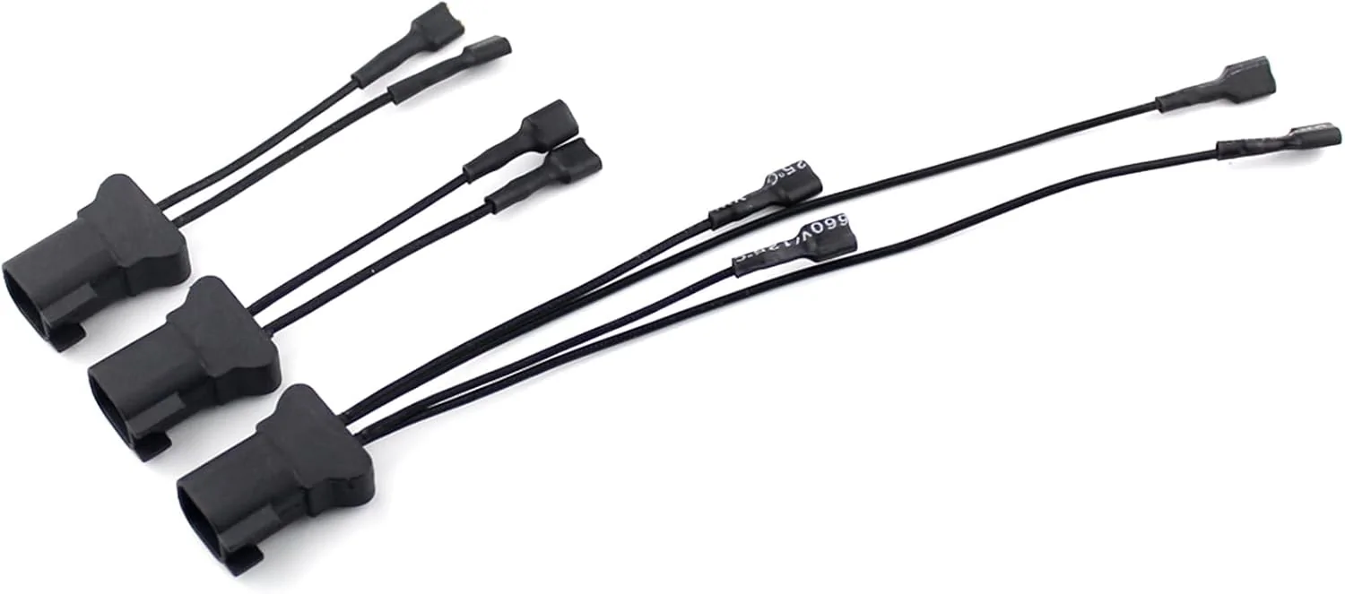

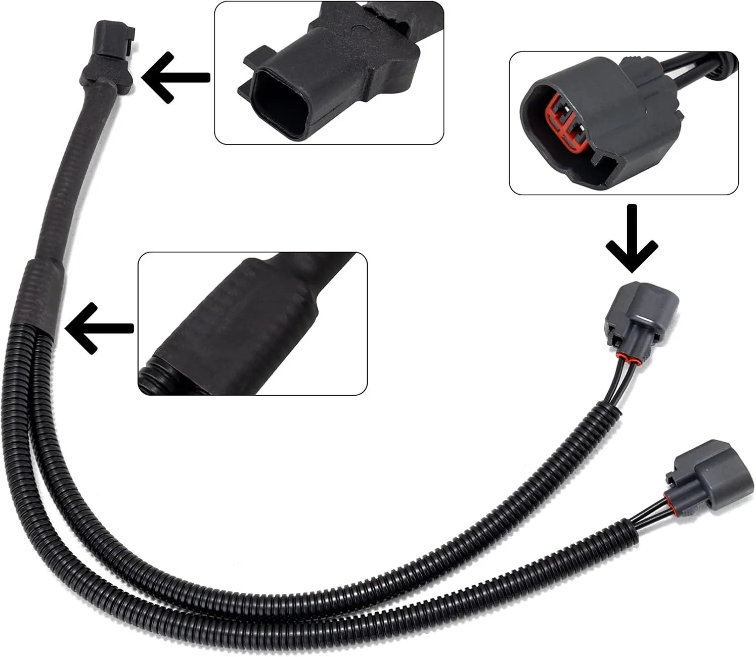

So what had been holding up this mod is I didn't want to cut up the jeeps harness and it seemed no one sold a JT /LJ horn harness
After some research I finally figured out jeep and ford share the same horn plugs, armed with that I was able to search for connectors, while scouring the Jungle site I found that Farbin sold pig tail adapters, I could just unhook a horn and it plug in
FARBIN Car Horn Special Plug Compatible with Ford Adapter Converter Wiring Harness Pigtail Socket Car Horn Connector Harnesses Cable 3Pcs
Jeep Gladiator Supazuk's journey to the Dark side build.... The "DeceptiCON" 1757706074617-of
That would have been fine, I could have snipped the ends made an extension and had my loud horn ......
However, when i added to cart i noticed Farbin had other options on the same page. I found it! a y splice for the horns now jeep horn and the loud "train horn"
FARBIN 1 to 2 Horn Adapter Connector for Ford, Y Type Horn Connector Converter Wiring Harness, Plug and Play
Jeep Gladiator Supazuk's journey to the Dark side build.... The "DeceptiCON" 1757706128330-22

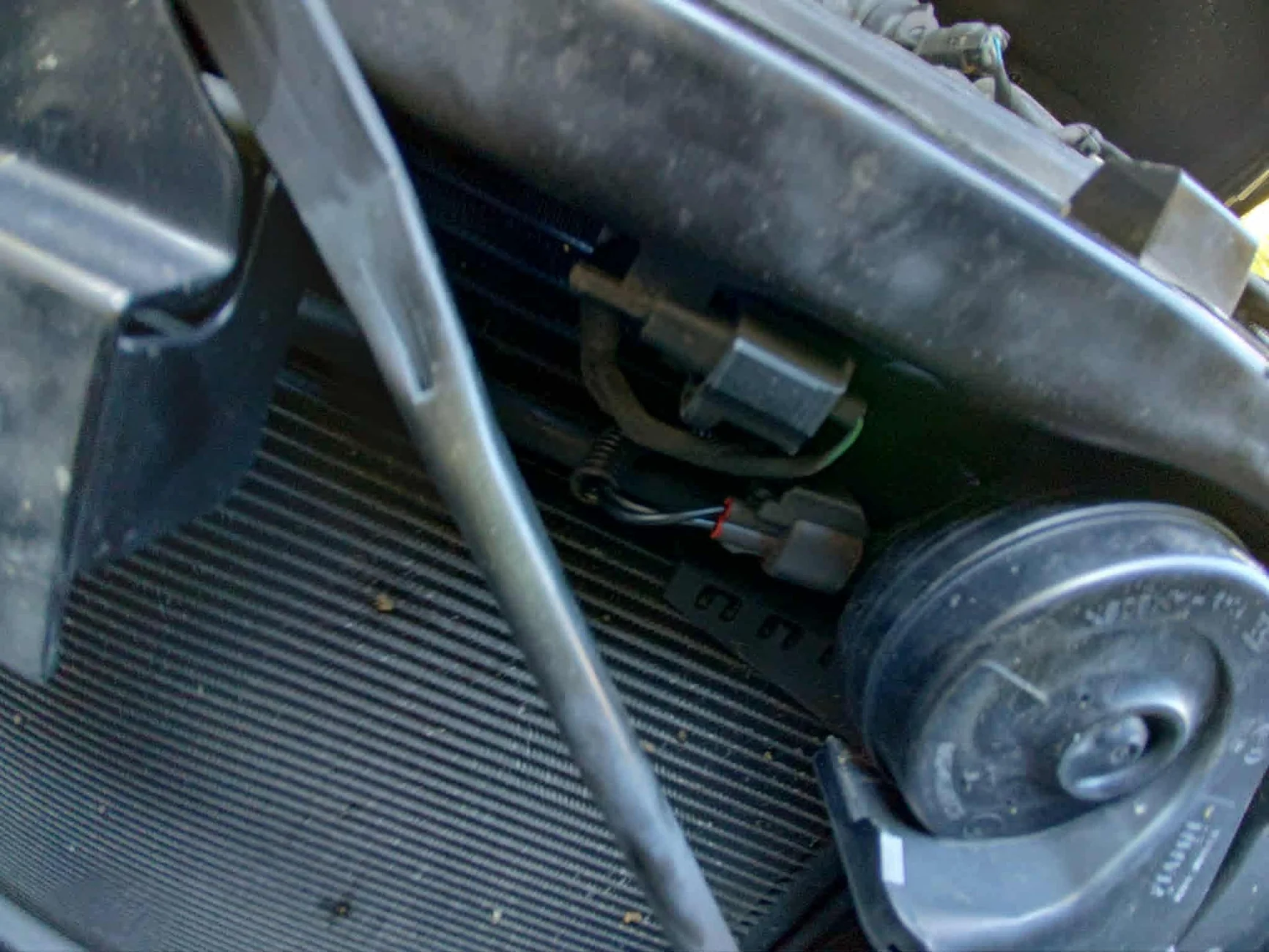

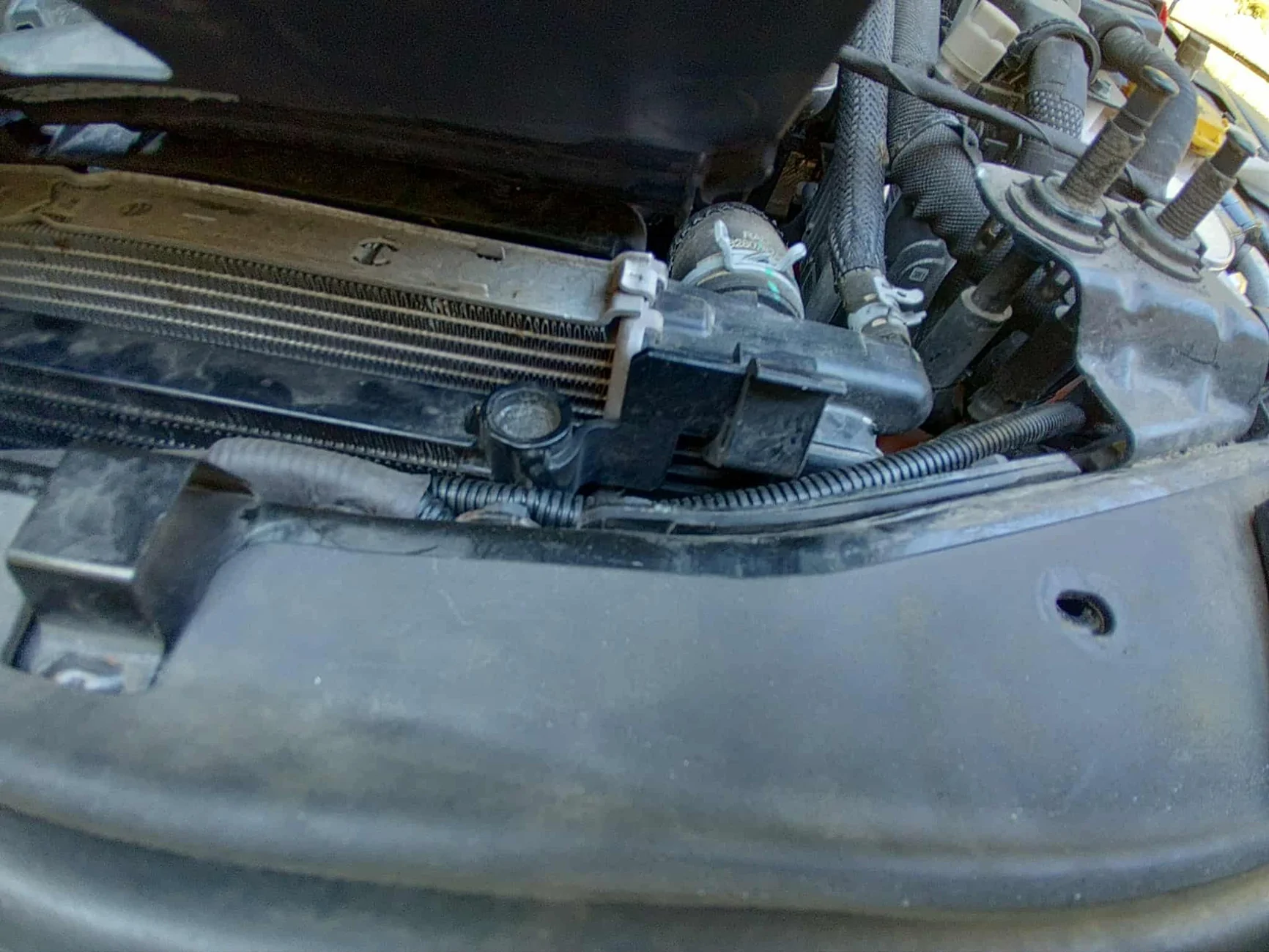

So Today was the day first I had to find what wire was the positive and negative ...easy
- pulled out the grill plastic rivets and laid back the grill, winch is on so taking it off would be dumb also I could have left the grill unhooked with a pick and long screwdriver but then could not get pics of the connections for that forum write up

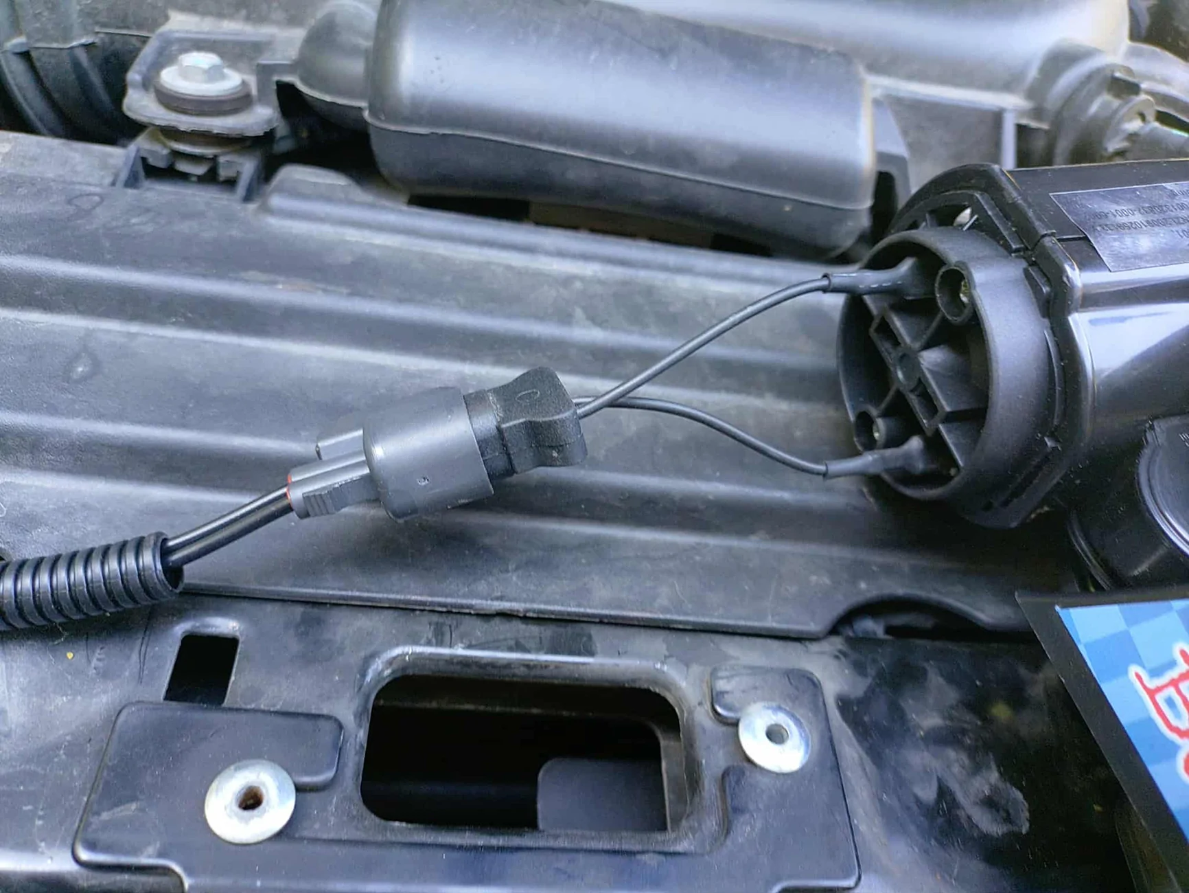

-unhooked both (don't want to piss off the neighbors) and plugged the adapter in
-used a test light to figure out positive and used a paint marker to mark it

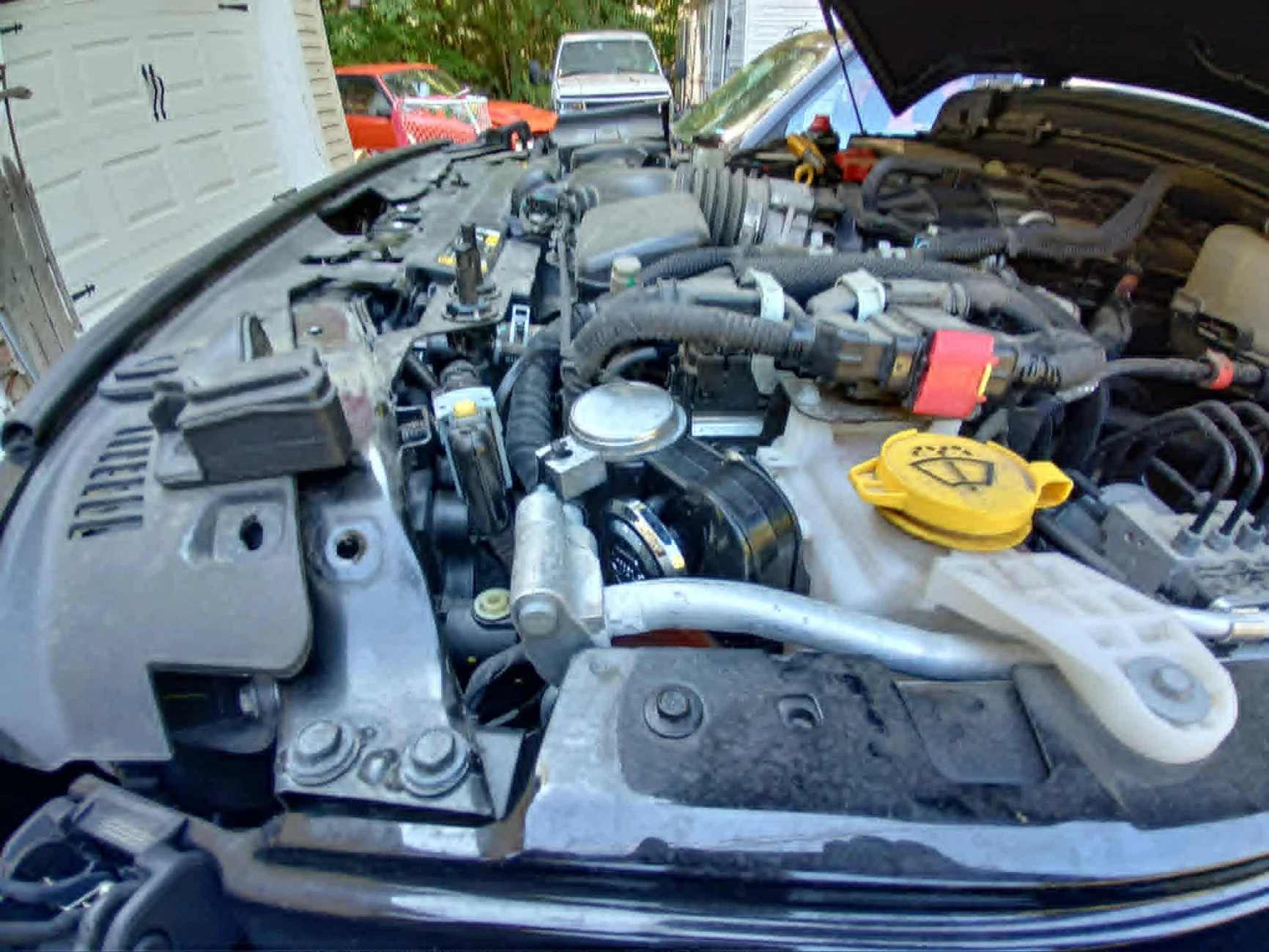

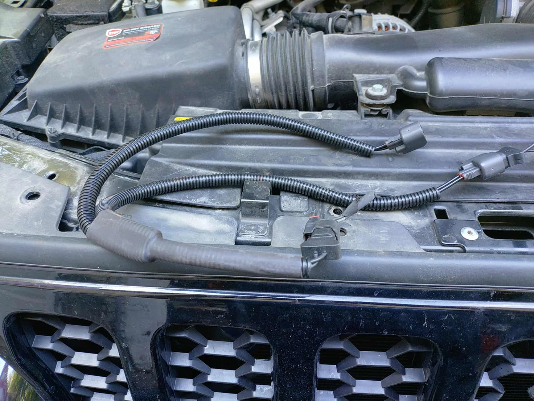

now for the harness
Jeep Gladiator Supazuk's journey to the Dark side build.... The "DeceptiCON" horn3
Both horns connected and all the wires hidden away
Jeep Gladiator Supazuk's journey to the Dark side build.... The "DeceptiCON" horn5
the only question was where to put the Bad Boy well that fell right into place and fit so well all I had to do was a quick zip tie an put the plastic rivets and grill was back in .... Now off to the mall to scare Old lades and soccer Moms!!!

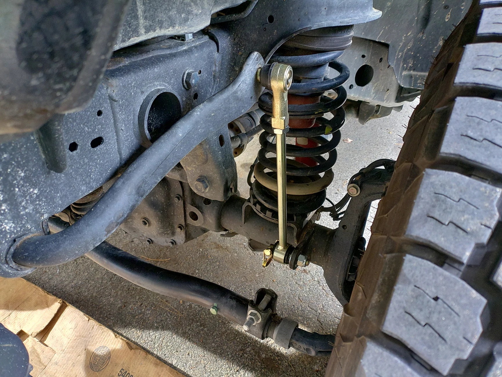

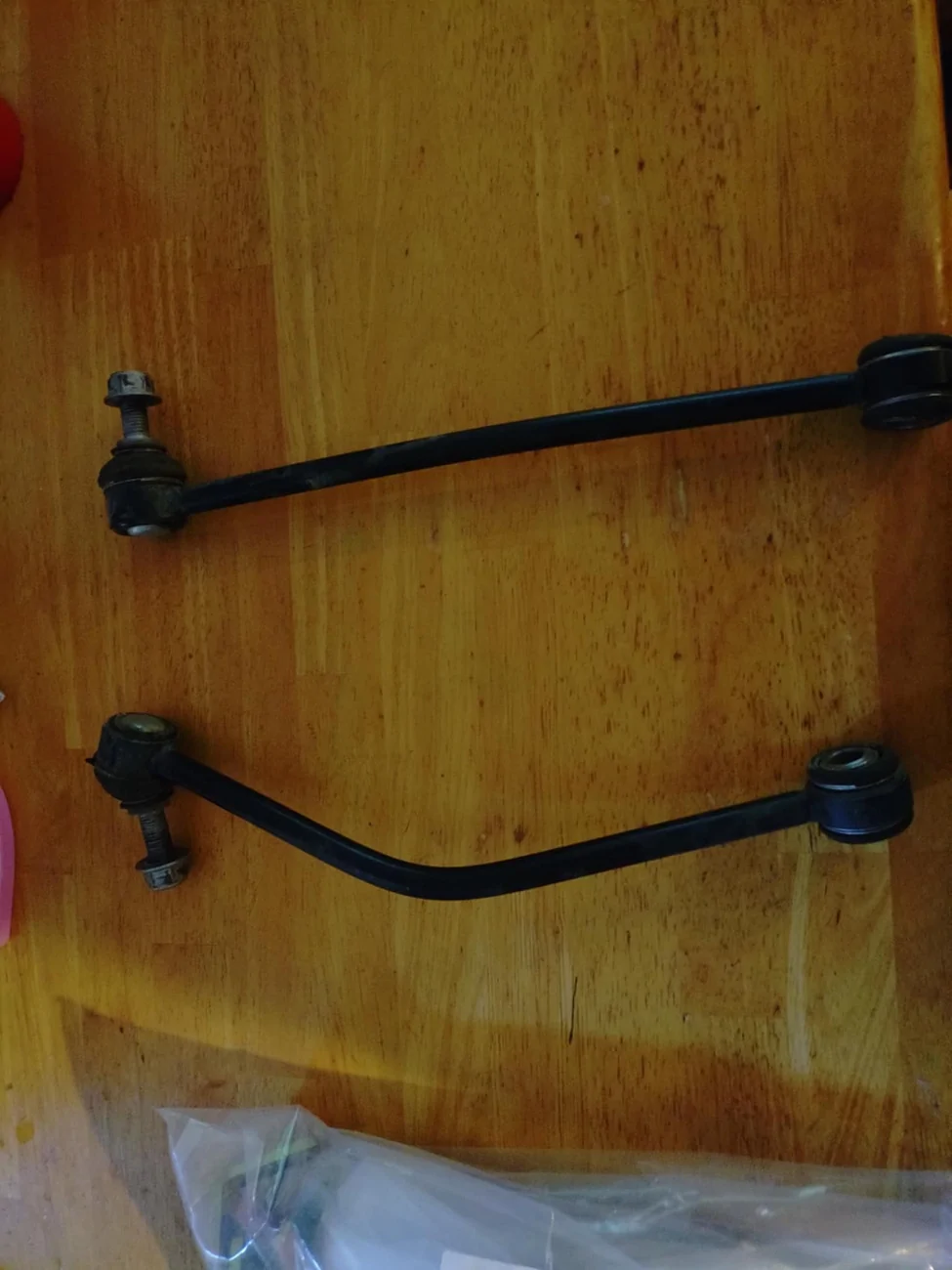

Over the weekend I noticed the front felt loose and increased roll on the highway and on my dirt road I was hearing a clunk I didn't notice anything Until Monday I noticed the front link sway bar link became auto disconnects because the nut fell off and the threads were begging for one's. oh well I had Metal Cloak front sway bar disconnect links sitting in the bag on my tool box
