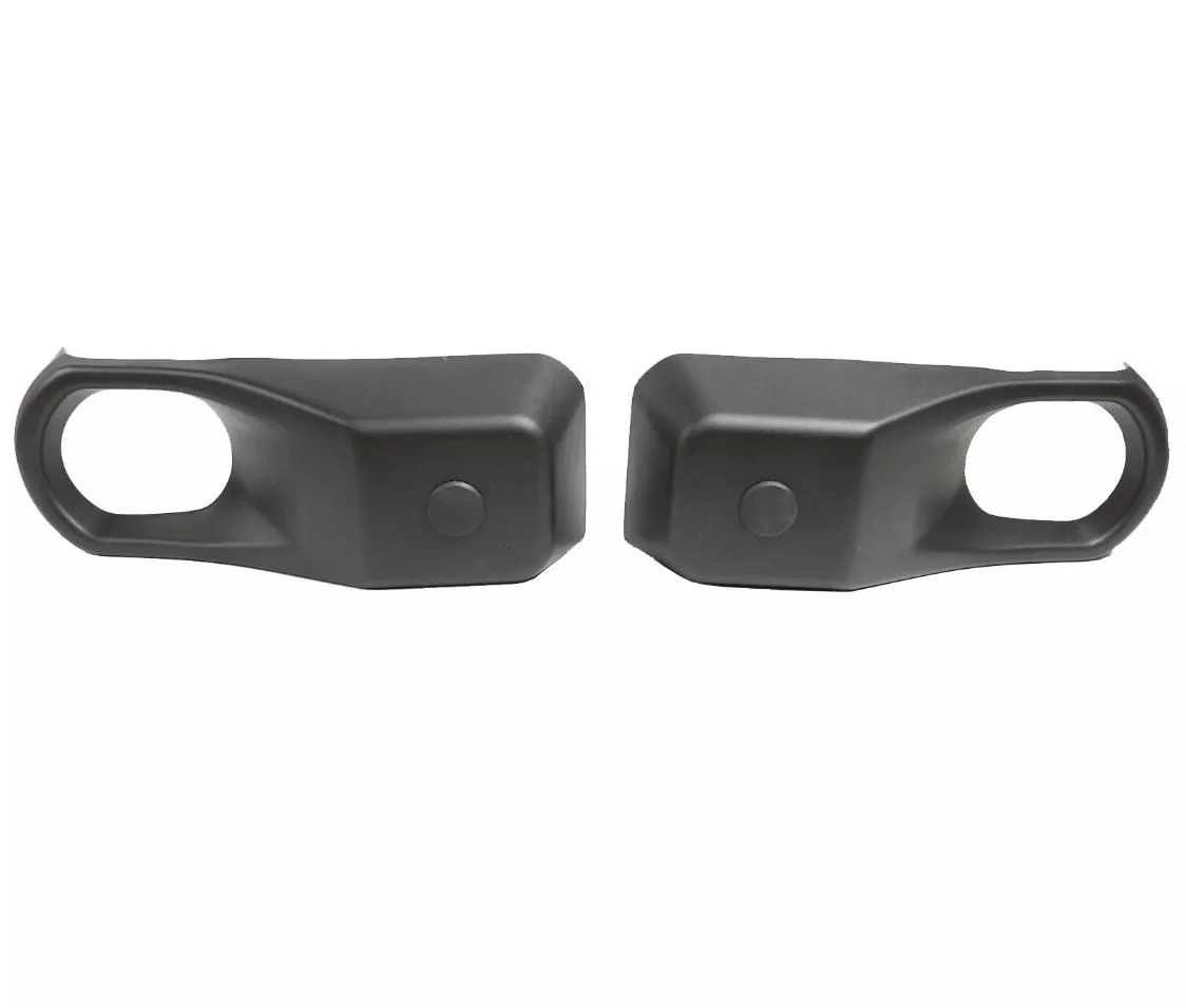

Here is a better shot of it after installation.
Looks great! Thank you. It shows on that link that the fog light covers have grommets installed but yours looks factory. Did it come with what you have on there?

Yes, I just changed out two things.
The red hooks that come with it for my orange Mojave hooks.
I also chose to reuse the factory fog lights so I didn't have to mess with any wiring.
I was actually surprised with the quality and additional parts such as winch plate, additional hooks, fog lights and grille guard given the price point.
