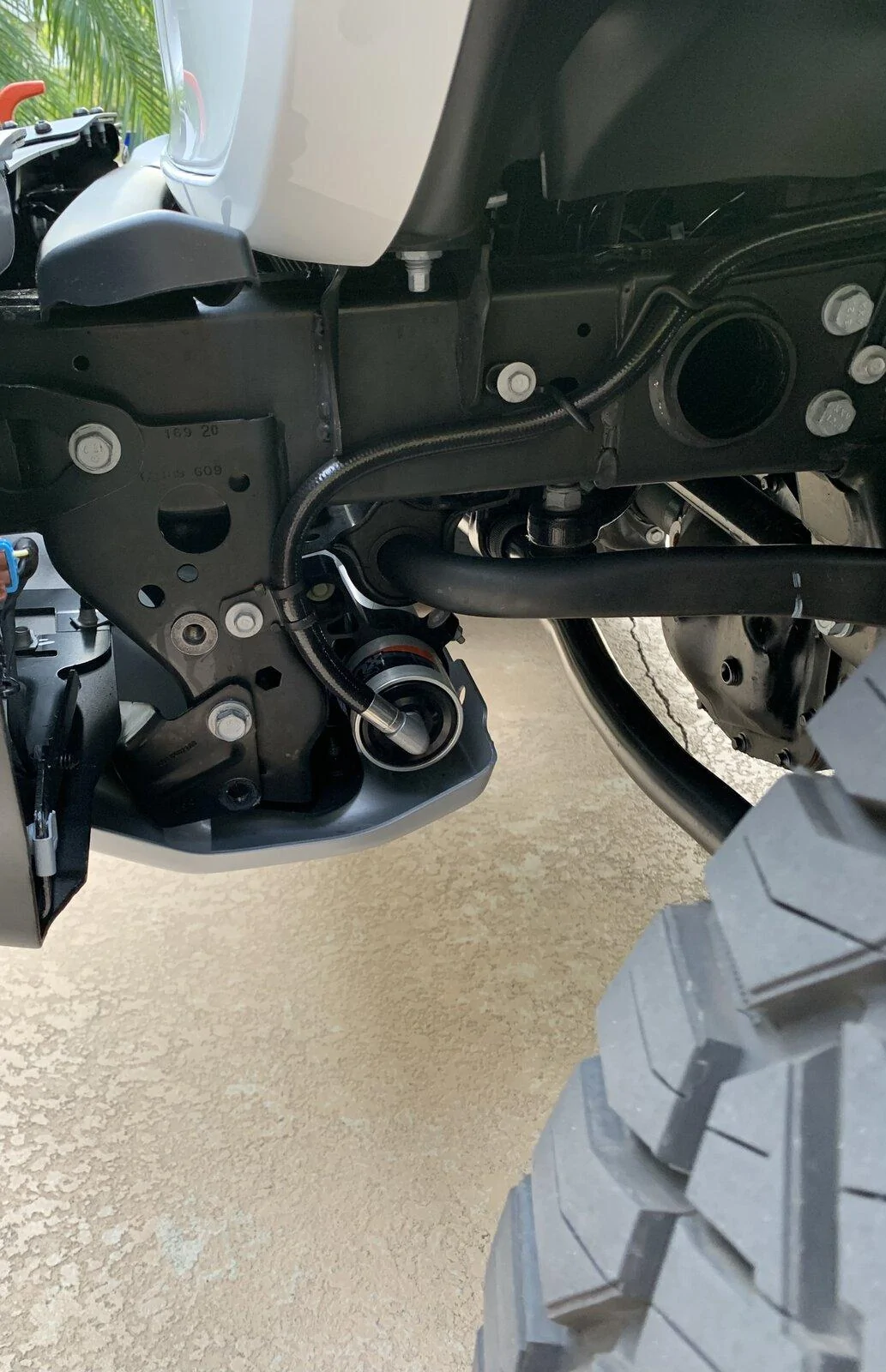

Another picture showing the only spot where the steel Rubicon bumper and Mojave skid interfere.
Thanks for sharing this.
I have a steel Mopar bumper on order, however I would like to continue using the Mojave skid plate.
Spacers / washers on the bumper might be the way to go here to bring the bumper a bit forward.

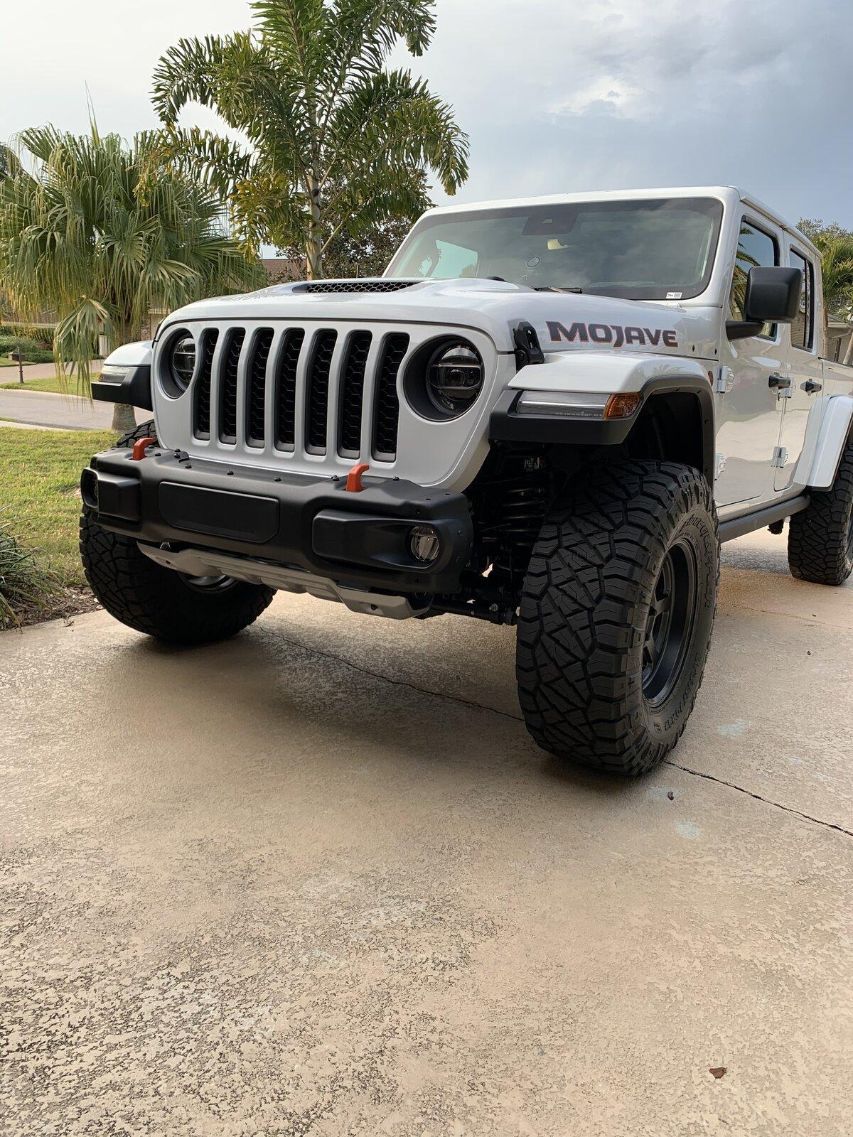

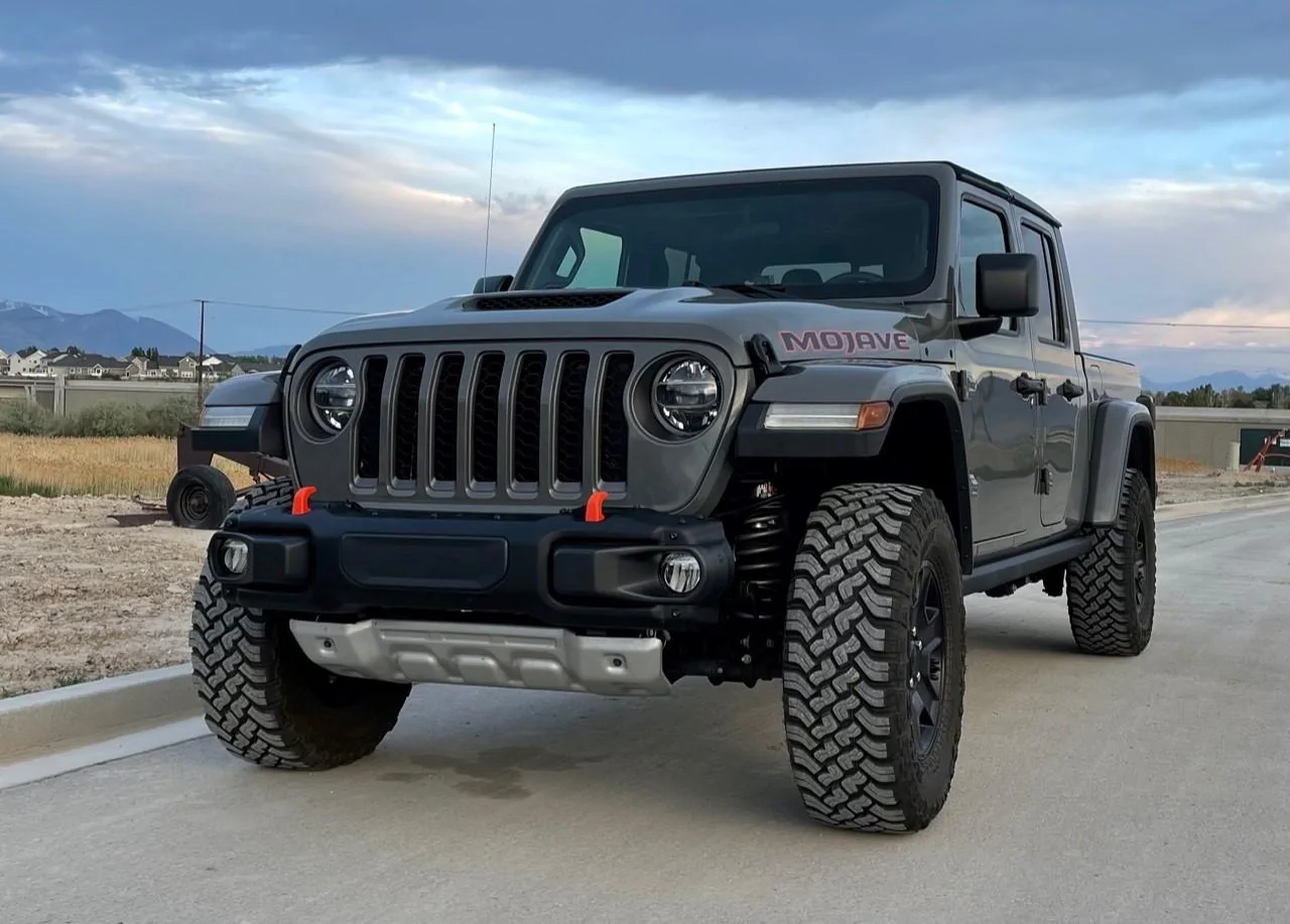

Not a Rubicon Bumper but I installed a Rugged Ridge Arcus and it went on without any issues or trimming and the factory skid bolted right up.
Since I am not installing a winch, I hacked the middle out of the factory bumper and made a plug to fill the void in the bumper then painted the silver skid black to match. Overall I am very happy with the results.
I think this is the way I prefer to go and is much less cost wise.

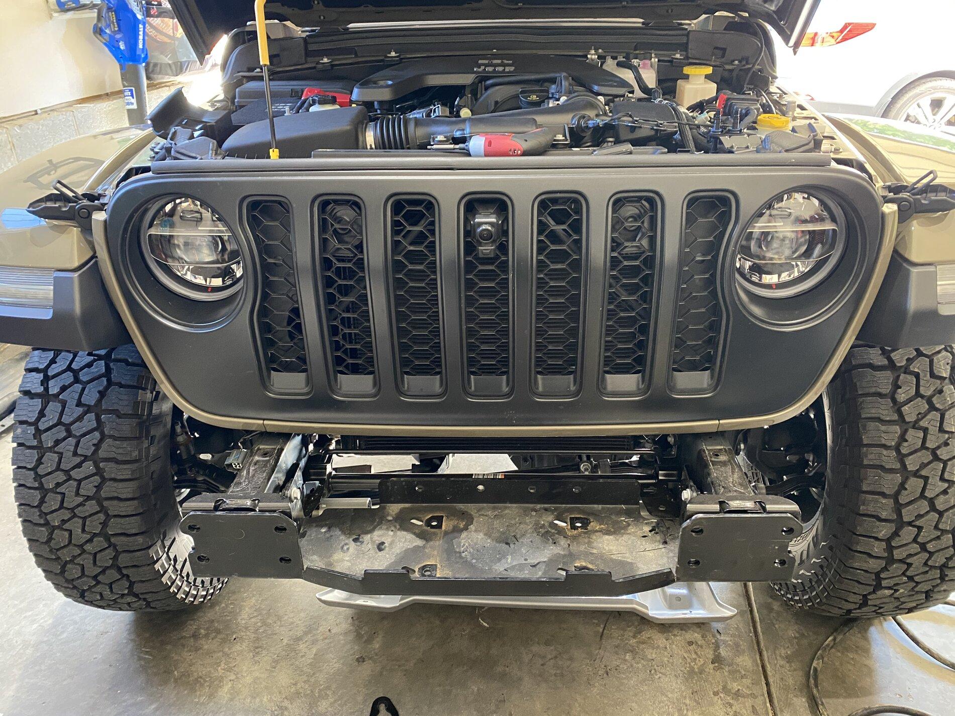

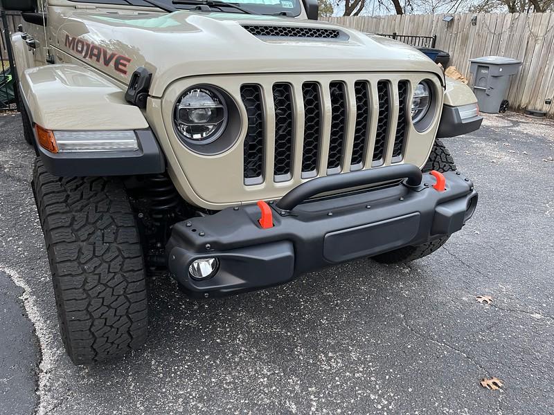

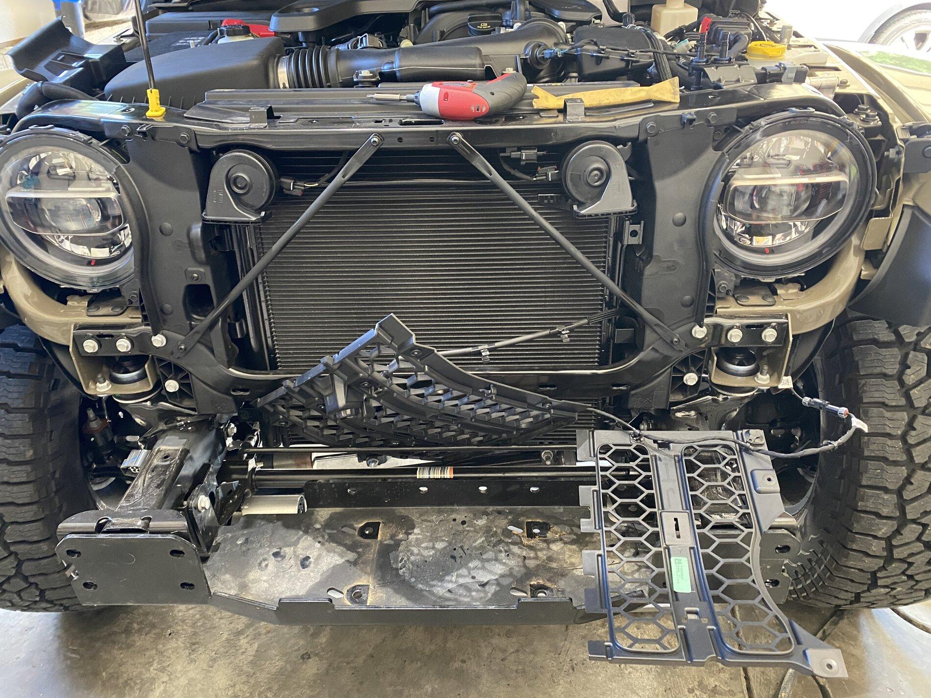

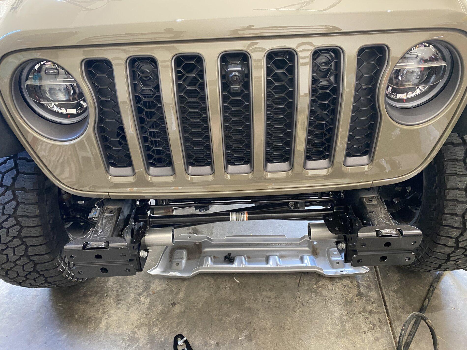

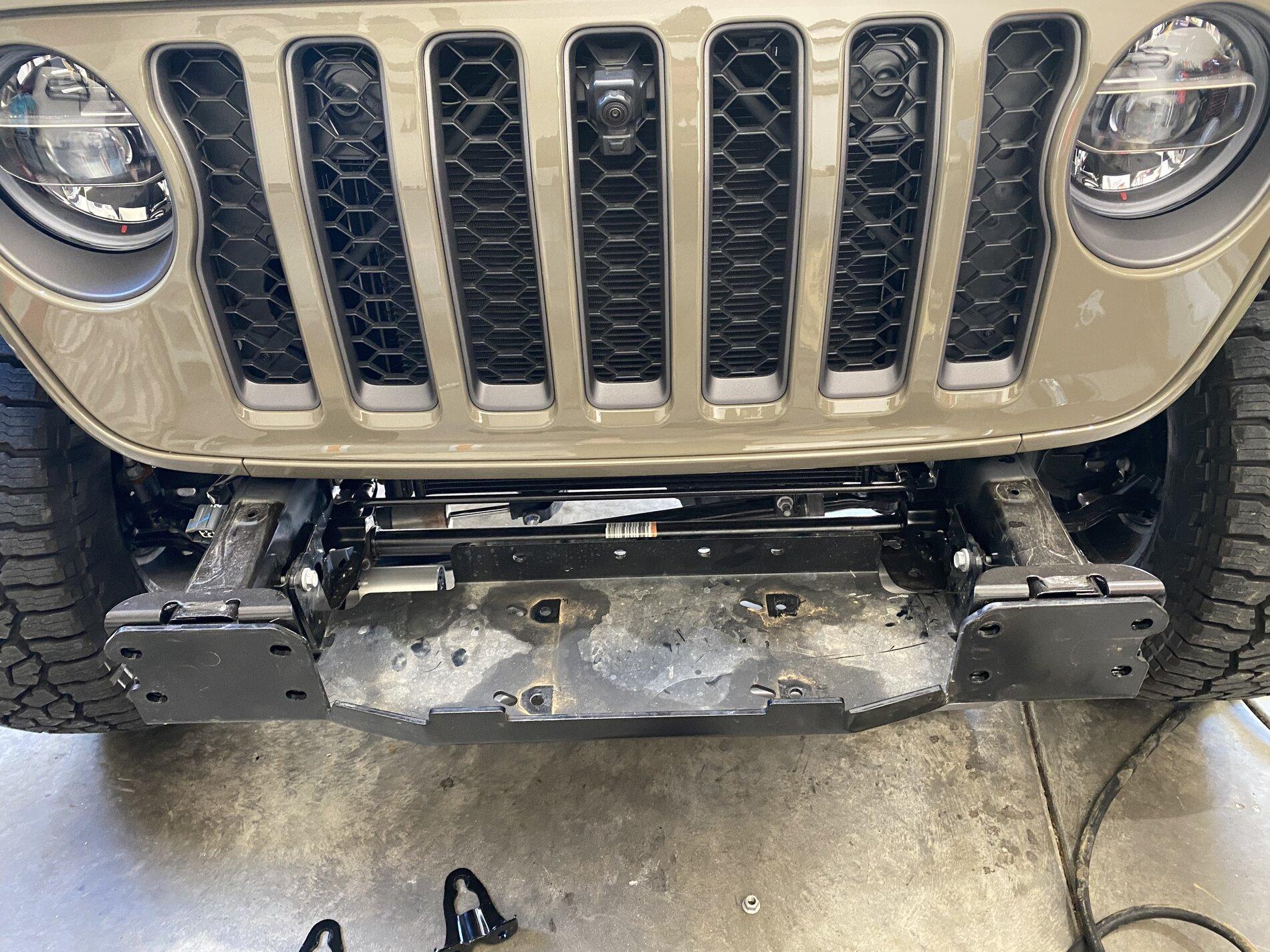

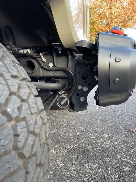

I installed my genuine mopar bumper today on my Mojave. Also made sure to swap over the orange tow hooks. Took off the end caps for now.
Certainly there must be differences between the genuine one and the ebay china one - with the ebay one leaving less cutting to do..

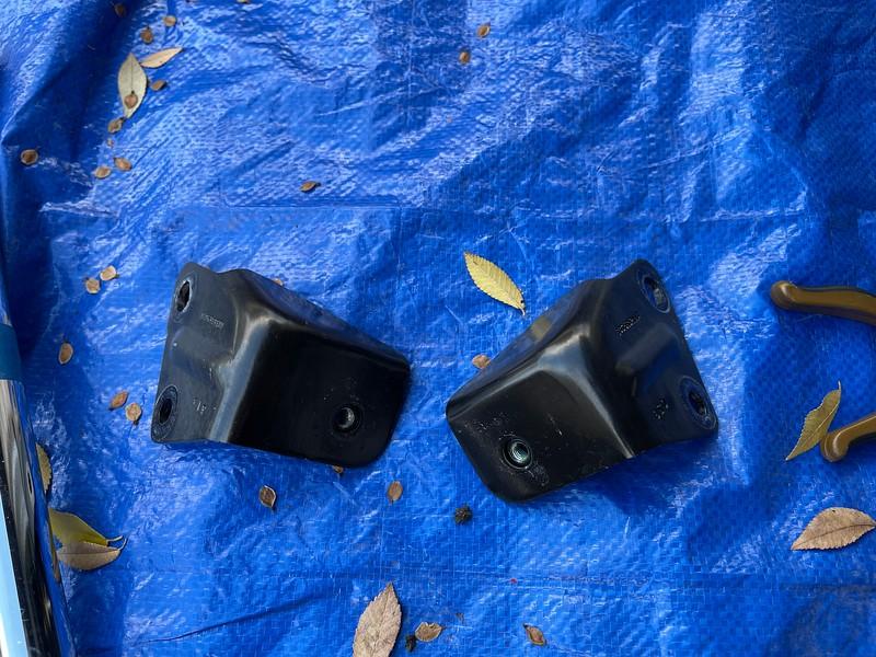

I tried some spacers on the bumper to the frame which it helped to clear the mojave plate brackets, but to mount the actual skid plate would need a lot of cutting. I went back and forth on what I was going to do, but then decided to ended up removing the spacers and brackets, and I will just order the rubicon metal skid plate instead.
I pretty much had every part of this bumper apart today, lol
Thanks to the previous contributors on this thread, a lot of useful information that assisted me.
Mojave plate brackets, I ended up removing them

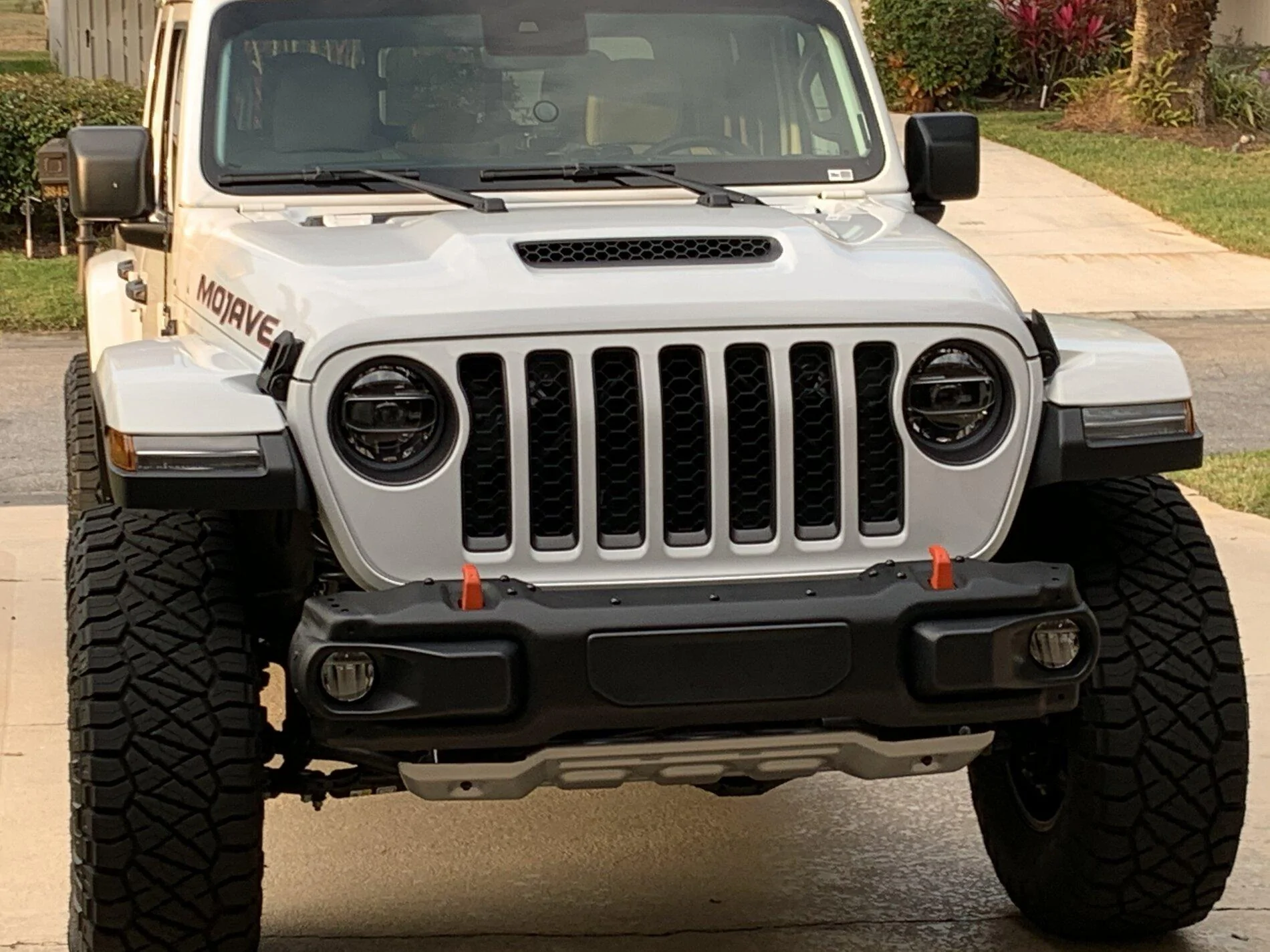

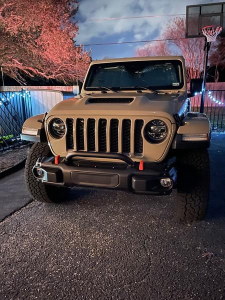

I tackled this last weekend - this is my story: bought the Mopar steel stubby from Bam wholesale. I didn’t want to hack into the bumper or skid plate, so I hoped for a creative solution, and I found it after much reading on this and other forums, owners groups, etc. I ended up moving the skid plate bracket down a hole, using the bottom hole for the top hole of the bracket. While you’ll probably think that’s only 1 bolt holding, once I tightened it and the bottom bolt on the skid... this thing is solid! The only difference is it spaces the skid down about an inch, but doesn’t matter to me - it still protects the reservoir, which is the mission, right? I’m very happy with it! I‘m waiting on the Warn low grille guard to arrive and I’ll call it good for the front end for now... some KC lights to follow at some point.

Looks damn sharp. Nice work.

Looks very good, clean. I like this option a lot better. Thanks for sharing.

For my purposes, I won’t be adding a winch. But if I did, there wouldn’t be any interference, as the skid is actually moved down and out of the way by an inch and 1/2... definitely wouldn’t interfere with a winch plate. It would be like mounting to any other Mopar steel bumper. I considered it, but it would be a waste of a Warn😂

do you by chance have access to the bumper and could take a photo of the wiring for the led fog lights.
on the bumper… I took the route of the rubicon bumper married to the rubicon skid plate… no cutting or drilling…
