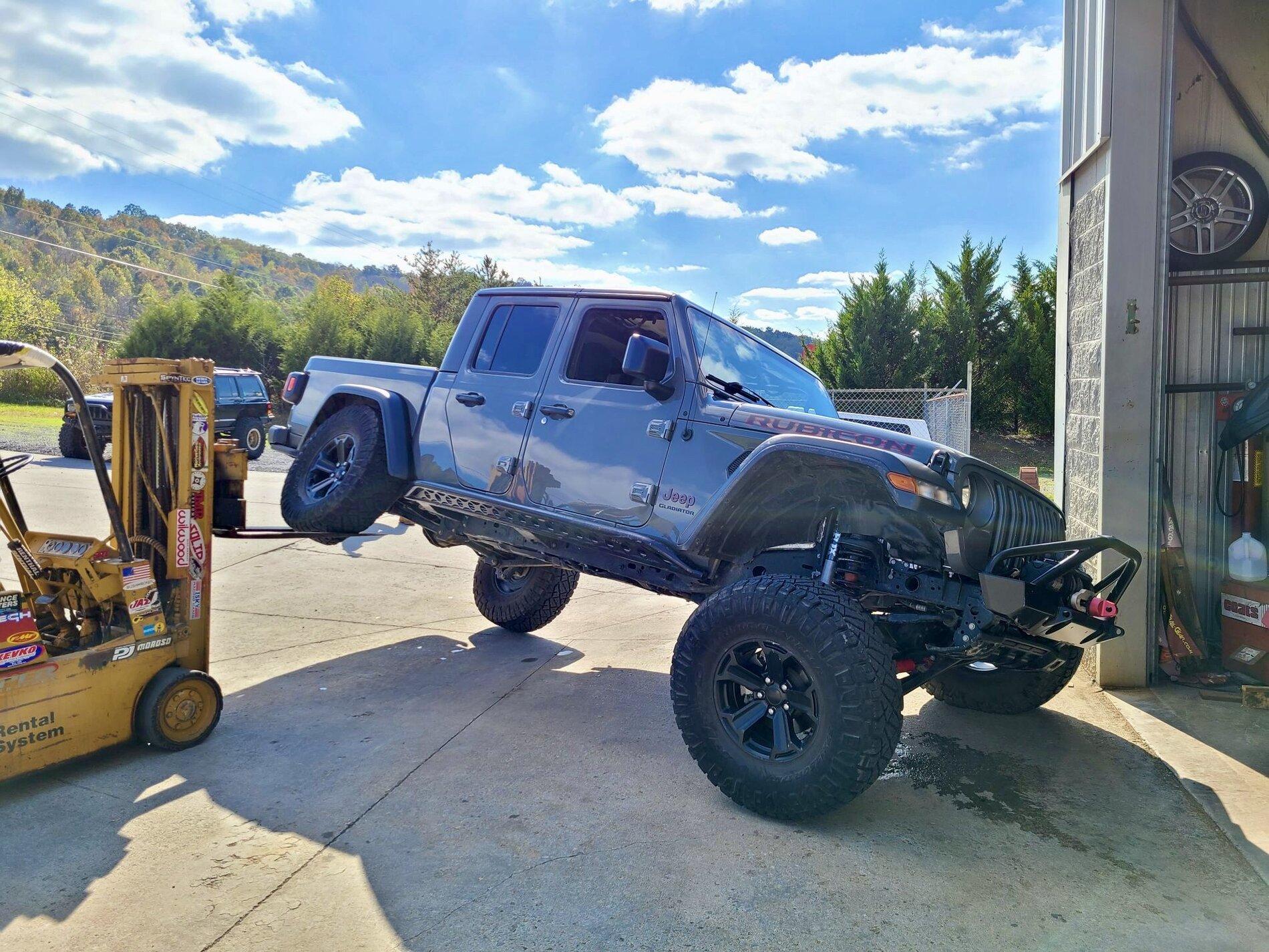

Will definitely upgrade the rear brake lines.
Currently running 2 pucks in the front
the jeep is more of a fire road vehicle for me.
i take out the x3 for trails
That looks fun!
I would also check the available up travel of the front shocks vs the up travel of the bump stop spacer to the metal cup of the jounce bumper. You might need all 3 pucks. I’m running 2” of front puck with the Fox 3.5-4” shock, and the shock and jounce bumper are completely collapsed simultaneously.

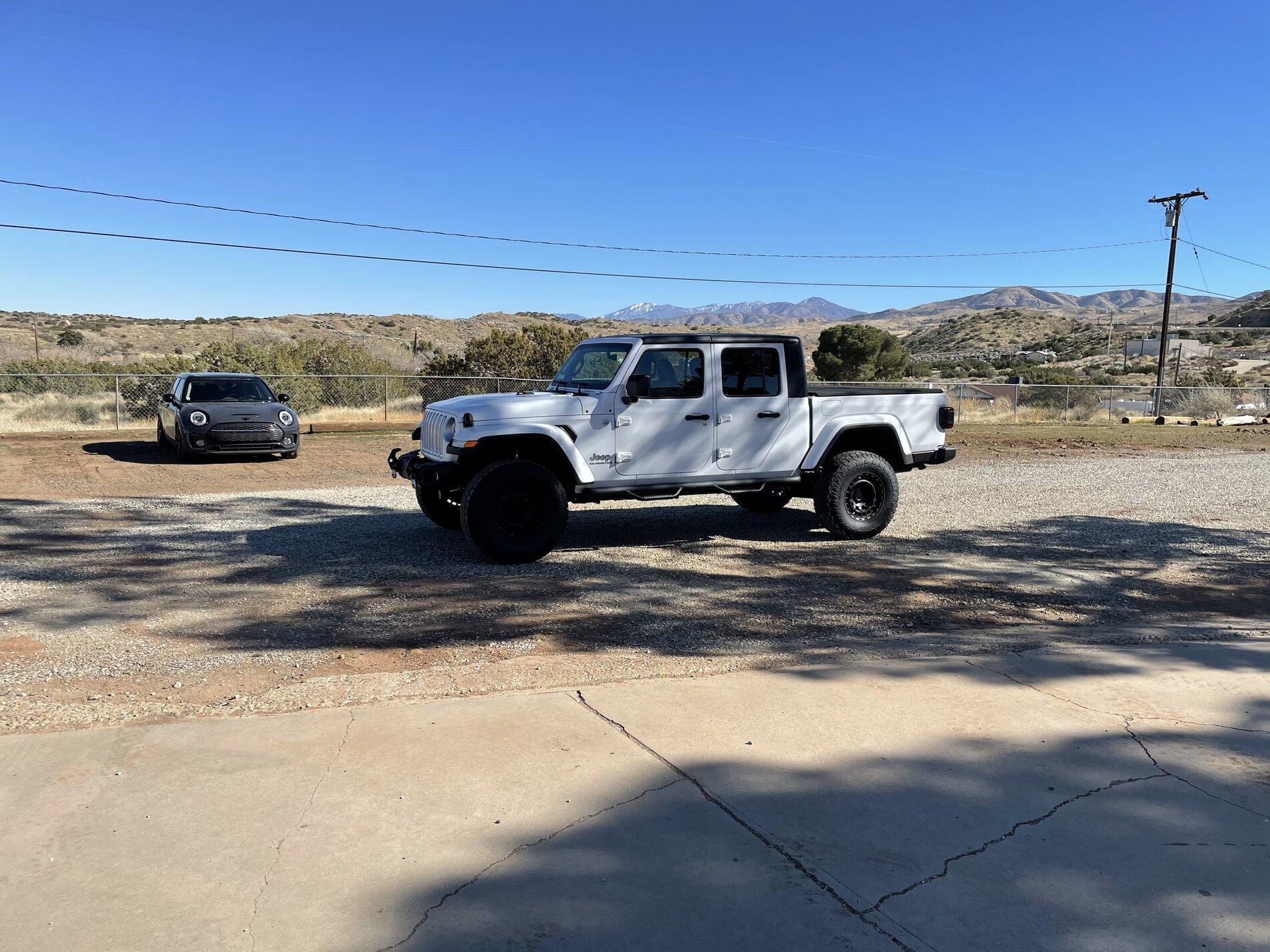

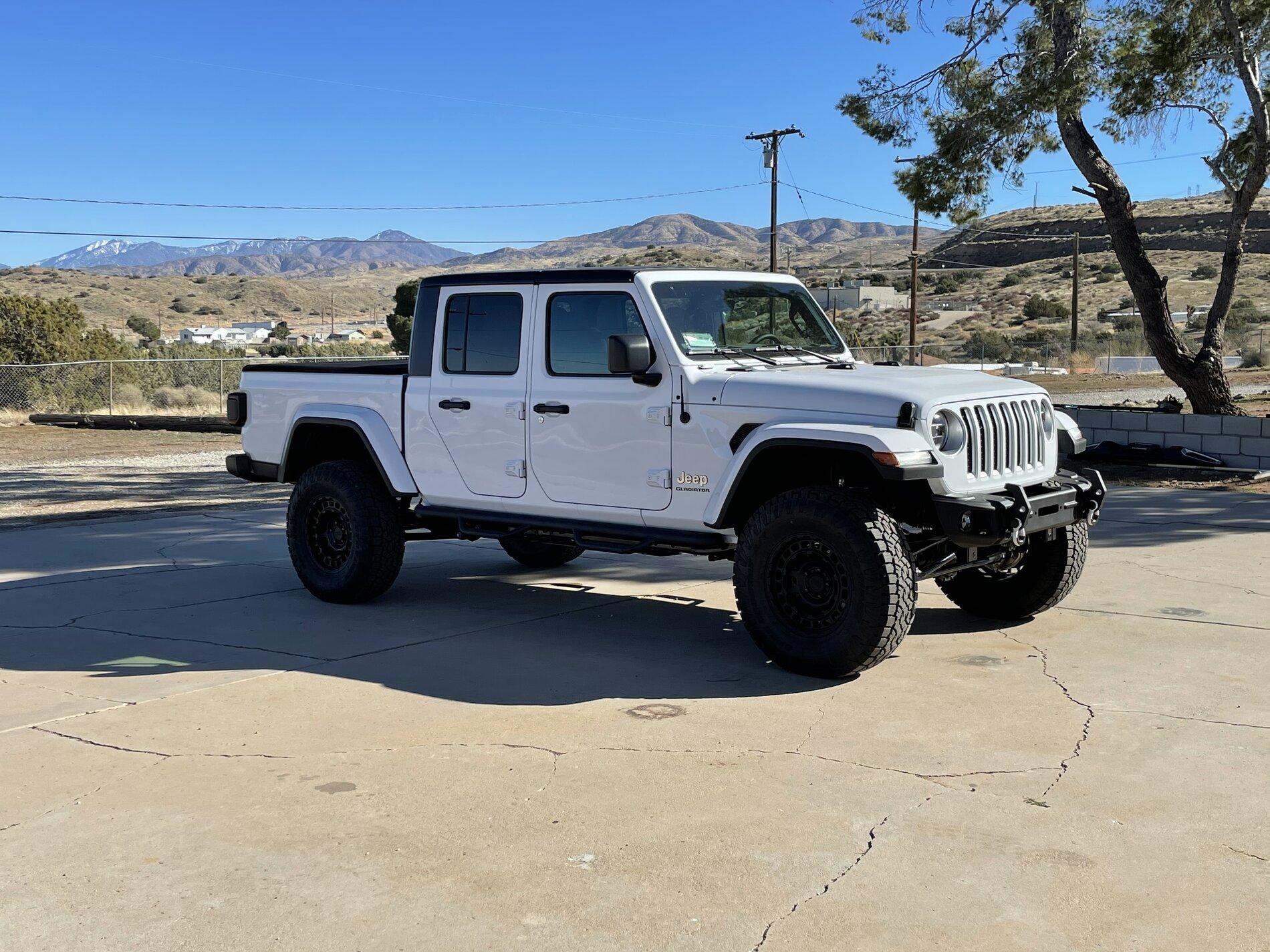

So after driving around
And adding the
winch, maximus 3 tow loops and
Steel skid plate
I ended up at 40 1/2 front and 43 rear
So 2 1/2 inches of rake
That was with a
3 inch coil front and 2 inch coil rear
i ordered a 4 inch front coil to try and have less rake.
after installing, i now have
42 front. And 43 rear
i will see how much it settles
But so far its exactly what i was looking for.
And adding the
Steel skid plate
That was with a
Nice! Moving to 4”/2” spring combo is on my COVID stimulus wish list. How is your shock travel looking?
