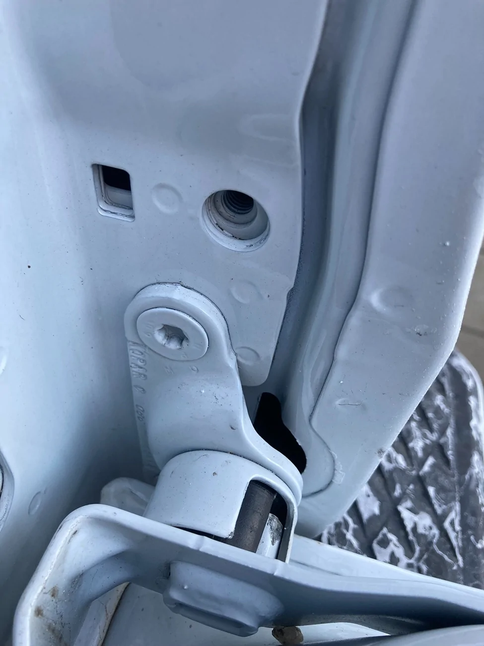

You had an exposed threaded hole, or was there some sort of cap or plug?
Yeah. Is the exposed threaded hole not factory?
If you look at the actual tailgate "pin", you can see some paint scraped away. I'm thinking the previous owner removed the tailgate habitually. Unless that happens just from use. Maybe there was a bracket there that was removed?

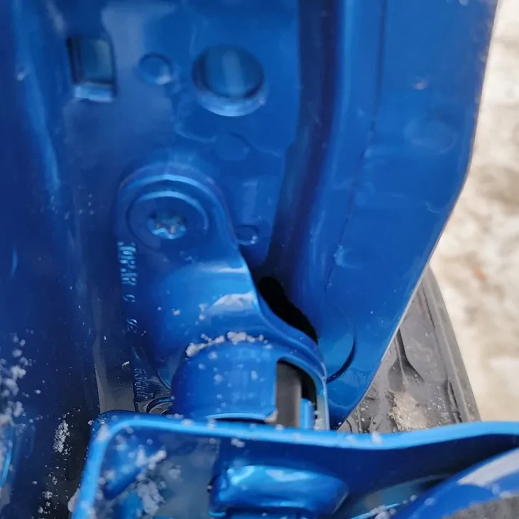

That's what I'm trying to figure out. Obviously if the bracket is/was there, the threads must be, but this is what my brand new 2025 looks like. Does not appear to be threaded, though it's possible there is a plug in there covering it that gets painted with the bed.
Yeah, that could be a plug. Although, the rectangular opening on the left that receives a tab looks to be plugged on yours as well.

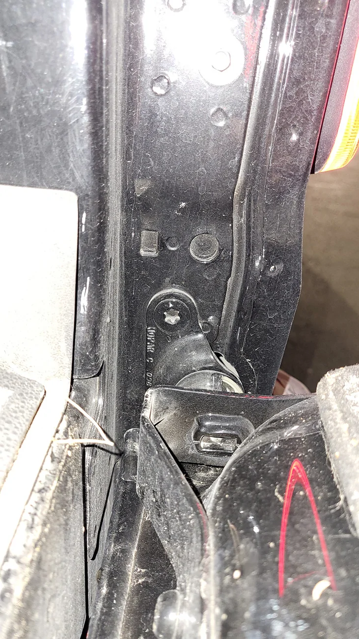

This is my '23 High Altitude, built 10/23.
Well, that changes everything!! Was this an option at the time? It looks like on my '23, the previous owner possibly had the bracket, removed it , and the holes were left? Weird.
I'm guessing, from the build date, this was one of the last '23s built, and the feature had already been removed from the assembly line in preparation for the '24 builds to start.

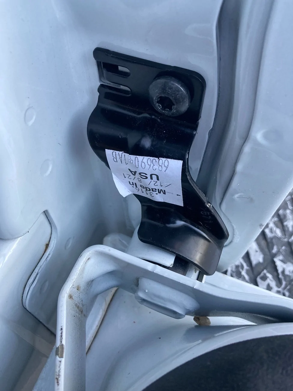

I think for now, I am just going to remove the bracket from my '21 before I sell it, and sort out making it work on the '25 when the weather is nicer. But if anyone else has one with the holes seemingly blocked off like mine tries it first, please do share.
