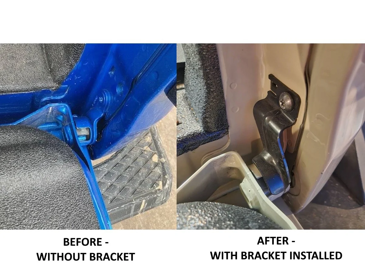

The older Gladiators have a little plate that bolts over it so you have to take out a bolt before you can remove the tailgate. They stopped doing it after the first few years, but Mopar sells the bracket and bolt as a "tailgate theft deterrent" for like $12.

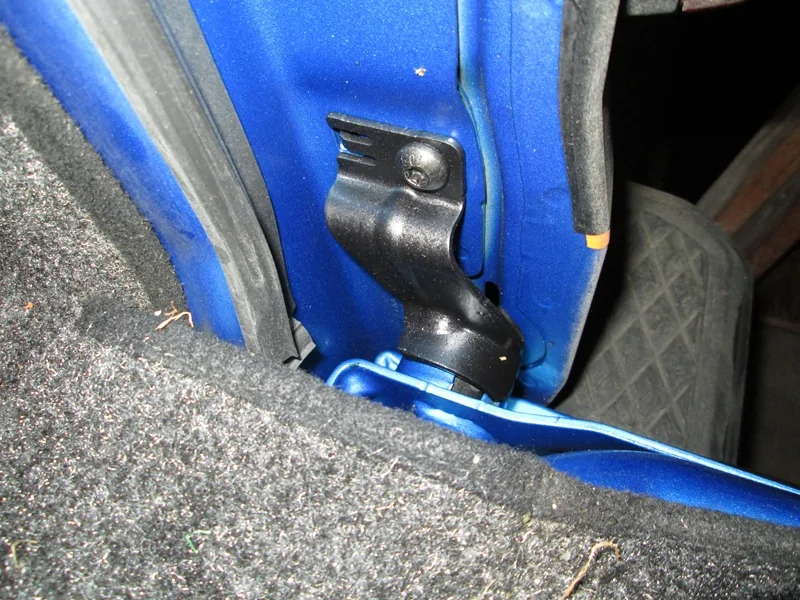

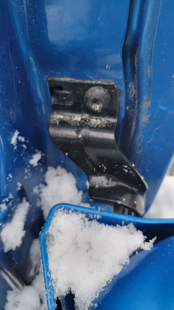

Maybe, maybe not. I just so happen to own a '21 and a '25 at the moment, so I went and looked.
2021:

2025
Jeep Gladiator Tailgate NON-removal 1765656036988-9u

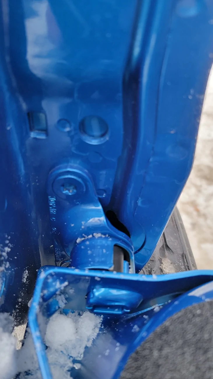

I am not sure how that bracket is supposed to screw in on the 2025?
I did look, seems to be a threaded hole in this location and the Mopar site where purchased says it's a fit for the '23. Fingers crossed!
Looks like you'd have to drill a hole for the fastener and install a nut or nutsert.

Please follow up when it arrives. The description says it just simply bolts in place, and includes the bolt. No mention of drilling or needing a (not included) nut or rivnut, but the before picture they use does not appear to show a threaded hole either. Can't find any install instructions or reviews, but the site confirms fitment for my 2025 as well. I was going to just swap over the one from the 2021 until I didn't see any threads on the '25.
Ok, will do.
