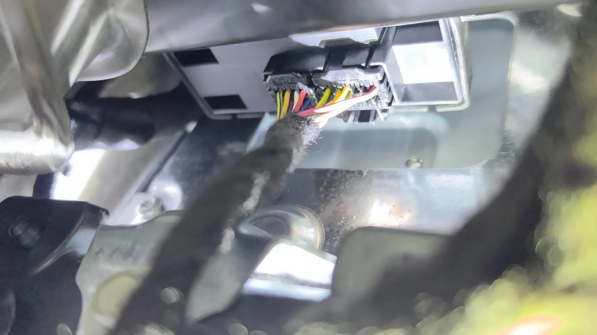

Okay JT People, who has installed a Tazer Mini in your 2026 Gladiator? First Hand expirence only, please.
1. How easy was it?
2. How is it working?
3. What settings have you changed from the stock setttings?
Backstory: I've owned 2 JT's and 1 JLU (all were 2020s), prior to my current 2026 JT Rubicon X. My one & only Tazer Mini worked in all of those so I kept it for my current truck. Since buying my 2026 JT, I have heard mixed results (mostly on Podcasts) that "they don't work" without some other devices and/or "cheat codes". Thus I want to know your exact first hand expirences. The people saying this have only been quoting other people, not talking about their own expirences.

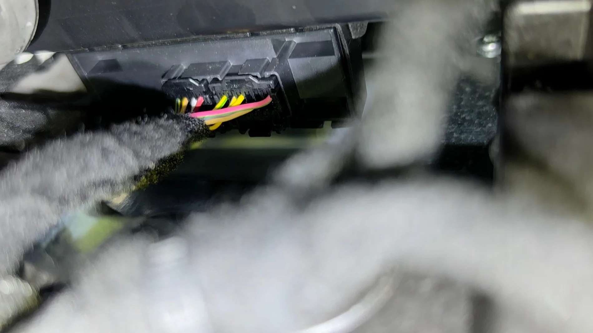

On a different & much simplier note, am I wrong that the new plug in spot(s) is easier to get to? (See pics below) I think I've spotted it, but thus far not done it... I've only got 1,500 miles on my truck so I am kinda waiting a while to make sure it's in tip-top shape before I (potentially) screw it up. I don't know why this time around I am nervous, but I am.
Have I contacted the Tazer Mini customer service? Yes. Of course, they say it will work... I wouldn't expect anything else from them tho.

Have one in both the 2025 JTR, and the 2026 JLU. Works fine in both, just make sure you are up to date on firmware.
I will say it was way harder to do on the Rubicon because of all the other stuff under the dash the JLU doesn't have (Alpine audio, power inverter, etc). I've had Tazer JL's on 4-5 different Jeeps, and the 2025 JTR is the first time I broke down and bought the extension cable because I NEVER want to have to try and reach the SGW again.

I’ve had one in my 2024 Mojave X for a couple years now.
The install is a pain in the ass because the plugs are WAY up inside and lots of shit in the way. YOU NEED the extension cable. You plug/unplug the tazer into the extention cable - it’s quick and easy. Just that first install is rough….unless you have small hands. 😆
Most people (including myself), leave the Tazer plugged-in all the time.
No laptop needed and it does not plug into the OBD port.
You change the settings directly from your dash screen.
Note - There is a specific process in plugging & unplugging these things (aka sleep cyces). If you don’t follow the process precisely, can cause issues and battery drain. The instructions from ZAutomotive are horrible - I’ve written my own instructions so its easier to follow.
Sounds like yours is a few years older…. You might want to research to see if your older version is compatible with the newer vehicles. Did the plugs stay the same or no?

So, the Extension Cable only makes it easier to reconnect the SGW harnesses, when returning to "stock" configuration. At no point while using the Tazer, are the extension cables being used. Am I understanding that correctly?
Correct. The extension plugs into the SGW. The Tazer plugs into the oem harness in place of the SGW. If you remove the Tazer, you plug the oem harness into the SGW extension. Truthfully, some need it, some don't. It depends mostly on what options your Jeep has, and also a little on just how small and flexible you are or aren't. If you have the premium Alpine stereo, and the 120v inverter, you will probably want the extension, because some of those components are in the way under the dash, and after one time doing it you will NEVER want to try and reach that SGW again.. If you are a large person or just have fat fingers, you may want the extension.
