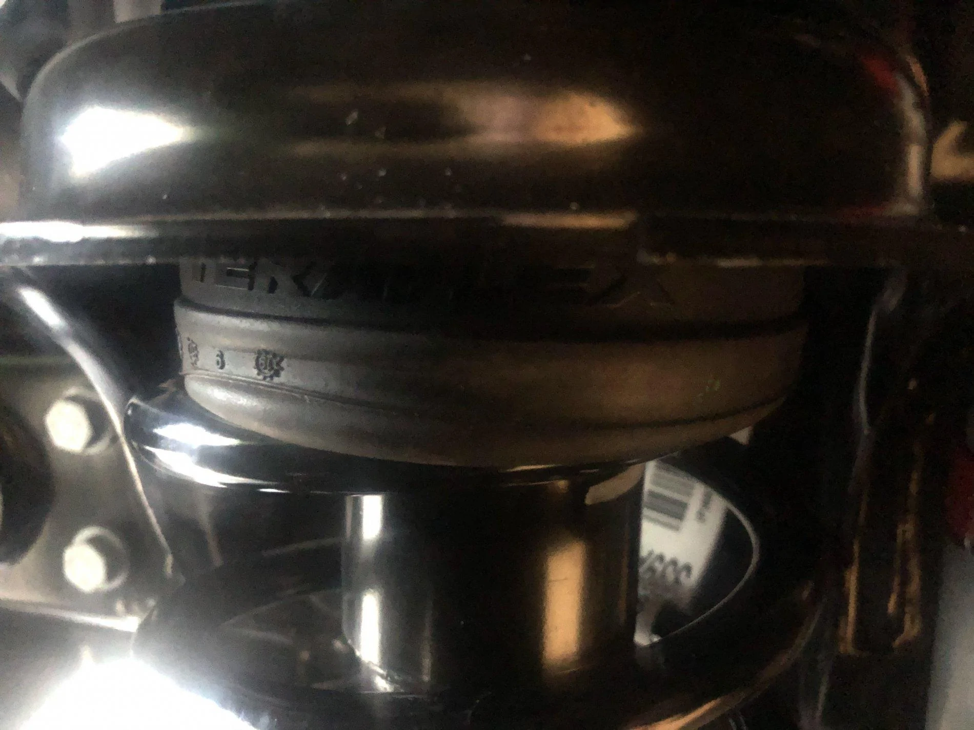

I just installed the 1.5” leveling kit on our gladiator rubicon. The spring isolator seems to have bulged to the side on both sides a little. The coils are seated correctly on the bottom seats and the spacers prongs are aligned properly with the spring isolator and coil bucket. Is this normal, has anyone else experienced this when installing the kit?

Just checked mine, look same as yours. As long as the pins are aligned, I think you are good. In the end, it is rubber isolator.

That's where the diameter of the coil crosses the diameter of the raised ridge on the outside of the isolator. It should not be an issue.
