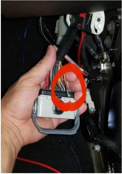

I am in the middle of the auxiliary switch install on my JT and damaged the terminal female connectors that plug into the gray harness and into the supplied socket from the kit. Can anyone please help identify part number and source of where to get replacements? Will require soldering too.

Thanks for the responses! Think i solved it.
For future reference i think i figured it out. I got the technical documents for one of the components from the Aux Install switch kit -- Molex 334710201 (https://www.molex.com/molex/products/datasheet.jsp?part=active/0334710201_CRIMP_HOUSINGS.xml). In the technical documents it says that the terminal number is 330122001 (https://www.molex.com/molex/products/datasheet.jsp?part=active/0330122001_CRIMP_TERMINALS.xml). Search for the part yielded a bunch of retailers: https://octopart.com/33012-2001-molex-7665045#
i am going to order and confirm here if this is the right solution, but it looks like it.
