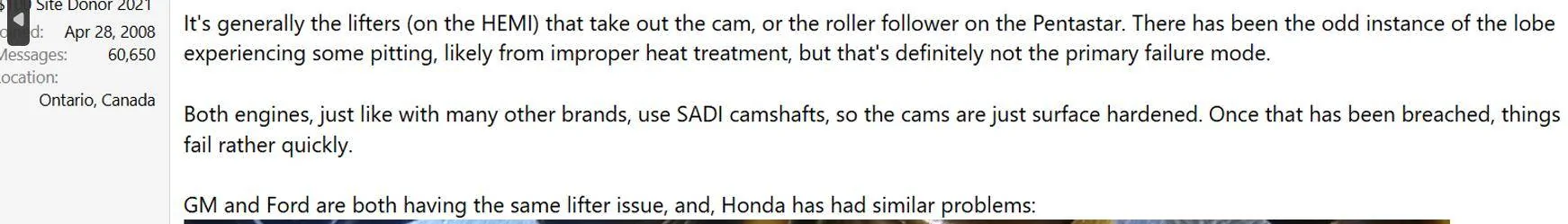

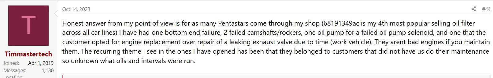

Here's another - yes, from 2023, but still very valid -
Jeep Gladiator The 3.6 Tick Bites Trail Recon at 31,000 Miles Screenshot 2025-05-25 095445
Jeep Gladiator The 3.6 Tick Bites Trail Recon at 31,000 Miles 1748300113233-vd
Maybe larger metro area here in Denver and more Jeeps per capita. I spoke to a couple of the techs and service manager and they stated they just keep ordering them to keep them in stock.

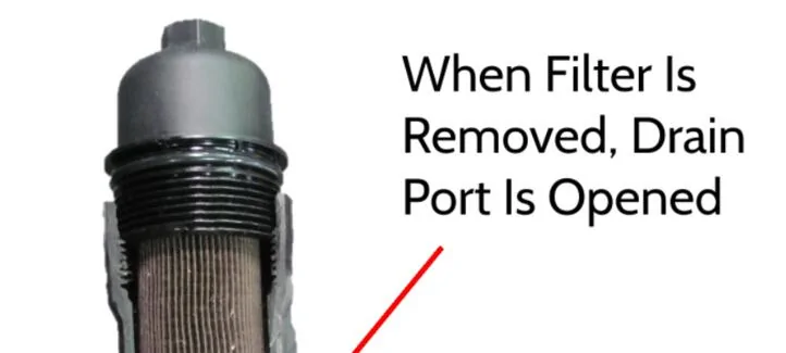

I actually think the Baxter is not as easy to change as stock because you have the additional step of having to blow the oil out of it when you change it. Opening the cap and pulling the cartridge filter is about as easy as it gets. I do usually loosen the cap and let it drain a bit before pulling it out. For some unexplained reason, this oil filter that everyone says drains out keeps some oil in the cap, which tends to spill out of you are not careful.
If Baxter is so confident that their product is necessary, how about an engine warranty? Say 500,000 miles?
40,514
54,044
Jeep Gladiator The 3.6 Tick Bites Trail Recon at 31,000 Miles 1748302070355-ad
On these, you are supposed to change the filter, then go down and drain the oil.
I agree on the additional step for the Baxter. Additionally, you are correct about the current gen Pentastar oil filter holding some oil. I noticed with mine, after draining the oil and with the drain plug still removed, if you wait and remove the oil filter at this point, a little more oil will drain out into the drain pan. I’m sure it’s due to the seal on the plastic ball on the bottom of the filter that the previous gen did not have. Do I feel it makes a difference? Not really, it certainly isn’t preventing any the current rocker arm/cam issue. Then again I’m not a believer in the dry start “issue” theory.
I always pull the filter before replacing the drain plug. I wasn´t sure how it all worked, but I did notice early on that more oil comes out when you open the cap and pull the filter. That explains it. It also makes me wonder if we´re getting a dry start as much as some think.
Another funny Pentastar thing...You can drain that thing for an hour and put a glass under the drain hole and in the morning it´ll be half full. It´s crazy how much oil comes out after so much time has passed with this engine.
