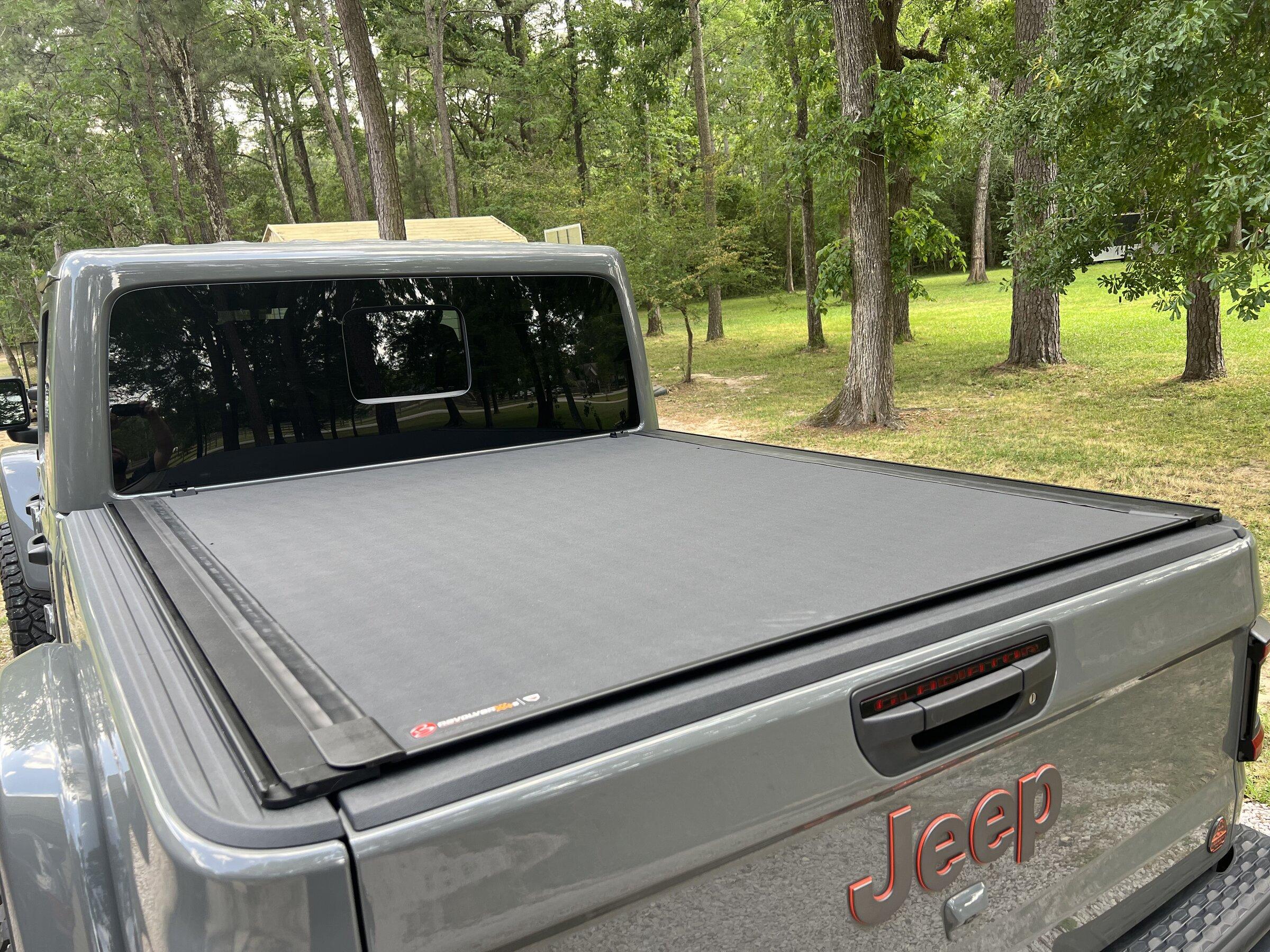

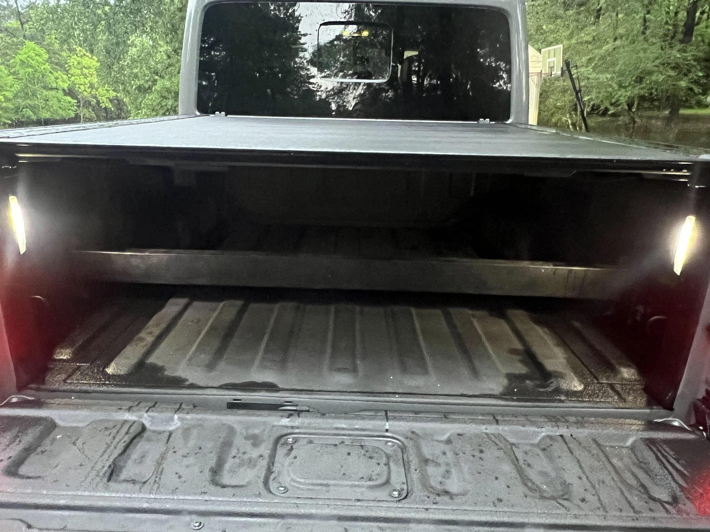

Did you line up the edge of the tonneau at the tailgate with the rail ends? The way I read the instructions was to line up the hard cover with the ends of the rails at the cab. It causes the tailgate side to overlap a little but I get very little water
I think I have it lined up almost perfect, but I am going to mess around with it this weekend and see if I can adjust it or maybe just add some seal tape.
Let me know if its still leaking after adjustment, we may have to look into some new seals
