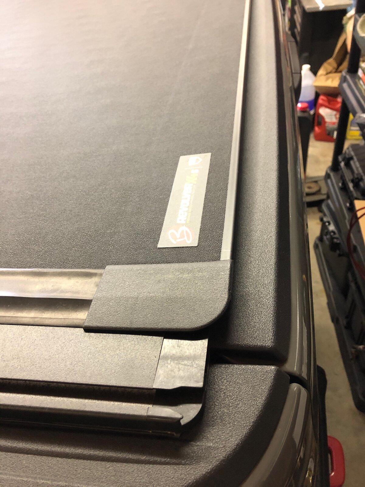

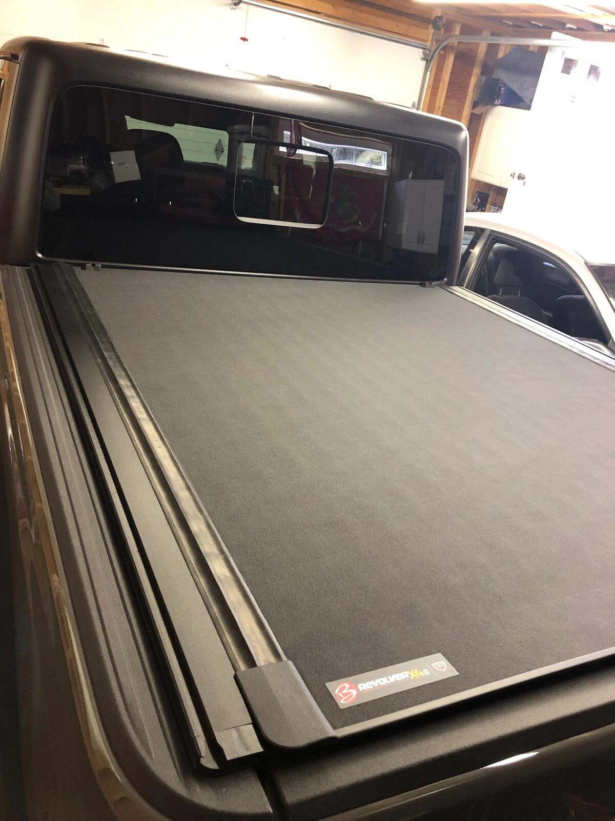

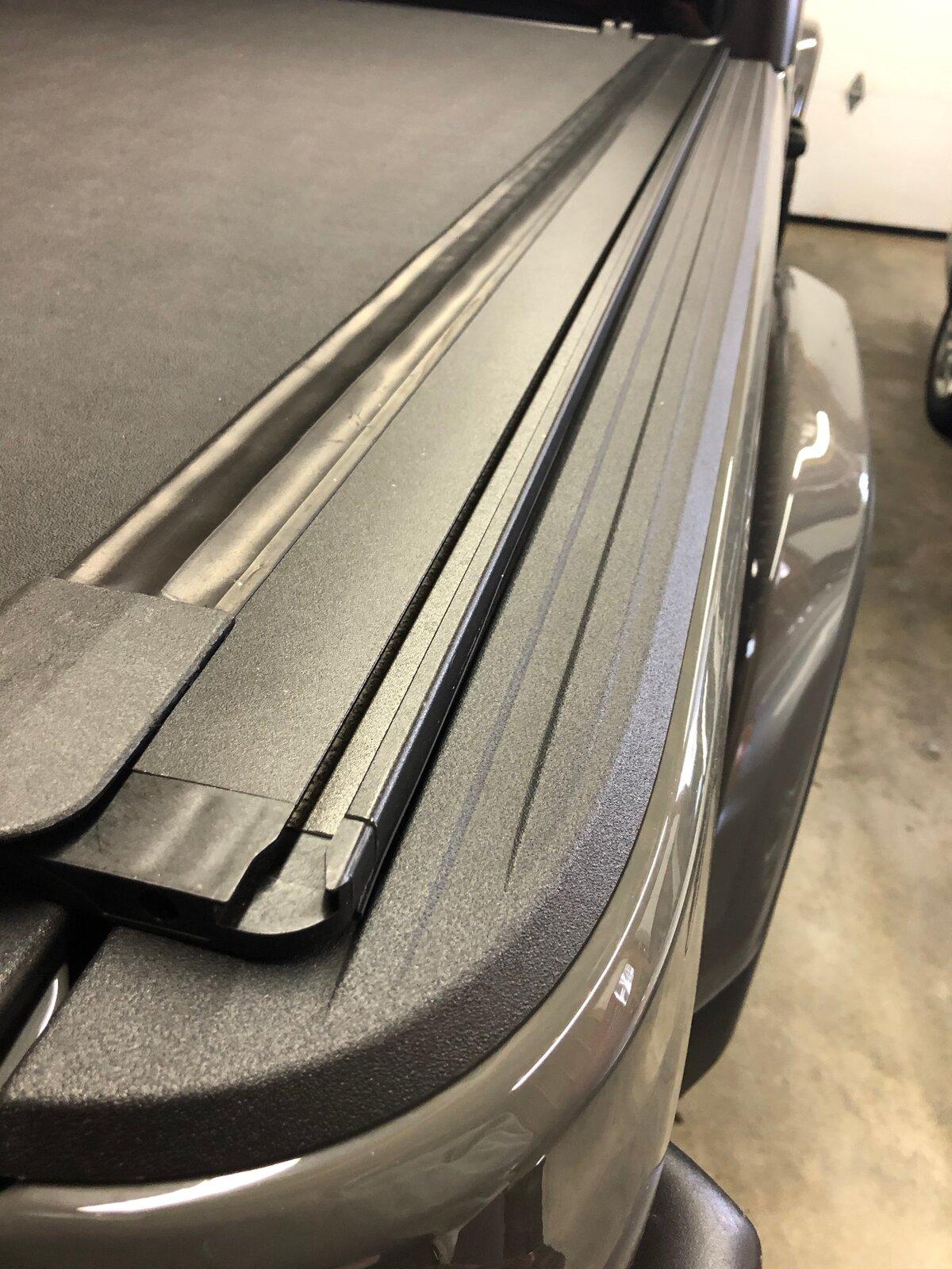

Big shout out to @Axeman for sending me some pictures of the X4s installed on his Gladiator. As you can see there are t-slots on the cover. I am still in the process of finding out exactly what racks will work with it. I did call on the BK Voodoo rack and the owner said it will work just I don't believe it will utilize the t-slot, he found another way that allows it to mount

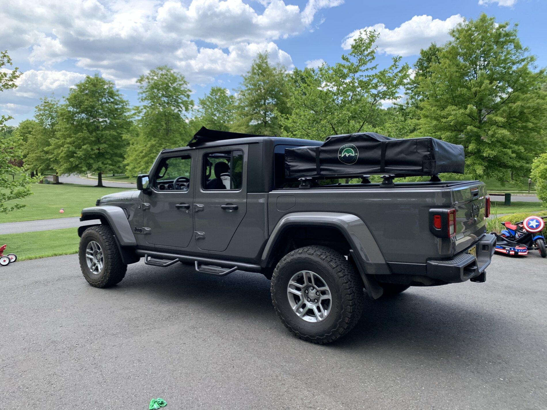

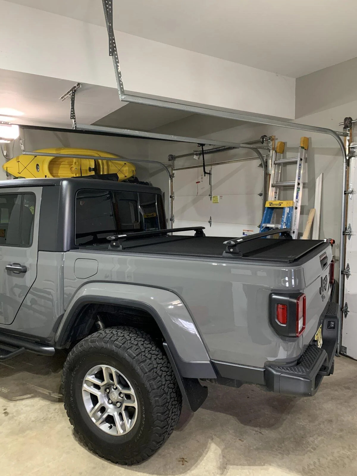

Can you post a picture?
Sure, here it is, I also have a roof top tent that I use on top, works great, bars are 220 dynamic load so plenty of support
Could you be so kind and tell me the exact Rhino Rack pieces included in the rack system you are using?
Looks like there a total of three seperate pieces - pad/base that attaches to the T-rails, Tower, and then crossbars themselves. Is this correct? Are there taller options to allow the X4S to rollup underneath the crossbars?
Can you give some part numbers? I’m having a helluva time figuring out what the heck I’m supposed to buy. Looks like you have a complete setup and a good weight so I’d love to replicate it.

Good question, took me a while to figure out but it is actually just one kit Y02-490b-NT or Y02-490-NT if you want silver Bars.
Best part is that everything you need comes with the kit (59” bars, feet, etc....) and it is not that expensive and well built....I think I paid around $325 shipped.
As far as I know you cannot raise it up enough to roll up top, that is the only downside
