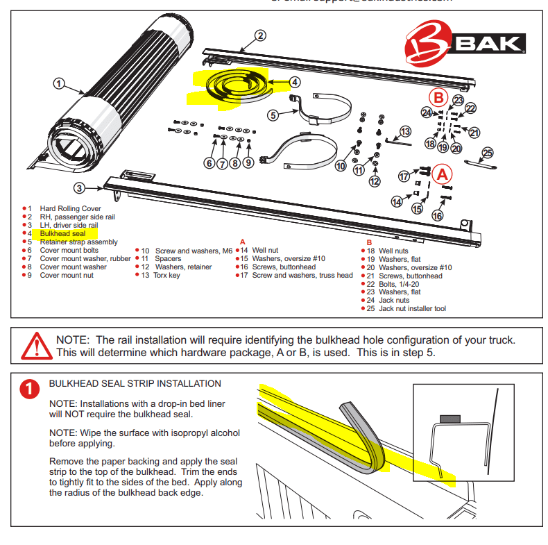

Any way you could check and see where the long seals are meant to go? I can report that it's pretty dry in the bed after a good downpour.
I have actually been looking into this and haven't found any info on it as the install sheet I have on shows the bulkhead seal. I will update once I receive some information
After getting off the phone with BAK and the rep that was assisting me doing some digging the only thing they could come up with is it being a bulkhead seal, they said they typically send out two of them, a 3/4" and 1/4" as to make sure every base is taken care of. I don't know if this is the same seal that you are talking about but all that we were able to come up with.

Lastly, I haven't done anything witht the longer thinner seals. Does anyone know if they go under the side rails or on the inside/side of the rails?
I asked Alex about this seal, waiting to hear back. It wasn't included in the instructions, but my guess is that it goes around the tailgate to seal the bed off from water getting in.
If I remember right from installing on a previous truck you are correct. You get a thick and thin bulkhead seal and two thinner seals for the tailgate.
I will be getting an X4 soon. Loved it on my other truck.
Can you show a pic how those thin seals for the tail gate are supposed to be installed? The tail gate corners are the only place I get a good leak if parked ass end uphill especially. (I do have the X4s)

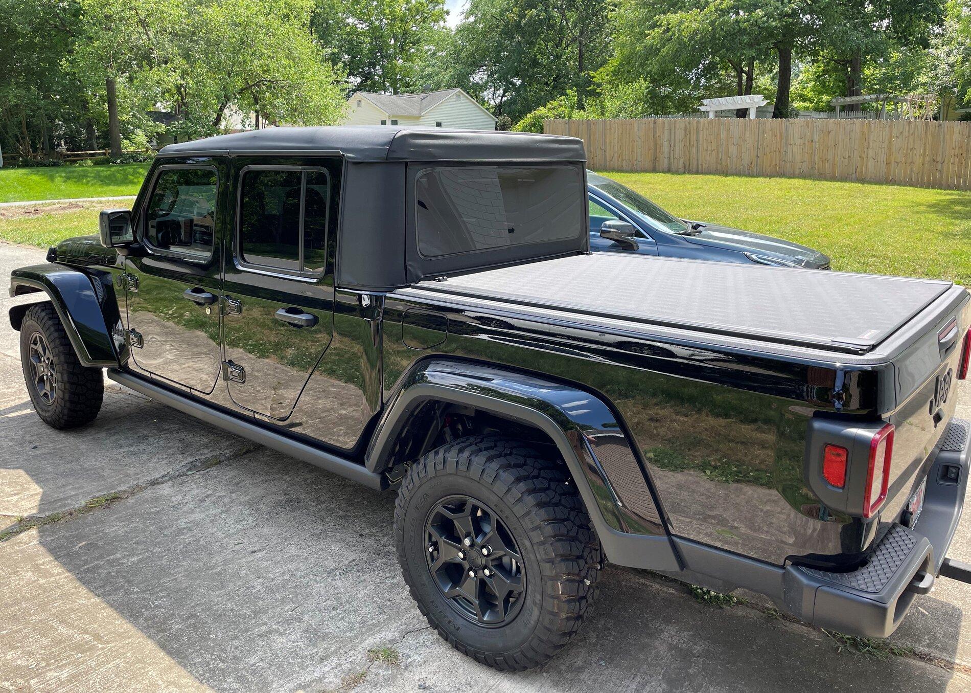

Hey, installed one of these last week actually on my 2021 (new to the forum, but been lurking a good while before I finally bought one).
I had a Bakflip MX4 (hard tri-fold) on my Tundra and loved it, so wanted a Bakflip for the Galdiator, as a hard folding tonneau cover is the most useful mod I've ever done to a truck.
Went with the X4s, and so far really happy.... a little disappointed I missed out on this offer ha, as I ordered directly from Bakflip which best I can tell IS RealTruck, same basic company.
Install was a pain initially as they sent me the wrong set of instructions in my box that showed I needed to use clamps etc.... after about an hour of cussing, I figured out they messed up, and 30 minutes of Google found the new Gladiator instructions that were easy enough to follow.
Install is setup for both versions of our truck beds (A&B as they call them, both seem to work fine, mine being a 2021 was B and worked great).
They do give two long rubber gaskets, one 3/4" if you have no drop in bed liner, and a 1/4" if you do have a drop in liner. I don't, so I used the 3/4" gasket.
There are also 4 short pieces of rubber molding that I didn't use. They are to keep the rolled up top from hitting the cab, but on a soft top this isn't a factor. Might matter on a hard top, but I doubt it, but if you need them they are included and just stick on where needed.
Other comments from reading this thread, there is no additional gasket that goes on the rear, and I learned from my Tundra days with a bakflip to just always park tailgate down if it is going to rain.... that will keep your bed dry. If you park tailgate uphill, water can enter on either corner, just the nature of the beast. But, it is a really great rear seal, and works with the cover closed, feels like shutting a car door, nice seal.
Yes, I realize this is my first post, but I'm not a shill for Bakflip or RealTruck ha.... I just happened to see this thread and knew I could contribute.
And no, I would not stand on the cover, or even lay on the cover. They claim "400 lbs" but if you notice, they say equally distributed. Think something like 400 lbs of snow or something covering the whole thing evenly. I sure as hell wouldn't stand on my X4s or even my MX4 I had on my Tundra.
Let me know if I can help further, and Alex, help an earlier adopter out here with a credit ha... I didn't even get the "discount" I've seen mentioned, just really wanted the cover on my new truck.
It is a great cover so far though, I'd buy it again. Not 100% I love it more than my MX4 (but they don't recommend MX4's with soft tops because of how they fold up), but I think I might eventually, who knows. I'm curious how the vinyl holds up, as the MX4 is finished aluminum, and looked great even after 5 years.
Did install on my black Willys, so the all black on the X4s does look really sweet :like:

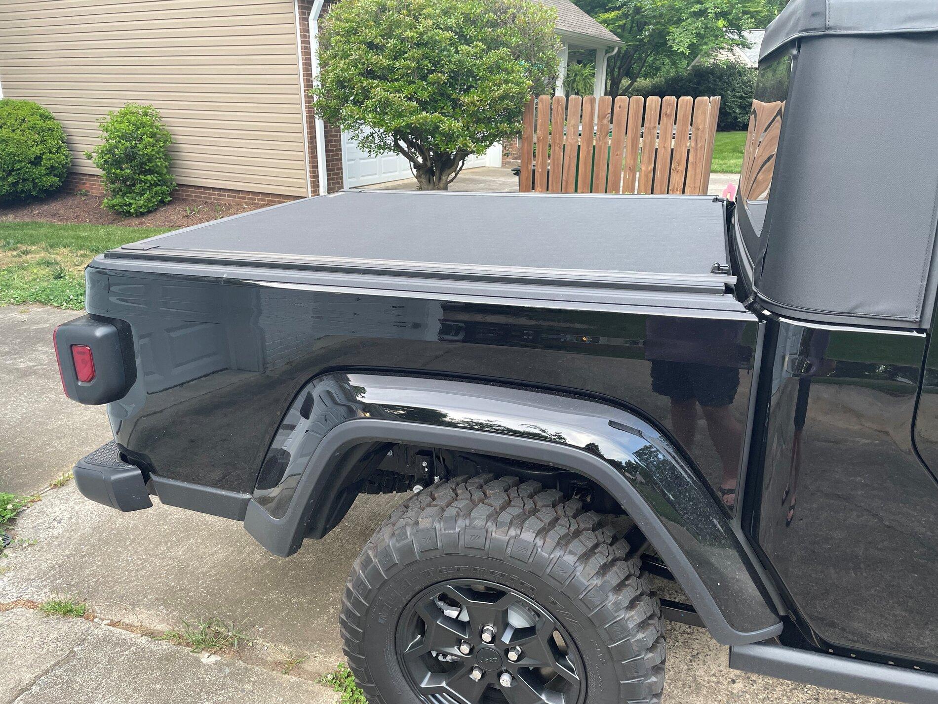

Other comments from reading this thread, there is no additional gasket that goes on the rear, and I learned from my Tundra days with a bakflip to just always park tailgate down if it is going to rain.... that will keep your bed dry. If you park tailgate uphill, water can enter on either corner, just the nature of the beast. But, it is a really great rear seal, and works with the cover closed, feels like shutting a car down, nice seal.
That’s quality info. Thanks for sharing. Post a pic of yours if you get a chance.

Damn that looks good. Pumped for mine to get here.
