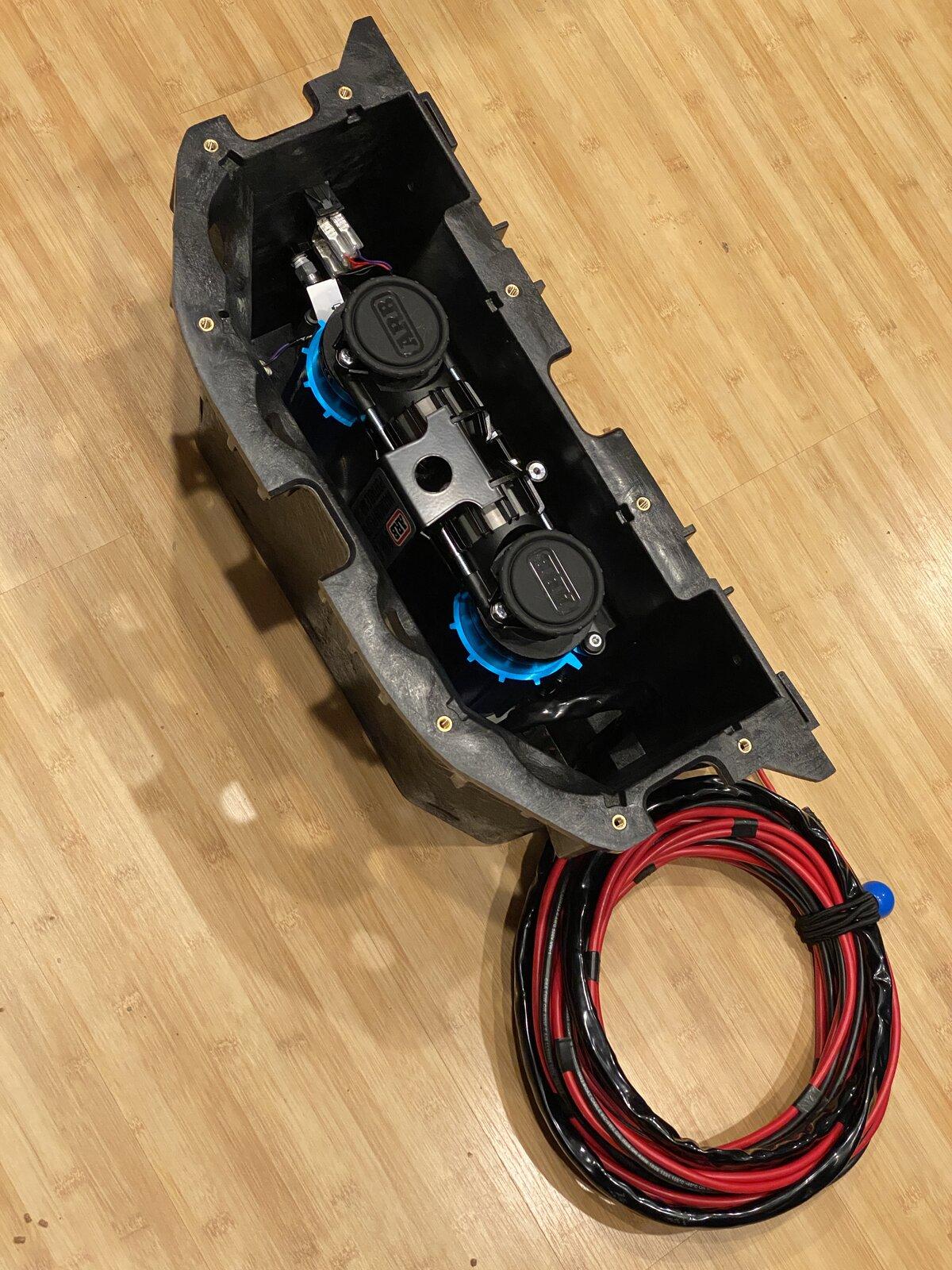

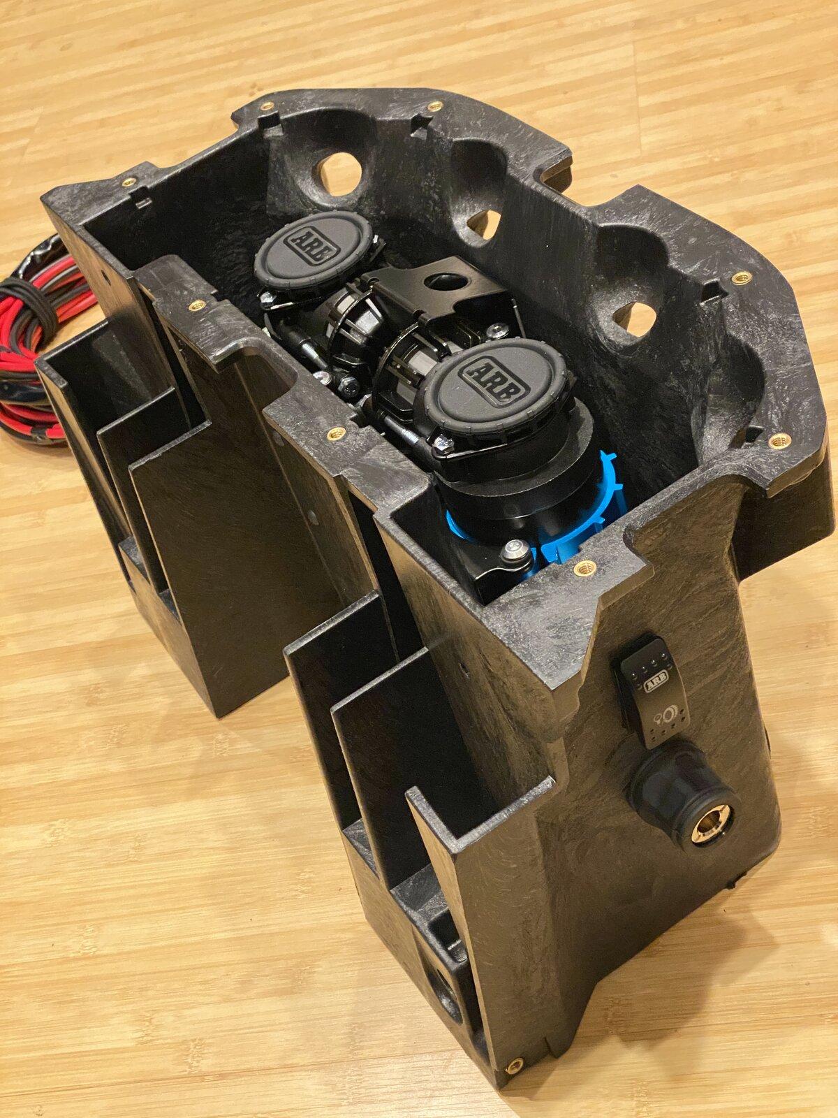

This location meets many needs for Jeep Wrangler JL and Gladiator peoples.
Easy access
Height to Keep out water and mud
Cool location to keep within operating temps
FREE
FREE
Looks cool.
What model ARB compressor is that?
