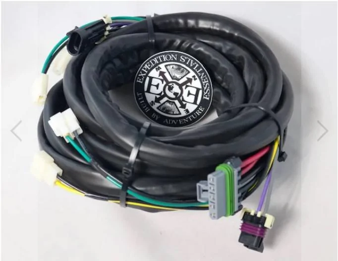

Expedition Essentials ARB Twin Harness (I could have made this but I was having a hard time finding the wire connectors and I want a nice clean install). They also offer a 10% military discount which was nice.
I made my own just to clean it up.
putting this info here for someone that might want to make their own in the future.
3-Pin Metri-Pack 150 Series Connector
https://www.amazon.com/Delphi-Metri-Pack-Connector-Sealed-Waterproof/dp/B07DZ2L4JK/
APTIV Metri-Pack 280 Series 5-Conductor 30Amp Connector w/10 12,14,16,18,20 AWG (5 Pin) Housing Sealed Set (14 16 GA) Brand: Aptiv (formerly Delphi)
https://www.amazon.com/Delphi-Metri-Pack-5-Conductor-Connector-Housing/dp/B07P2CSY6P/
Delphi Metri-Pack 150 Series 3-Way Connector w/16-18 AWG Sealed Waterproof Set
https://www.amazon.com/gp/product/B07BMVDCJ8/
I needed those 2 days ago lol. Thank you for posting the information though. Hopefully it will help others out.

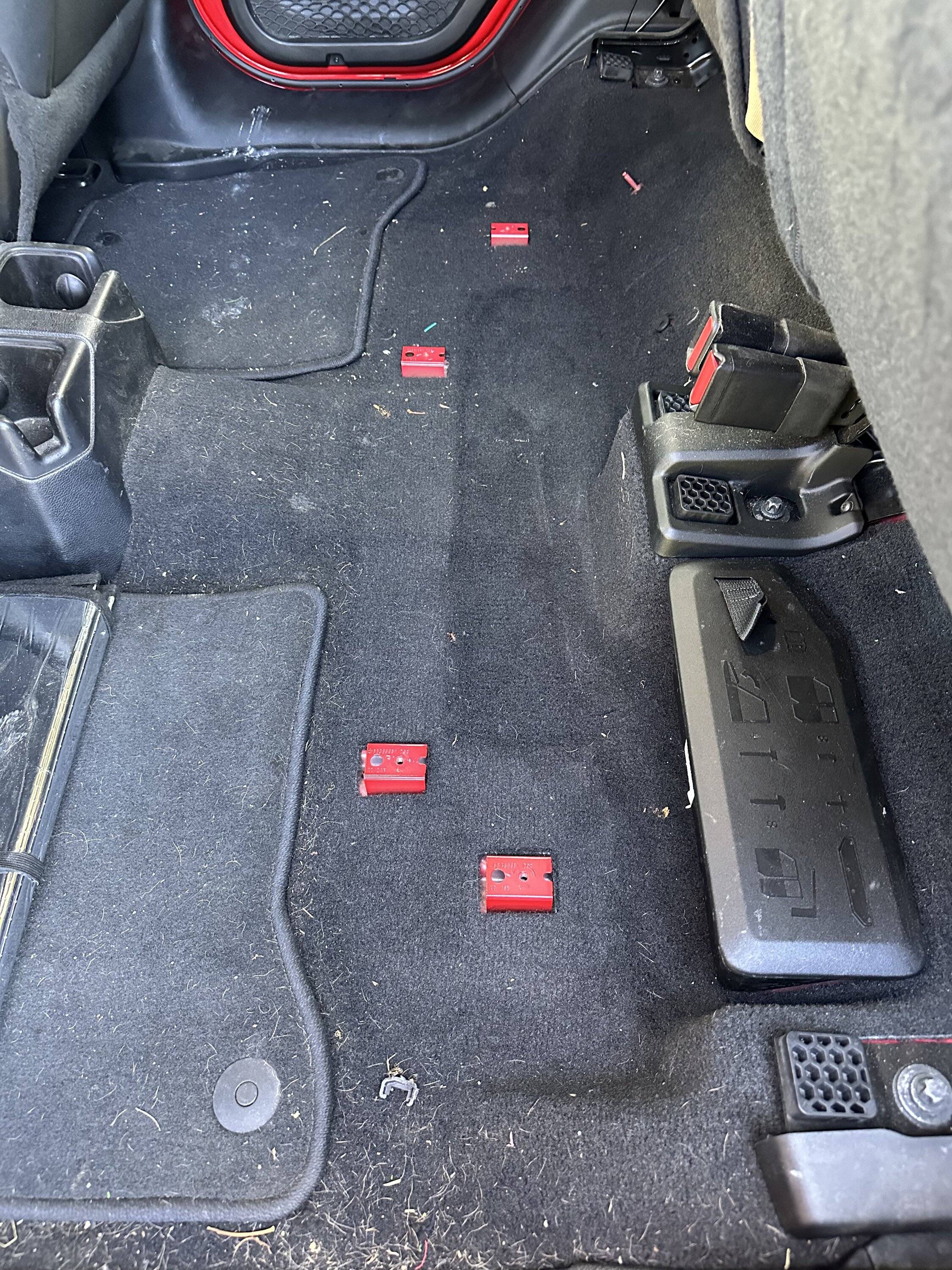

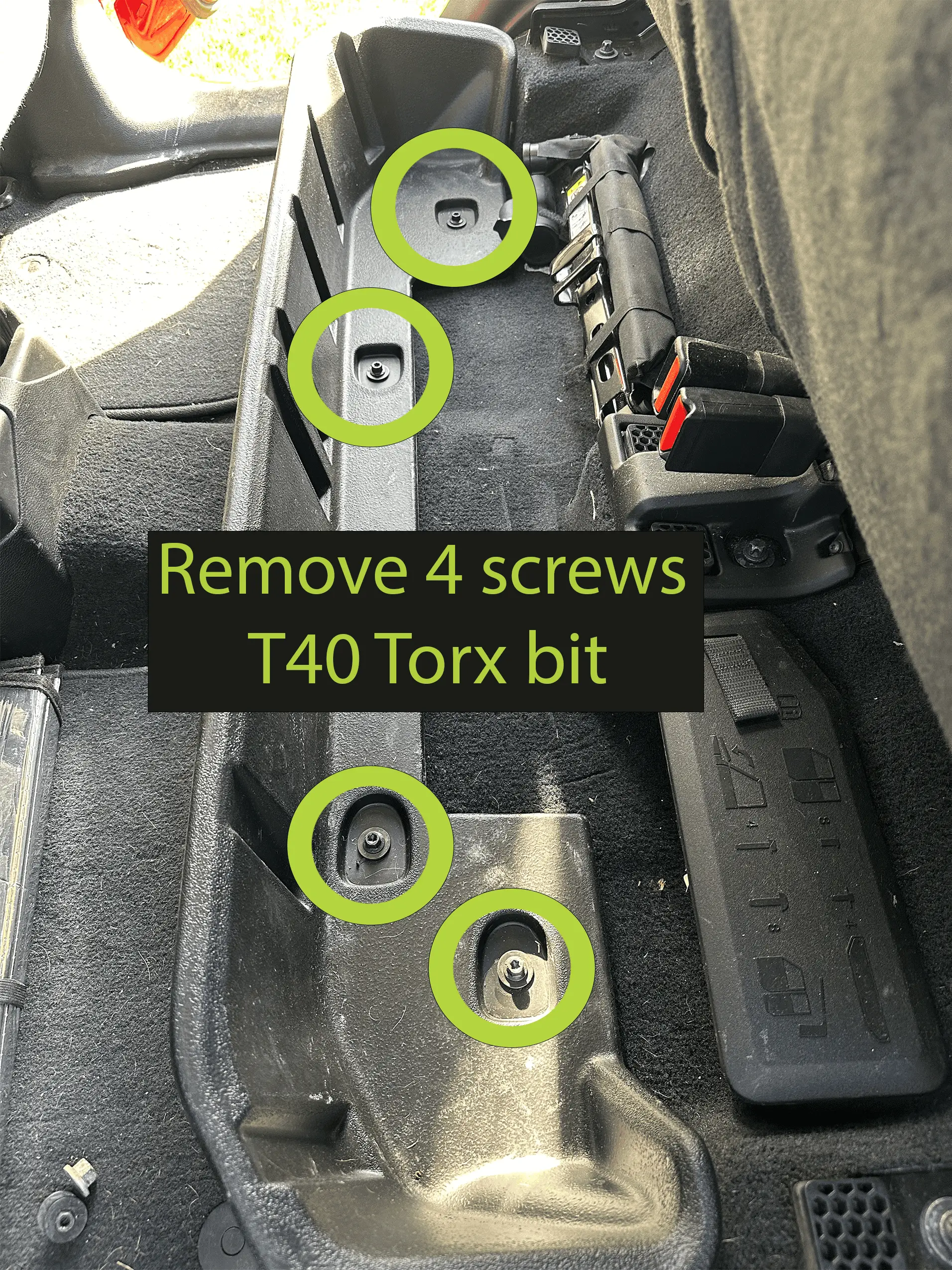

I have a delivery coming in tomorrow from @813 Fabrication & Design. To prepare for it's arrival I went ahead and removed the under seat storage. This is probably the easiest thing to remove in the Gladiator.
It took about 5 minutes to remove it, that included getting the tools, thinking to myself I need to cut my grass tomorrow, wondering what's for dinner, taking the screws out, removing it from the Gladiator, wondering what I am going to do with it now, and finally putting the storage piece in my garage to decide its fate later. Needless to say, it takes really no time at all.
To remove the under seat storage I used a ratchet, extension (really do not need this but it does give you room to work), and a T40 Torx bit. You simply remove 4 screws and it comes right out.
The jack and tire removal tools are also going. With my lift and tires they are pretty much useless now.
Jeep Gladiator ARB dual compressor rear seat install with 4XE air conversion cowl. under seat storage removal
Yup, needs a quick vacuum and some new floor mats.
Jeep Gladiator ARB dual compressor rear seat install with 4XE air conversion cowl. IMG_0529
