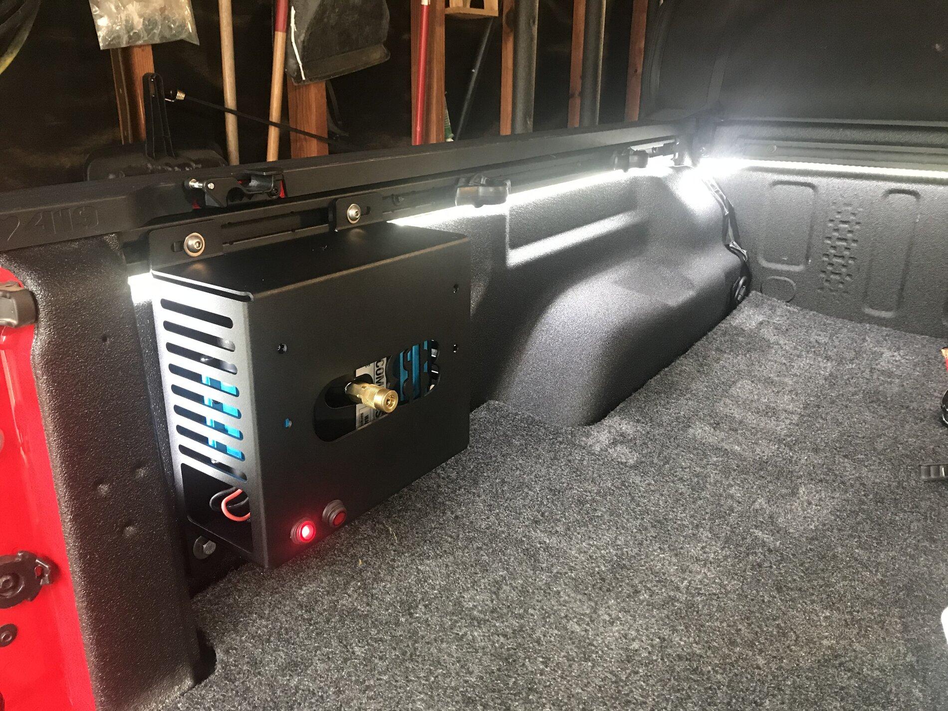

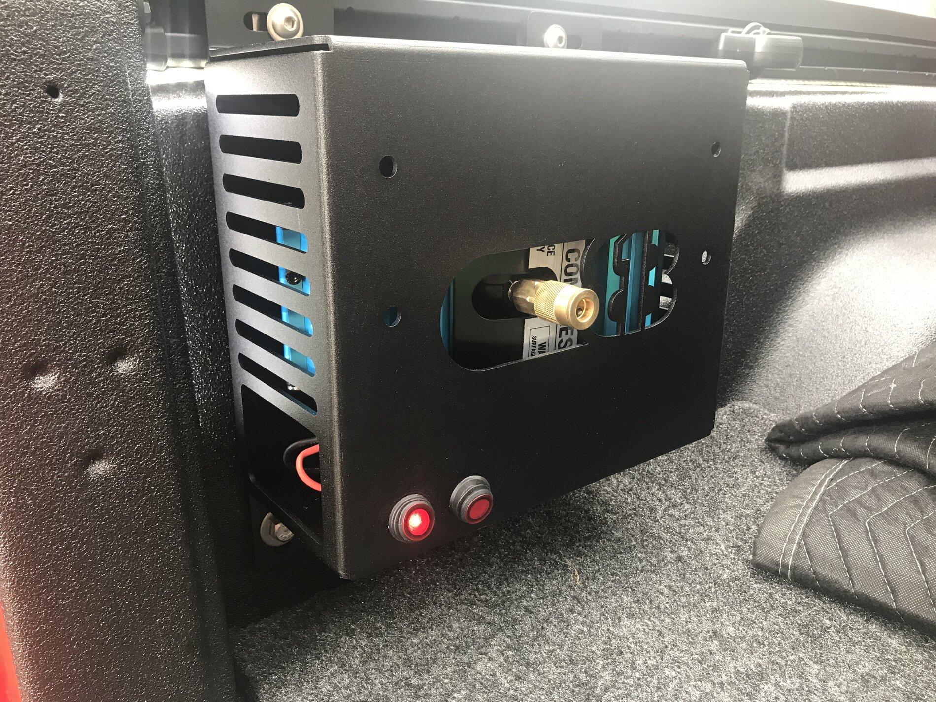

I installed my ARB in the Truck bed. Didn't need the air for lockers. so just for an air supply. Waiting on tank to arrive to install.

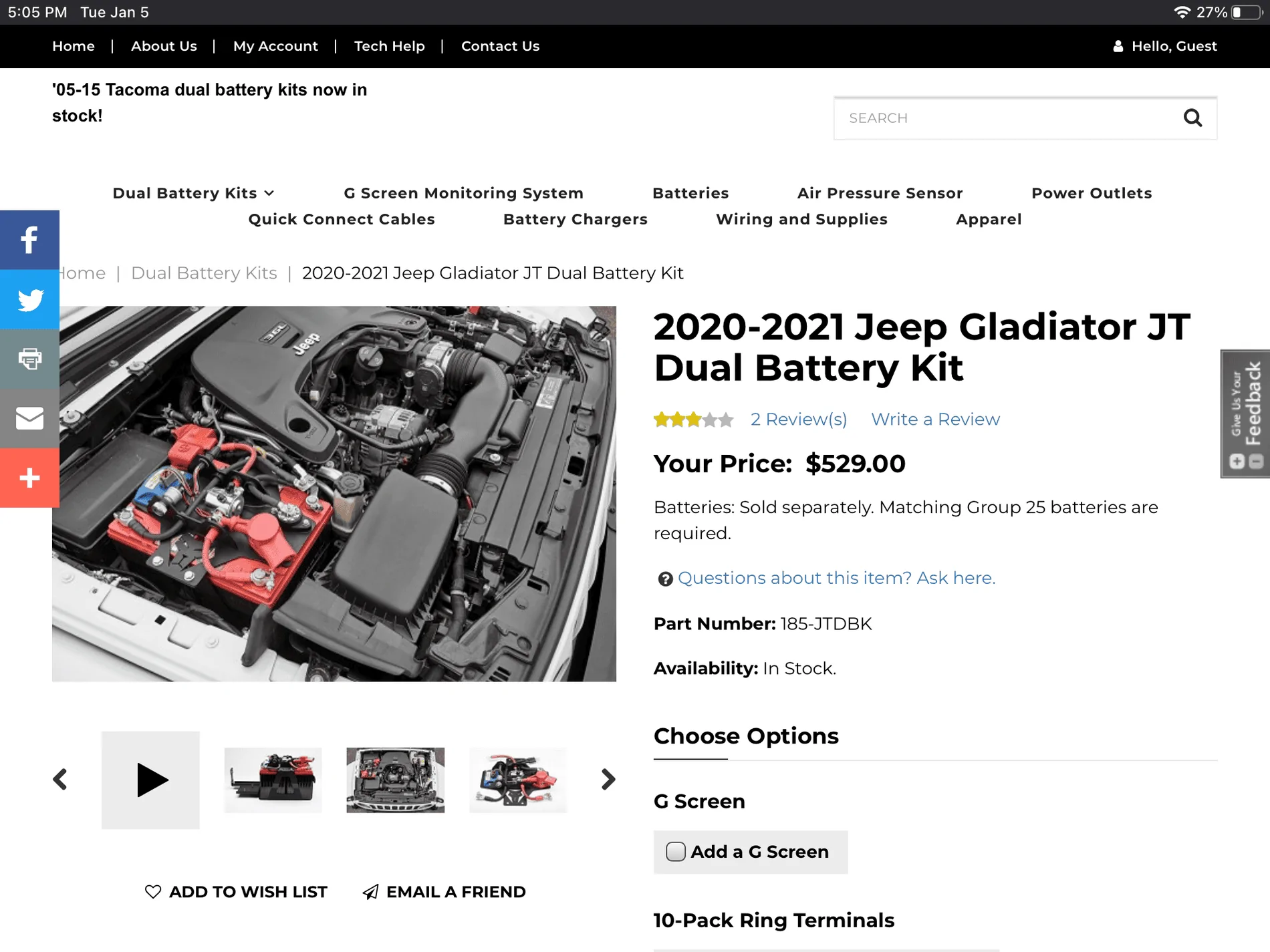

What the heck kinda battery and setup is that? Looks......powerful

I used the genesis battery box with a hellroaring solid state battery isolator/combiner.

You got the Genesis Dual Battery kit at a discount? When? (Never seen them do that)

Got batteries at discount. Only got the genesis battery box from genesis. The other components I already had.

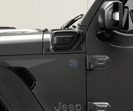

Hey, I know this is an old post but what do you all think about using the cowl that Mopar has made for the new Wrangler 4xe ?
Looks a lot like the concept but with a door.
I’ve already reached out to 813 about using his under hood kit with this.
Hopefully the cowl will be available as a part soon.
