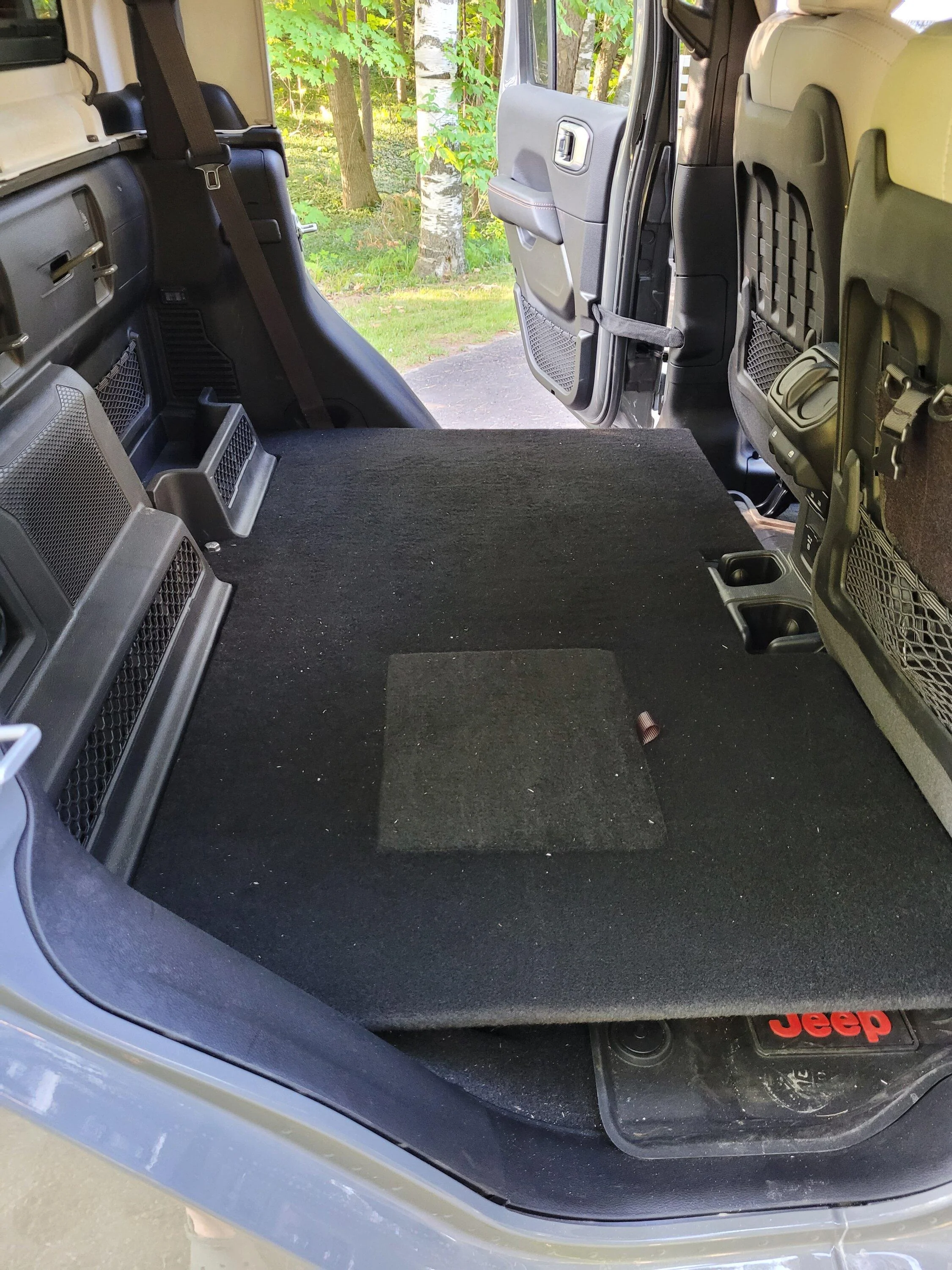

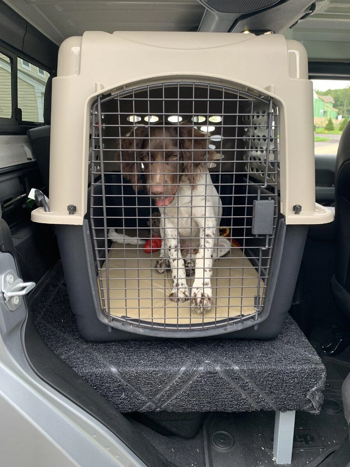

Got mine done. Only needed to remove the 60% seat to get enough room for the dog crate. So happy with it and thankful for people that tackle these projects first to make it easy for guys like me.

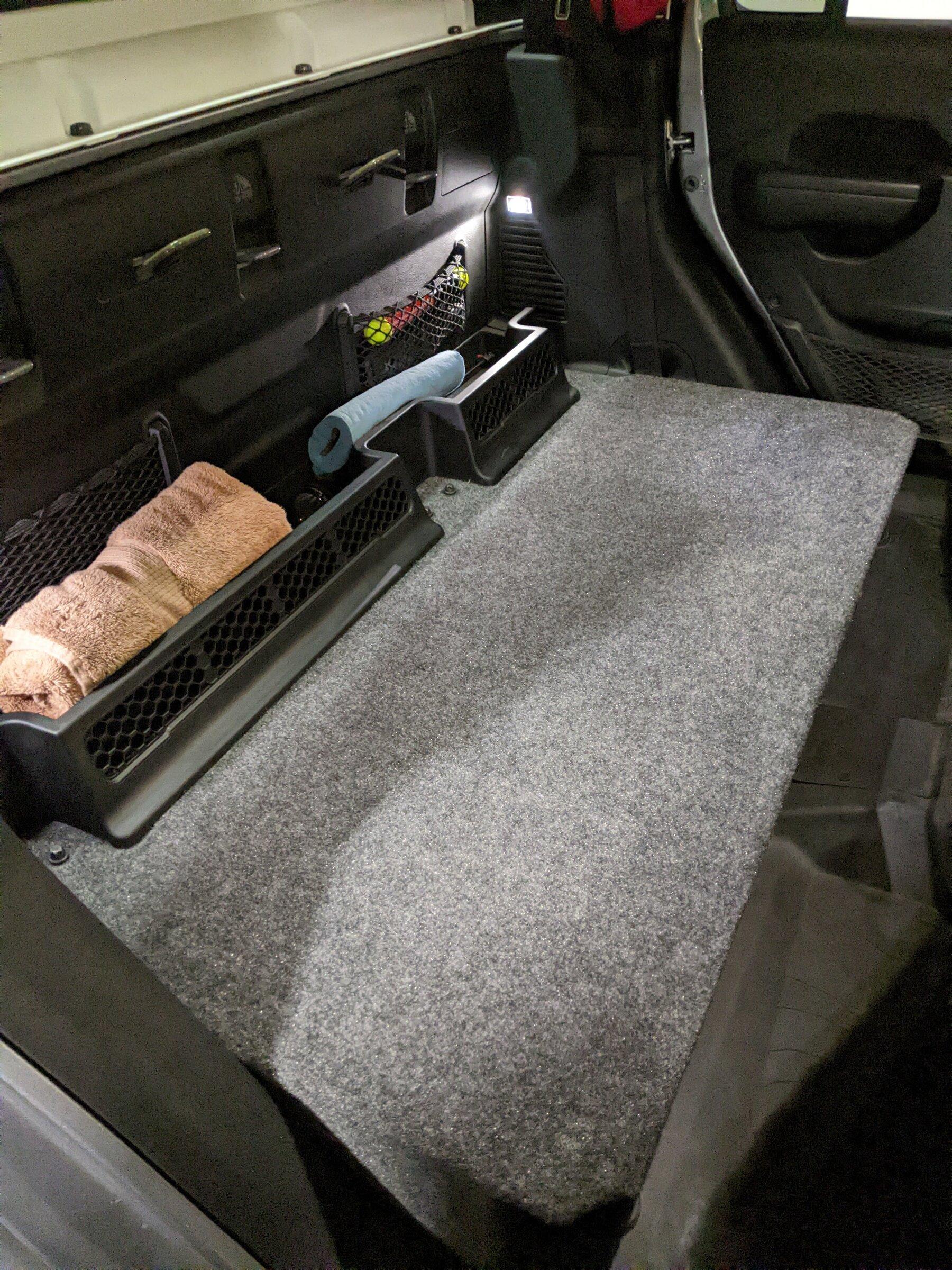

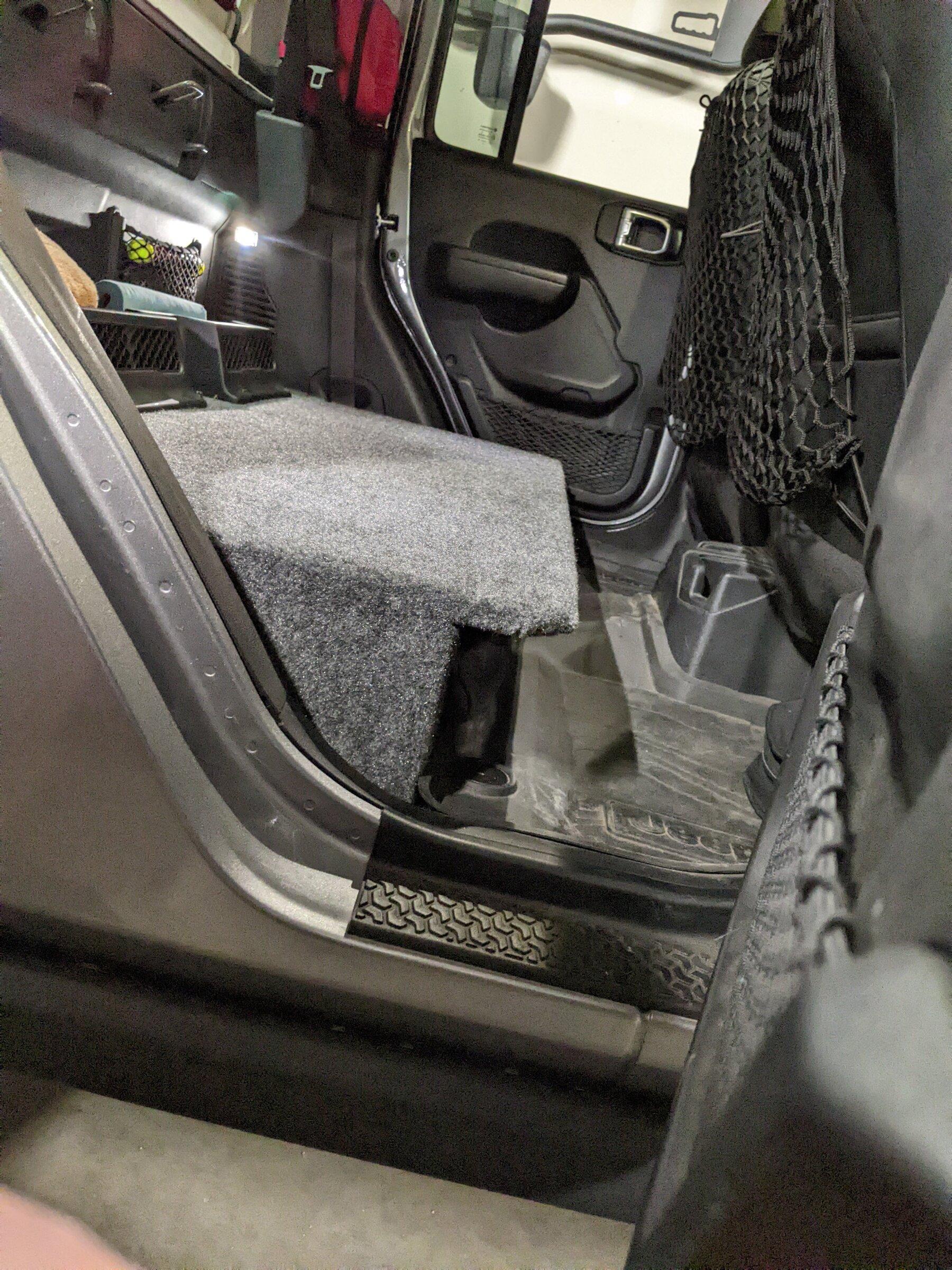

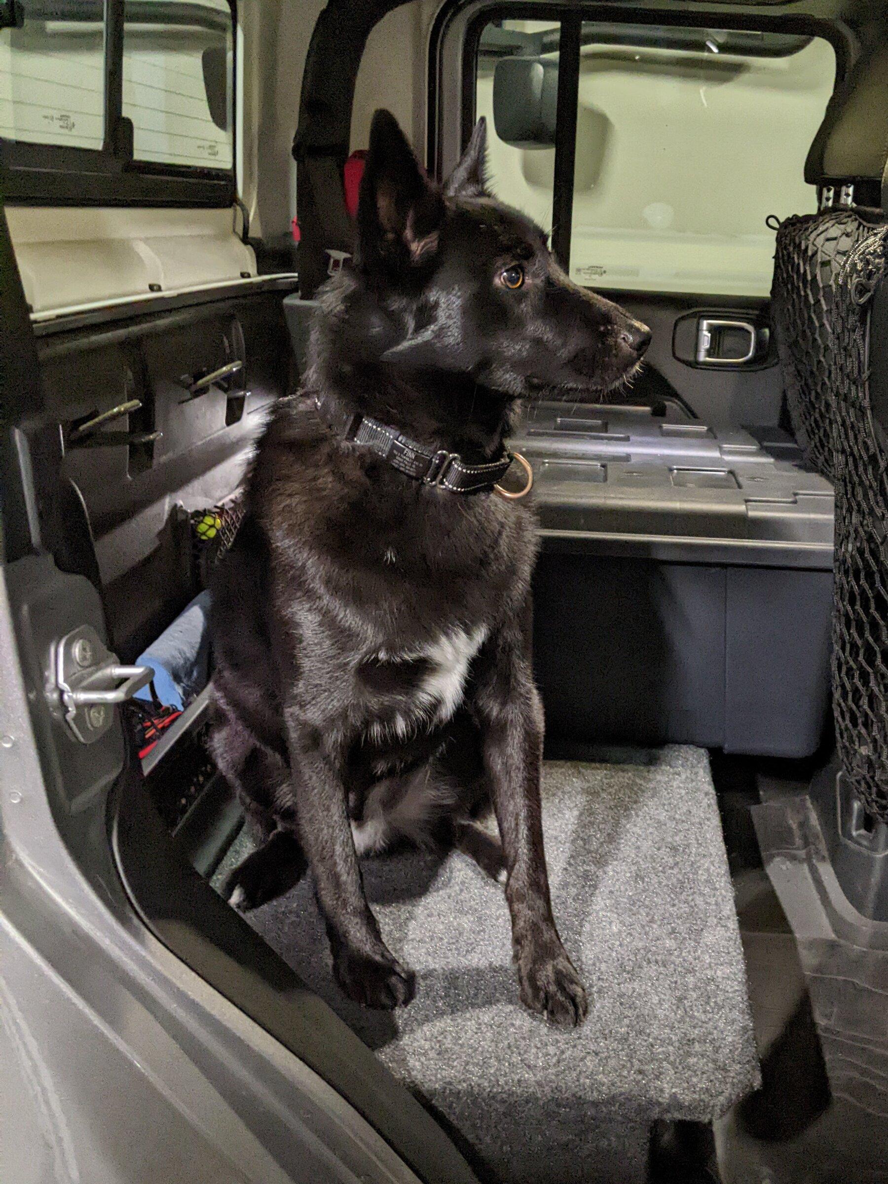

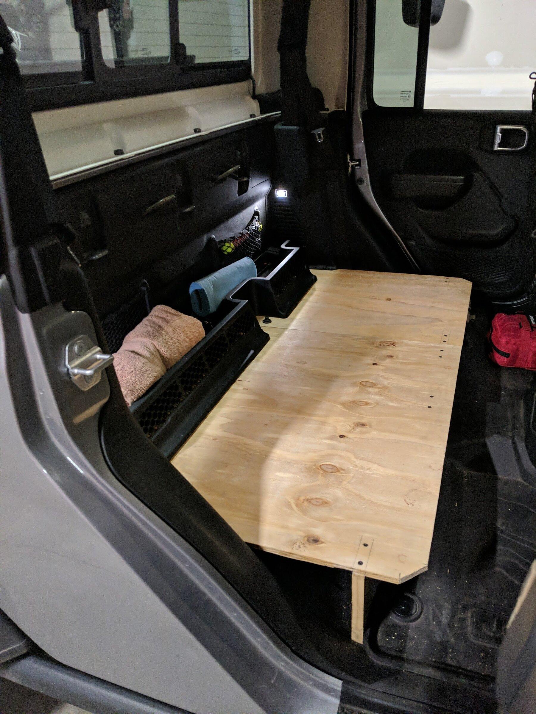

Thanks everyone for all the great info and pics on this thread. Here's mine. Wanted to keep it simple and easy to replace the seats if needed, so no complex/large pieces here, just the single 60/40 pieces with the legs attached to them (so I can choose to keep the 60 or 40 portion of seats with a partial platform depending on the trip/use).
I decided on this route since you can still get access to all of the space under the platform from the front, you maintain access to the areas beneath the front seats (more storage), and someone could sit on the platform and still put their feet in the footwell in a pinch. Hopefully my pup doesn't mind the awkward portion of platform to jump onto when getting in from the outside, but we'll find out tomorrow after I put carpet on it.
If anyone's looking to mimic it, my platforms 1/2" thick and 24" deep (front to back) so you can get a couple pieces from HD/Lowes fairly cheap (around $30 in today's market).

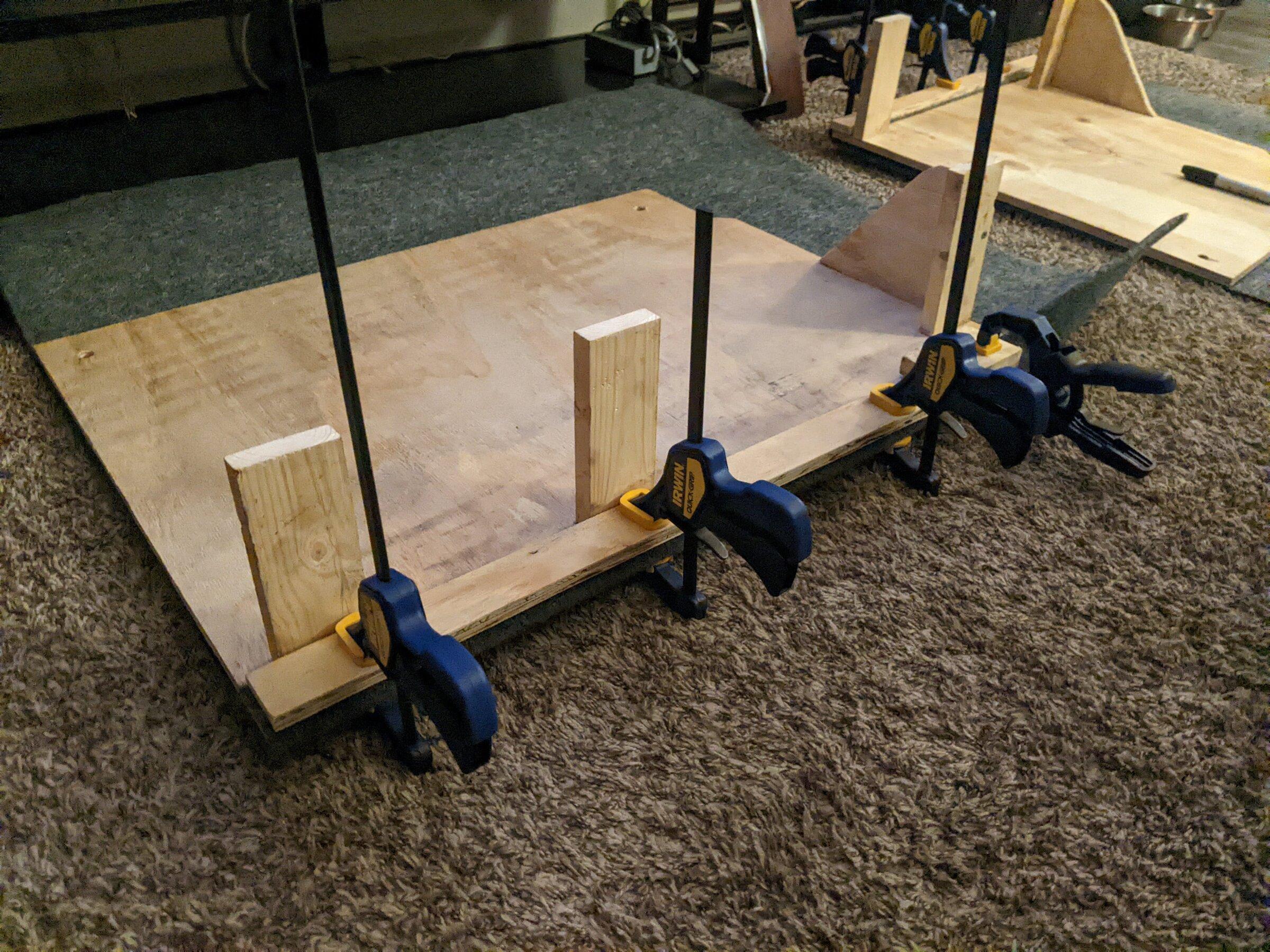

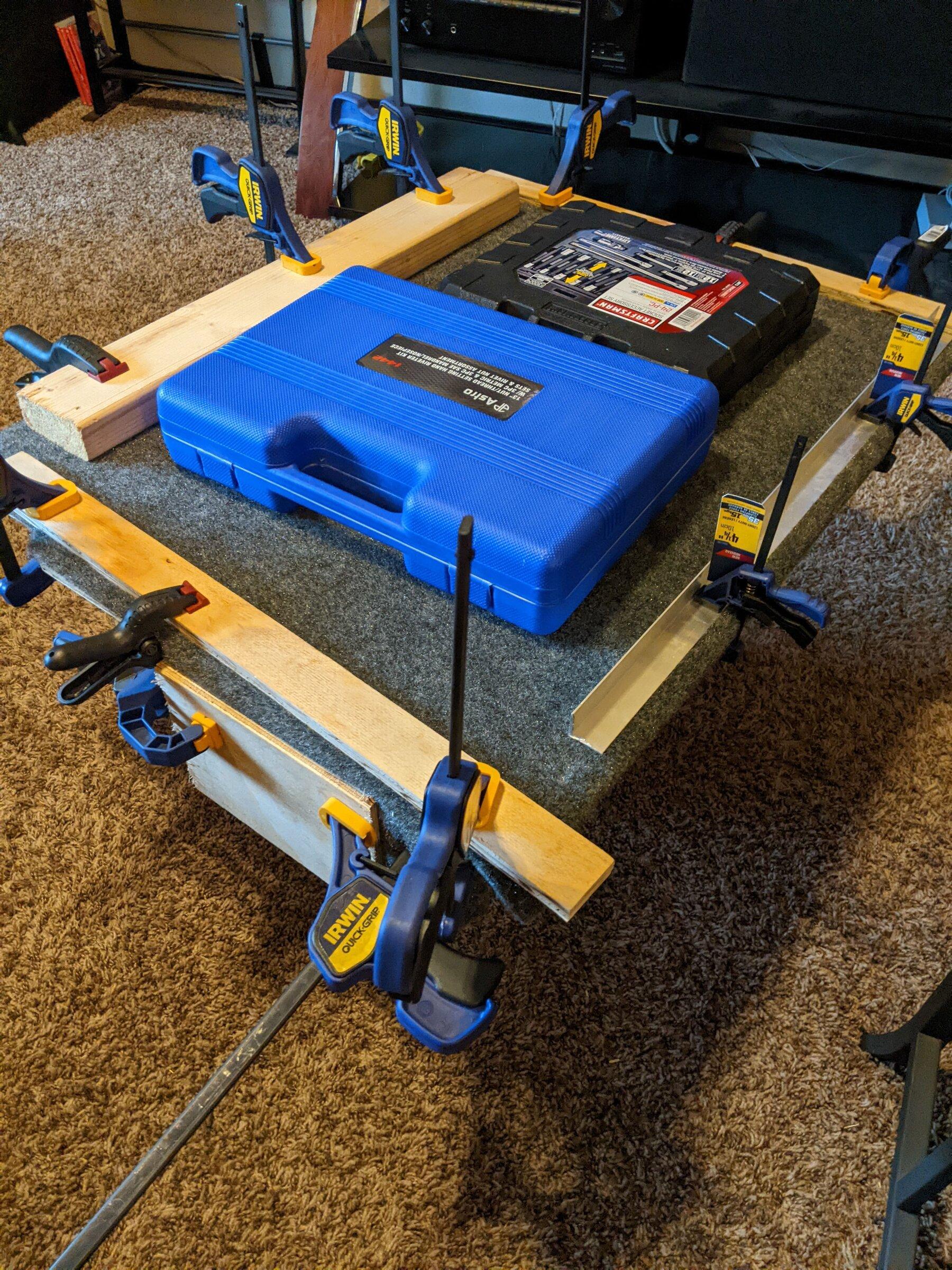

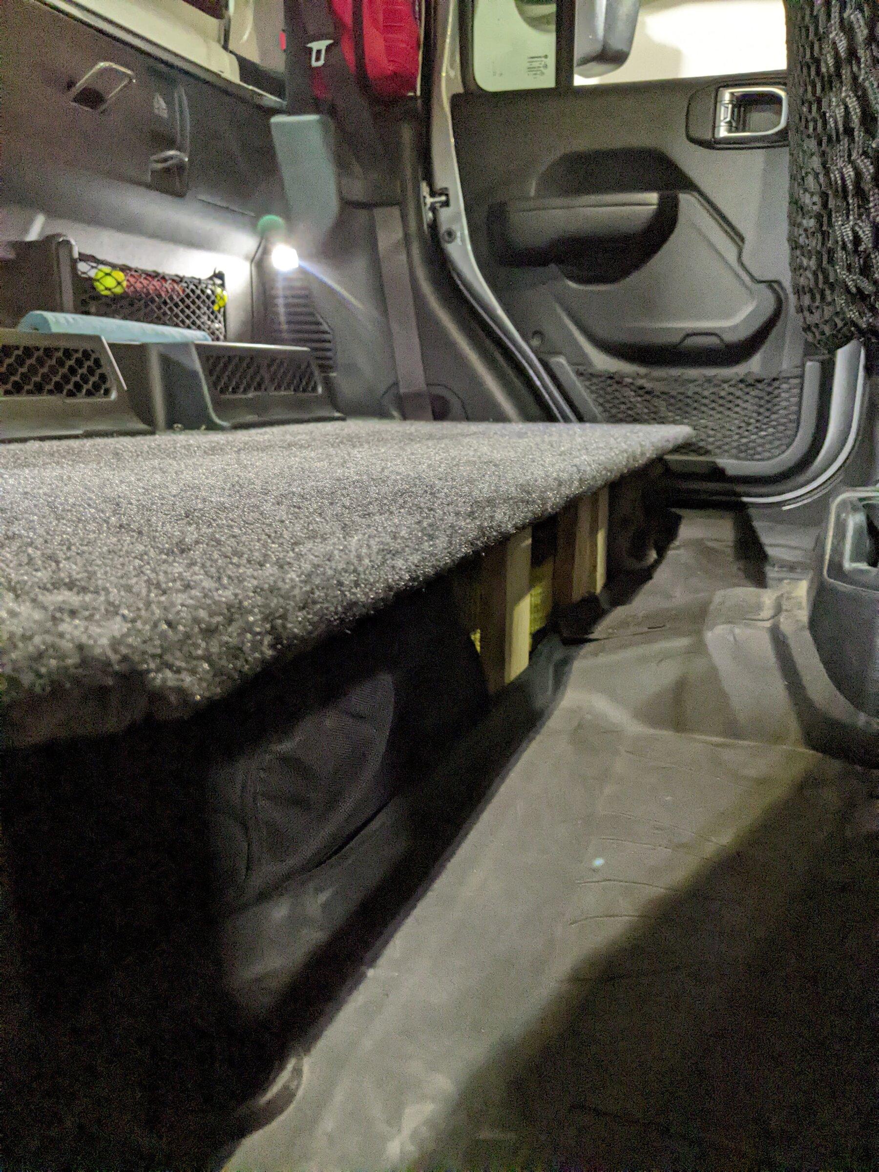

a few more pics after getting the carpet attached. For $30 bucks of plywood and some spare carpet I had from my truck bed divider board I'm happy.
The first couple pics is just how I clamped the carpet down while the gorilla glue set beneath it.
Jeep Gladiator Rear Seat Platform (After Rear Seat Removal - Rear Seat Delete) PXL_20220430_185350251
Jeep Gladiator Rear Seat Platform (After Rear Seat Removal - Rear Seat Delete) PXL_20220430_042204032
Jeep Gladiator Rear Seat Platform (After Rear Seat Removal - Rear Seat Delete) PXL_20220430_205543021
Jeep Gladiator Rear Seat Platform (After Rear Seat Removal - Rear Seat Delete) PXL_20220430_205646645.MP
Jeep Gladiator Rear Seat Platform (After Rear Seat Removal - Rear Seat Delete) PXL_20220430_205517634.MP
Edit, pup approved

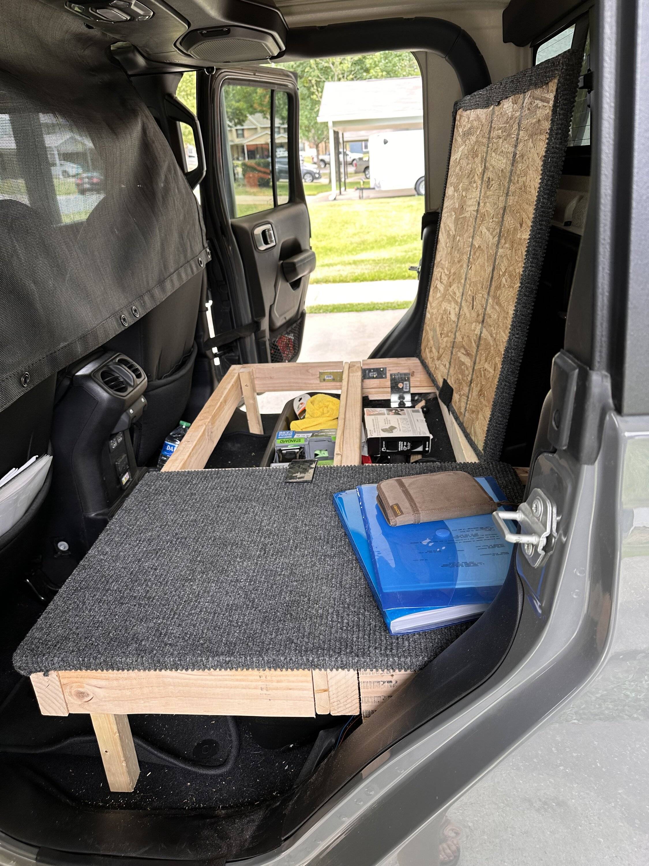

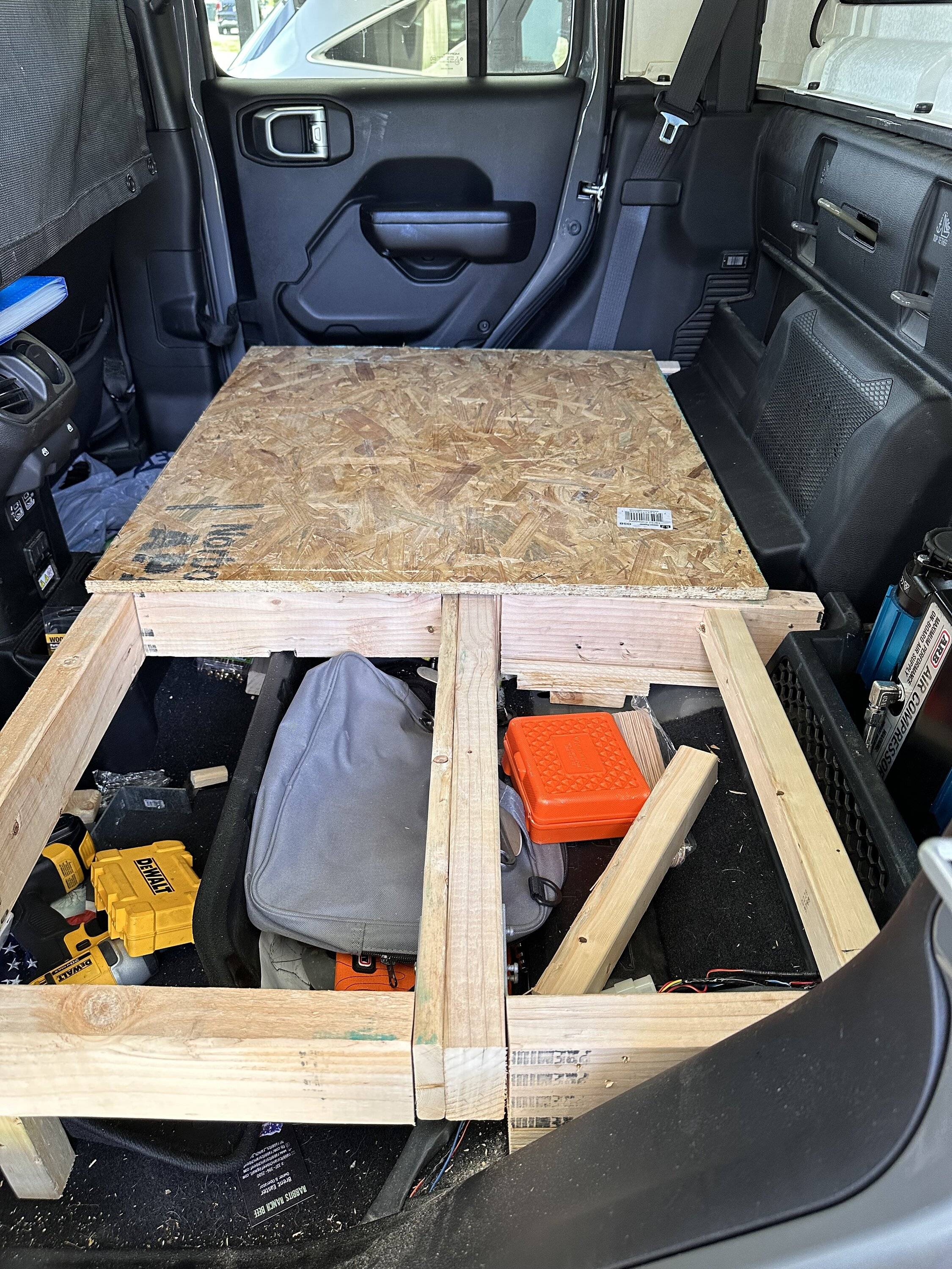

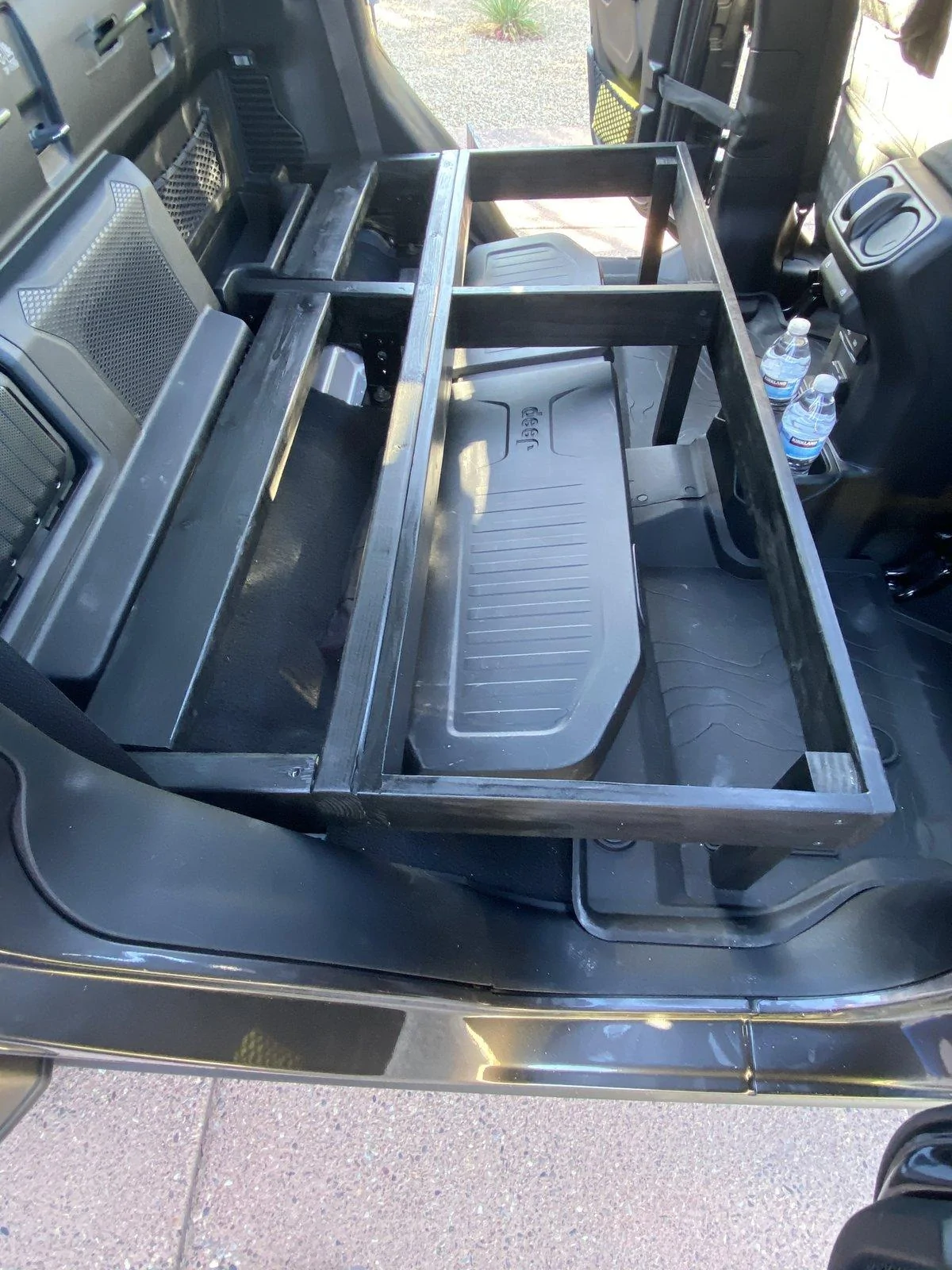

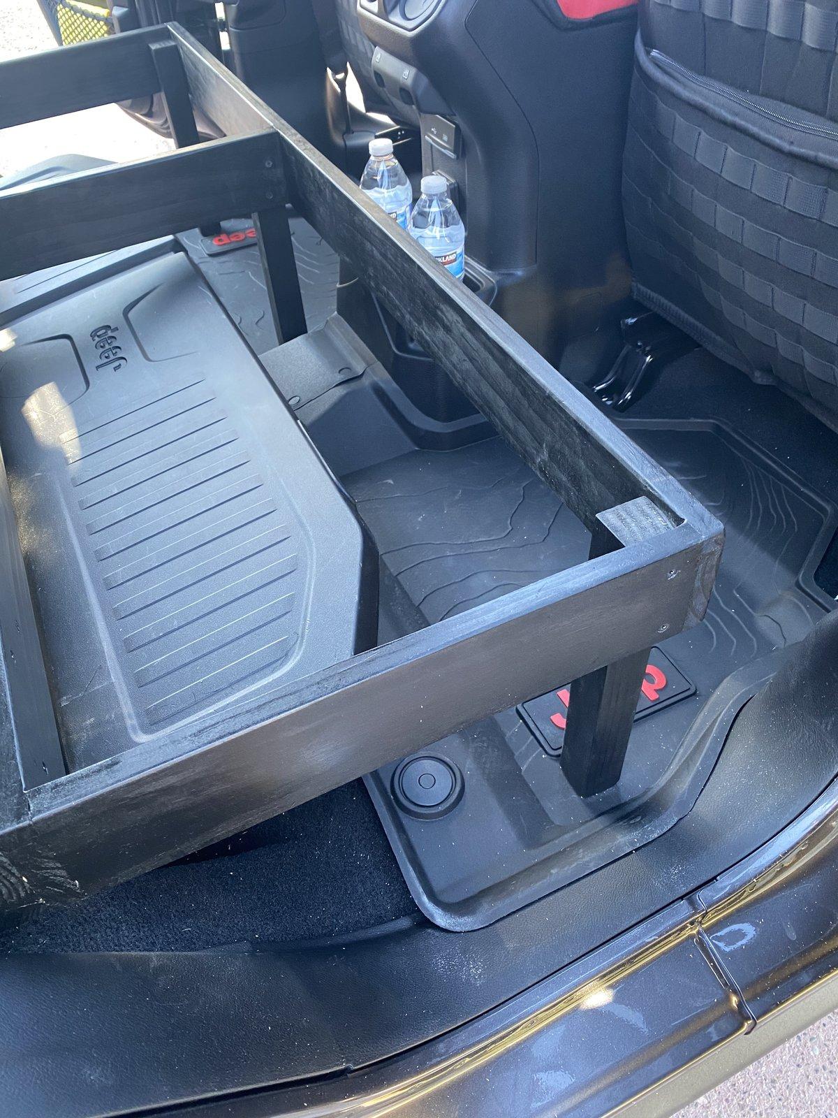

Here's the frame with 3 legs...
Jeep Gladiator Rear Seat Platform (After Rear Seat Removal - Rear Seat Delete) 20220710_193037
Those downlegs are sorta small, you're not distributing the load as well as you could of you out a board under them across the floor, it would decrease the PSI directly under the legs
JRobes
Oct 27, 2019
934
1,469
South Dakota
Enginerd
You're not wrong, but at the same time I don't think he'll be loading a walrus in there. The legs are supported by the steel sheet cab directly below the carpet, it's fine as is. Plus, the wider the legs, the more you block access from the front.
Teqsand
Todd
Nov 25, 2021
36
812
1,004
SoCal
21 JLURD & 22 JTRD
Bum
Is it steel or is it aluminum? If the latter, it can tear.....
Plus he might adopt a walrus someday
Jeep Gladiator Rear Seat Platform (After Rear Seat Removal - Rear Seat Delete) 8E57E9E6-77D4-4F8D-9EC6-DD721AB76341
Is that a munsterlander?
paulsoncall
Paul
Jul 7, 2021
Rhode Island
Gladiator Overland
Yes, heā€™s a small munsterlander. I just recently got a cap for my Gladiator so my hunting buddy now sits in a crate in the truck bed.
