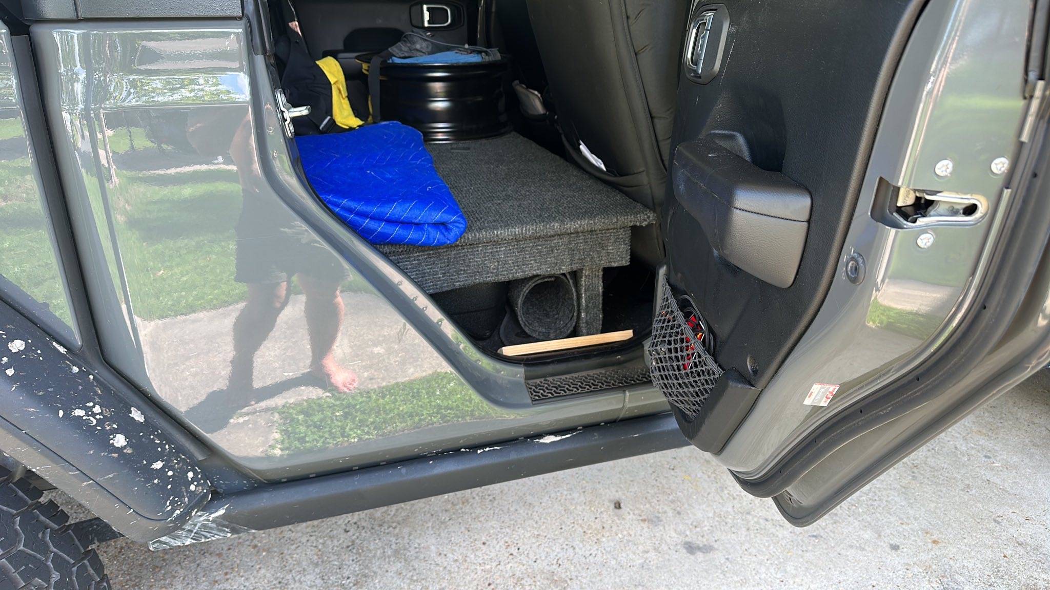

In my previously posted thread I explained how I removed the rear seats (rear seat delete):
https://www.jeepgladiatorforum.com/forum/threads/rear-seats-removal.22980/

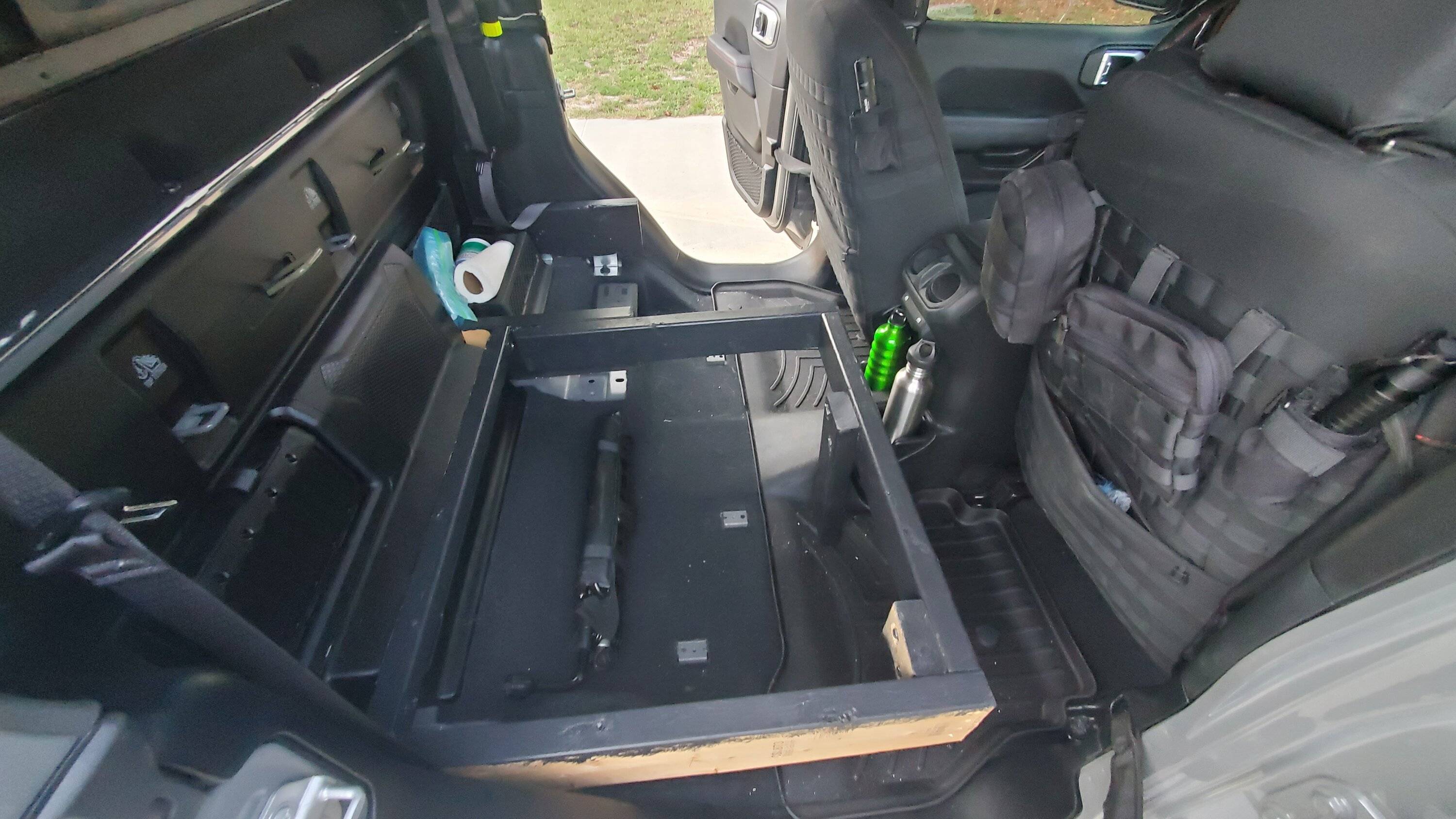

In this thread I'll show you how I built a Rear Seat Platform that provides access to the storage containers on the floor as well as the bolts used to secure the platform to the Gladiator's floor (same bolts used to secure the Rear Seats to the floor).
Here's what the Rear Seat Platform looks like now (nearly done except for trimming of the mat on the Platform):
Lots of flat storage space!

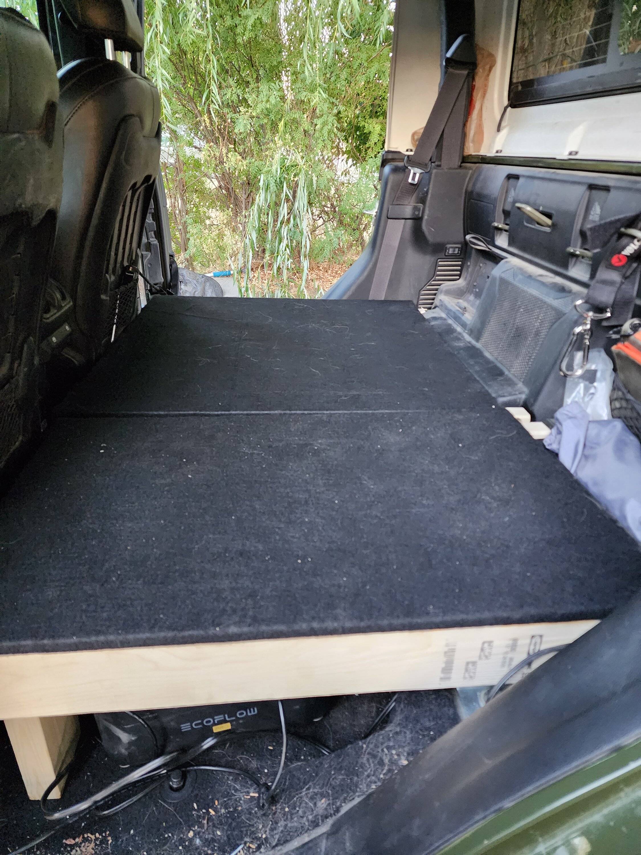

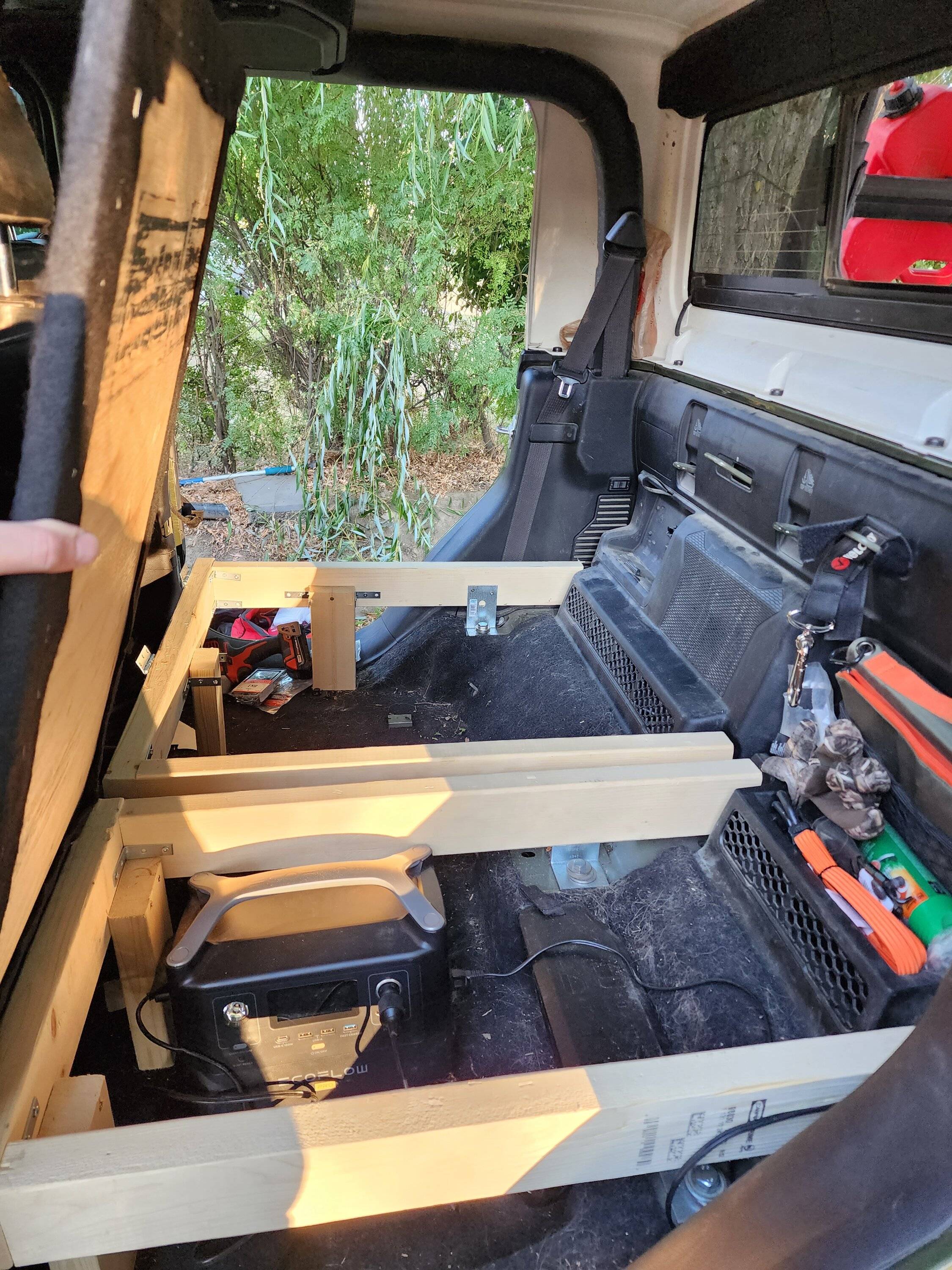

I took the OP‘s idea and made a similar set up. Also I’m not the best carpenter.
still need to attach the tops. I’m trying to figure out a good way to attach piano hinges to the set up.

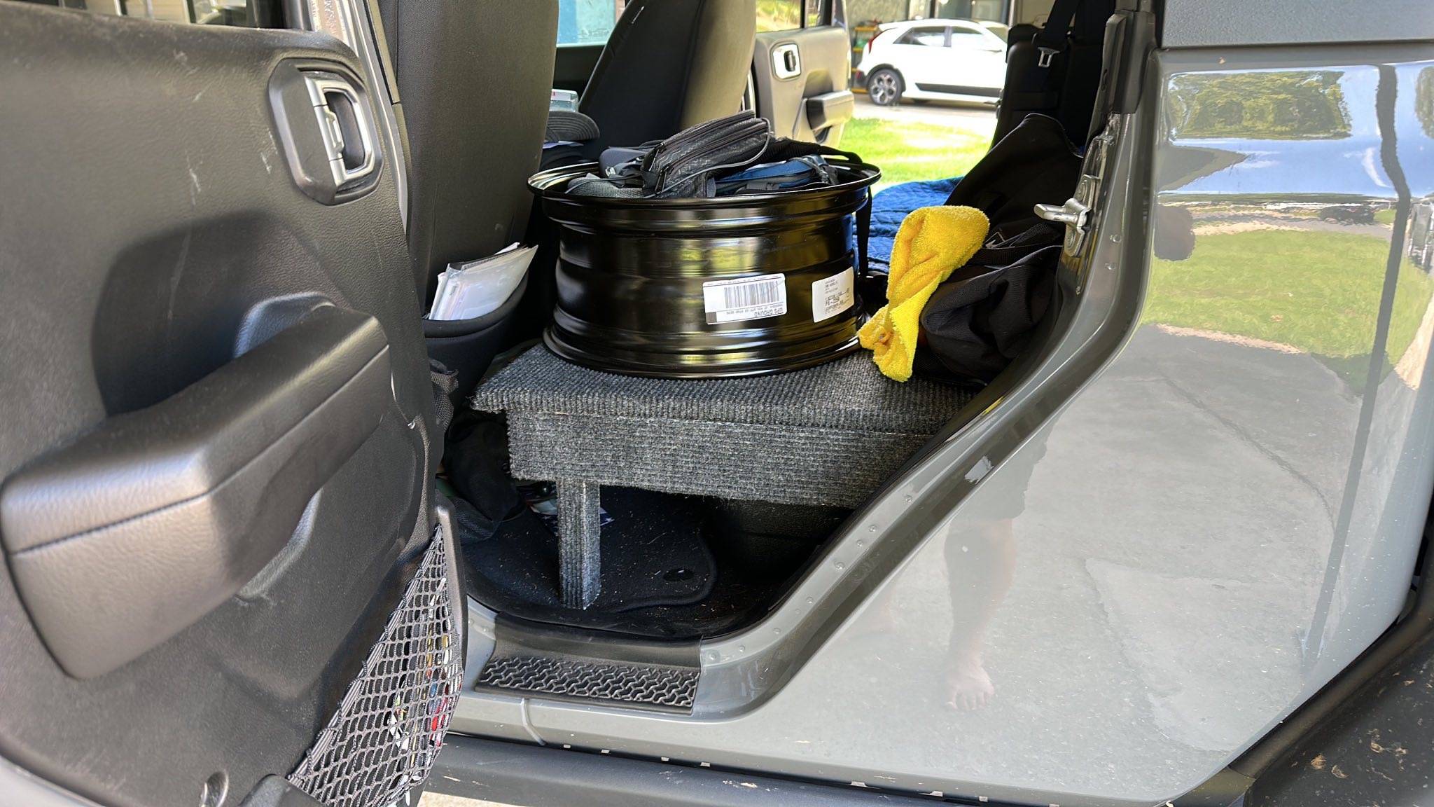

Thanks for the info. I did manage to install a hidden hinge on the 40% section. On the 60%, it is more a friction hold than anything else. The upholstery that I added and the overall design that portion isn’t going anywhere and I found out I actually like having that on hinge at the center line of the vehicle vs back of the seat side.
I also finished upholstering the platform. Legs, frame and platform top are good to go. My dog kind of enjoys the platform and I could imagine that the platform is way better to get carried around on vs the seat/hammock setup we used for years.
Jeep Gladiator Rear Seat Platform (After Rear Seat Removal - Rear Seat Delete) IMG_0255
Jeep Gladiator Rear Seat Platform (After Rear Seat Removal - Rear Seat Delete) IMG_0256
Jeep Gladiator Rear Seat Platform (After Rear Seat Removal - Rear Seat Delete) IMG_0257

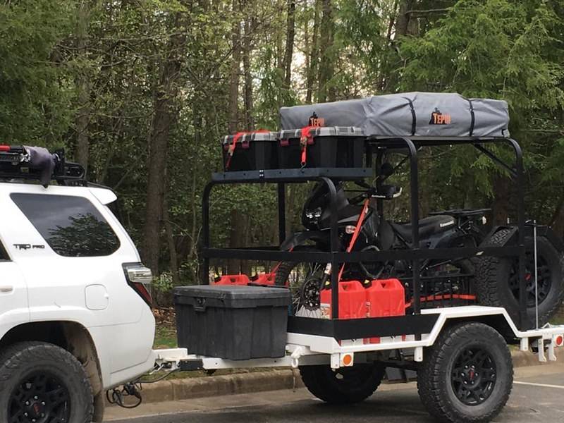

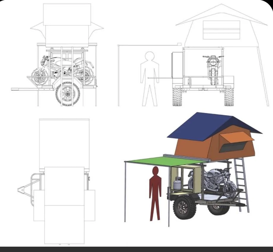

On to the next project, ”off-road utility trailer”! Basically I’m having a 5x8 utility trailer custom made so I can run 35s. I contacted a fab/ trailer maker local to me and started talking about design and concept. A dedicated travel trailer Isn’t something I am interested in since I still need something to haul a motorcycle with and random
yard or house projects. These are the concepts I have the trailer maker.

My utility trailer isn't made for off-road use. Great choice on looking to local fabrication for trailer. Mine was custom built to my specifications along lines of the company standard models , heavier duty and cost less than "box store type.

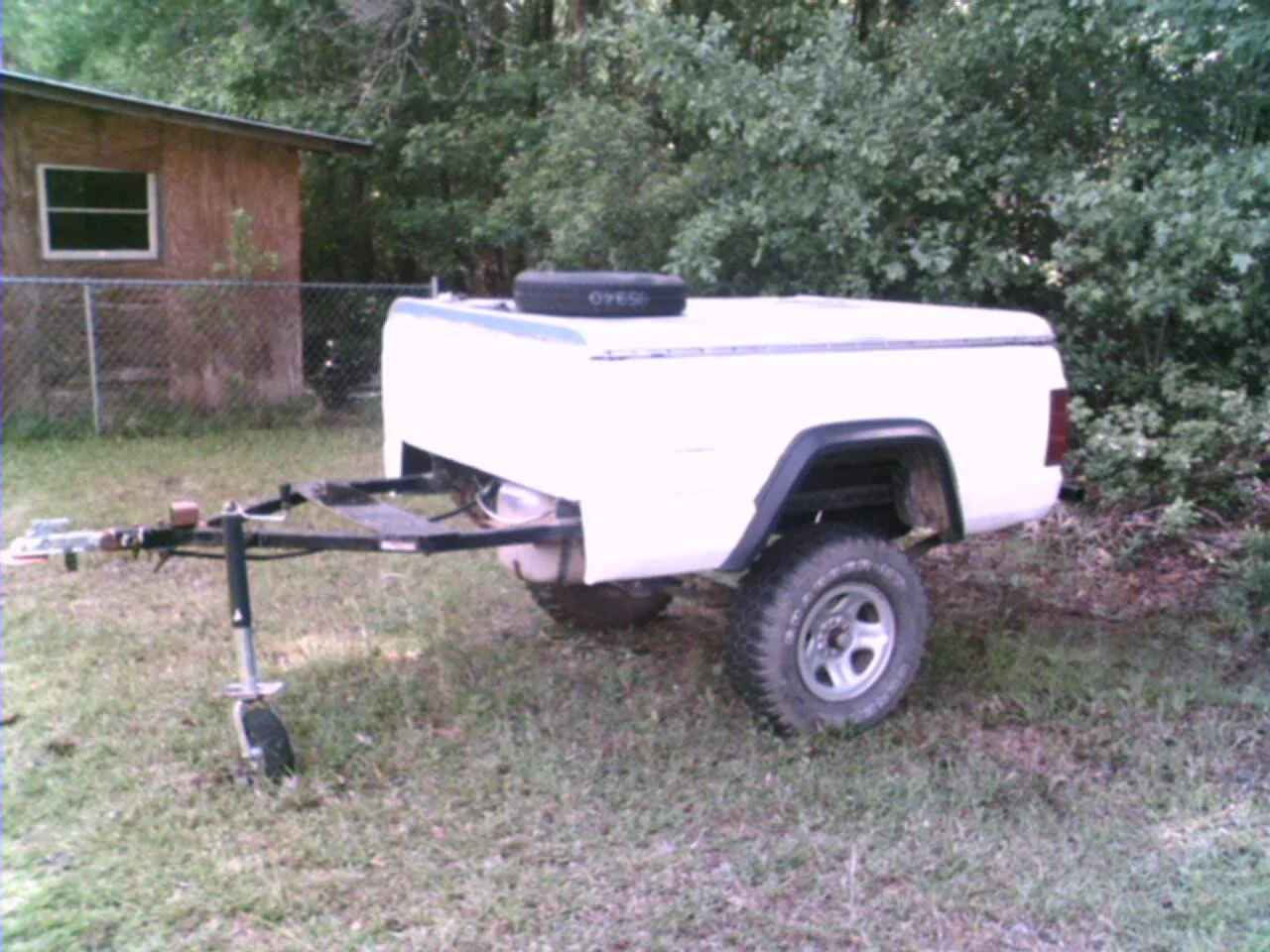

That definitely reminds me of my Comanche bed one I built for my XJ. As of on same line of use. It was made for off-road use and cargo. I used the bed, fuel tank and leaf springs but built frame and axle for it. 1/4 wall square tubing.
Jeep Gladiator Rear Seat Platform (After Rear Seat Removal - Rear Seat Delete) Photo_042706_007
FYI: if anyone sees this send me a picture, when and where it's at. Somebody really liked it too then stolen it.

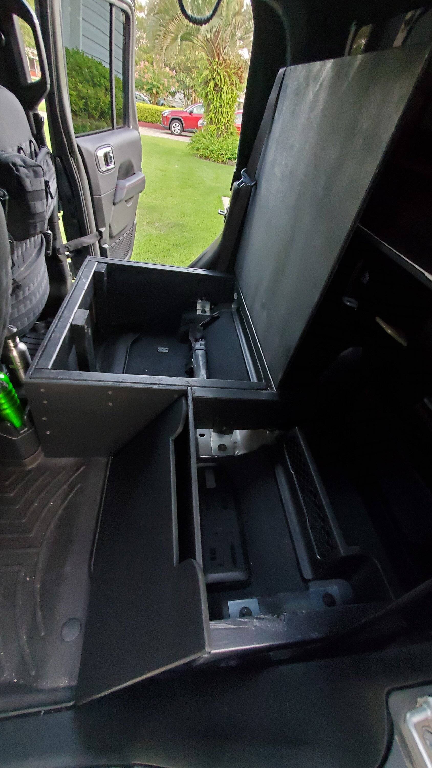

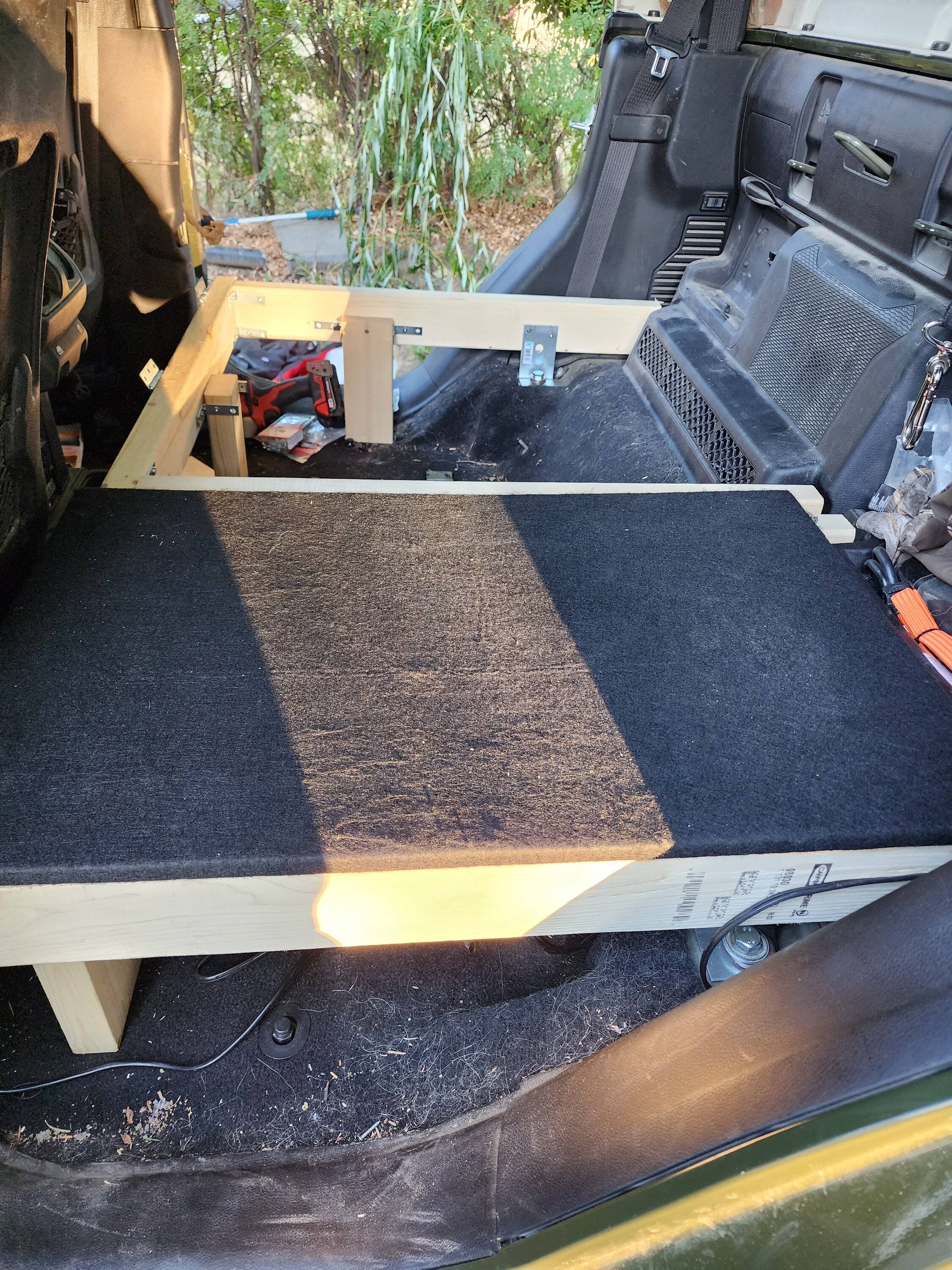

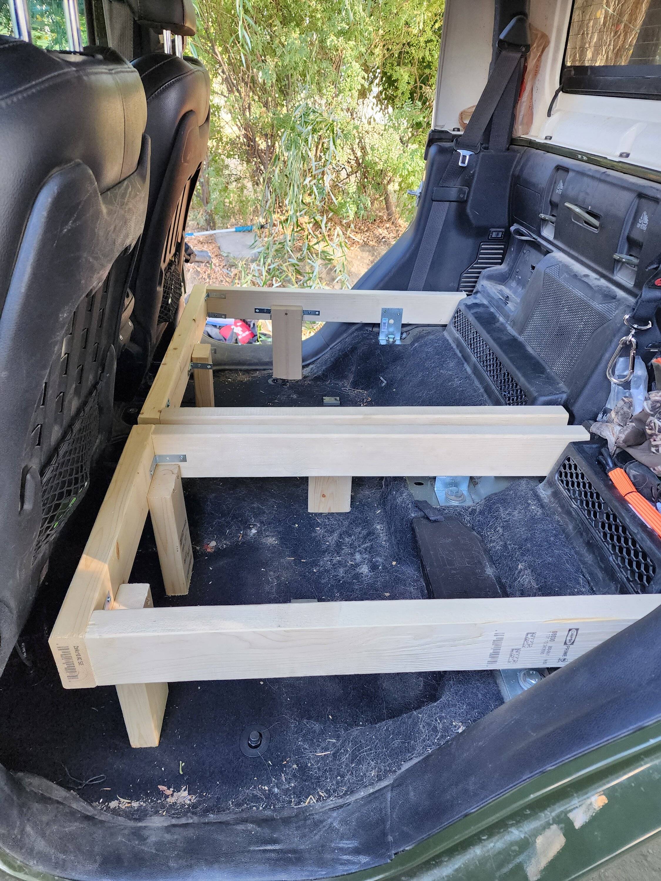

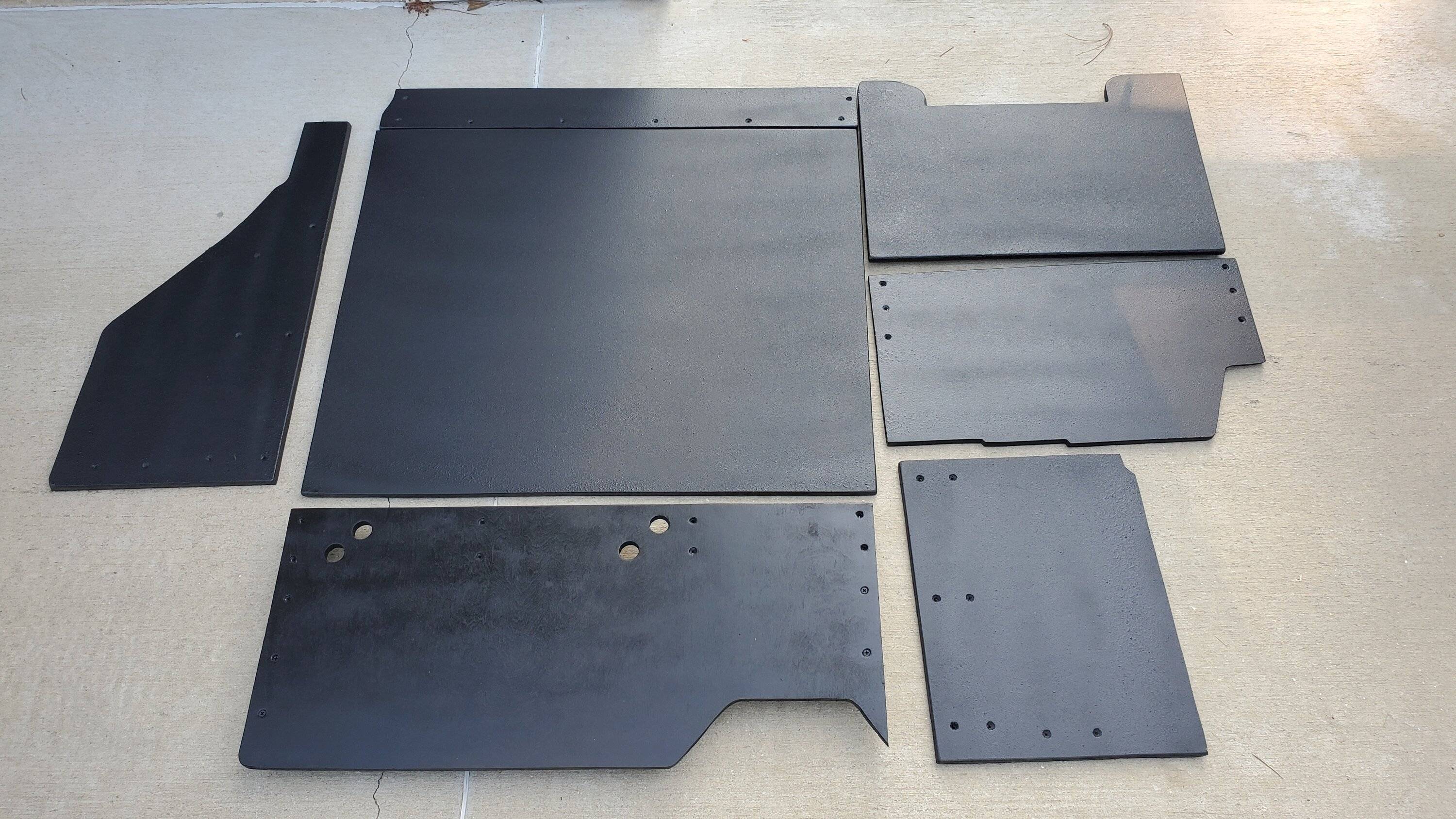

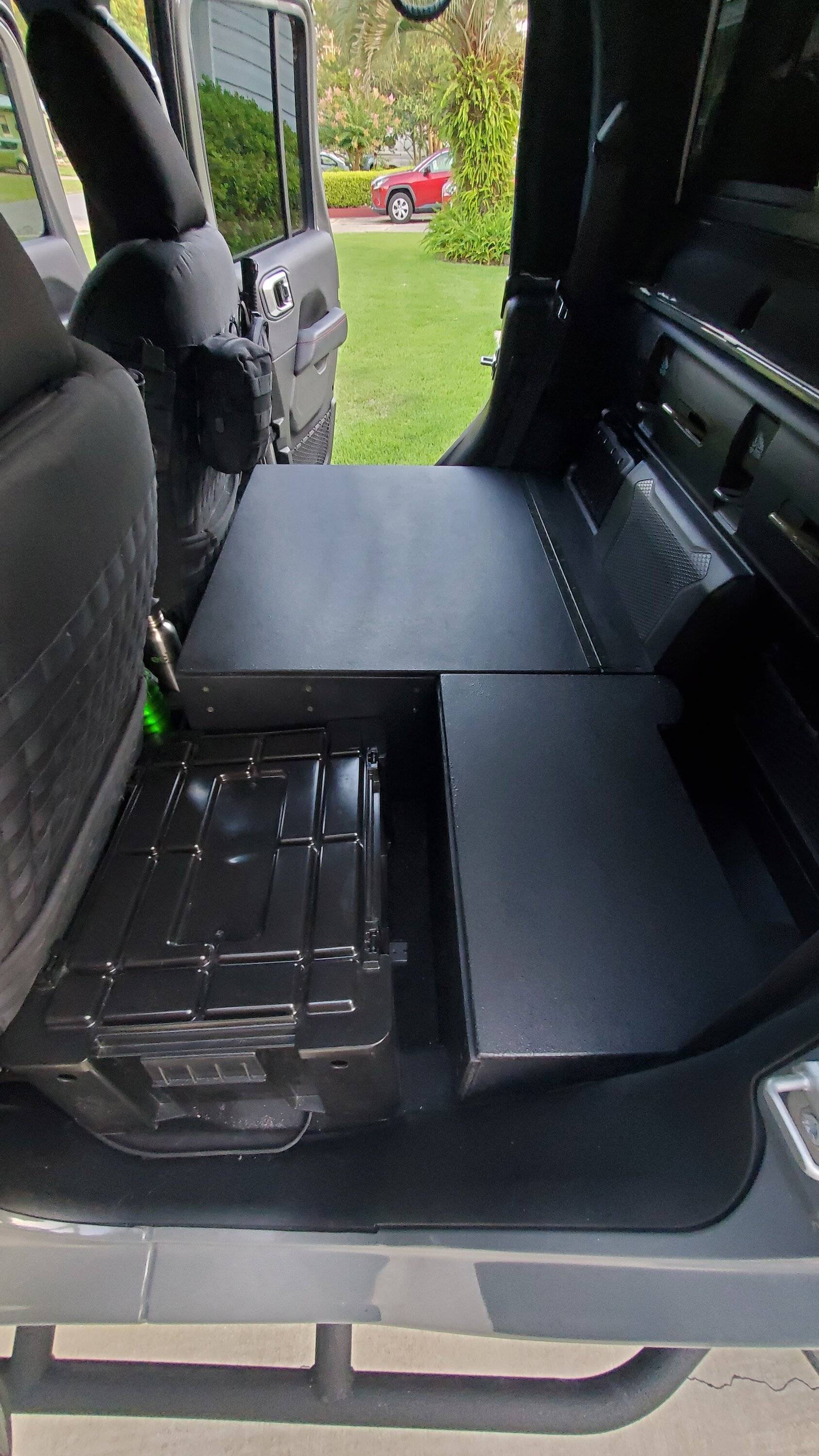

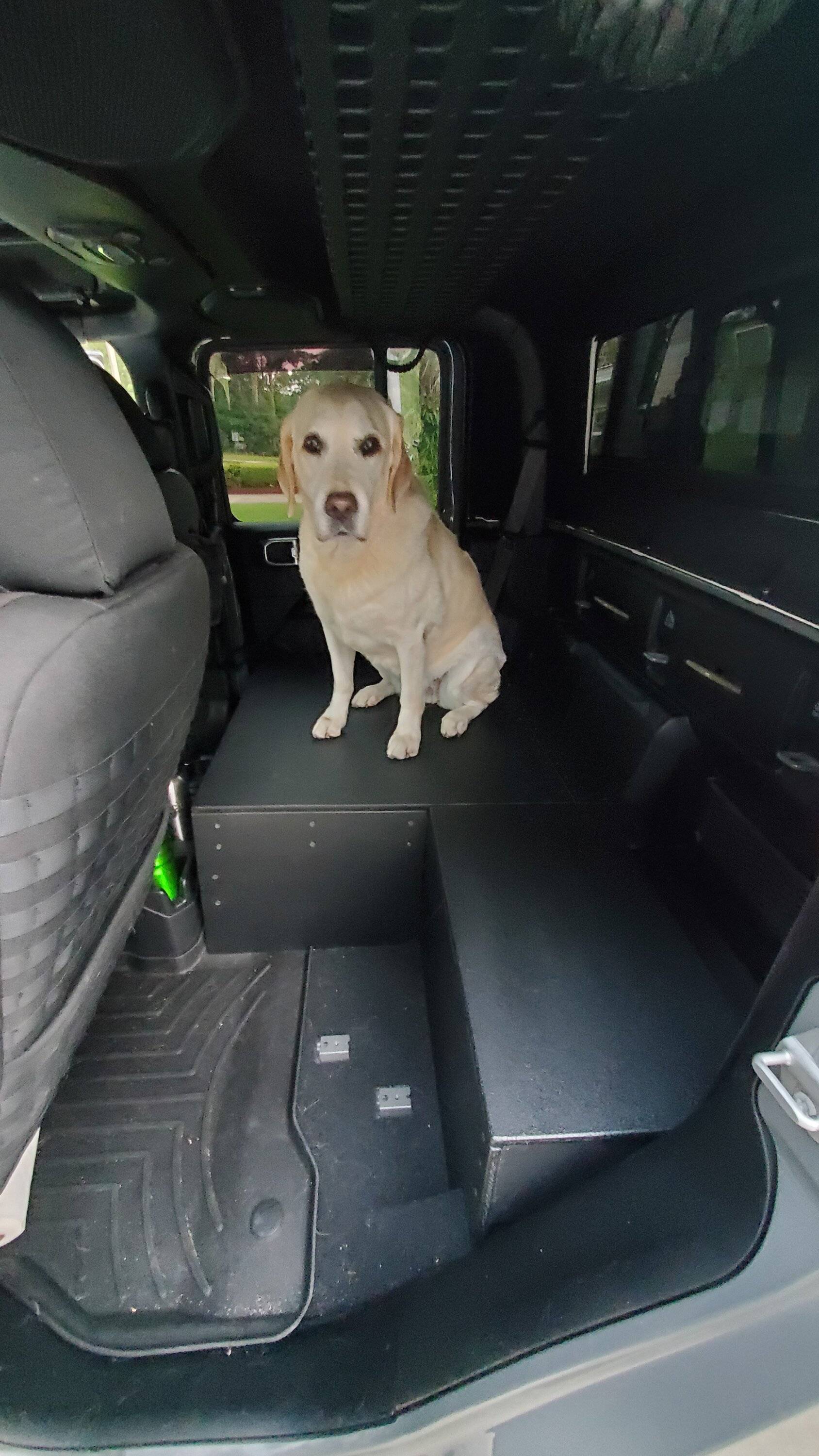

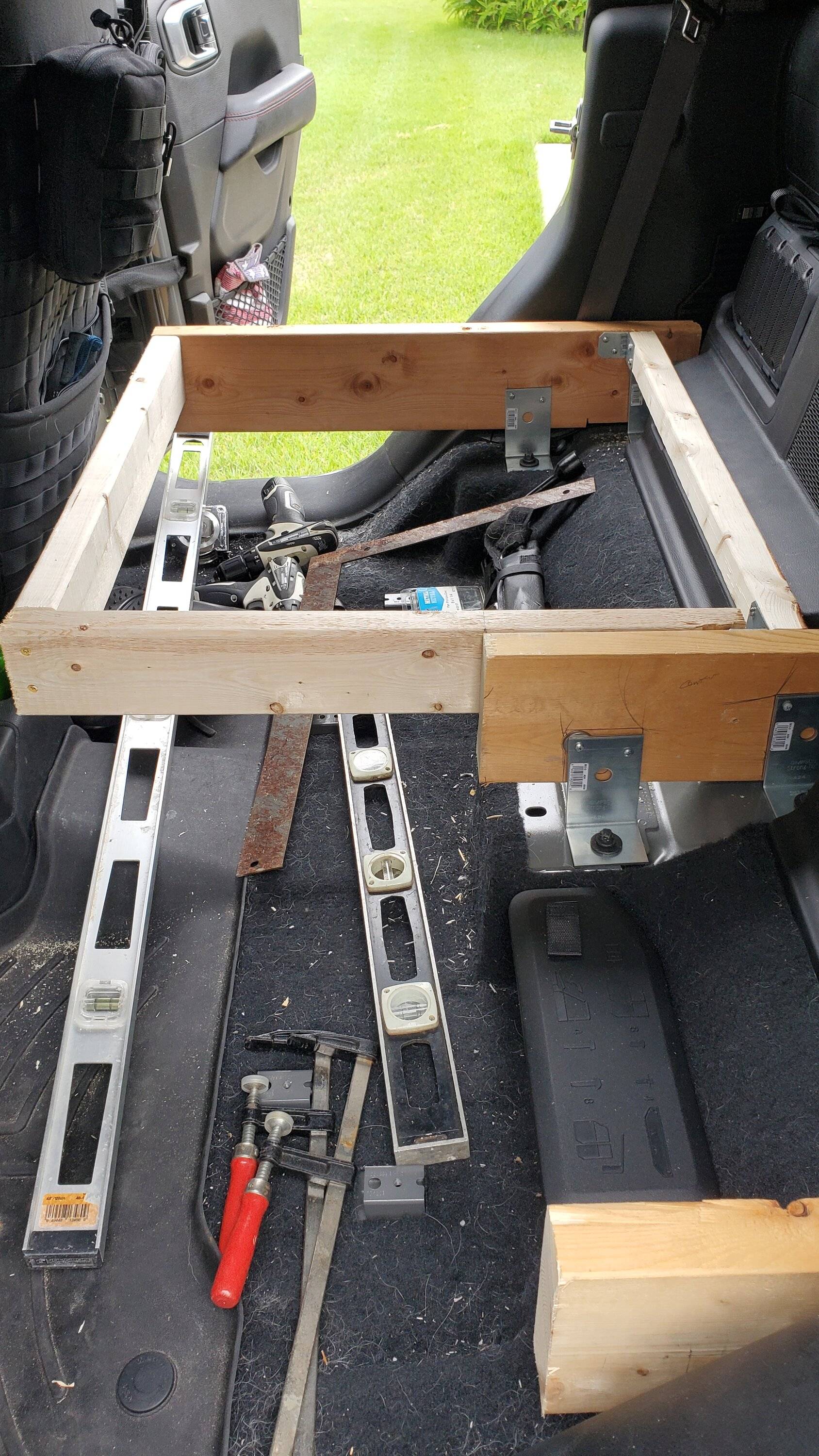

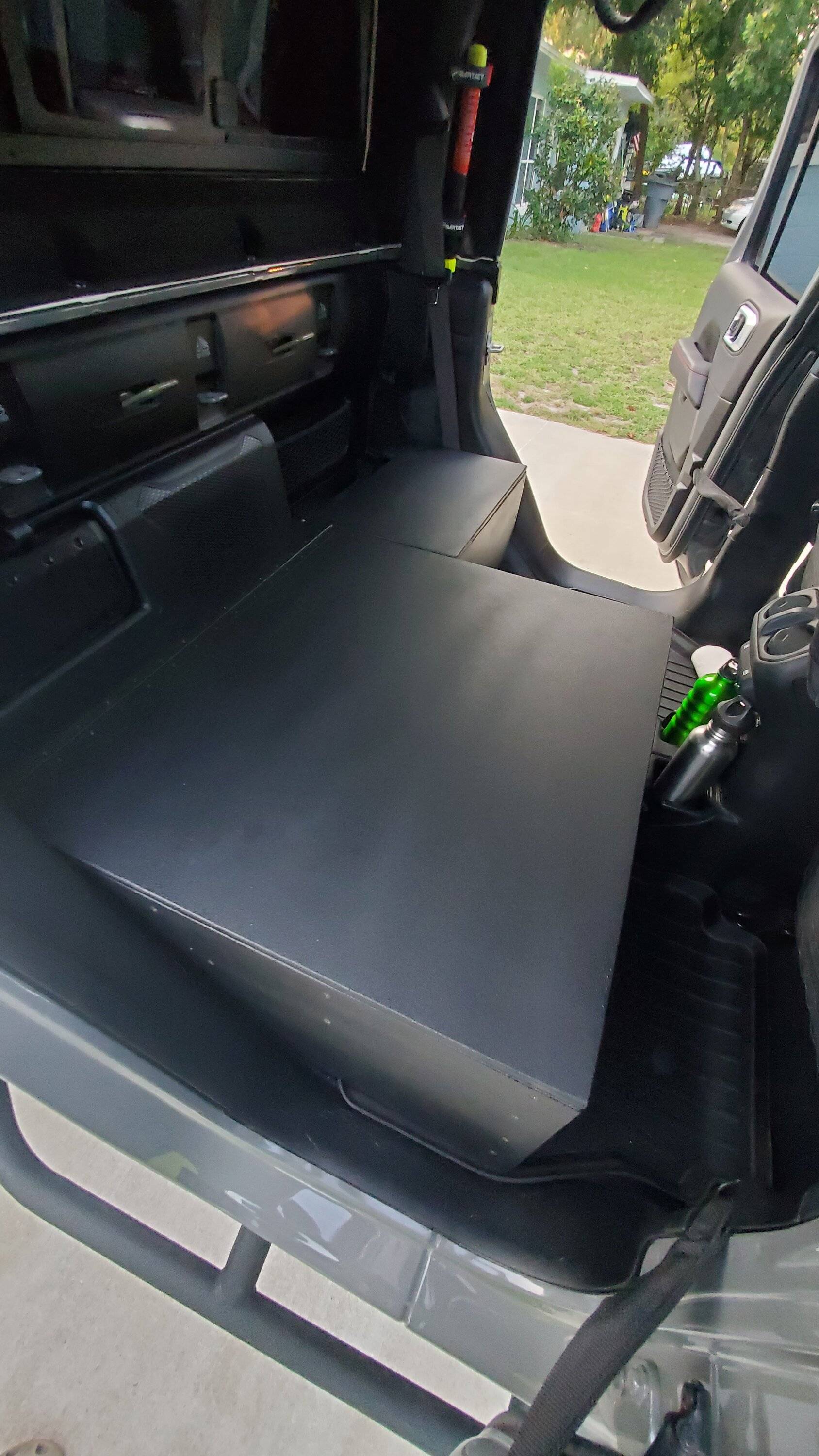

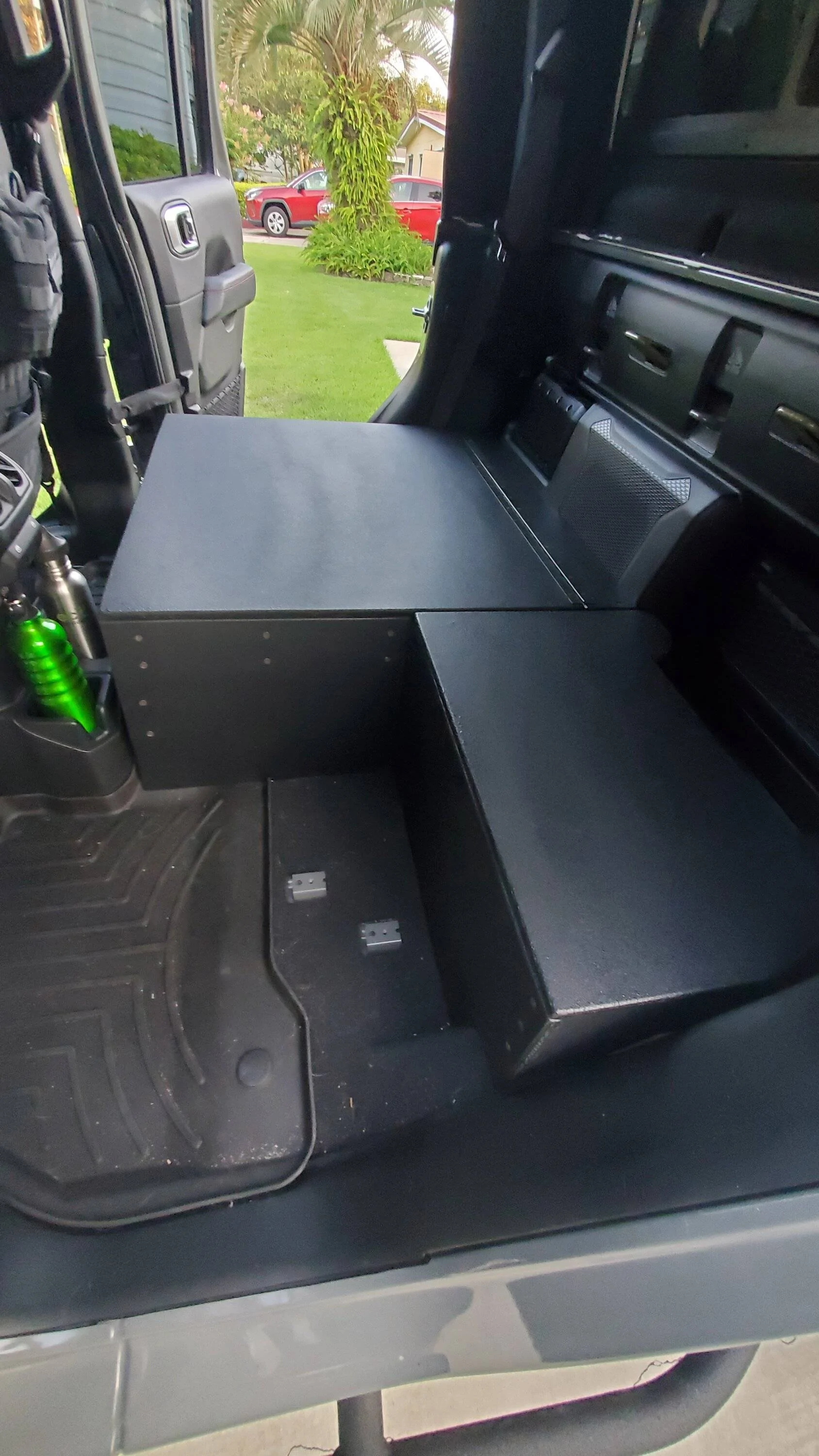

Here is my variation on the design. I used 2x6 to make it deeper and so the top would cover the bump-out where the subwoofer is. Used a longer one on the passenger side so I didn't have the middle framing blocking the compartment. The cutout behind the driver is for 1) the dog to get in and out and 2) so I can recline my seat. A Wolf Pack box fits nicely in that space. A few pointers for anyone doing this. I used a level to position the long 2x6 frame piece on the L-bracket and traced the bracket with a pencil, then put screws in it and bolted it down. Used a 4' level to position the two short pieces on the L-bracket, so they were all approximately on the same plane. Then I used washers under any L-bracket that needed to be adjusted up or down. To get the big compartment square, I used washers between the 2x6 and the L-bracket to change the angle (first pic). The compartment is totally square (my OCD would not allow less). I used cardboard to scribe each of the side panels, then cut the plywood. Each piece had to be trimmed, angle cut, or whatever needed to make good contact with the floor. No gaps (OCD). The legs are 2x4 and are bolted to the frame so I can easily unbolt them to remove the Weathertech mats if needed. One primer coat of leftover cans of paint, then a final coat of Raptor 2K (except one panel, I ran out). I used Rustoleum black to paint the piano hinge and screw heads before installing it. The small compartment doesn't hinge, it just pops off. Think I'll add a Sea Deck knockoff to the top so the dog can get a grip. The main compartment is 12" deep. I may put my house battery and components in there (the next project). Total cost $175.
