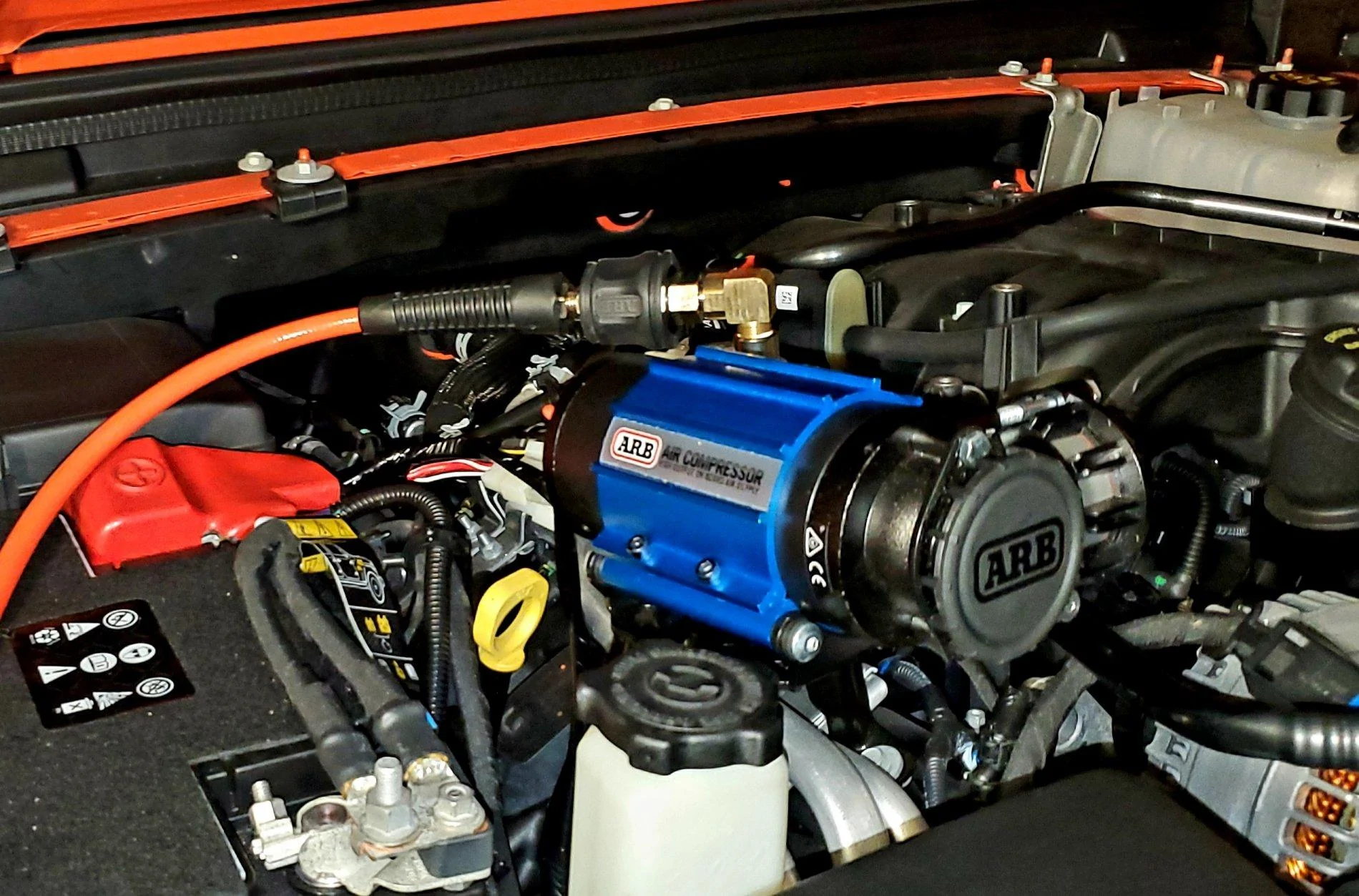

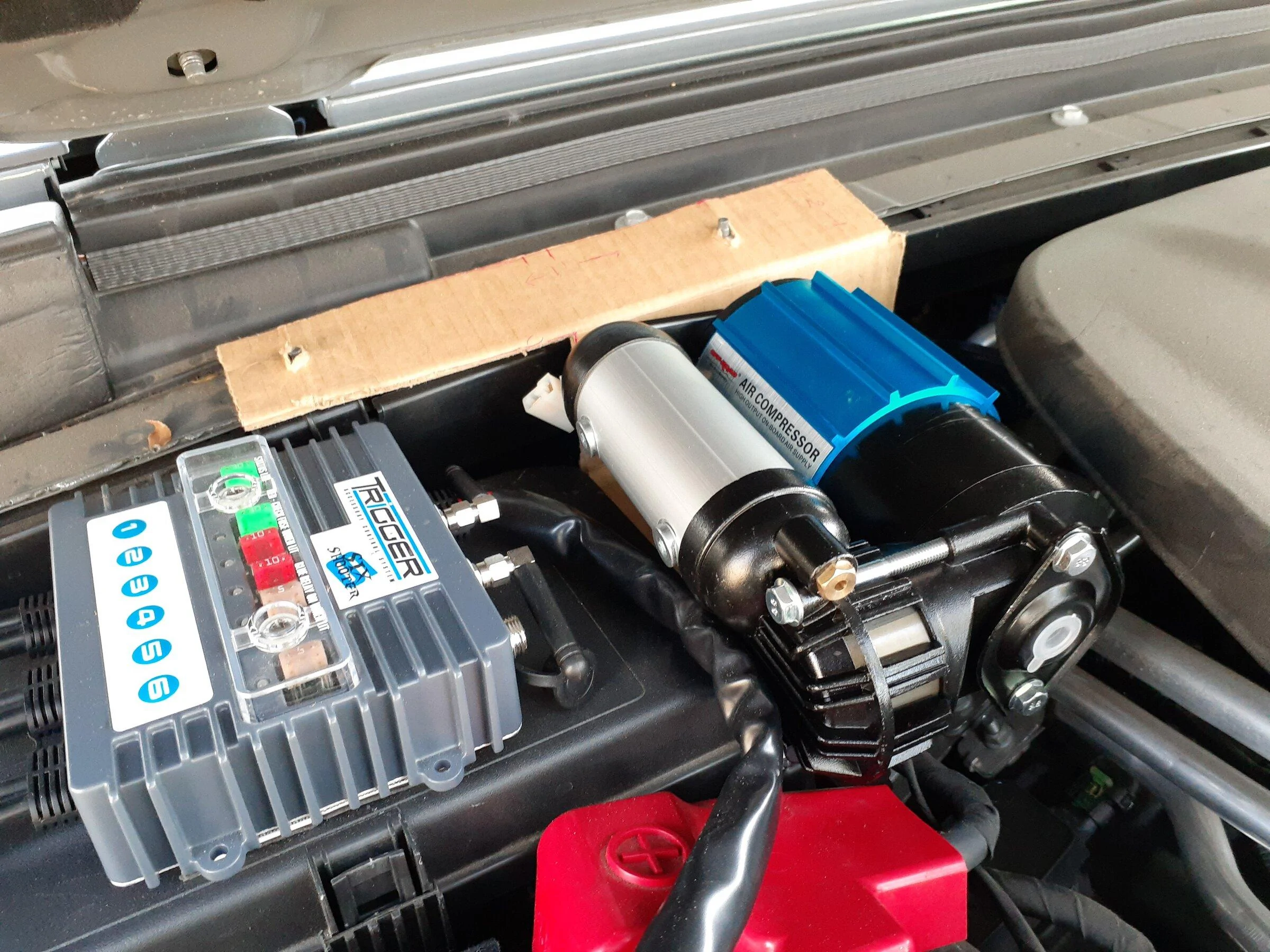

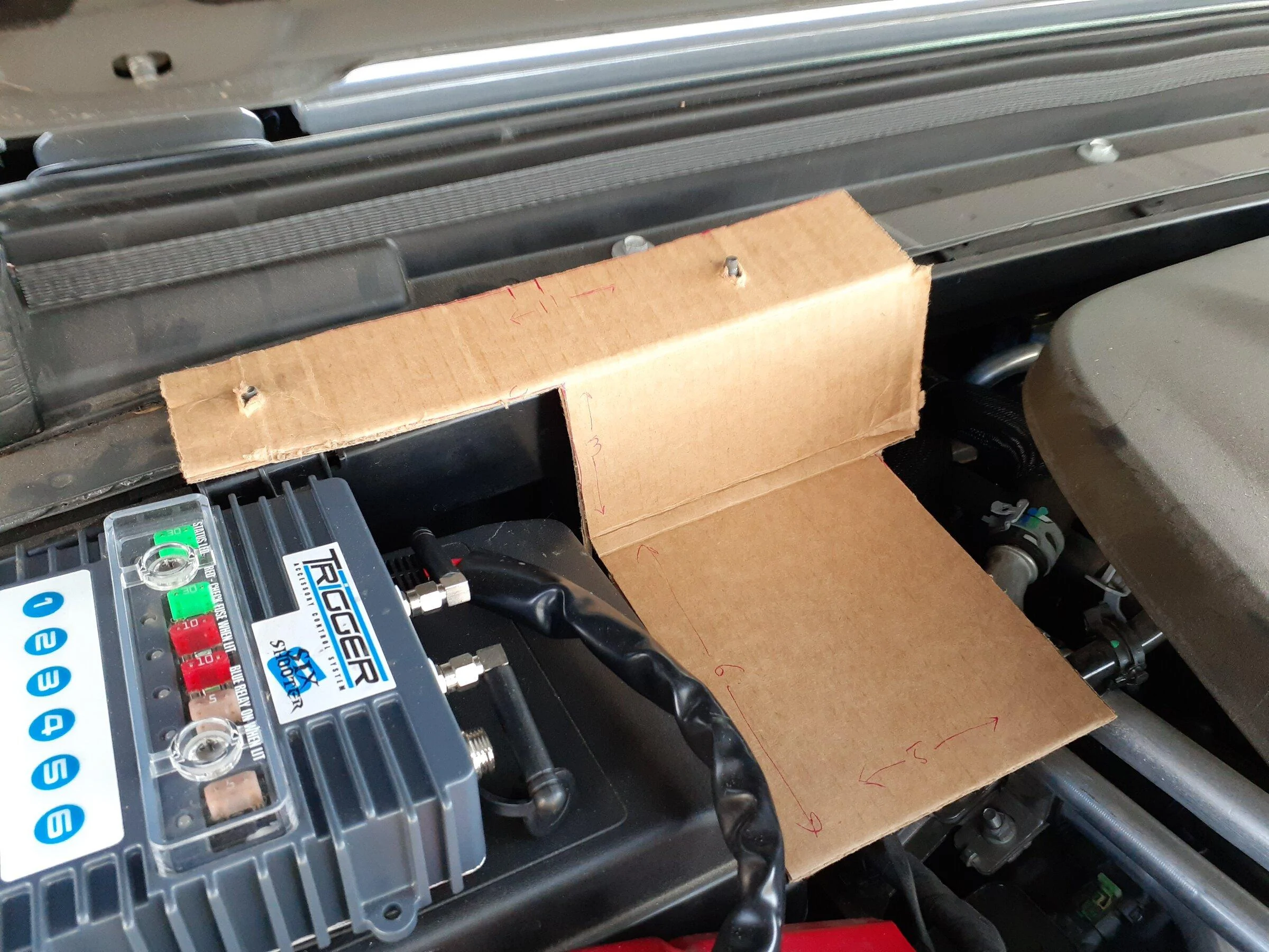

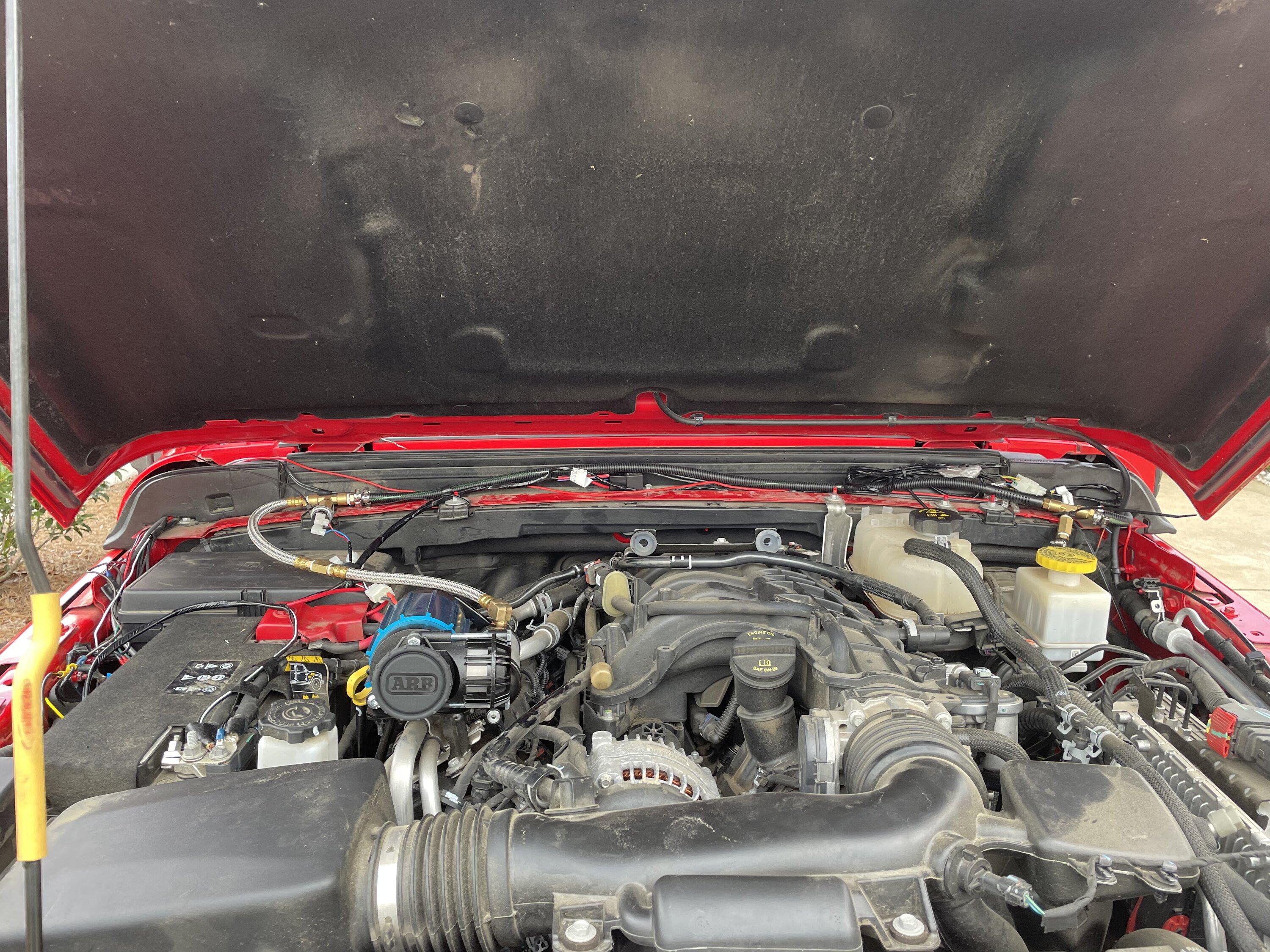

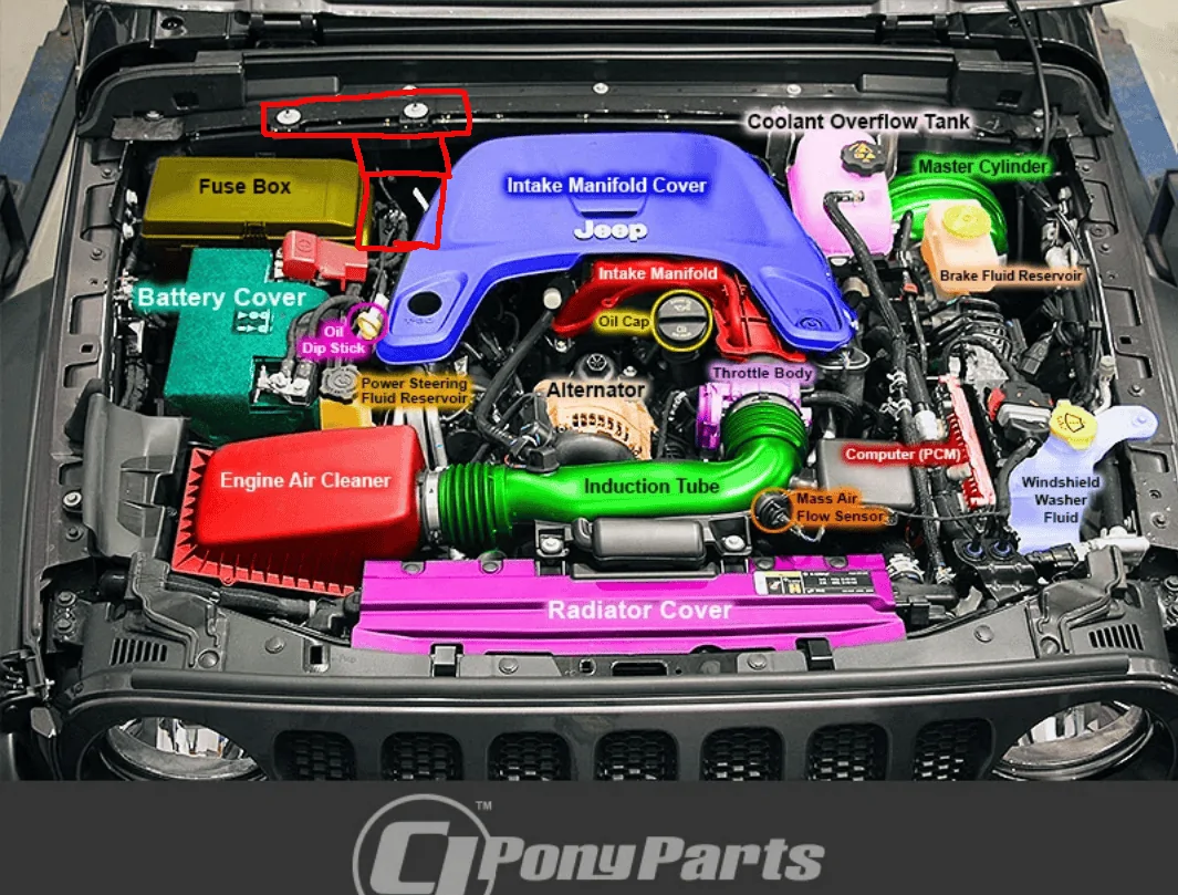

I've got the ARB twin in my bed and was thinking about downsizing and relocating to reclaim space. I picked up a CMKA12 clone for $150 over the holidays. I finally found a spot that I'm happy with. This spot next to the fuse box seems to work. I get to keep the engine cover and it's accessible without going through the wheel well. Ultimately, it will route to a 4XE cowl.
I just have to make a bracket.
Jeep Gladiator The best possible ARB Pump Install location ever? engin
Jeep Gladiator The best possible ARB Pump Install location ever? bracket
Jeep Gladiator The best possible ARB Pump Install location ever? bracket02

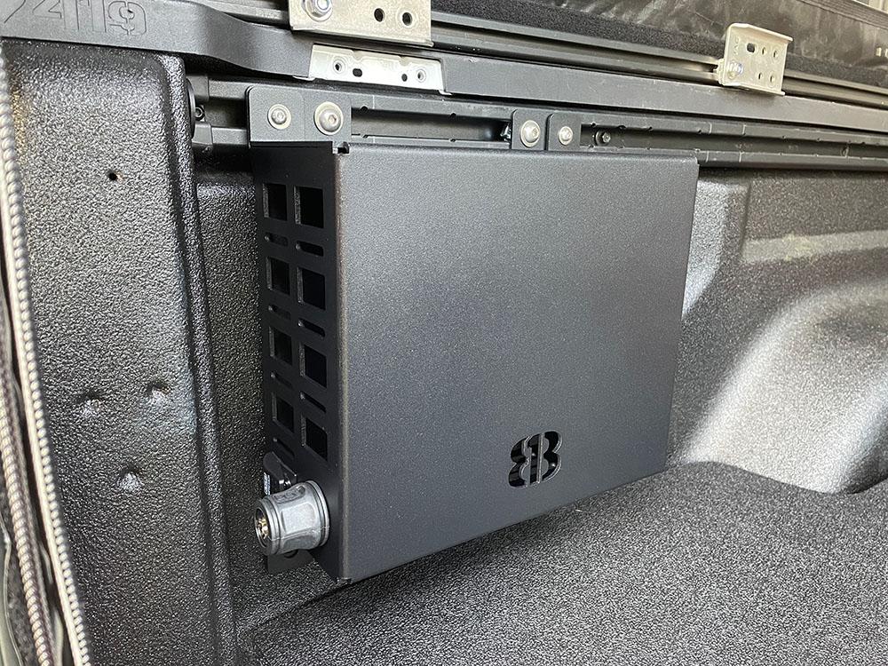

Just so you know, one of the sponsors has a bracket for that location.
https://www.813fabrication.com/product-page/arb-twin-single-under-hood-compressor-mount

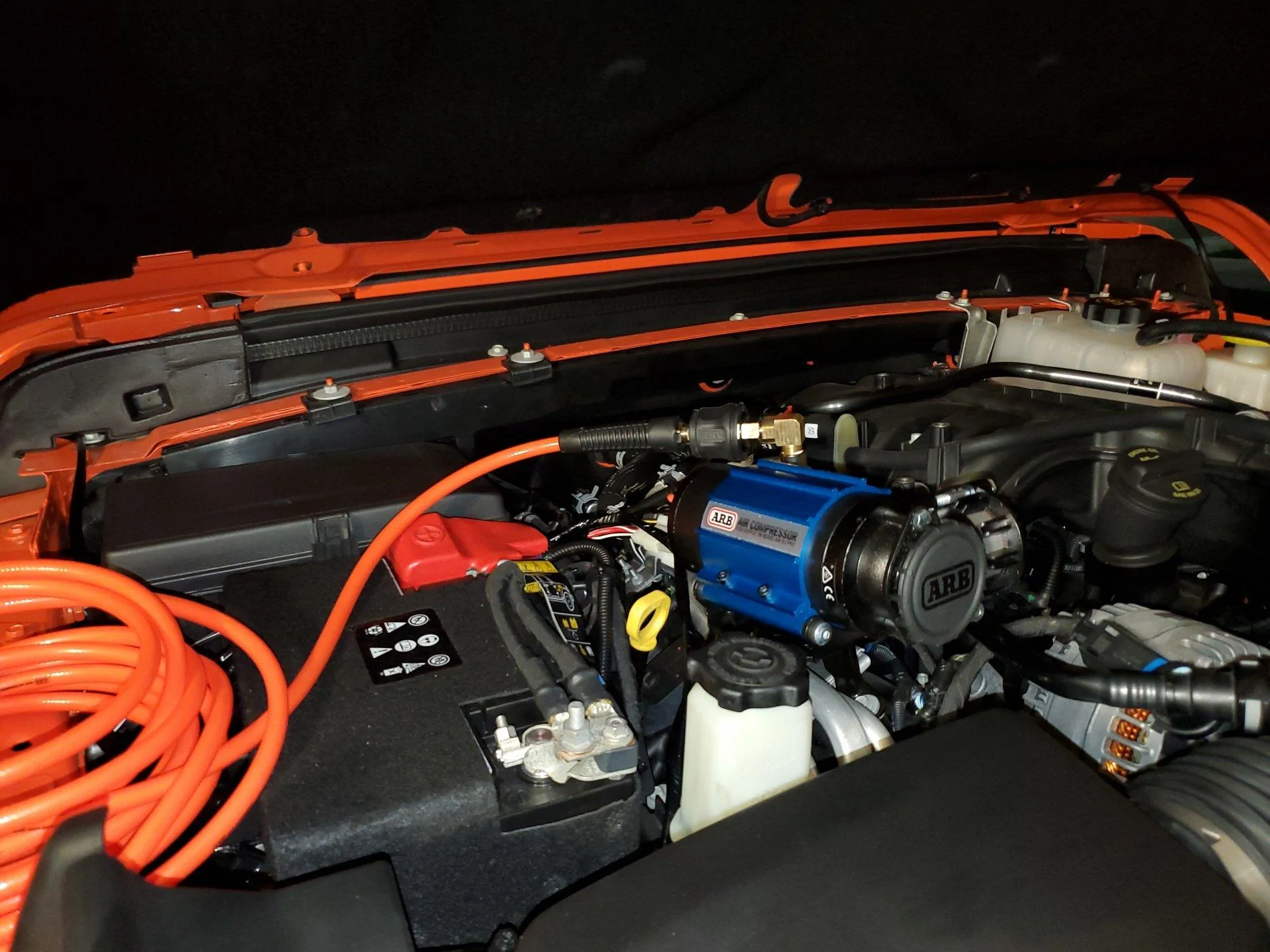

Very easy install in the best location.

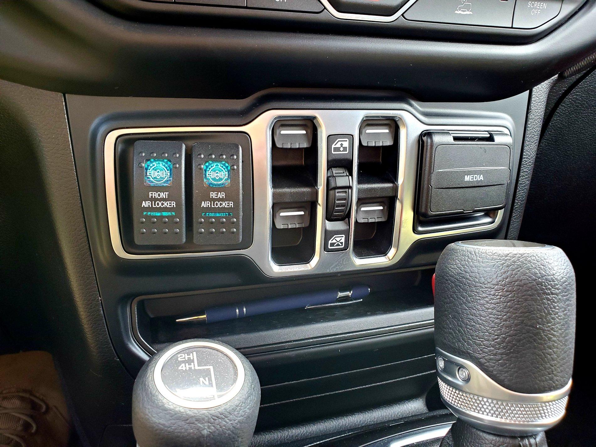

I don't have air lockers, so if you use the arb wiring harness with the Aux switches, you only need to connect the small red wire to the Aux switch. The other wires are unused. I used switch 4. The fuse and relay is still in place to handle the high amp load.

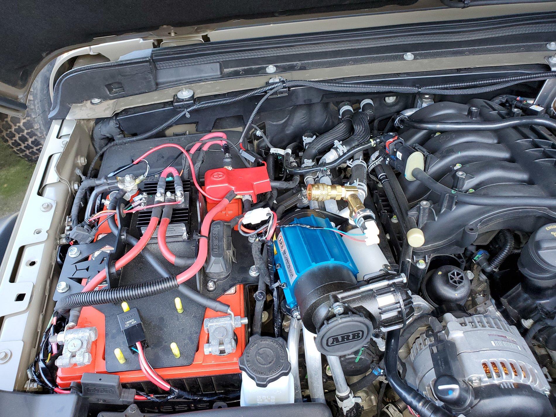

I tried this mount idea and ran into clearance problems. The Jeep in the video has a sport hood which offers more room. On the Rubicon hood the compressor will hit the liner and burned a hole in it.
Going to move to one of his less desirable locations on the drivers side.
Jeep Gladiator The best possible ARB Pump Install location ever? 36D49E61-F5AE-4E05-A58A-5F58746DB1F8

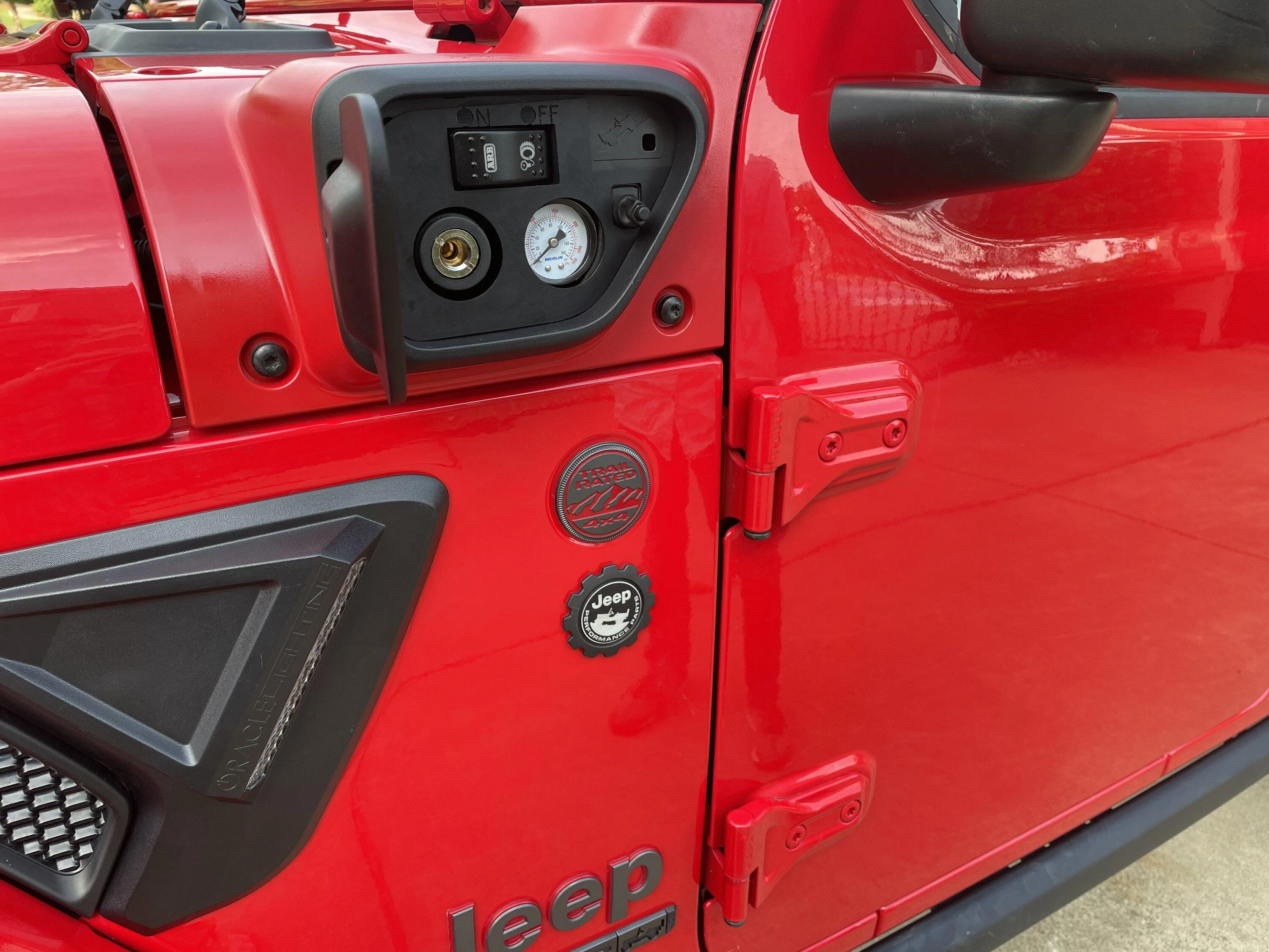

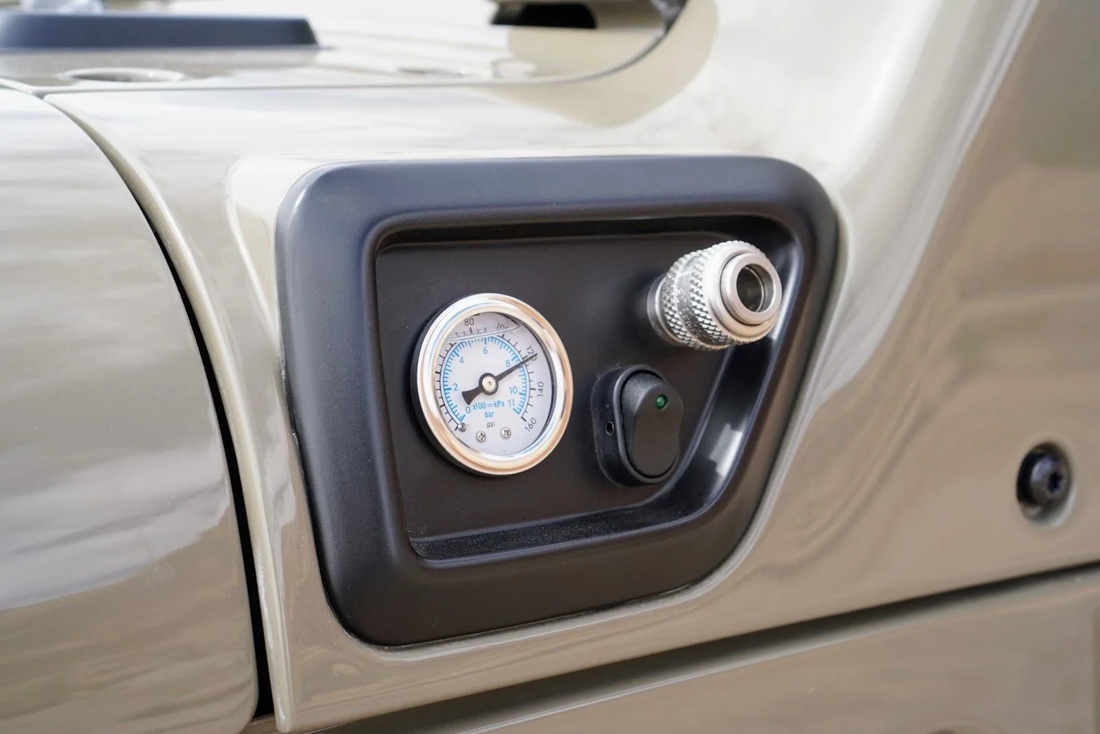

Sort of like the Wayout concept but on the other side. (Keep the switch inside though. lol)
I agree, I like the wayout idea. I kept the switch with the chuck though.
Jeep Gladiator The best possible ARB Pump Install location ever? 309BCEE6-AFAB-4D70-B107-2FD04CF3B969
