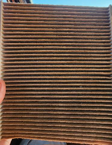

Check your cabin air filter. With our Jeeps spending so much time in the desert they get plugged up with dust bad enough that swapping a fresh filter makes a big difference in cooling.

That may be what it is dont think I replaced in the last year or so

The cabin filter should be replaced frequently. Most likely more than once a year. I do mine every other oil change. There is a lot of construction in DFW, so dust accumulation doesn’t take very long on these filters. I’d also recommend a headliner of some kind. My plans are to use some sound and heat adhesive sheets on the top and then a coverking headliner over that. Then adding armorlite flooring to replace the carpet. Texas heat stays around 100+ in most summers and the humidity is over 60% most days, up to 100%.

Well sounds like I found my somewhat lacking cooling performance. Has to be that cabin filter .
