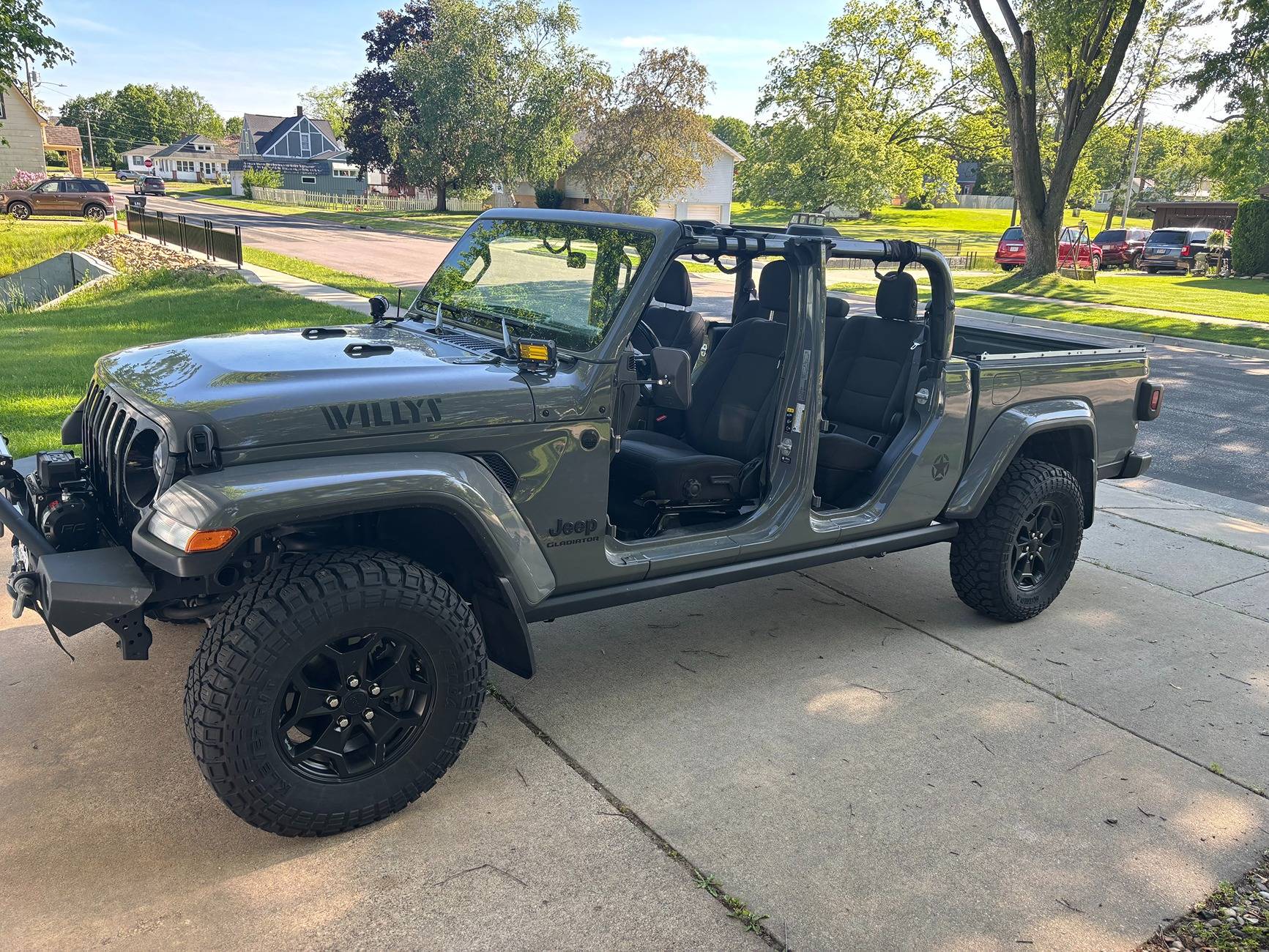

After watching this great video and doing some researching I was thinking I would need to replace mine. I now have just under 70000 on mine and just checked the ball joints. The stock ones are. solid tight. I do appreciate the video and will probably put the Teraflex set on when I do change them. No plan to do so until I need. My rig is a willy's and I upped my tires to 285-70-17. Also, I have 1" spacers on the wheels. Rides and works amazing. I do off road some. Usually dirt and mud trails, not really any rock crawling. Is it unusual to get this far before needing to change them???
Seems to be around 80K miles when we hear of them going out, BUT we've seen them go over 100K and have seen some really worn ones by 30K.
Lots of depends going on there. Probably one of the biggest is how much time the spend off road, especially with bigger than stock tires. The leverage on the joints and contaminations can really put a hurt on those nylon liners.
