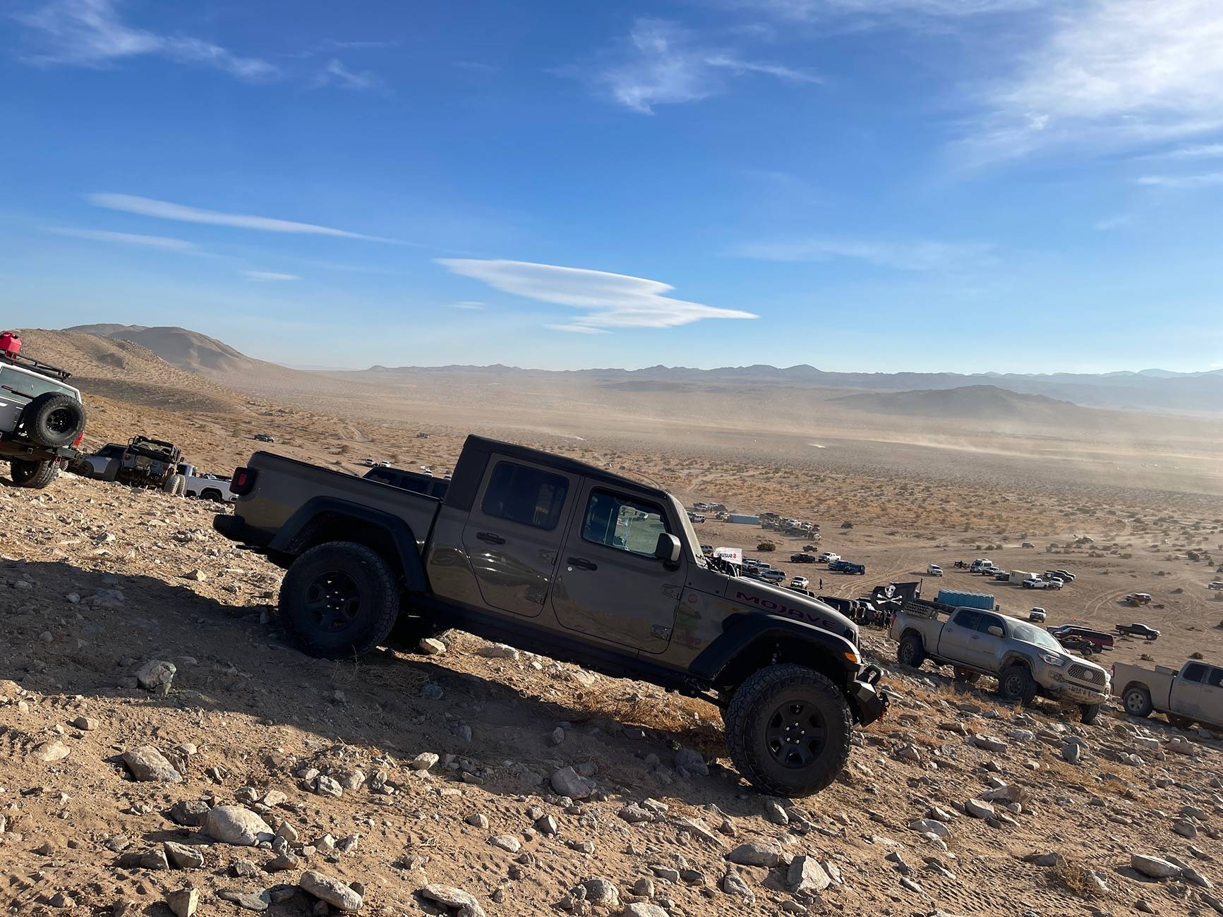

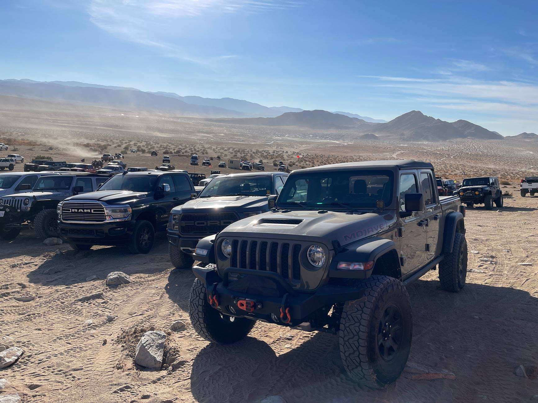

If you’re curious how it looks with all of those minor upgrades. Here you go.. I call it Mojave+. This is taken at Chocolate Thunder at KOH few weeks ago
