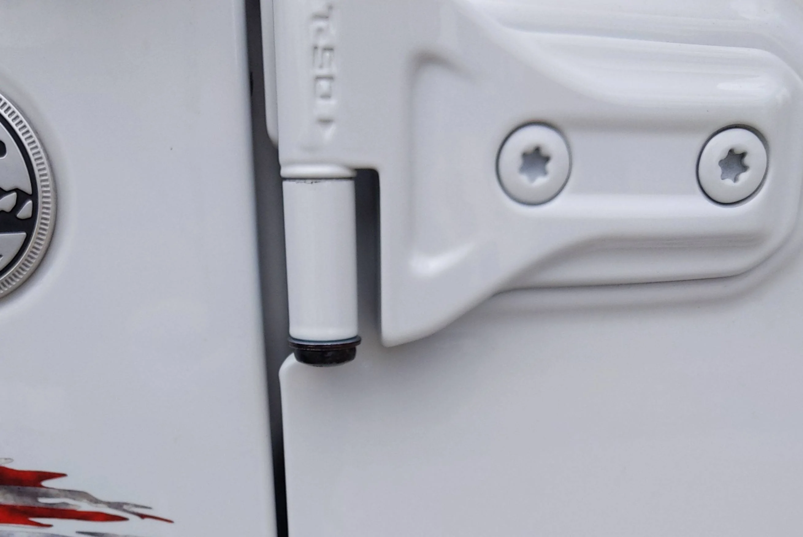

Picture one looks like the bolts on that door hinge have been removed due to the paint being disturbed. Picture two looks like the bolts have not been removed because the paint is not disturbed.
The top hinge was replaced for the corrosion issue, the bottom hinge is original. I was just trying to show what the washers looked like installed.

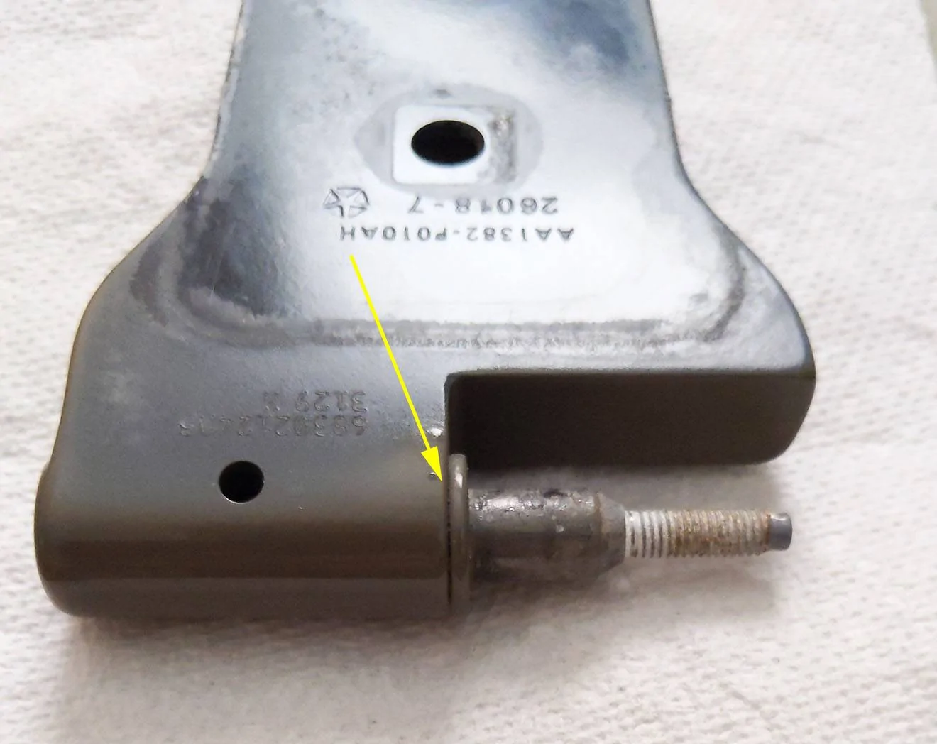

Here's one of my hinges that has been replaced due to corrosion. The corrosion paint bubble (arrow) starts where the aluminum meets the steel flange of the pin insert and this is the same for the other 6 hinges I've had replaced so far. The body of the steel pin extends into the aluminum up to the 5 (other arrow). That seems to be a significant amount of steel touching aluminum, but whether this is regular or galvanic corrosion really doesn't make a difference. Either way, wouldn't a zinc washer sacrificial anode on the door nut help mitigate the corrosion of the aluminum?

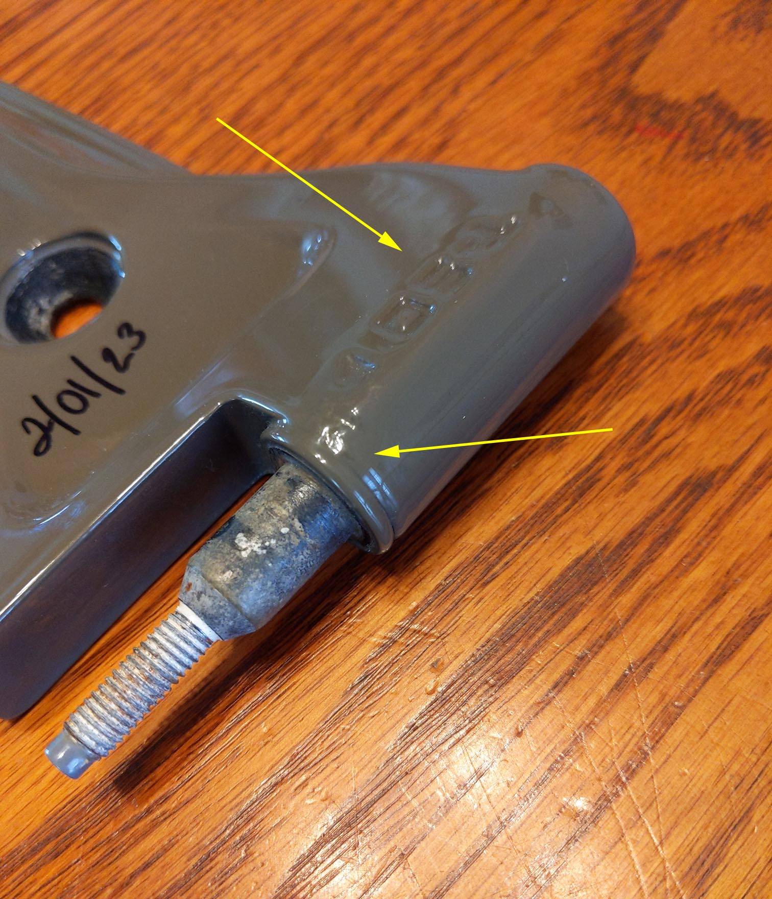

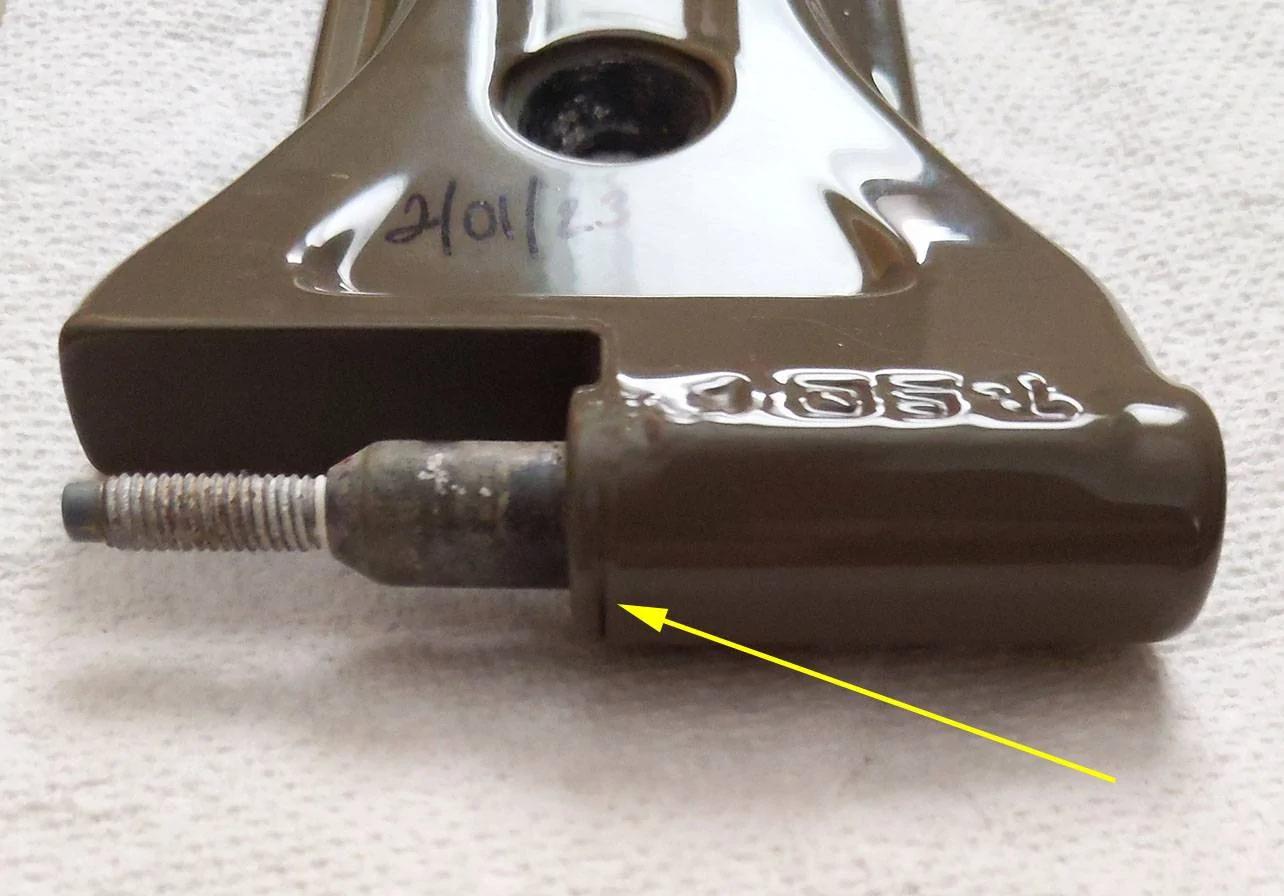

The real cause of the corrosion is that water/moisture gets 'trapped' at all the hinge/door/bolt/bushing interfaces that are not sealed against moisture. Seal these areas against moisture and the problem goes away.
I noticed that where the corrosion occurs is where the paint is thick enough to completely cover (and seal) the gap between the pin flange and the hinge. The gap is clear on the back of the hinge and there's no visible corrosion. That does seem to indicate that it's water/moisture getting trapped behind the paint being a major factor in this specific hinge pin area corrosion.
The gap is open in the back.

The arrow points to where the gap gets covered with paint.
