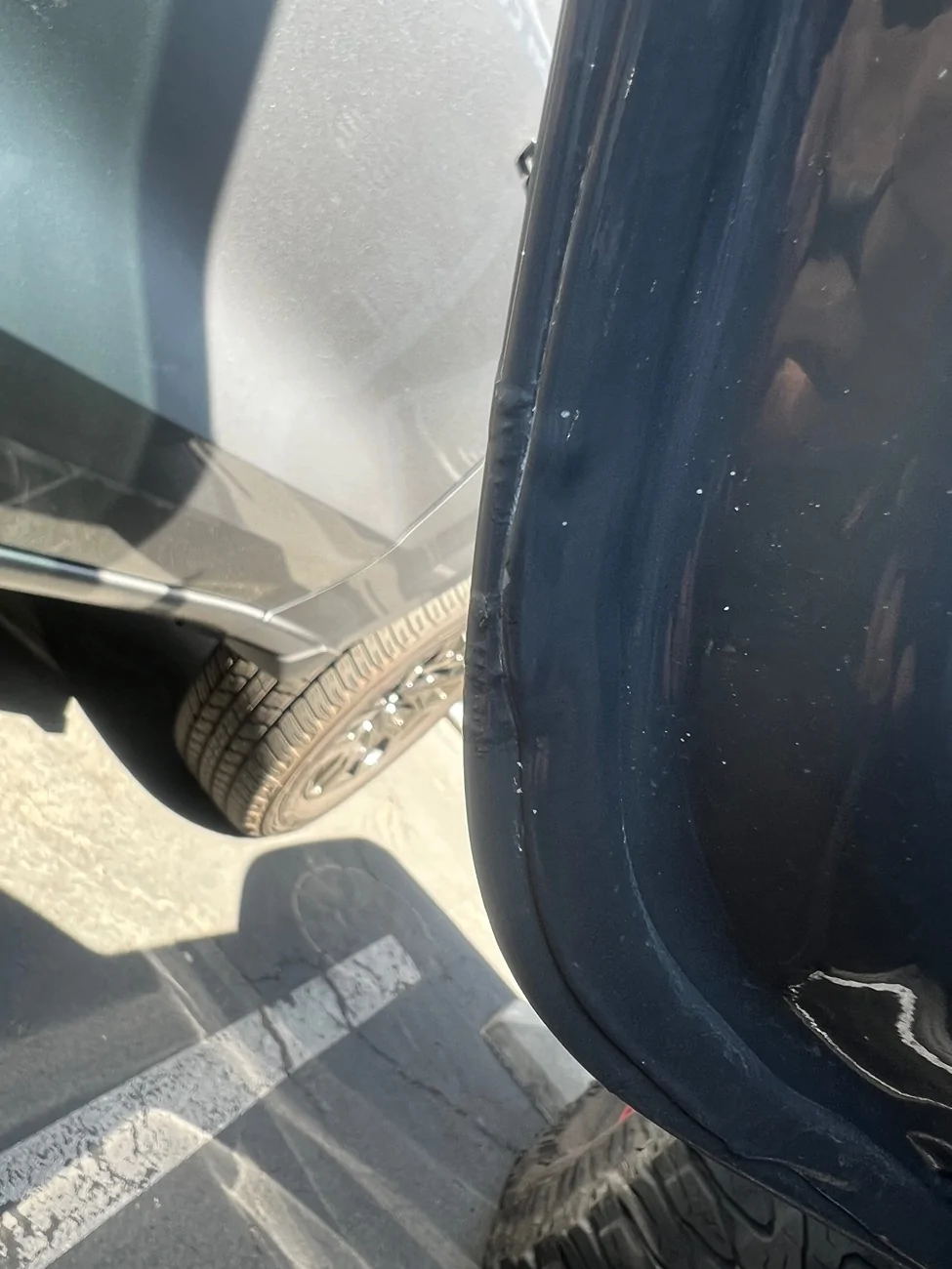

Well, at the dealer now. They sent me to the collision center, and the guy looked at the hinge and went yup, then asked to open my doors, and low and behold we found bubbling and corrosion at the bottom of the doors too. Jesus… didn’t even see that. This guy knows what he is doing and they are now taking pictures and will submit for approval. I will get all new parts Vice trying to fix. He said they have not had an issue with claim denial yet. Couldn’t believe I missed so much in other areas. Check your doors along the bottom under the sealant strip, noticeable bubbling under paint. Crazy

Can see the bubbling below the strip of sealant/ glue.
Jeep Gladiator Corrosion starting IMG_5648

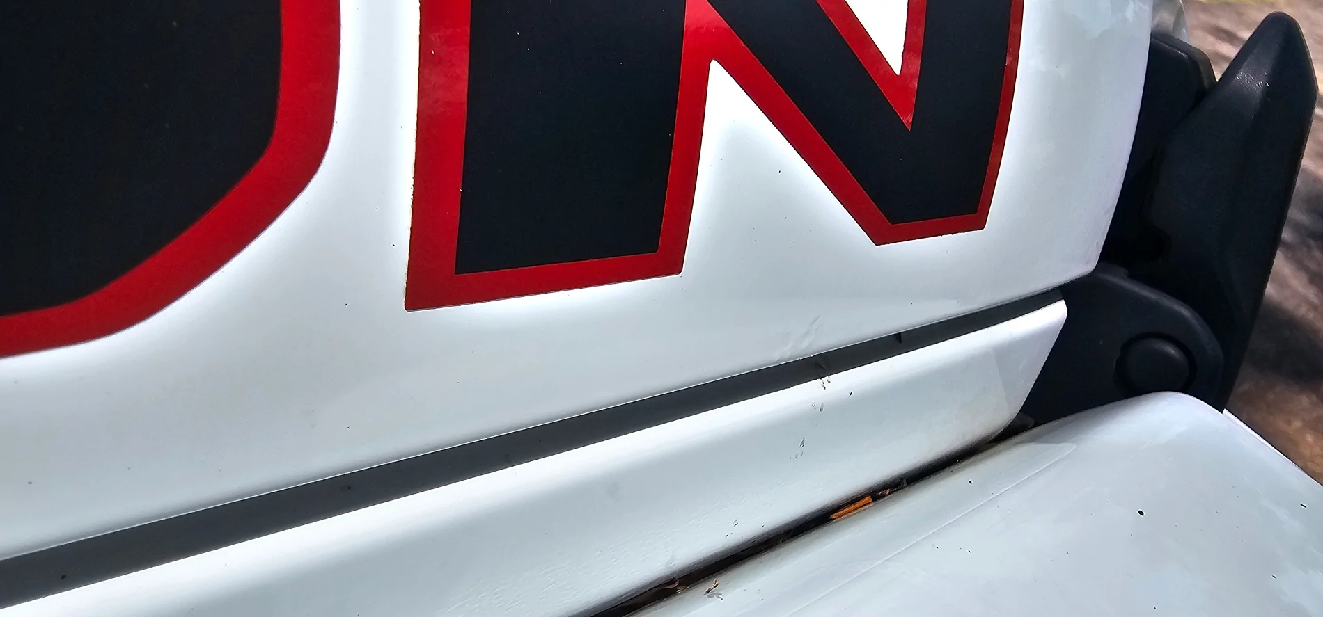

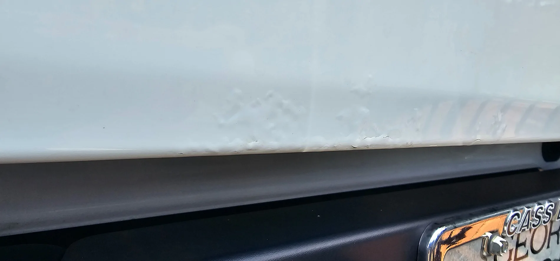

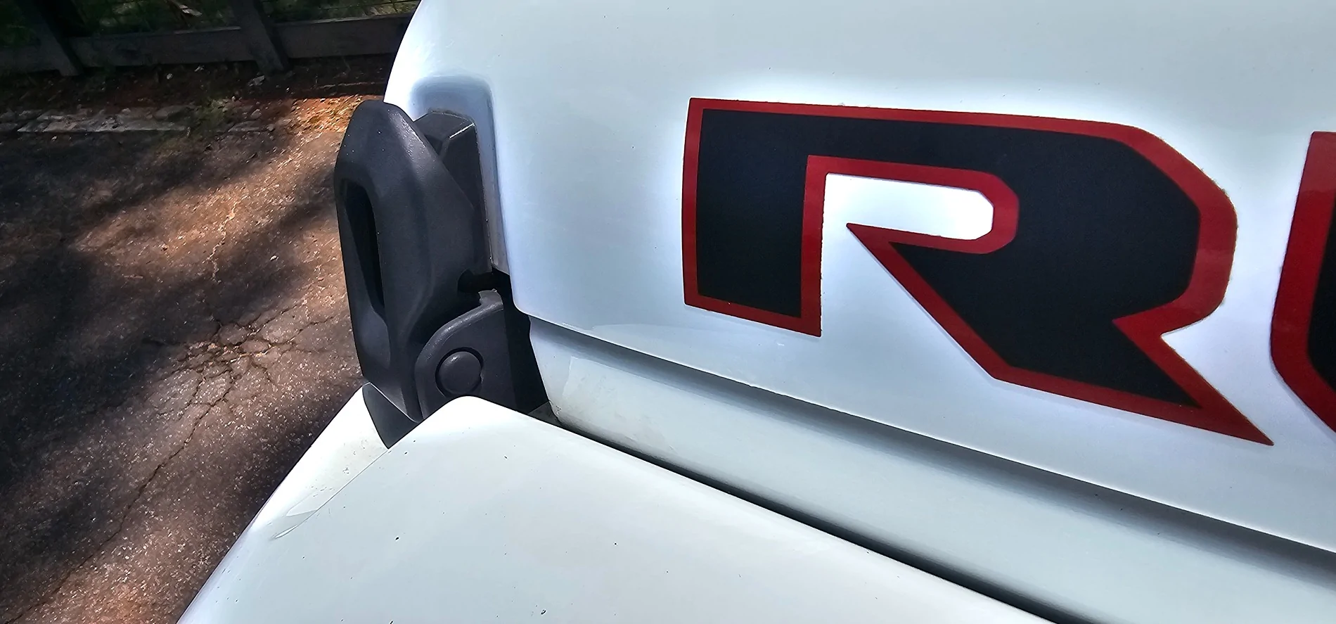

I have only 5 months left on my corrosion warranty. I will make the trip next week. Did they get it approved right away on your first trip? Were you able to lea e it with them or did you have to make an appointment?
Jeep Gladiator Corrosion starting 20250730_135201
Jeep Gladiator Corrosion starting 20250730_135125
Jeep Gladiator Corrosion starting 20250730_134850

I have a life time ding and dent warranty contract. It will not cover corrosion issues or collisions, but maybe hail or shopping cart dents. I never really read that contract
