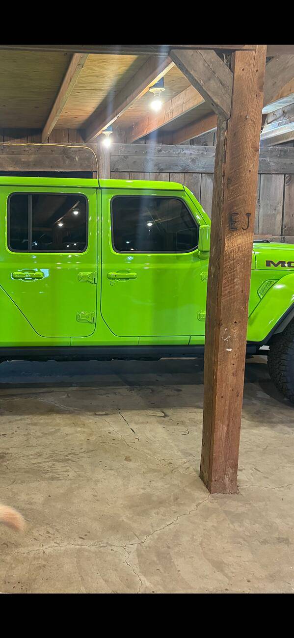

Just paid $1300 out of pocket to have mine done(all 8 hinges), this was also employee cost at the dealer body shop at work. They also painted my lock cylinders to match.
Jeep Gladiator Corrosion Repair…I hope your sitting down IMG_5372
