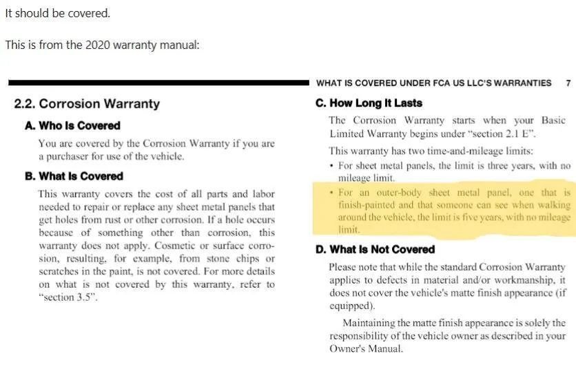

I want to get mine done, sides of the hood and door hinges are bad but being a 2020 I think I’m past the warranty period.
One year after the warranty is up there is time for a one-time "good will" extension where Mopar covers 70-90%.
