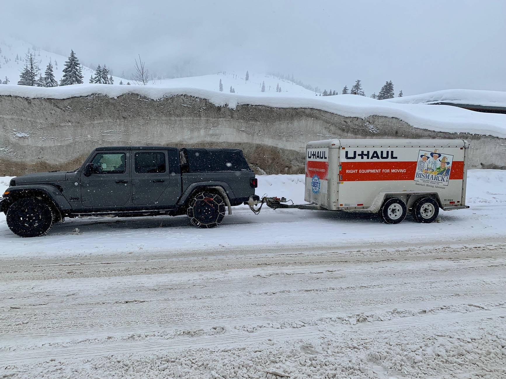

They fit just fine on stock Rubicon/mojave tires, are required carry in certain states on certain passes, and are legally required application in certain conditions. My setup in this pic was likely a bit less than the 10,000 lb CVW chain requirement that was active at this moment in time but I played it safe anyways with all that weight out back and my family in the truck.
On rare occasions (usually freezing rain on a steep grade) it can be a requirement for ALL vehicles regardless of what tires you have. This actually happened on Snoqualmie Pass in WA state a couple weeks ago, and was a massive coordinated effort by state patrol to keep the freeway open with chain checks (as opposed to just closing it, which is more common). I think I-80 in CA does this sometimes too.
One last reminder to folks that see snow only occasionally: 4WD/AWD doesn’t matter for shit, your ability to stop in snow/ice is far important and that all comes down to tires (or chains).

I just pulled the same trailer from TX to CO and narrowly missed 3 snow storms in between. I am not envious of that photo, that would not be a fun tow!

I swear by chains on the front in very deep snow when using a 4x4. Looks like you were pulling quite a load. Hate doing that in the snow or when icy and going down hill.
I agree if not towing chains up front on 4wd/awd is the right move for directional control and better braking. Towing though I really wanted to avoid the tail wagging the dog if the trailer got squirrely.

I have towed that trailer many times with the old Hemi Commander. Those things are heavy and its amazing how much heavier they can get with a load full of household crap! Even with the Hemi you could definitely feel it.
I notice you have a diesel, I get anxious just thinking about towing that with my 3.6 + 6 speed. :)

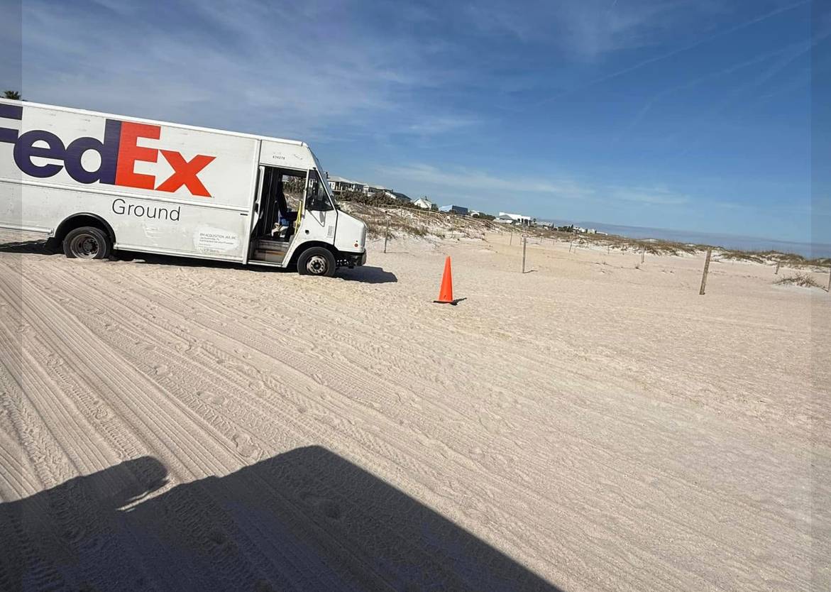

I don’t think chains would help.
