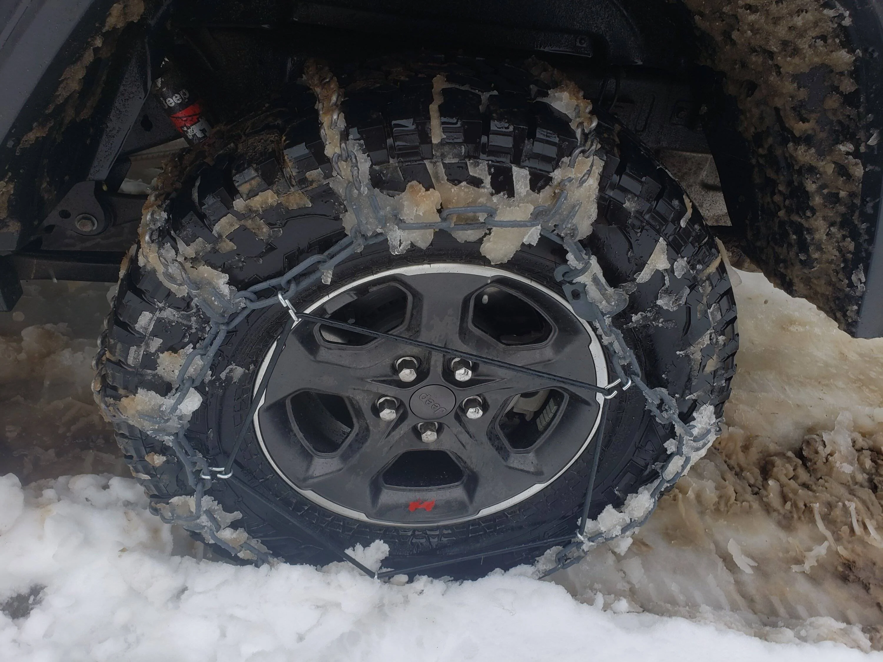

Jeep Gladiator Tire chains 20221224_122148
Data point - stock standard Laclede chains fit 22' Rubicon with no clearance issues.
Not low-profile or S rated, despite owners manual they were just fine. I drove a few miles with them, zero issue other than noise. Several inches of cold rain over snow turned my road into a tread filling mess and these were the only way up the hill. With chains on the read only, I traveled in 2Hi

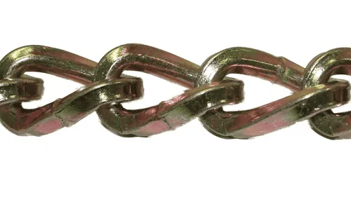

Personally I wouldn't run V bar chains on the road. They will beat the shit out of you and your rig.
I'd run a set of twisted square link chains with cams.
This is what I mean by twisted square links.
Jeep Gladiator Tire chains 1672563661750
The square link will bite better than round link and the twist will help it from chewing up your tires like standard square links can.
