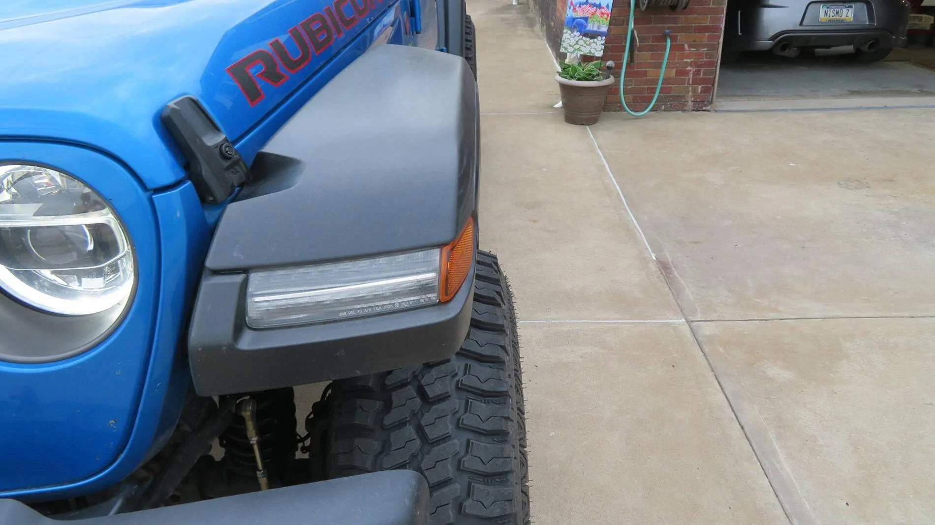

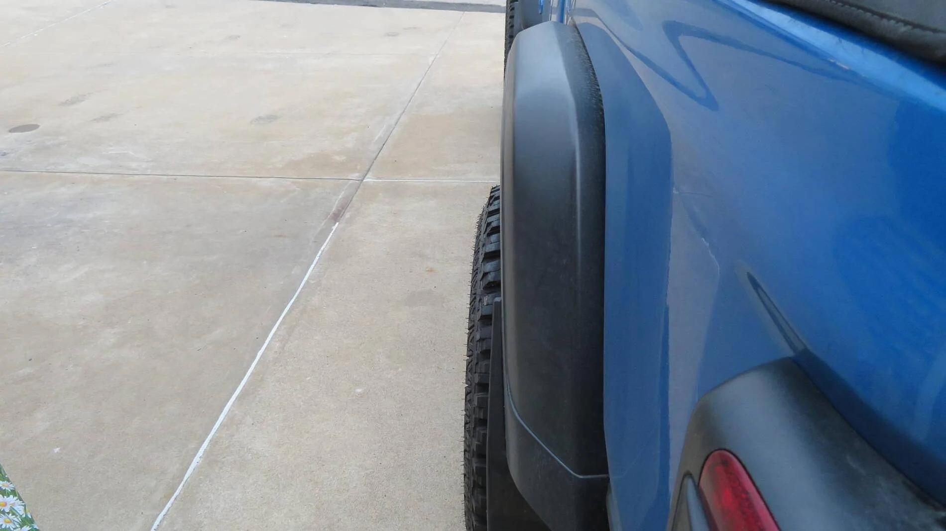

I ran the Synergy 1.75" wheel spacers with the stock Rubi rims and 37x12.5 MT's until I could get the rims I wanted.
