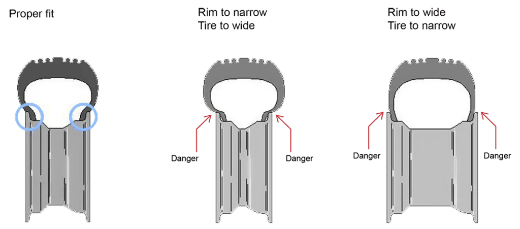

I think the 11.5s are the way to go if you can find a tire you like.
Though I've run wide tires on narrower rims and was able to compensate by running lower tire pressure. That helps to even out the otherwise center weighted tire wear in that situation.
It evens out the center but it makes the bead not sit so well. You will never see it really but it's happening to compensate.

You have 9" wide rims which are approved for that tire. His rims are not because they are too narrow. His issue isn't getting them installed in general, it's finding someone willing to do it on an unapproved rim.
