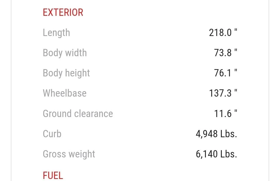

The numbers the OP used appear to be the Max weights of a Gas JT with max payload.
For reference my JTRD with Clayton 2.5" lift and HD front springs, 35" TKO2s load C, method rims, Diamond back bed cover, FOX 2.5 shocks, full tank of diesel and def, plus myself in the drivers seat was weighed at a Certified Cat scale. The weights were:
Front axle -> 3140 ( diesel adds ~400 lbs of weight over the gas)
Rear axle -> 2880 ( w/ 100 lbs of gear over the rear axle)
Total -> 6020
As others have stated, get it weighed and recompute the pressures or do a chalk test. Could also do both and compare the two. The chalk test will probably give the best pressures to run for the most even tire wear.

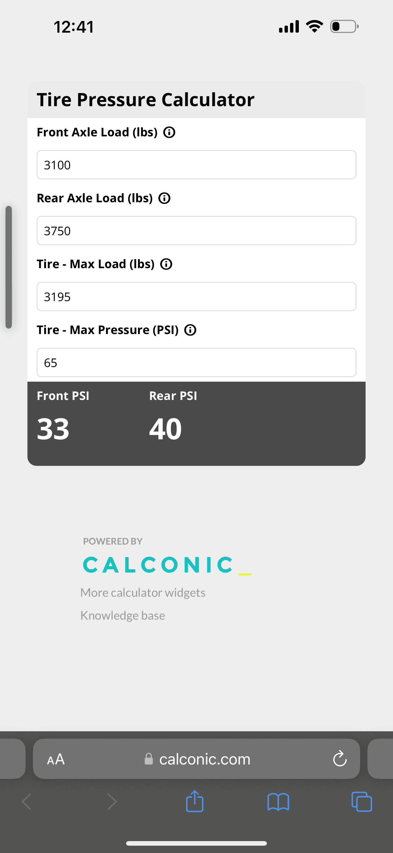

And my truck is likely lighter, or was. And if the tires are each rated for say, 2700 pounds, that's 5,400 pounds per axle.
If I use your numbers of 2880 and my tires can handle 5400 pounds a pair, I'd have to toss in 2500 pounds of weight to come to the max tire capacity per axle.
If the tire can handle only 2500 pounds each, there's 10,000 pounds for 4 tires, and the truck weighed 6,000 pounds, you'd have to be able to add 3 to 4,000 pounds to the truck to break the total capacity rating of the tires.
I know - that's static load, not accounting for load shifting, banging around and all.
But my point is - how can anyone possibly take a Gladiator to the point of exceeding their tires' weight rating? (unless 4 wheeling, then all bets are off - talking towing, payload and on the road use)
Anyway, it's not hard to figure the tire footprint in square inches, the weight of the truck and the psi you need to run.
In fact you can weigh the truck using pieces of paper, a pencil, tape measure, calculator and tire gauge, and get really close.
I run what the General consumer engineer said I should run based on the tires and weight of my truck.
You need to adjust for seasons there's so many things involved, don't sweat 1 or 2 psi.
But that huge difference - 33 and 40? No way.

I have a set of E rated MT tires. There is an overland tire pressure calculator I found online and plugged in the values. Does this seem appropriate in your opinions? I’m going from stock axle weight
You need the actual weight of your vehicle and not the axle weight rating. Axle weight rating is the maximum weight each axle of the vehicle should weigh when loaded to the max.
Like others have said, set your rig up the way it will usually go down the road. Then get it weighed, preferably get the front and rear axle weights separately.
Then plug those numbers into the calculator. That will be a starting point, different tires (type, brand, model, size) will potentially need different pressures to accomplish the same thing.
Then you can preform a chalk test to finalize your tire pressures. Also tire temps can indicate improper pressures.
Just remember if you add extra weight, as in payload or towing you will need to adjust pressures.
