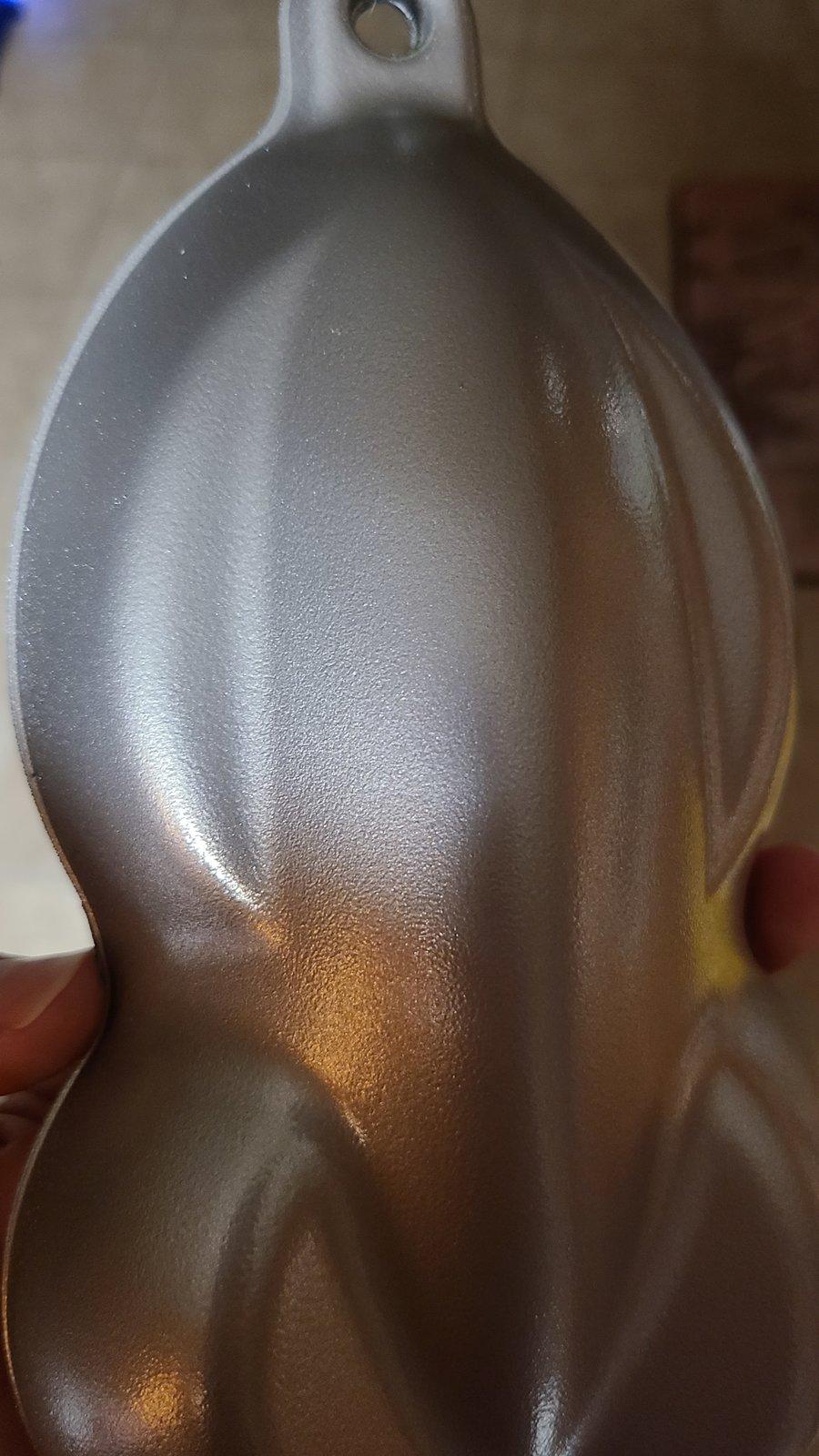

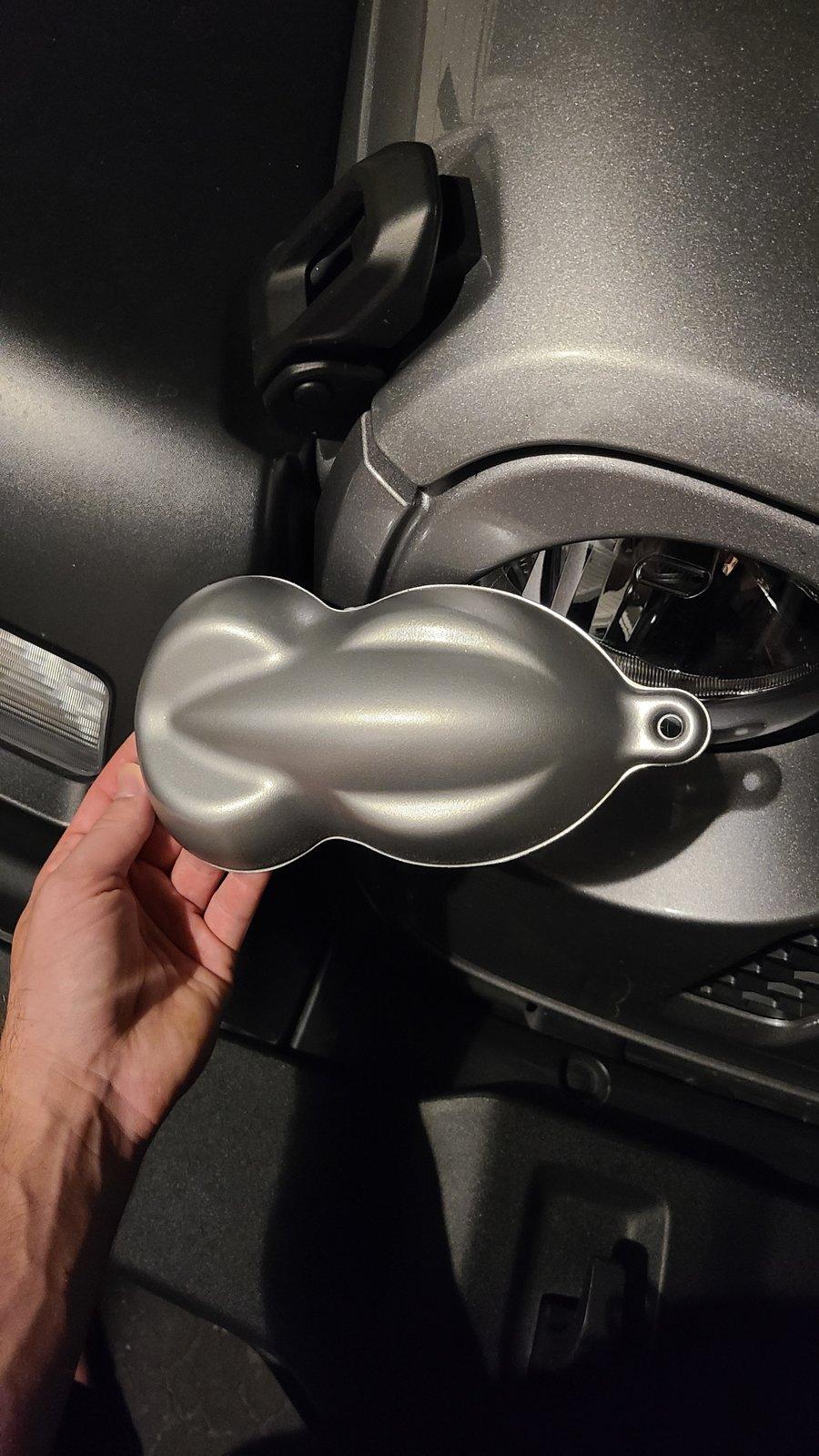

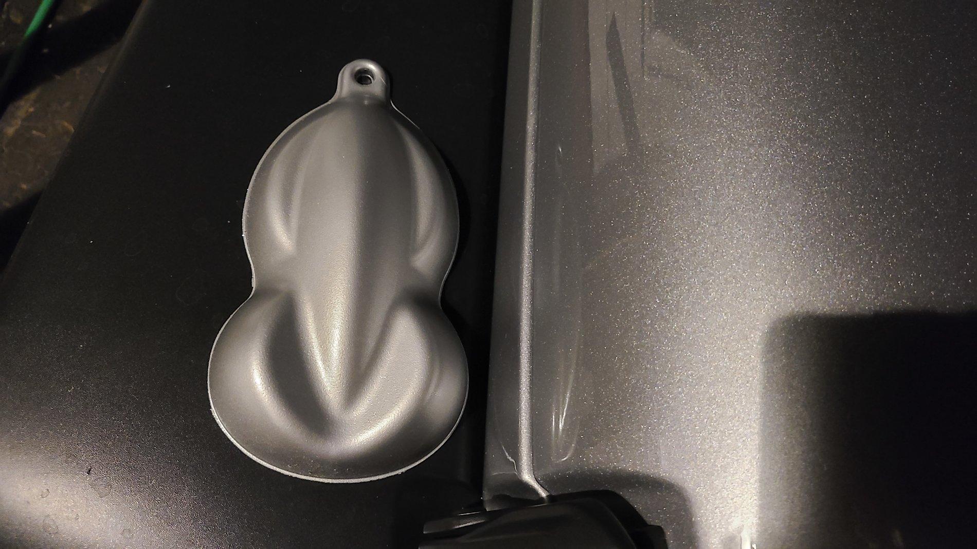

Colour seems a little lighter... Metallizer didn't really put a lot of flake//sparkle on my sample.
I'm only thinking of doing the fenders.

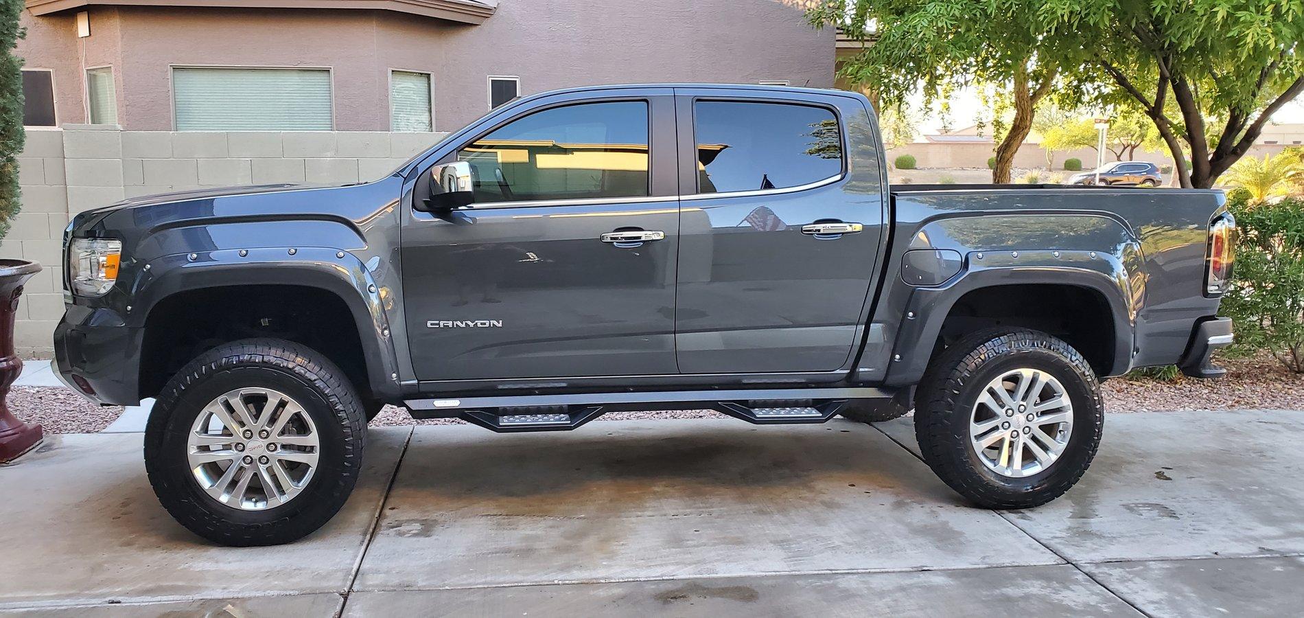

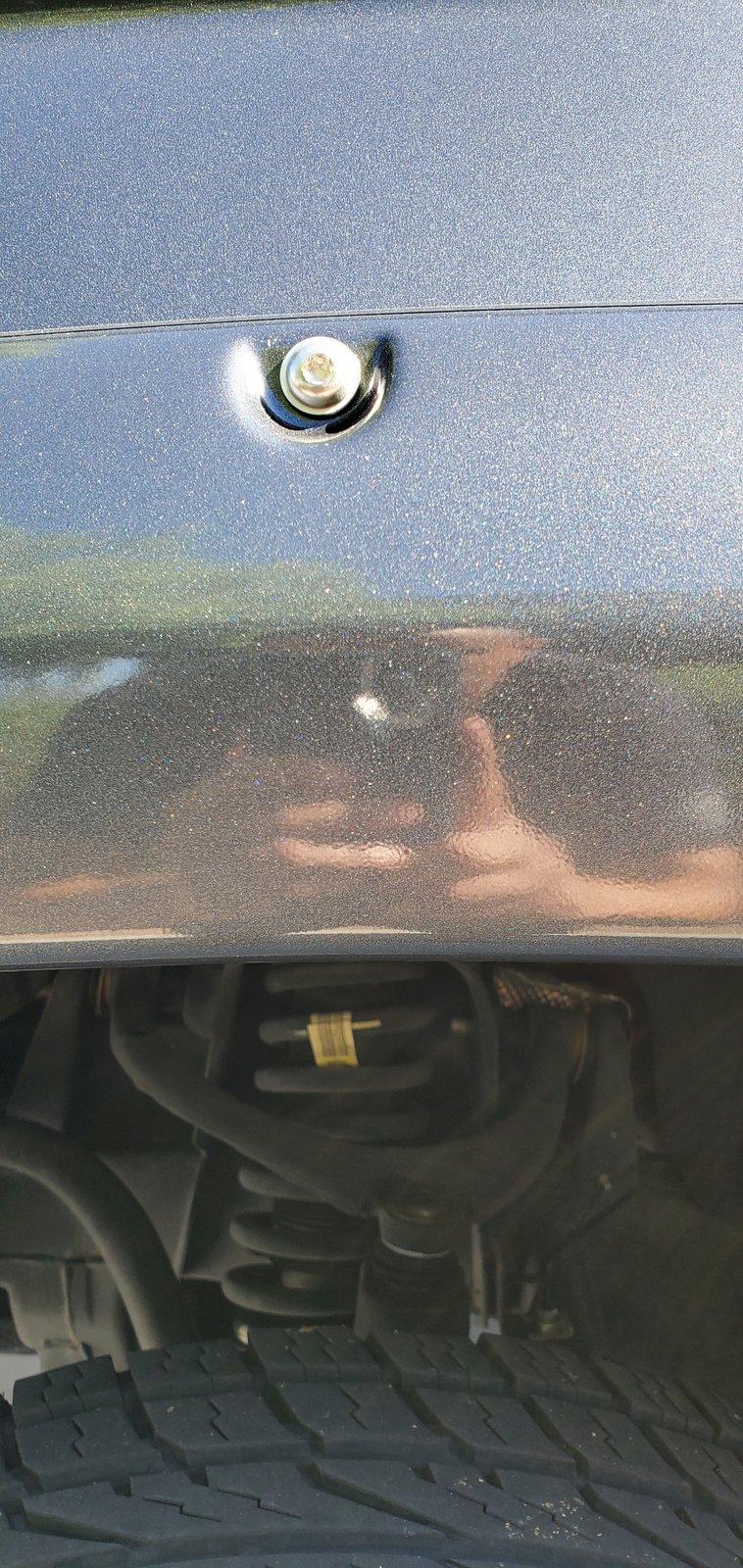

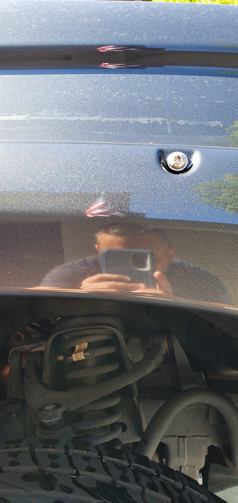

Here's some pics, first one is after the process I mentioned above, all rattle can automotive grade paint and prep supplies, second pic is after cutting and buffing. Third is a full pic showing the overall.
