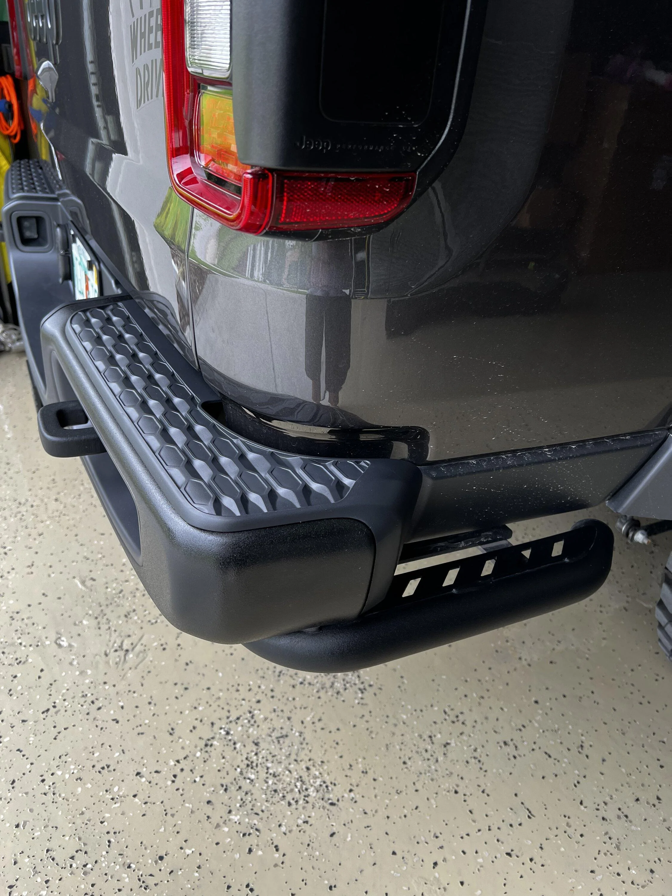

The red rock sliders will work with a stock rubicon steel bumper. Just installed one on my truck.
Jeep Gladiator Ordering some stuff tomorrow, any reason not to do steel rear bumper? 210D50CB-7FC5-4686-9786-D323EB8B5230
