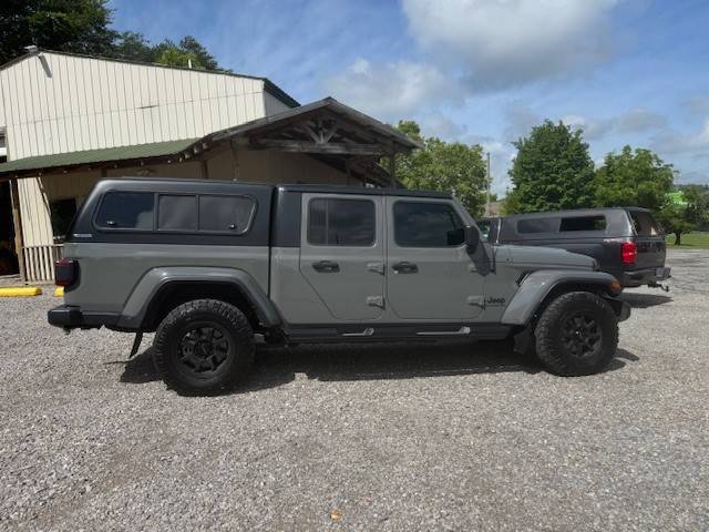

I installed the standard size ones. Seems like the front ones were a little tricky to get on, but I didn't have to make any modifications or drilling or cutting to get them to fit.
