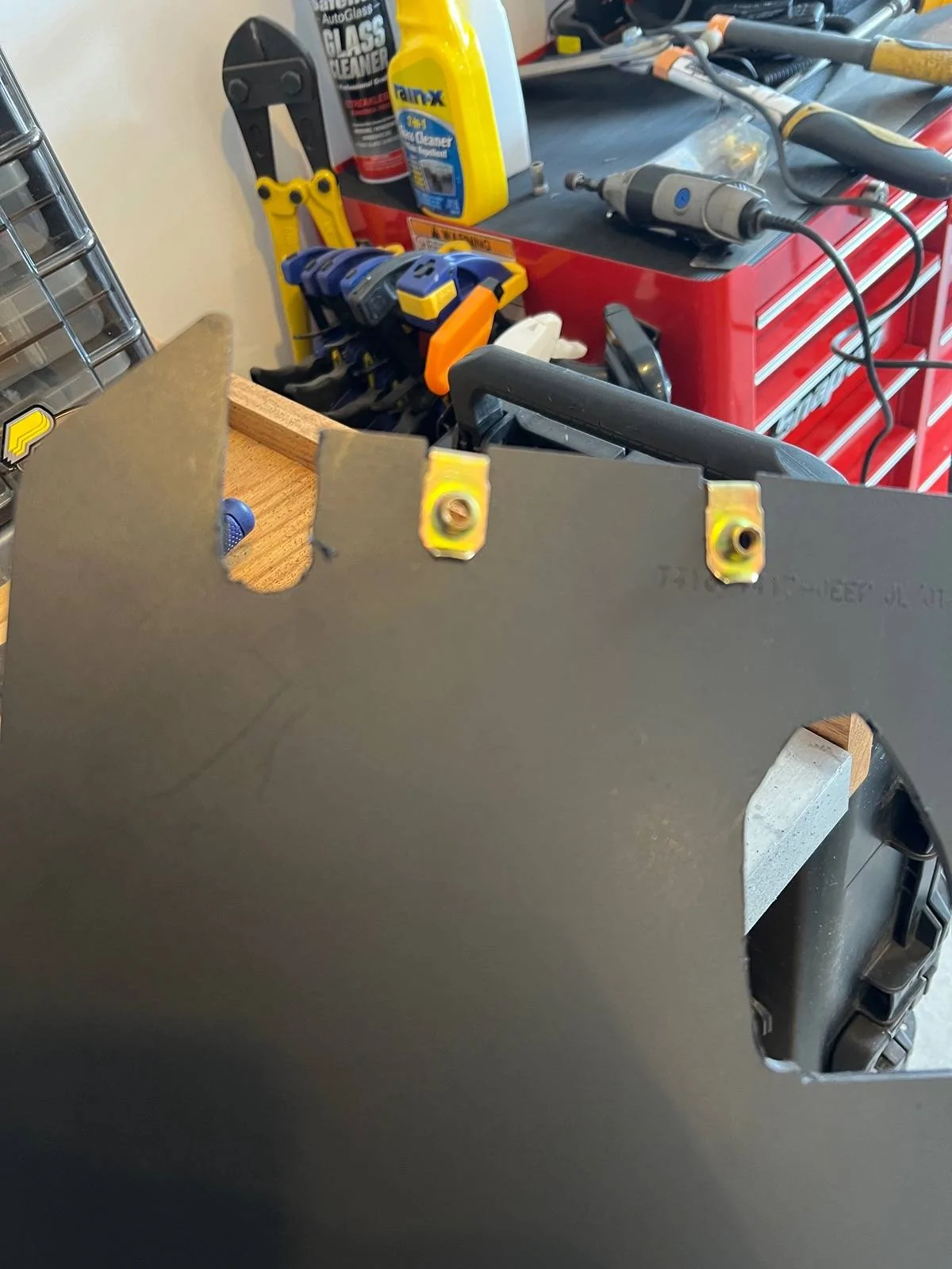

For the fronts you’ll have to trim the front flap to fit. Not a big deal but you need a Dremel, some folks won’t have one or not be willing to cut into a $100+ new part.
See pics in post below for what I had to do.

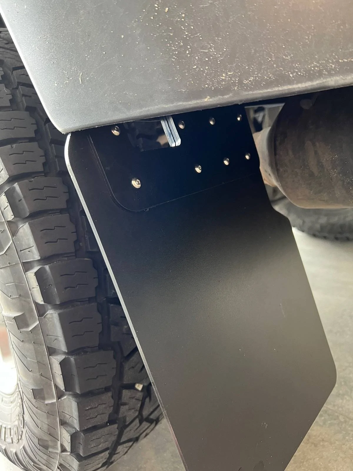

Rear actually fit just fine, the edge of the flap tucked under the extension of the max tow just fine. See pics below. Mine are not the wider versions, I'm not sure how those will fit.

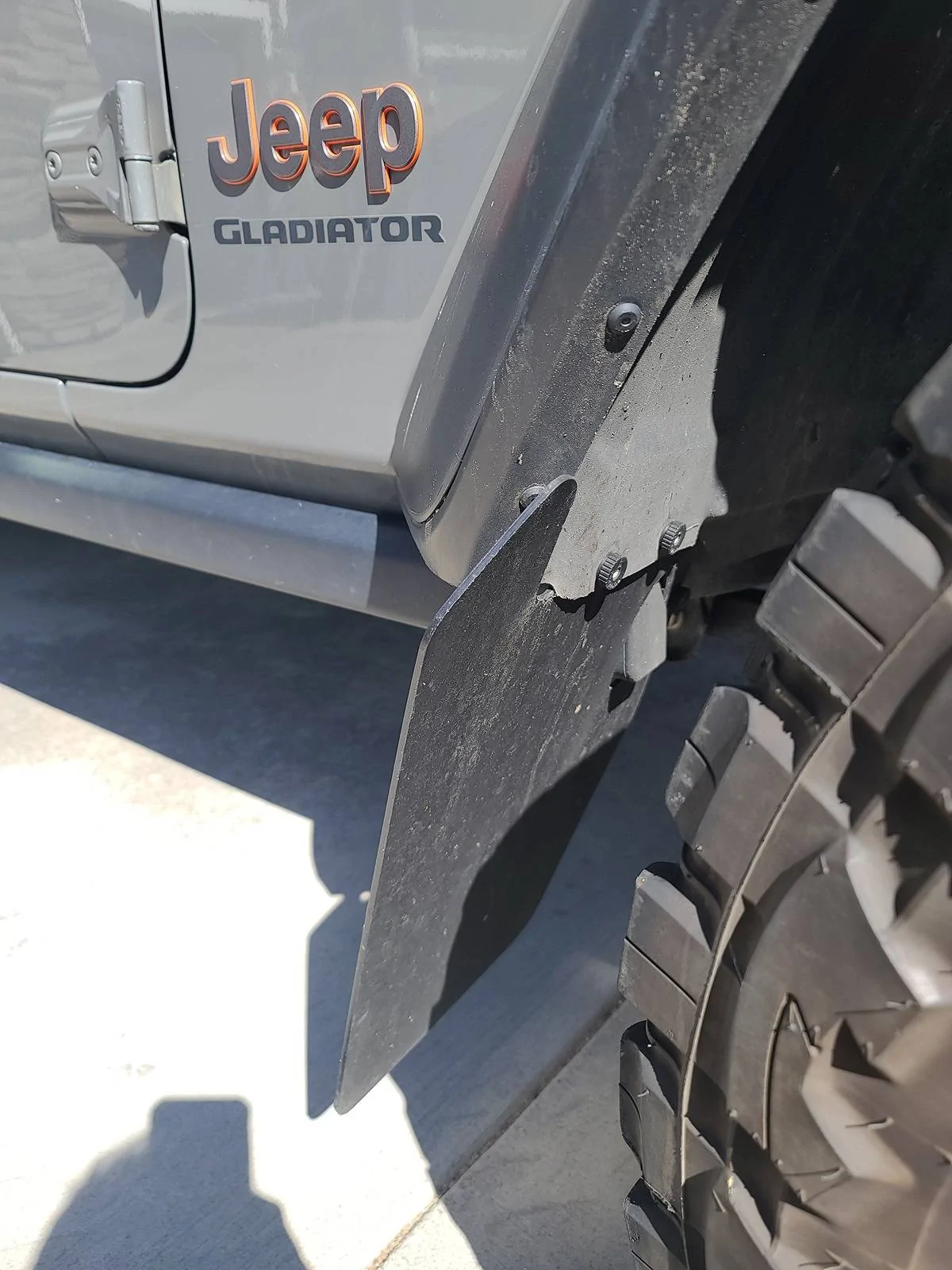

Fronts look like they will line up but I’m way off, hollow out the rail hole?

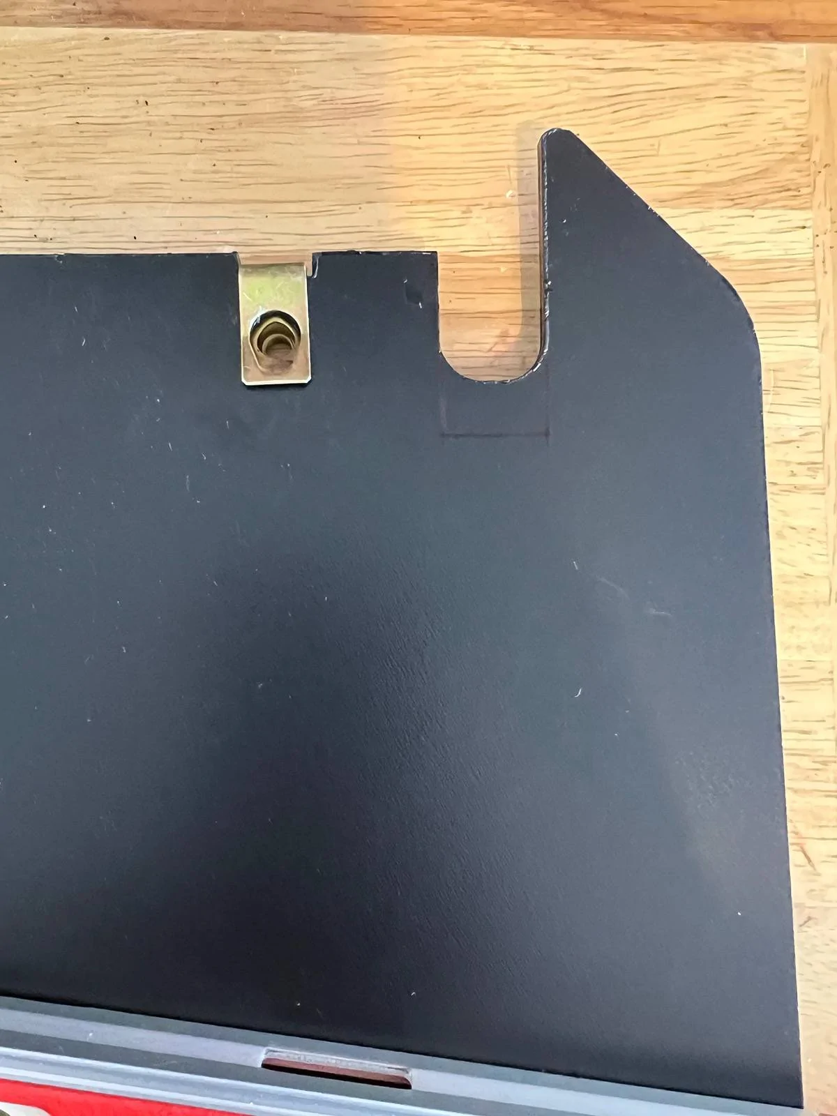

Ok fo the front I had to lower the notch to clear the wider extra trip on the max tow fender using the drimel of doom.
I marked out, drilled a line of holes along the bottom, used a cutting wheel for the sides then used a sanding wheel to clean up and radius out the bottom. I also have the rubicon rock sliders so I just widened that is not even a 1/16” to give me some wiggle.

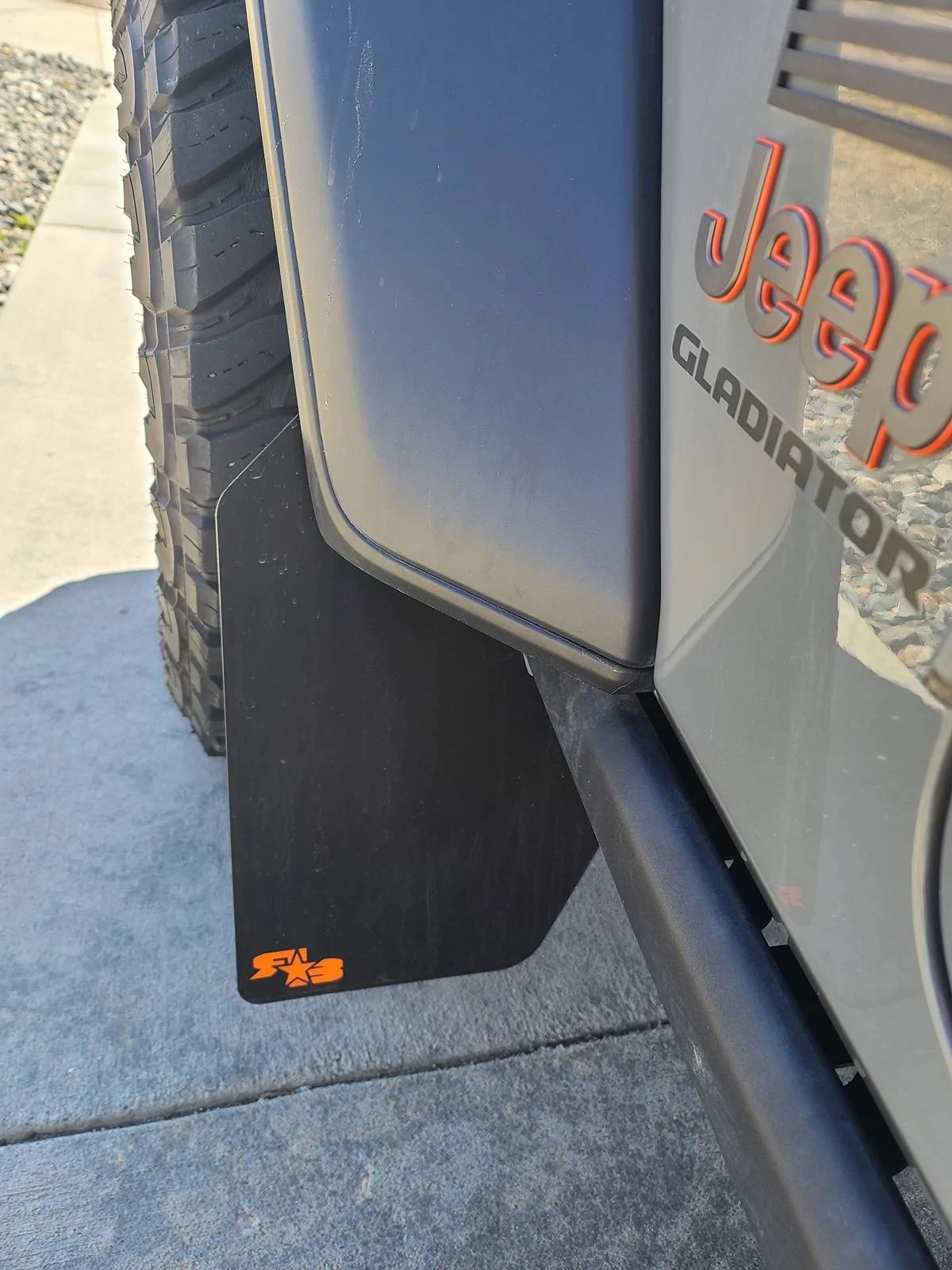

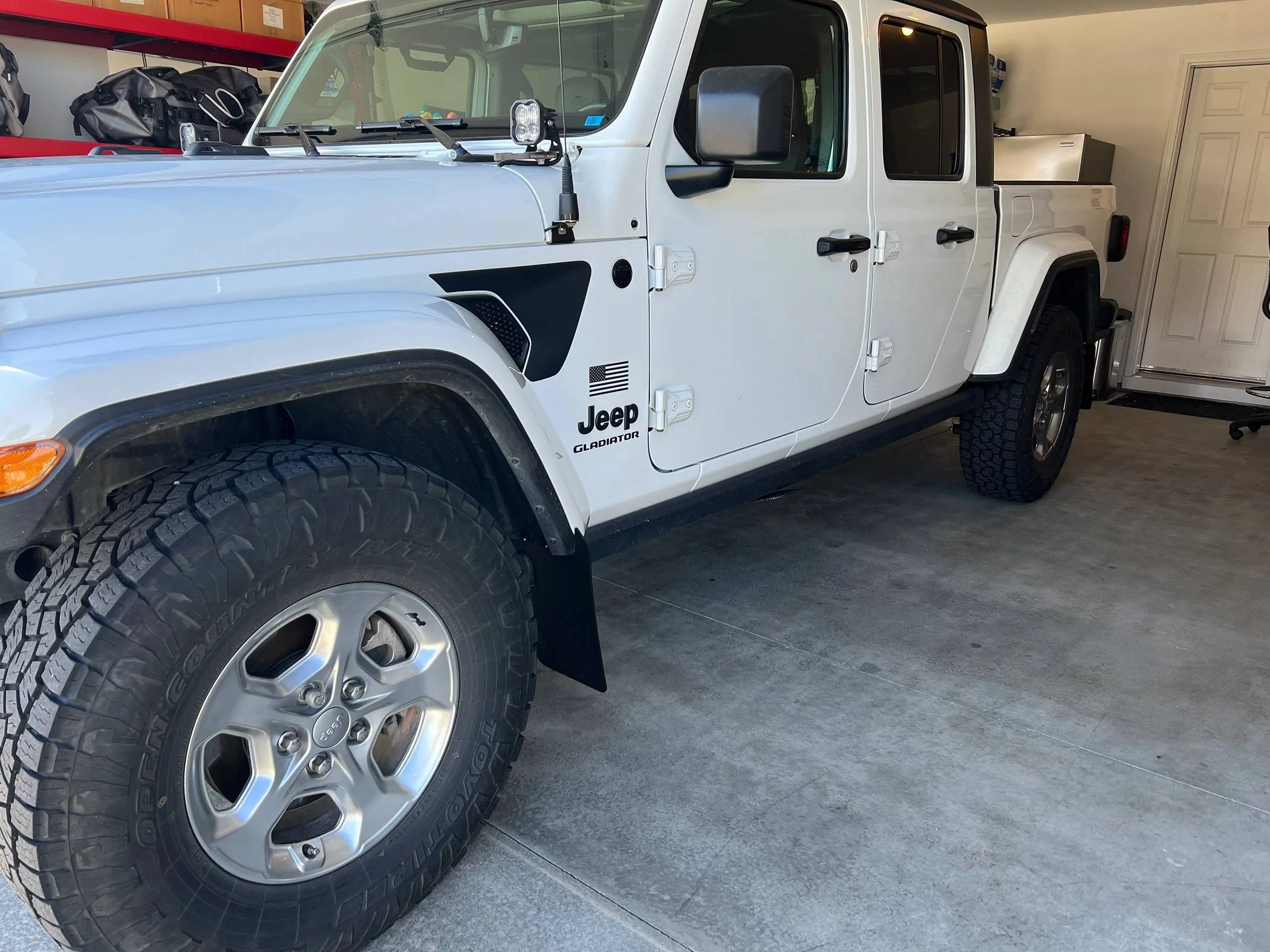

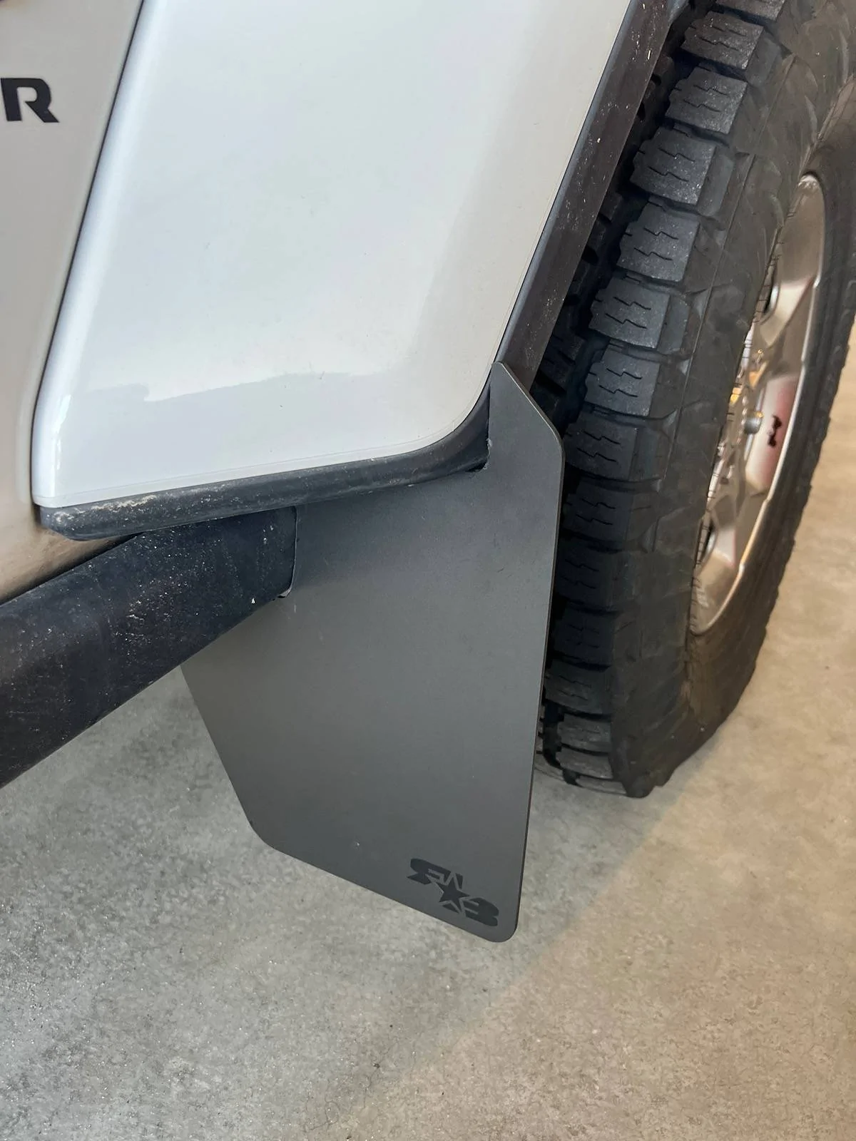

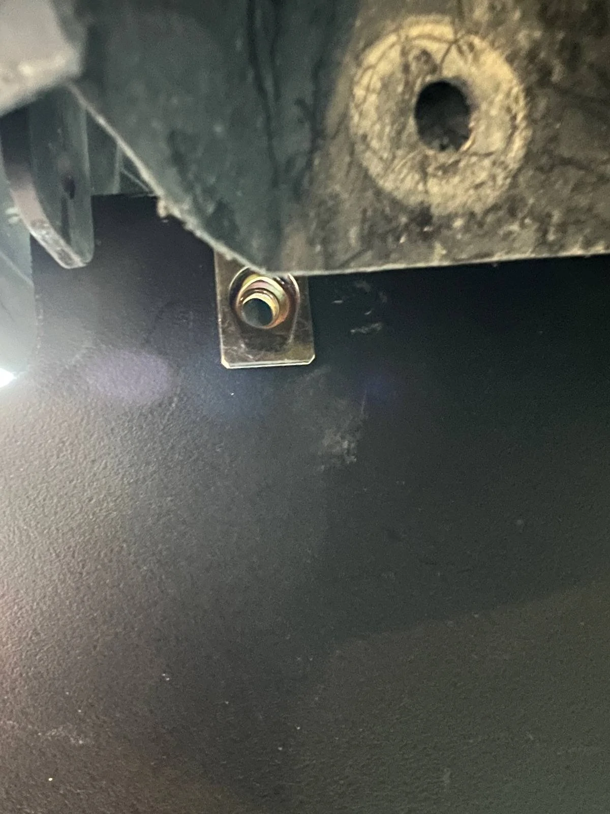

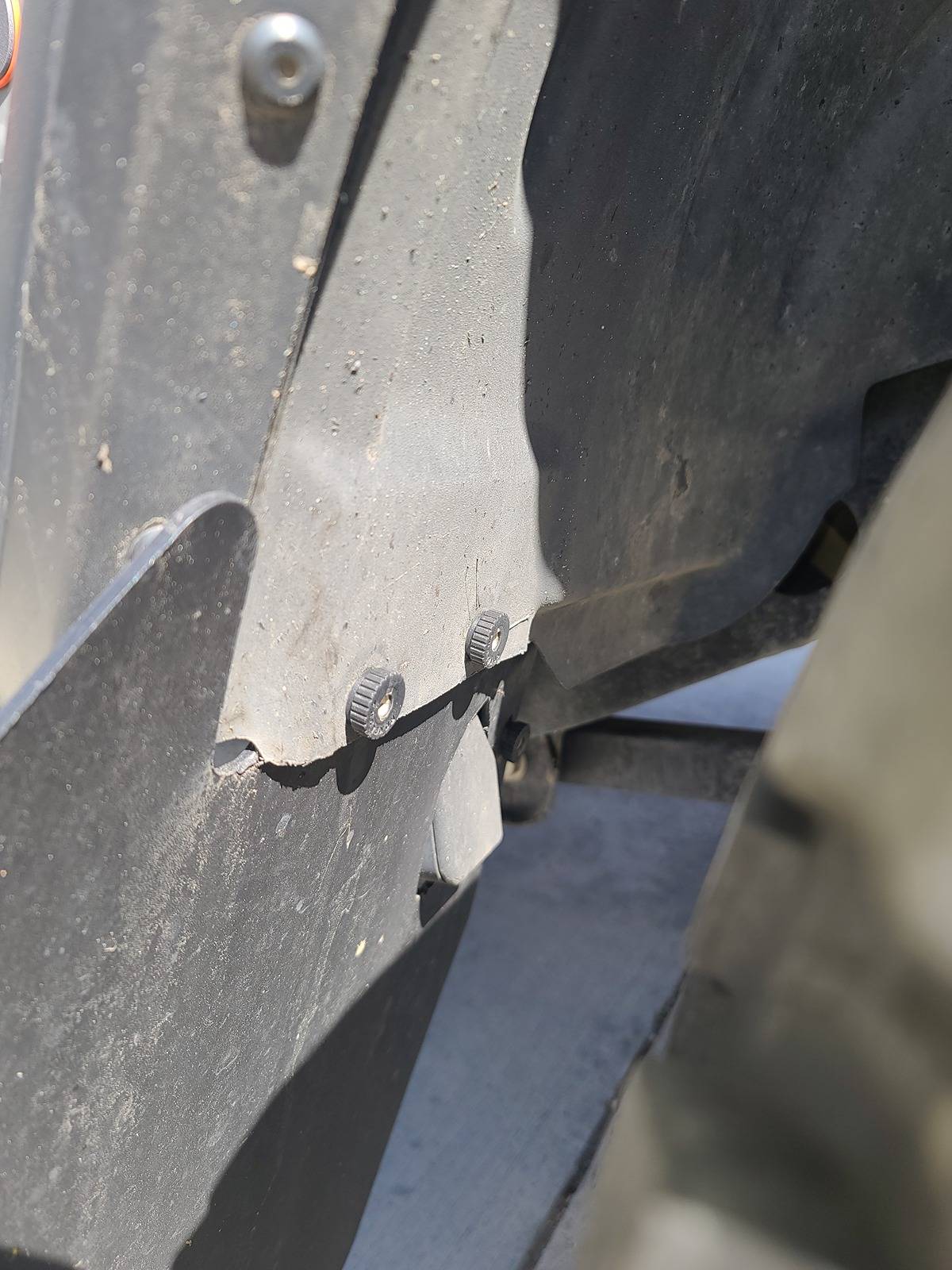

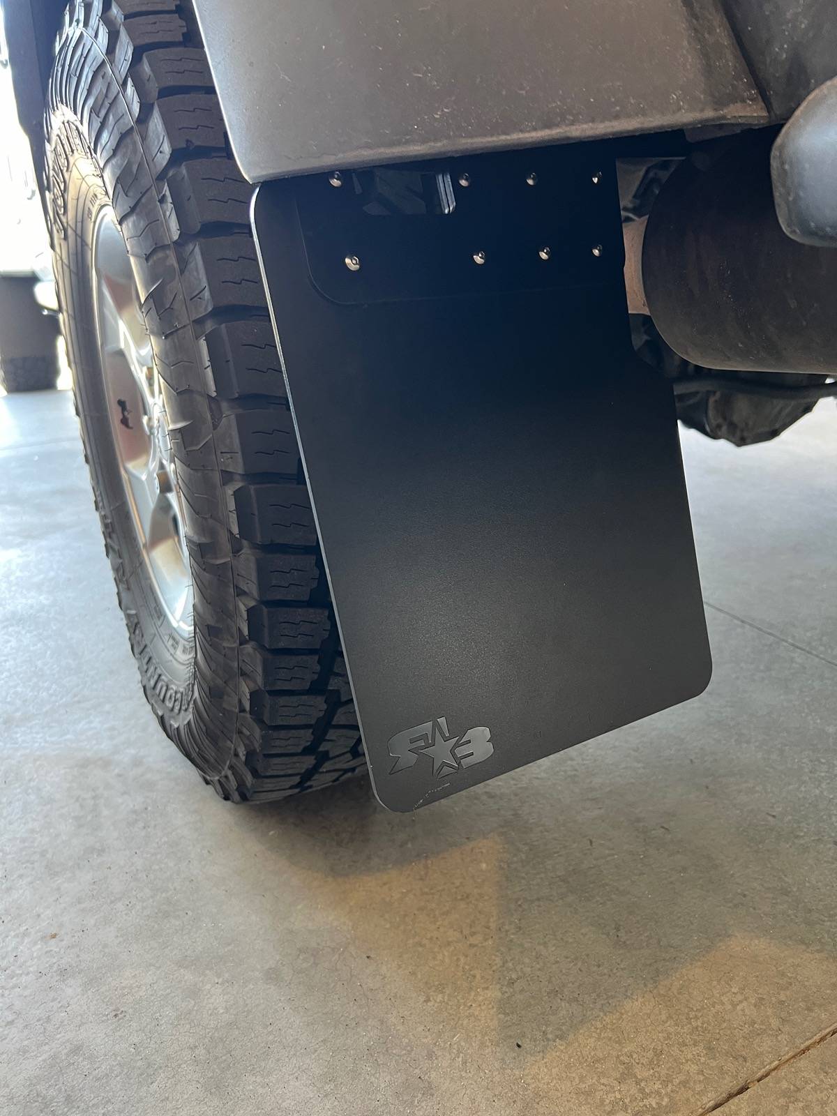

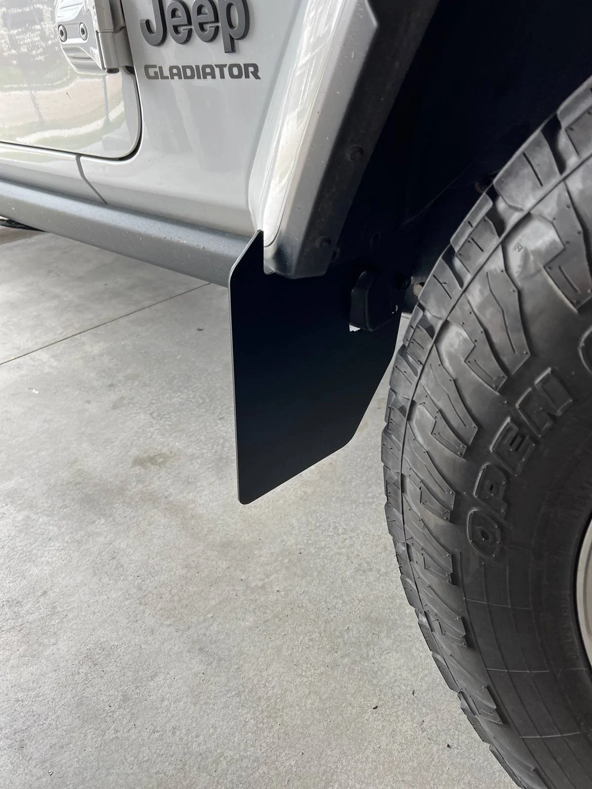

I have a Mojave but your front looks like its too far out. The outside lip should rest on the fender not on the outside. Heres a pic of my front and rear. Only issue i had was putting the the rears together, the holes were not square and the hex nuts would not snap in without re-squaring them, very annoying considering cost. Heres a pic of my front and rear. There was set of brackets i didnt use. Hope this helps.

Rears fit just fine;

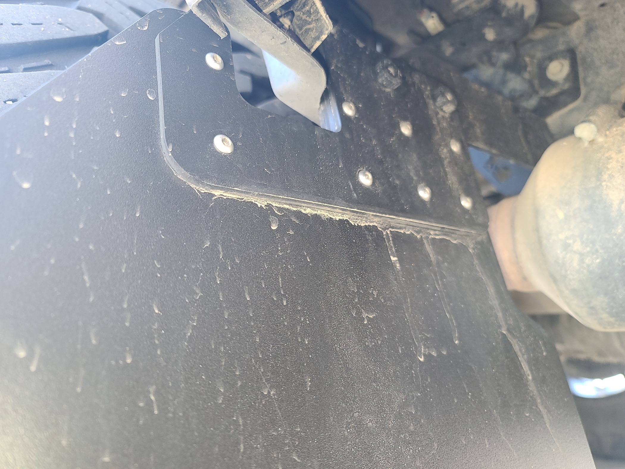

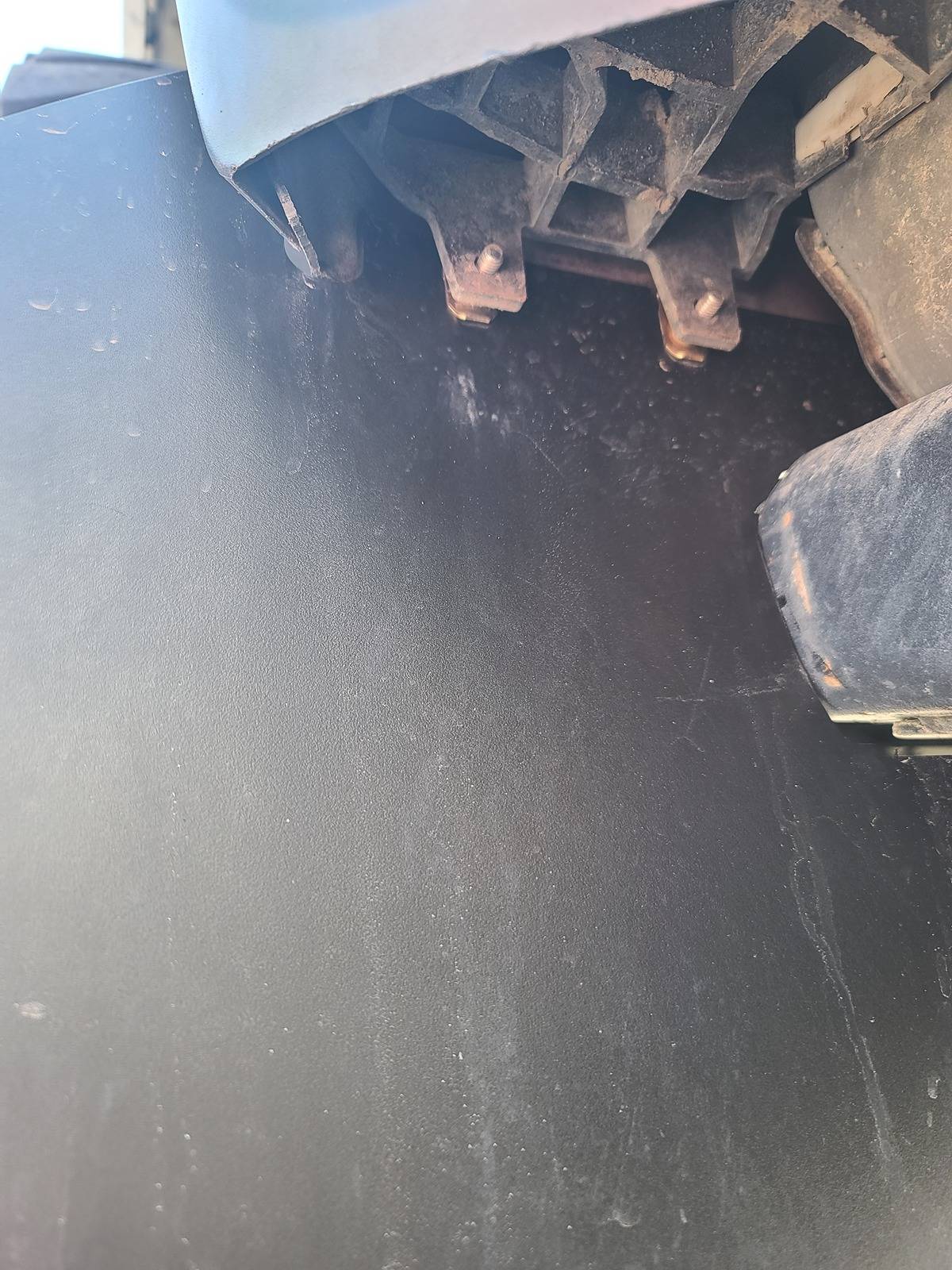

There are two OEM tabs that orignal plastic caps plug into on the back side, can u line up the RokBlokz screws with them? i actually considered putting the clips on them for extra support but they work fine as is for now.

Yes, mine run through the inner fender through the tab into the flap w the metal unit.
The way you have yours are incorrect.
You are either supposed to have the metal tabs on the oem tabs, or your supposed to go through them into the flap.
Inner fender/Tab/Flap
Or Inner fender/Flap/Tab with metal.
Right now yours are hanging on to just the inner fender. Go to 5 min of the install video..
You have the same fenders as the Rubi, you don't have the same fender liner front or rear as I do. With the Max tow we have the sport liner with an addition to widen them. That's what makes mine kinda goofy and the odd ball.

I installed mine exactly as described in the video, there's a third thumb screw that screws into a metal tab with the provided ear clip along with the fender liner that has the weight supported by the OEM tabs and its solid. Good Luck!

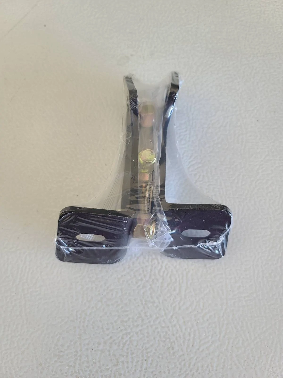

The extra brackets in the wrapper in the picture above is a new addition. Of course, I got to the end and had the extra parts. The newest video had directions on that but I don’t believe it was the RB video. I had to start over on the back but it was pretty easy. Just makes it attach stronger—I don’t know if it was needed or not.
