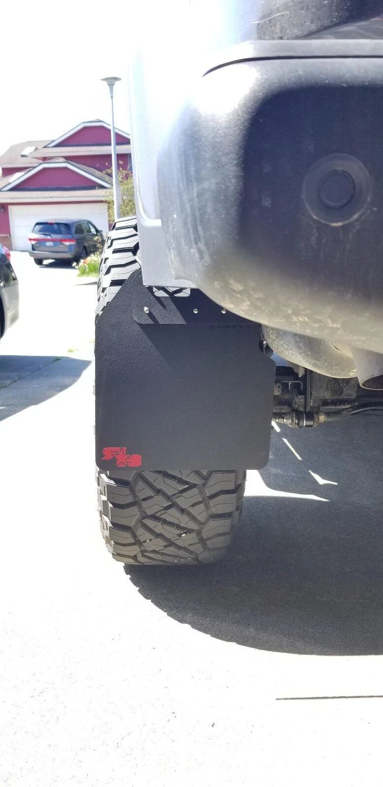

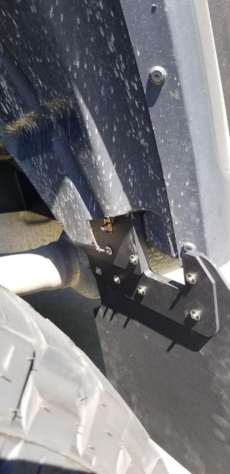

Has anyone installed these on an Overland trim? I only purchased the rear flaps XL original. I mounted the bracket where it says to go behind the plate covering the electrical panel, but then I can't slide the flap onto the bracket. Seems like the fender gets in the way. I thought these fit all trims as per their website. If you had to cut the inner plastic of the fender, can you share photos?
A bit disappointed for the price they don't just bolt on and fit.
noodles
Paul
Nov 27, 2019
42
43
Richmond, BC
Jeep Gladiator - Overland
Update. If any one using sport or overland trim, you have to cut a small piece of you inner wheel well plastic. Then it fits great. A dremel off amazon will make quick work of the plastic.

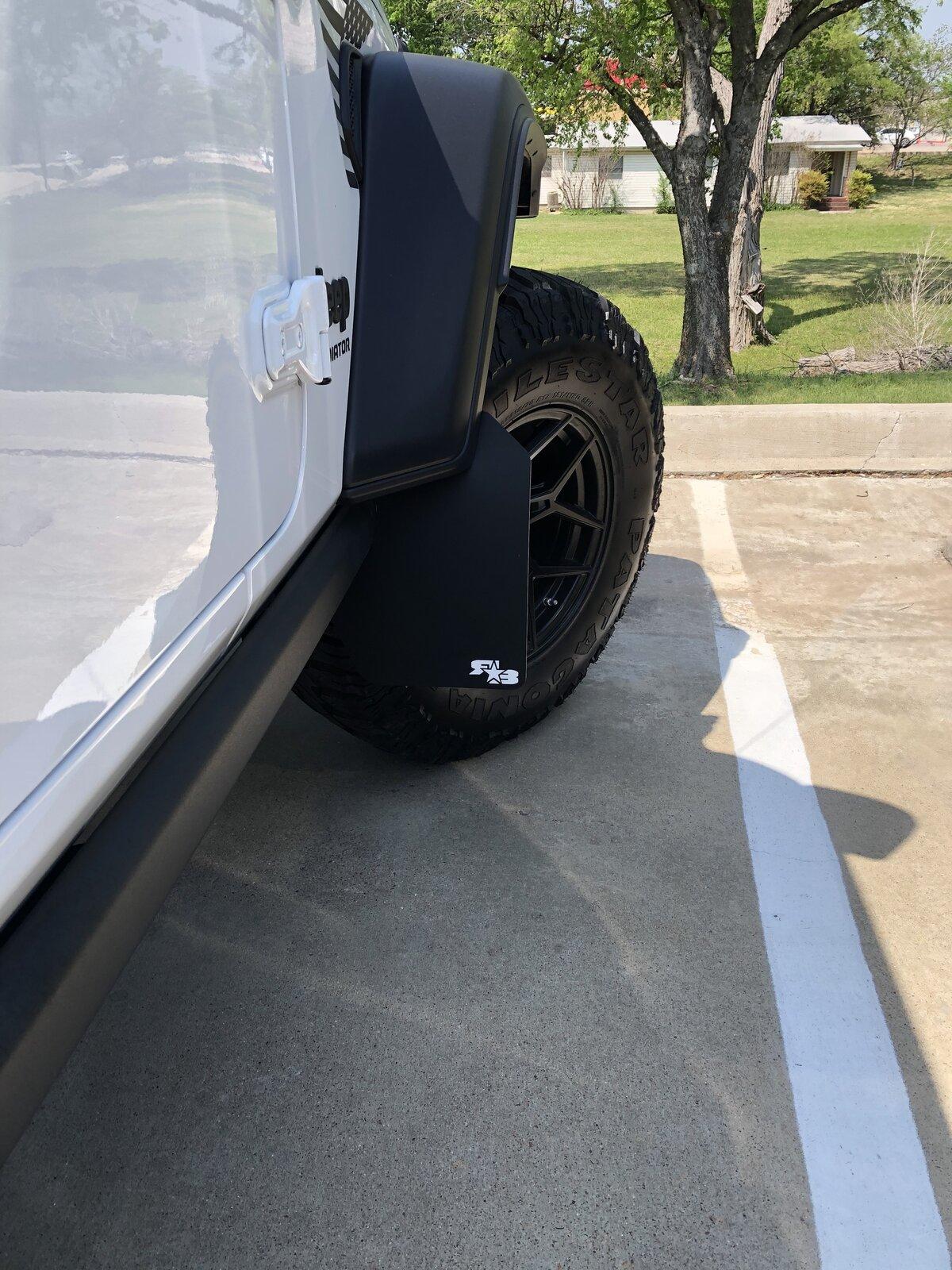

Jeep Gladiator Rokblokz Installed 20210418_133103
Jeep Gladiator Rokblokz Installed 16187793624584760692851097341533

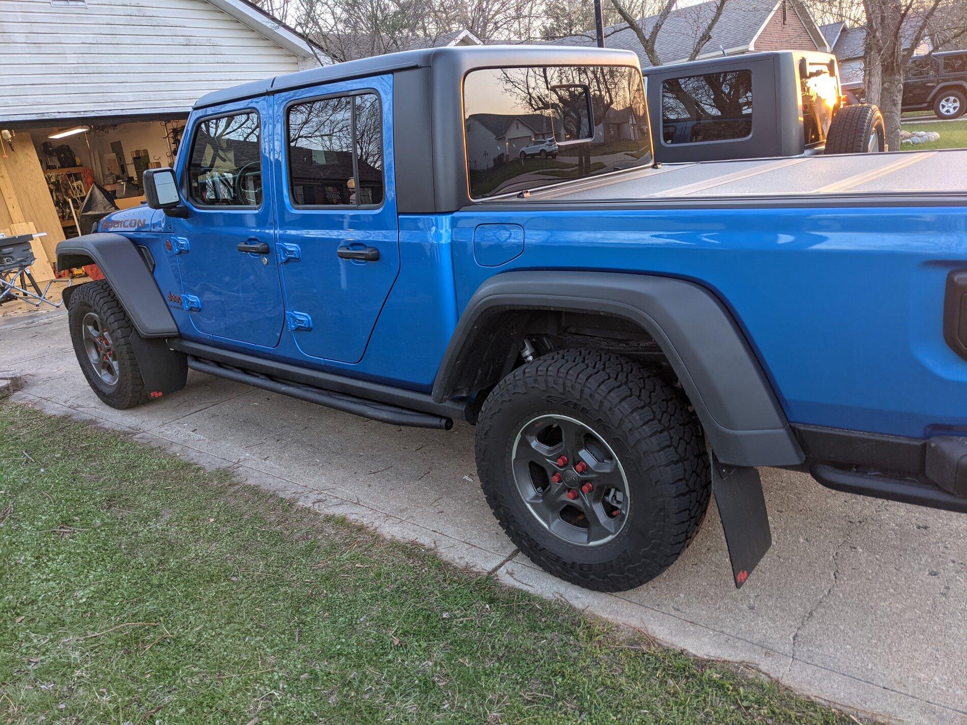

XL longs... Definitely help keep the dirt and rocks off. ?
